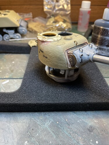

Finally got the turret glued to the basket. Something inside by the gunners station is rubbing on something else and I had to make a few slight adjustments to get it together. PIA.

I glued the turret basket to the turret and did a test fit inside the hull, and it was not seated level at all, being raised at the rear. I should have cut off more of the bottom of the turret floor from the beginning as it’s rubbing on the drive shaft hosing. Now I can cut it off and rebuild it to fit better. This was very frustrating but in light of this new info and pic I can fix it.

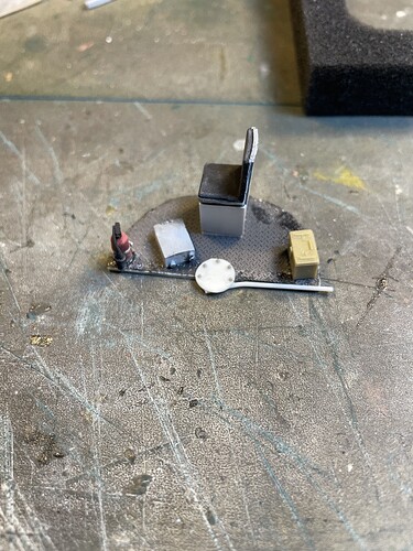

Ok here’s the revised turret half floor. Again just cobbled together.
Keep it up, it’s looking great.
Ralph
Thanks Ralph. I had a large, deep hole next to the turret loaders hatch hinge which I had to fill. I ended up cutting it off altogether and sanding it and installing the one from Blast models. Another small set back as I was about to start putting the rest of the turret parts on. So I moved to the hull. Getting there.
