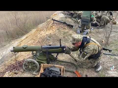

or this old beauty:
Anything that spits out bullets …
