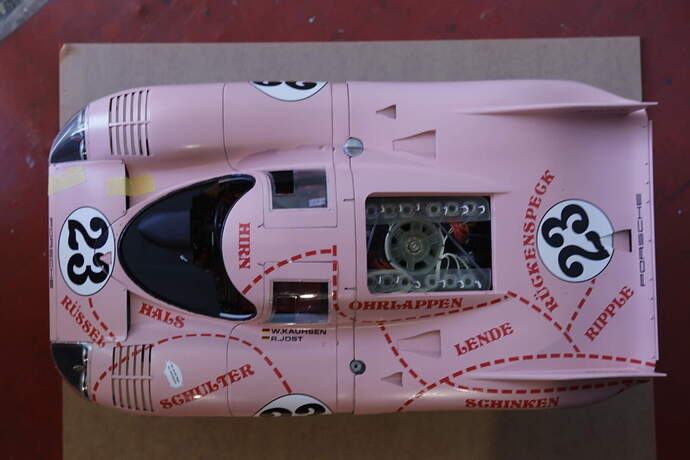

@joel thanks Joel, I also built that Pink Pig, and yes the doors didn’t quite fit (and I spent over a week continually reshaping them but there were many complex curves to deal with) and for those who weren’t there this is what I started with
but you can see I got pretty close
and you can also see the engine is too wide. From side on it is not too bad.
I think there is usually a solution but it just takes patience as I said in my reply to Richard.
cheers
MIchael

Michael,
Your Pink Pig issues with the door was pretty bad, but you got it darn close. My friend wasn’t so lucky.
As I’ve said a dozen or so times, you guys just simply amaze me with your skills to assembly such complex models.
joel

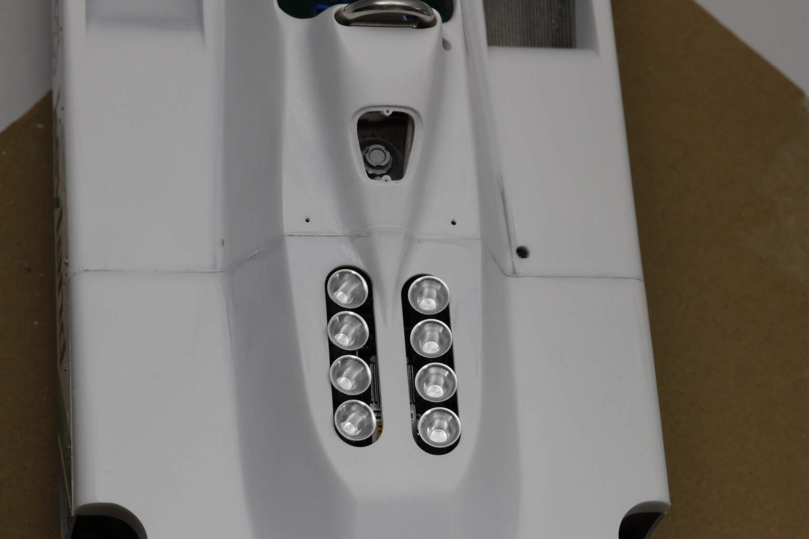

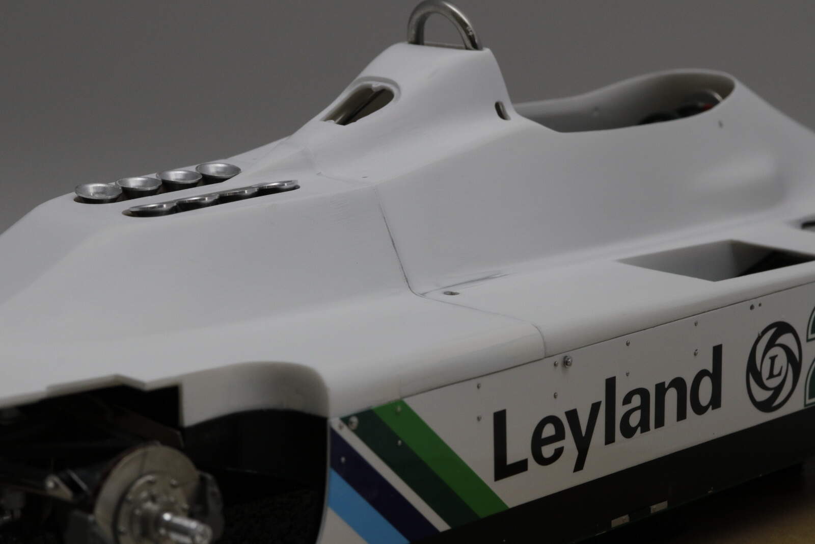

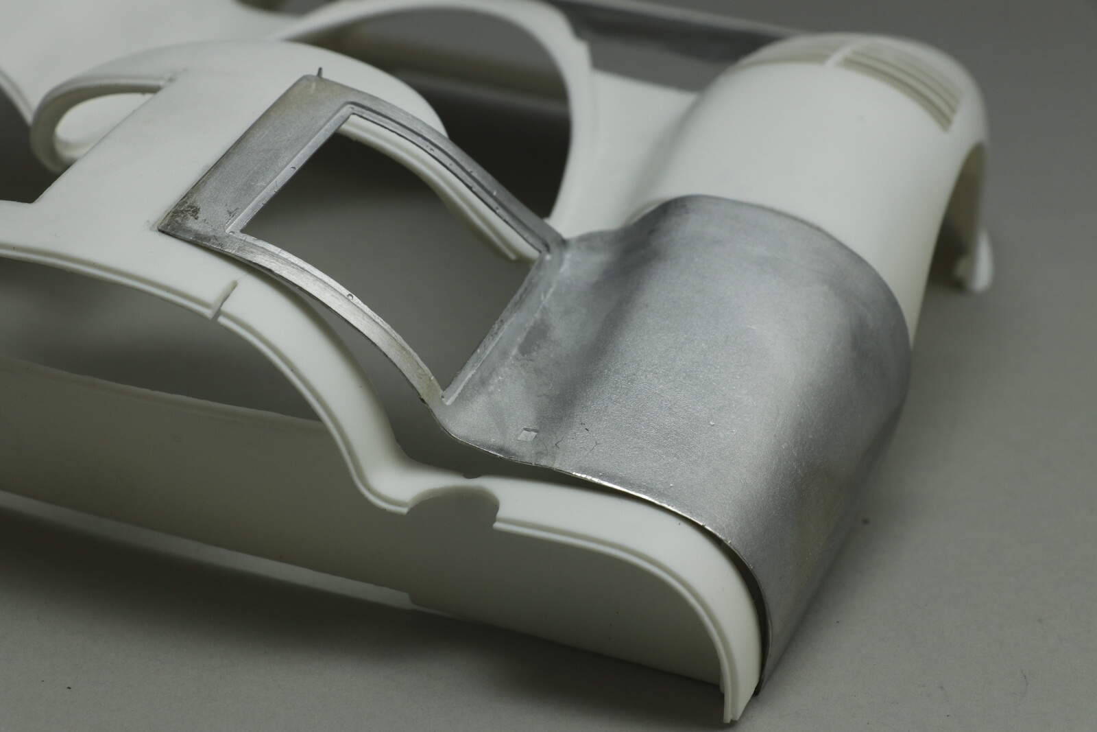

Well just about there for getting it all finished
From this
and this, especially that horrible gap at the top
to front and back match on all planes - it has turned out better than I thought
Now for some paint.
cheers
Michael

Michael,
I wish we had some kind of award other then just a verbal Kudos for a job not well done, but done to the highest degree possible from what I just saw in your set of pictures. Now that’s truly amazing work. No gaps, no lips, no steps, just seams that meet and align as the designers of the FW07B intended them to.
Richard’s Zen proverb reminds me of a TV series: Kung Fu, as this would have surely been one of the questions that the Master asked the “Grasshopper”. Without a doubt you’ve also answered this question in the most positive way possible that a student of auto modeling Zen could have done.
And as D said, it certainly does. Same for me as other then painting and decaling (the more complex the scheme, the greater reward), solving problems in fit, accuracy, and scale are truly the most rewarding.
Now use that newly found Zen philosophy to paint to perfection the top body panels. We all have complete confidence that you surely will.
joel
Michael,
That’s a spectacular improvement. They are not small components but you’ve got them beautifully aligned.

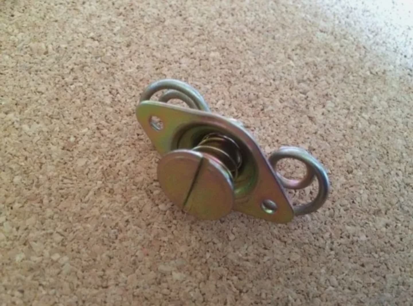

Now you’re all set for those working Dzus quarter-turn fasteners you know you want to make!
Phil.
Phil,
But of course the kit comes with those fasteners all ready to go.
joel

@Phil_B Thanks Phil. The fasteners are all there, and a key part of the build since they hold all the body parts in place. If I have it right there are 12 in total - that’s what’s in the box anyway.
cheers
Michael
Michael & Joel,
The fasteners are indeed there but I was jokingly suggesting you make them spring-loaded like the real thing with the coiled wire fixed to the back of the “receiving” panel.
Phil
