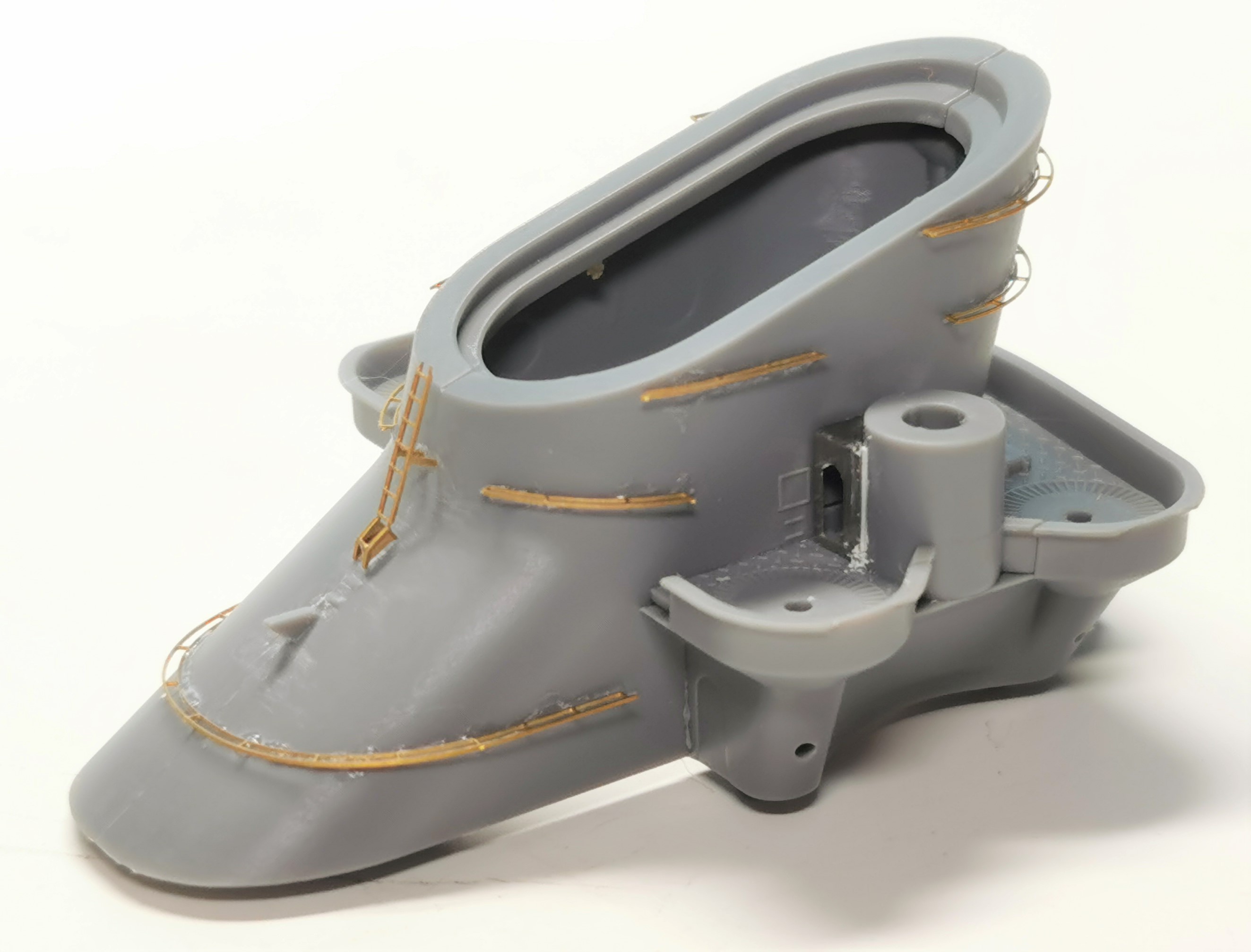

Continued with the funnel section. Here comes, in my eyes to one of the main attractions of the ship: The 3d printed upper part of the funnel itself with all of its small railings and ladders and pipes. Its from BLUE FATTIE MODELS and its a real gem and surely worth its money as these details are barely doable by hand without breaking off some details a hundred times or so…
The lower part of the funnel and the platforms around for the searchlights were used from the kit itself. No problems here again, just carfully removed the seams with superglue and sanded the areas over. These small etched railings are from KA-Model upgrade set again
And both parts glued together. Can´t wait to see it under color ![]()

Wow … And and even bigger WOW !!
This:
That upper funnel part is stunning? Amazing? I don’t find the right words…just unbelievable…
Looks absolutely great, and like you I’m looking forward to see it painted!
