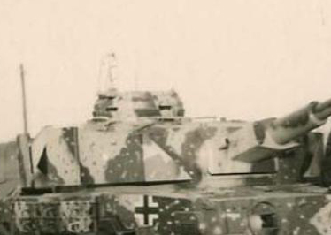

These are the best photos of PzIV in factory “ambush” pattern that I have saved in my reference files:
Panzer IV J disk camo
This is as close as I can find. While the dots appear to be sprayed soft-edged, the disks are hard-edge. Look particularly at the turret schurzen.
If you search any stationery store/dept you can find 1/4" circle peel-off stickers - these are ideal for the larger diameter circles in 1/35 scale. You can also find decorative (the design is irrelevant as you’re going to paint over them anyway) peel-off stickers in several sizes/diameters. If you examine most factory-applied Hinterhalt camo you will see that at least two different diameter masks are used. You just use them as any adhesive painting mask - it’s just that you have to apply them one at a time, and remove them one at a time.
