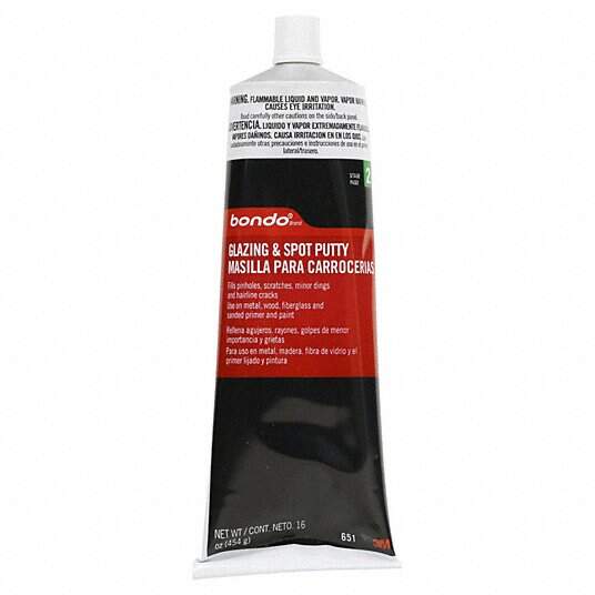

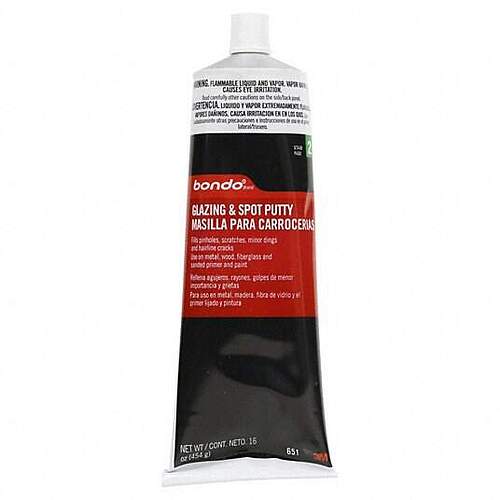

A third recommendation for Bondo glazing and spot putty.
If l’m not mistaken the Tamiya stuff is an acrylic based putty. If it’s anything like the AK stuff that that I have tried I don’t think I want it. Bondo looks promising though.

Bondo Spot & Glaze is excellent putty in my experience. Also a nitrocellous based putty.
Putty vs putty Bondo is hard to beat for unthinned filling.

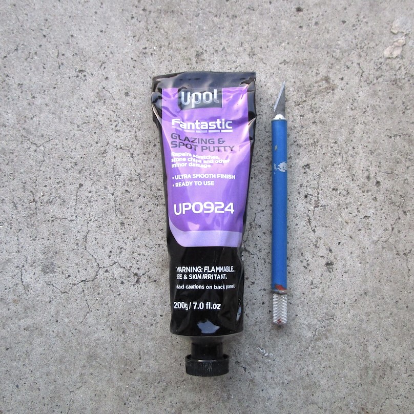

However, if you want to venture out a bit. There is UPOL Glazing & Spot Putty. Similar to Bondo spot putty but with no grain. This stuff has the application consistency of tube paint like oil paint or acrylic paint. Smooth paste and smooth finish but hard and tough as Bondo.

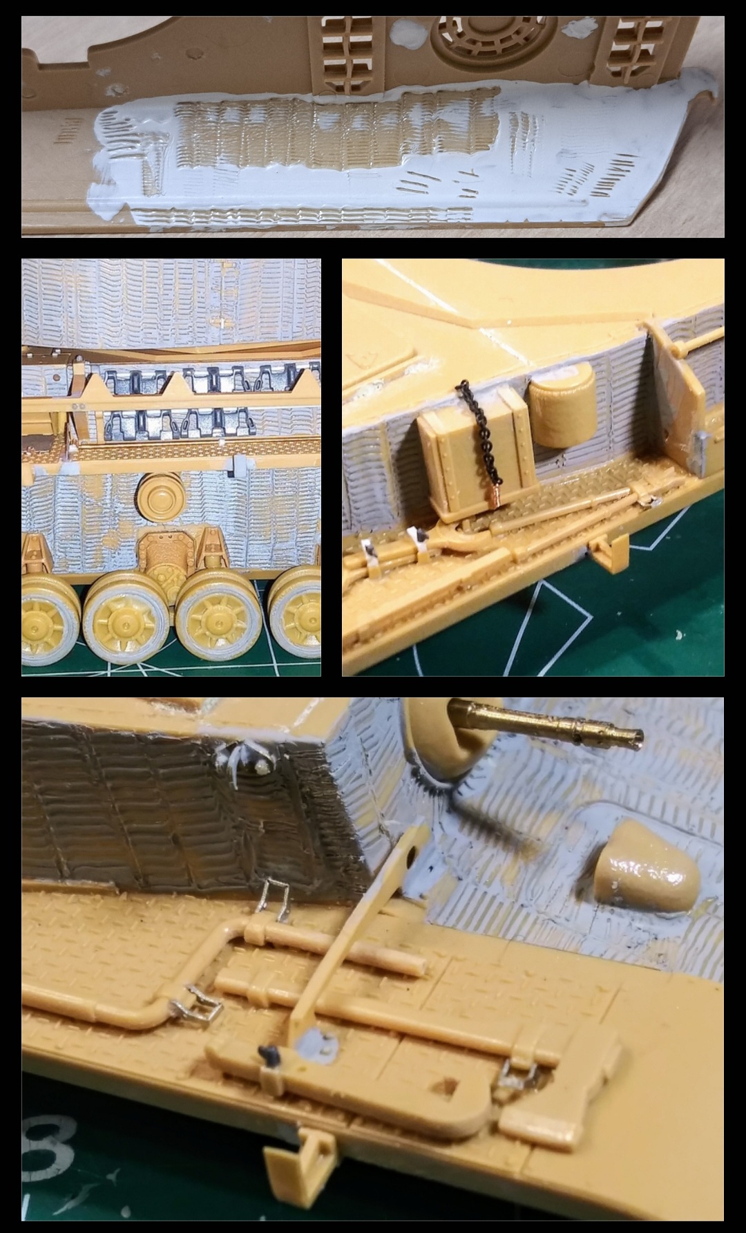

Most of putty I’ve used, I wanted thinned putty glaze almost like paint for zimmerit, texture or filling small defects or blemishes. I’m counting on it to shrink slightly etc like a cured paint.

The grey is Molak Stucco Putty or Tamiya Basic thinned out with liquid cement. White is Tamiya polyester.
I’m sure there’s a way to use Tamiya white for thin zimmerit, but I haven’t been able to find it.
