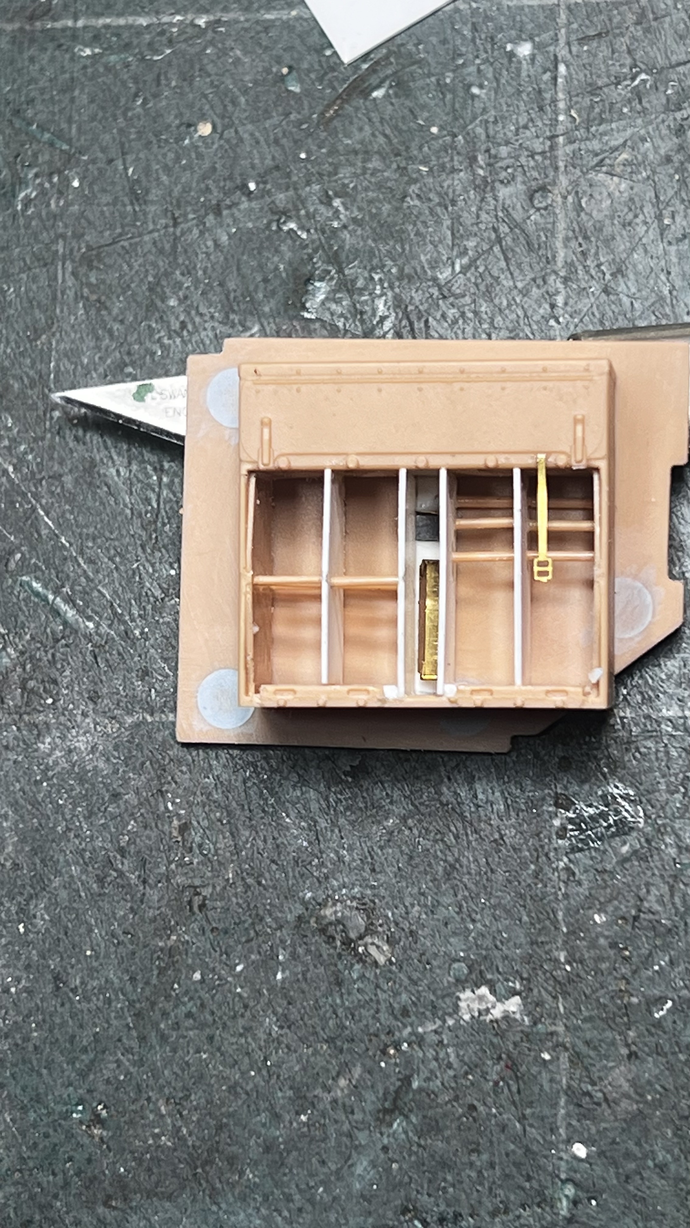

The side storage compartment has changed as well initially the box has two storage box units as depicted by the kit and Eduard etch provides etch for this however the new one has a pull down set of rods which provides for a more flexible solution.
If you have any pics of this I’d be very interested in seeing them as they are very hard to find.
I’ve bought books in the past for projects but as I typically don’t build multiples of a kit they then become less useful and I usually then sell them. Also it would seem that these may not have updated vehicles in them. Thanks anyway.
Early style as provided
