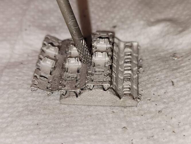

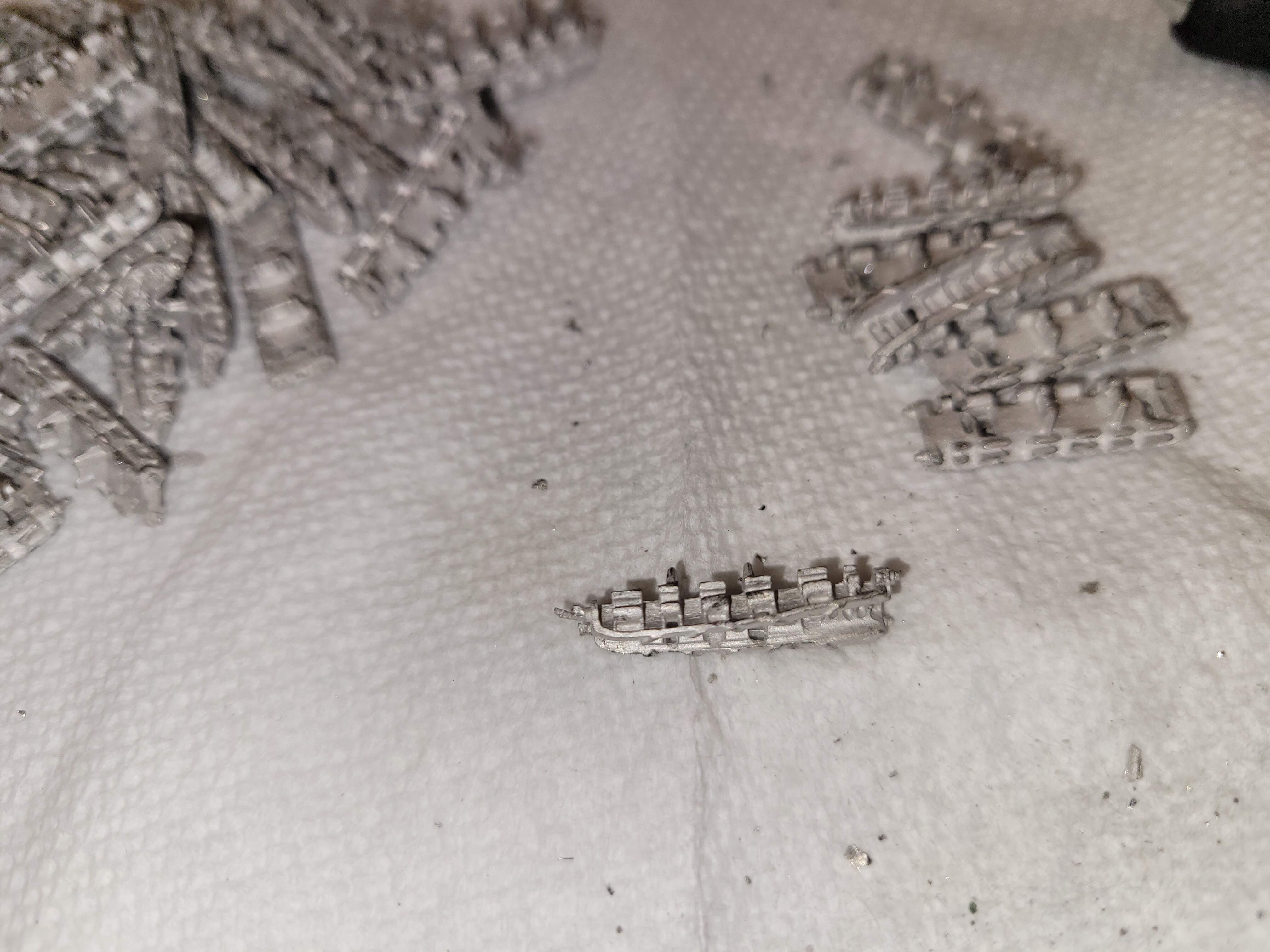

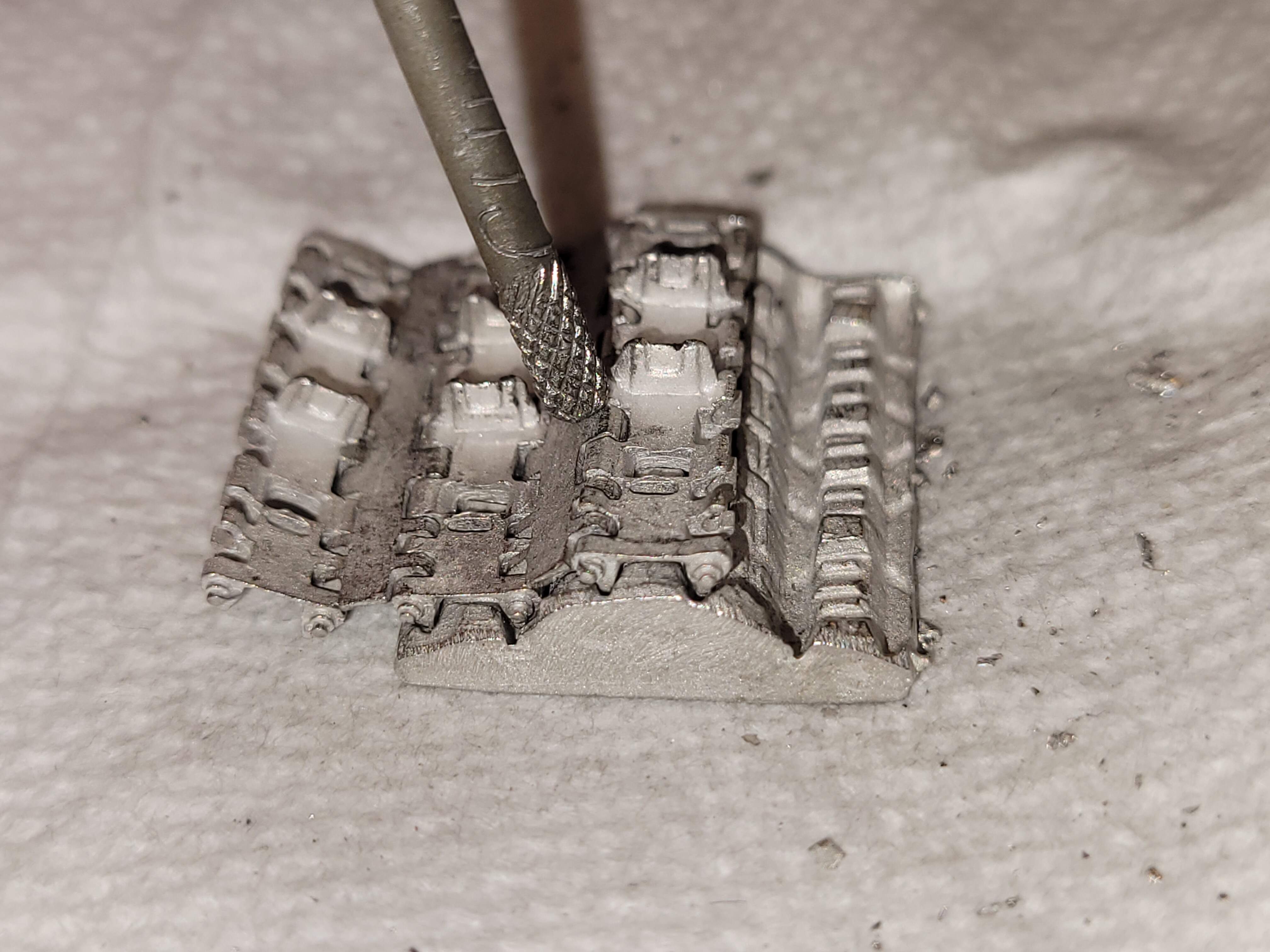

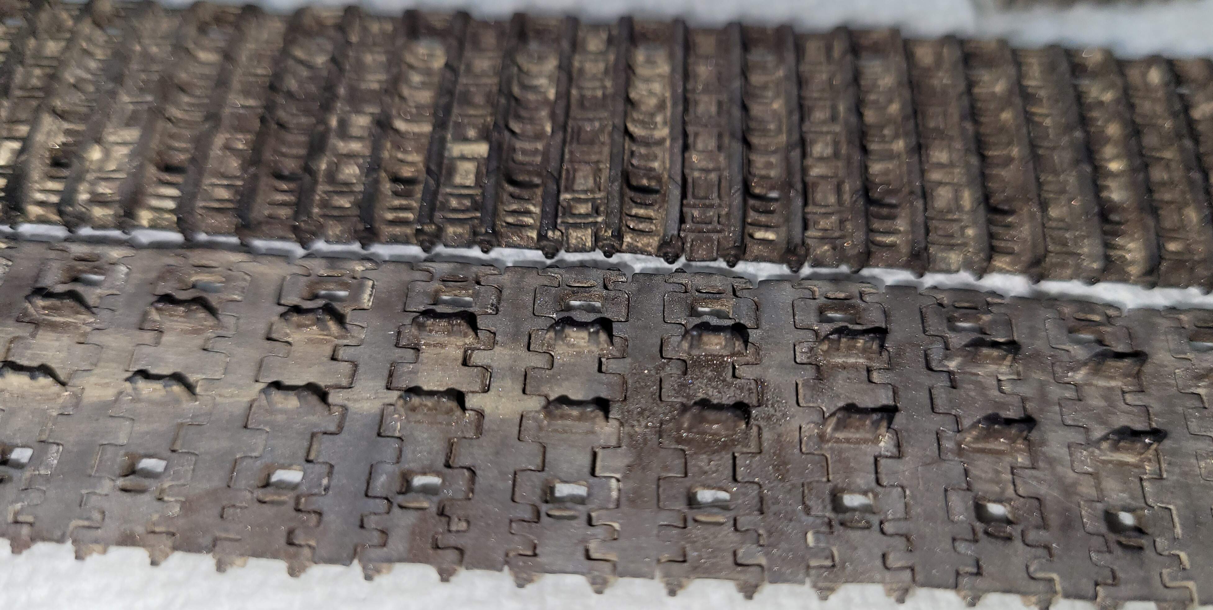

About 1 out of 7 of the thick links were distorted or warped beyond saving. Probably half of thin flat links were wrapped but easily flattened back to correct shape.
Several links had broken pins or broken classes so that also had to be checked.
In the end, I had ninety usable thick links and over a hundred usable flat links. Each track run needed 42 thick & 42 flat, plus 6 double links for spares. So there was a total of two spare thick links.
Thankfully Friulmodellismo included an alignment jig for crimping track links back in the day:)

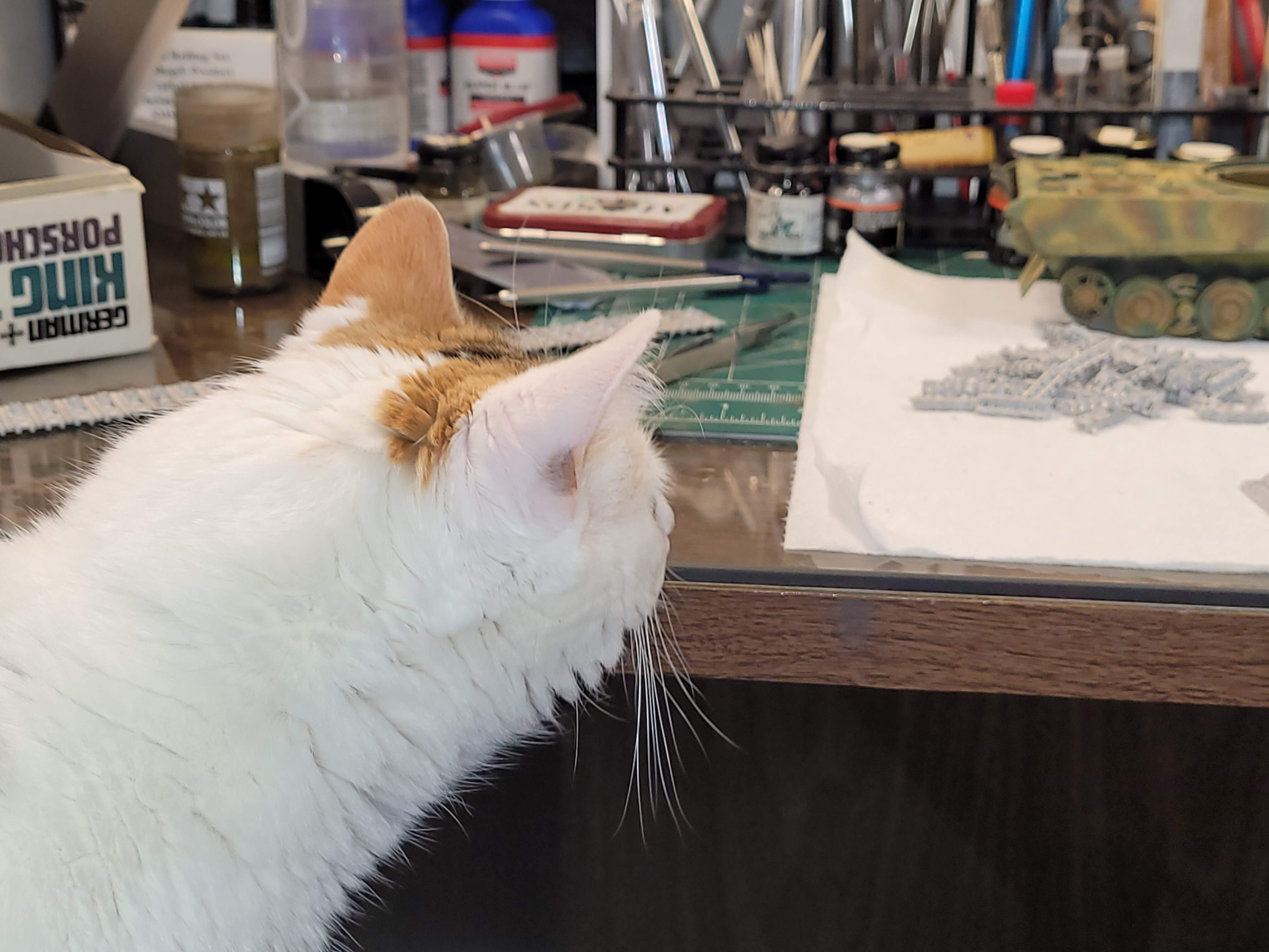

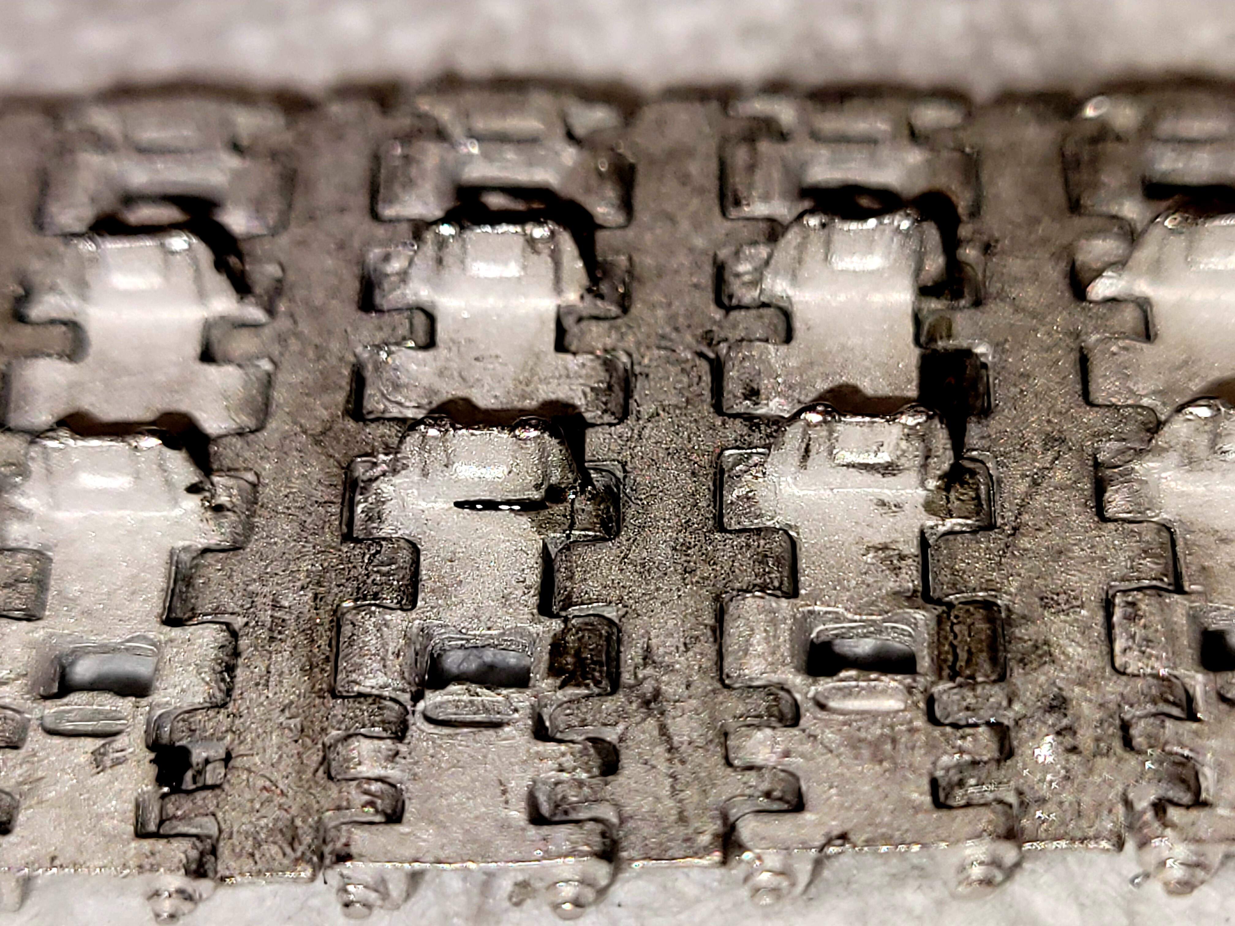

The tracks had a very heavy coating of mold release agent. It may have been silicon spray etc but I looked like thirty some year old Pam nonstick cooking spray. In anycase, it proved hard to remove with a simple wash that usually works.
Kali Kat offered use of her table and Ultrasonic cleaner.
Don’t do this disclaimer! Responsibility is entirely yours if warning is disregarded.
Used gloves, safety glasses and outside ventilation etc. Safety is critical!
Cleaned up an old seasoning jar and filled it with MEK. The lid was above water level in the ultrasonic cleaner and sealed tightly. The Ultrasonic waves penetrate the glass jar and create bubbles inside cleaning what ever is in the jar. Naturally the tracks were in the jar.
Two eight minute cycles for each track and they were free of mold release. The tracks were left outside and dried in open air ventilation.
Kali settled in for a nap while I cleaned track links.
The jar sealed well enough the MEK can be saved in a secure location and used again for cleaning additional tracks if needed.

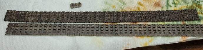

The tracks didn’t develop much in of the patina that looks so nice with Birchwood Casey burnishing fluid. I think they were a little too clean and this inhibited the rust effect. I probably should have only cleaned for one cycle of Ultrasonic cleaning instead of two.
After a thin wash of Floquil RR - Antique Bronze.
They still need a few more tweaks.
They did blacken nicely with very few spots that didn’t react.

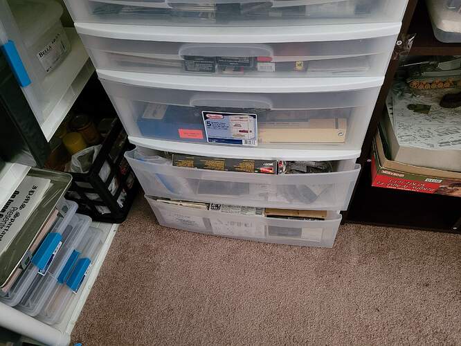

Took a few pictures along the way during the quest to retrieve those old Friulmodellismo tracks from the Imperial vault…
images (10)
images (11)
Second door to the left after Smaug
Old Skool :slight_smile:
Hey! An archeological dig in progress. I bet you could carbon date some of that.
Without a doubt carbon dating would be handy for these fossils :slight_smile:

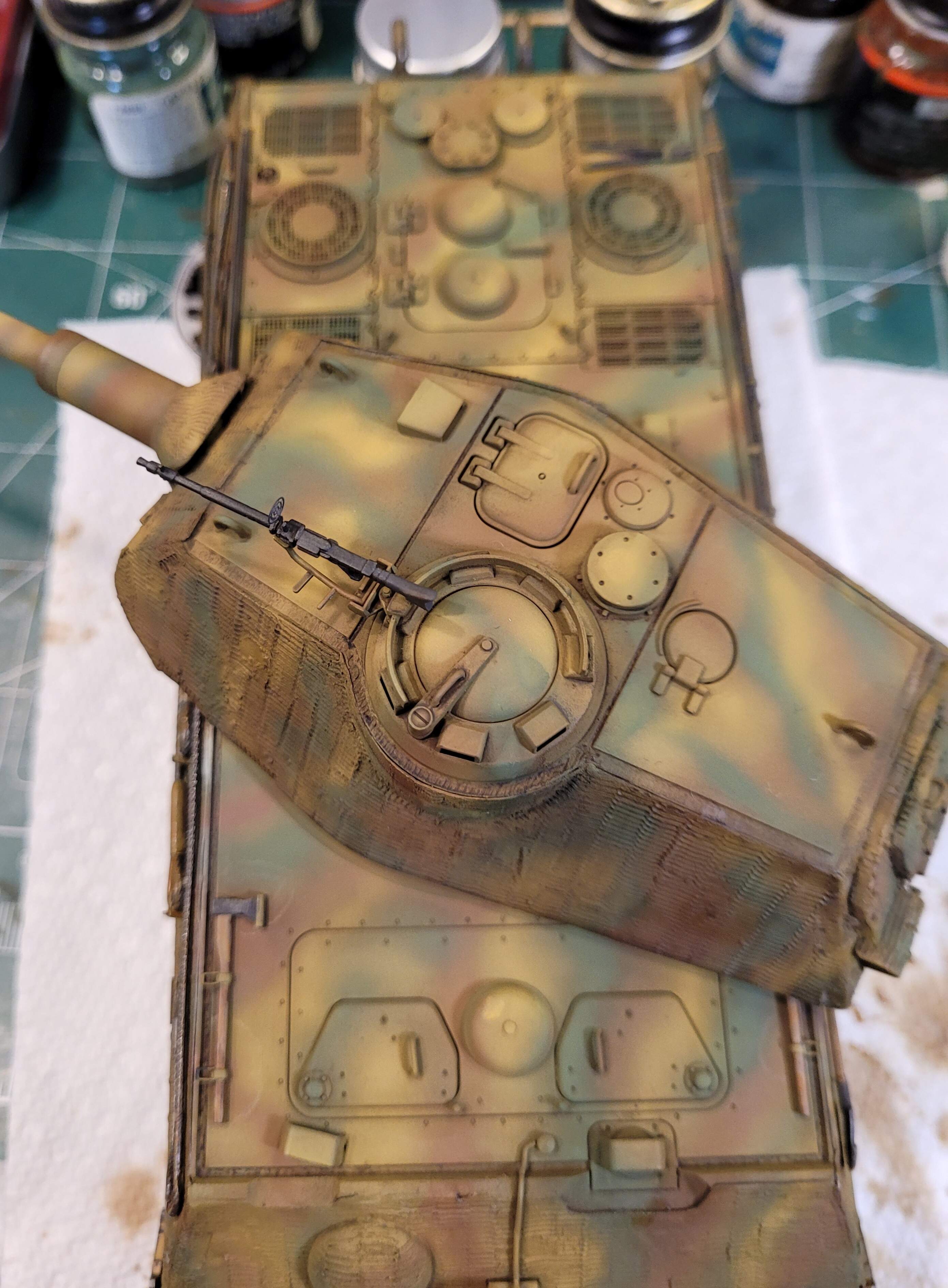

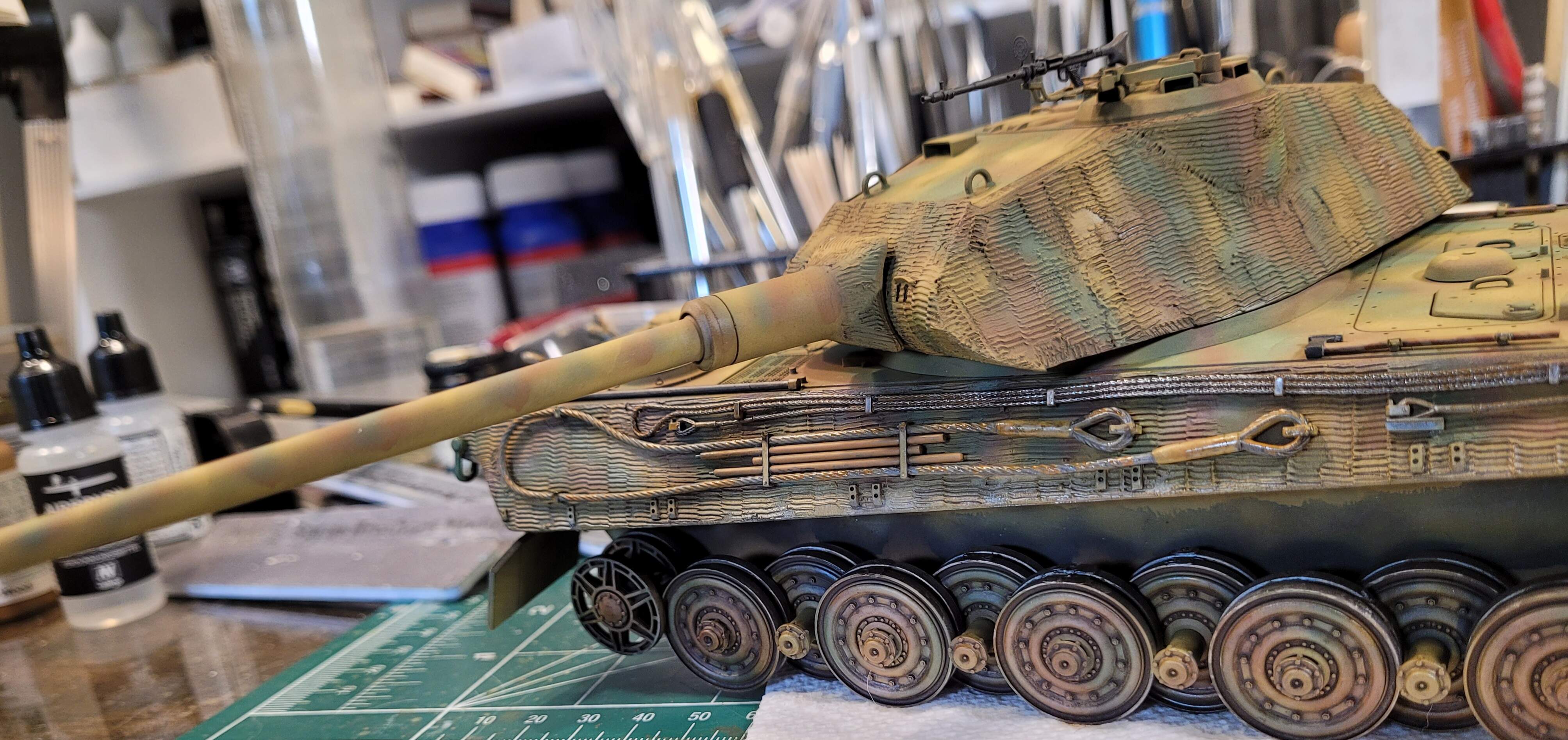

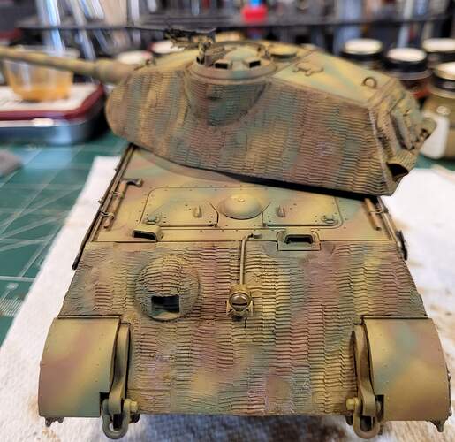

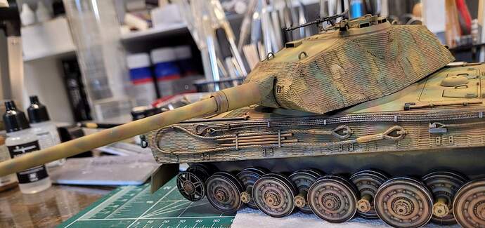

Grinding away on the old KT …age plus moving several times…seems to have taken its toll on this old Shelf Queen…
Side skirts were lost along with the kit tracks, one U towing bolt missing, replaced with one from a collectible DML Tiger 1 kit with 3 sets of them, two broken mud flaps, one broken torsion arm, two Tamiya aftermarket tracks replaced…any here’s where the PKT sits…

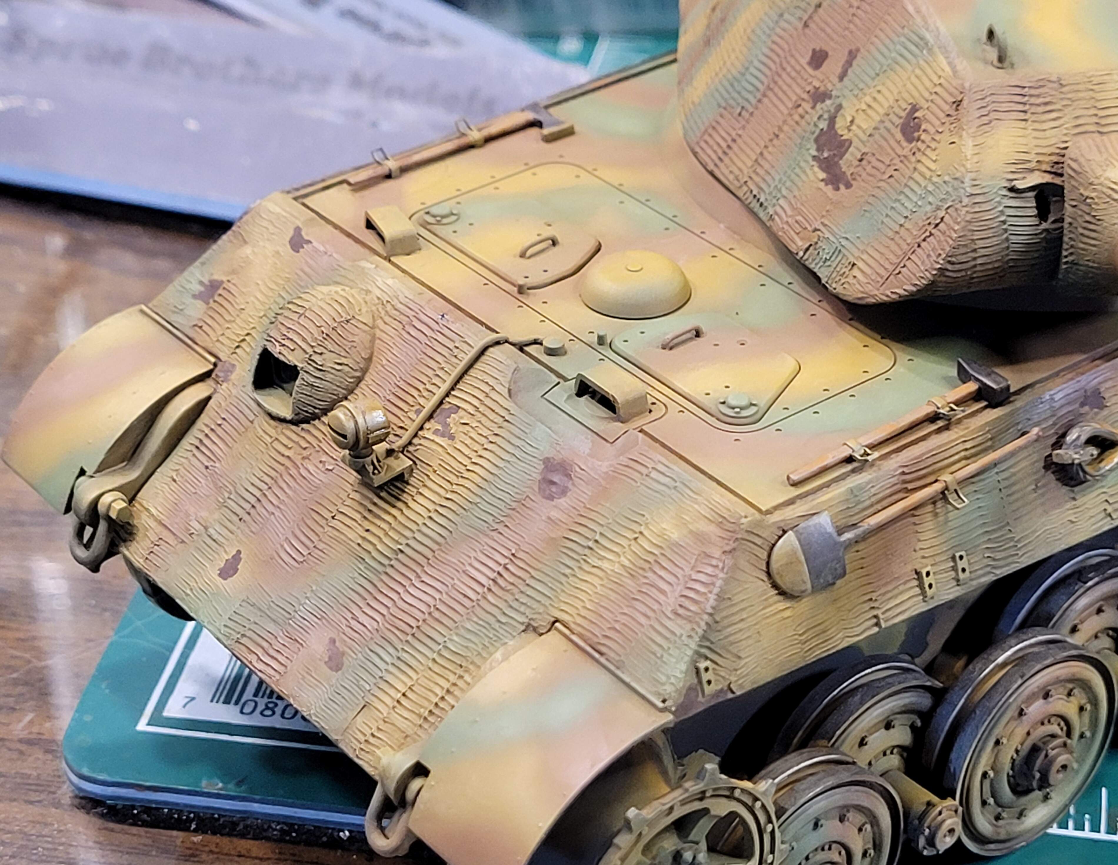

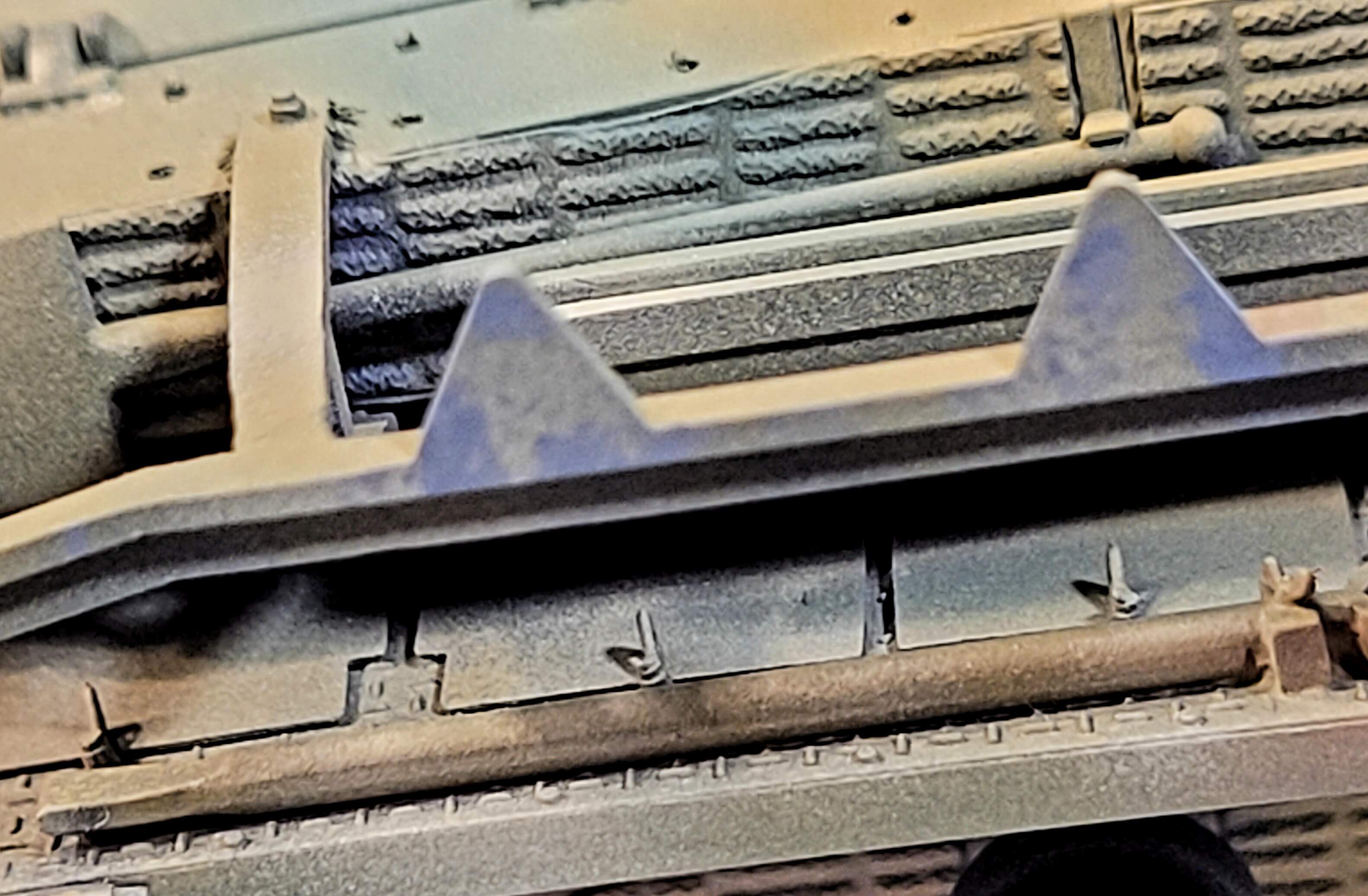

More dry brushing. Added red oxide primer chips to Zimmerit. Cavalier did a nice job on the King Tiger resin Zimmerit sheet. Not sure if Cavalier is still around.
One more round of drybrushing to go then its touch up time.
Last I heard, they were not. If someone has more up to date info, please let us know. I liked their stuff. It looks great, like here!

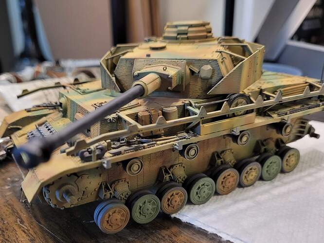

Question if I may? Being a nob military modeler and currently building an RFM iv J I noticed the 4 top rollers on you J. How many J’s had 4 return rollers?
bruce
@BGT Bruce,
The the early J’s and middle J’s (to my way of thinking)had four return rollers.
Officially, 3 return roller start date was December 1944. Roughly 650 to 700 Pz IV J’s were manufactured with 3 return rollers. I think of it as a late/final production model feature generally speaking.
Craig Ellis’s book, Pz IV at the front Volume 4 mid-late Ausf G, H and J has excellent info on this sort of detail. There’s a nice chart that gives specific list of when changes occured month by month. Excellent book, highly recommended.
Thanks. I just had in my mind that all Js had just the 3.
Bruce

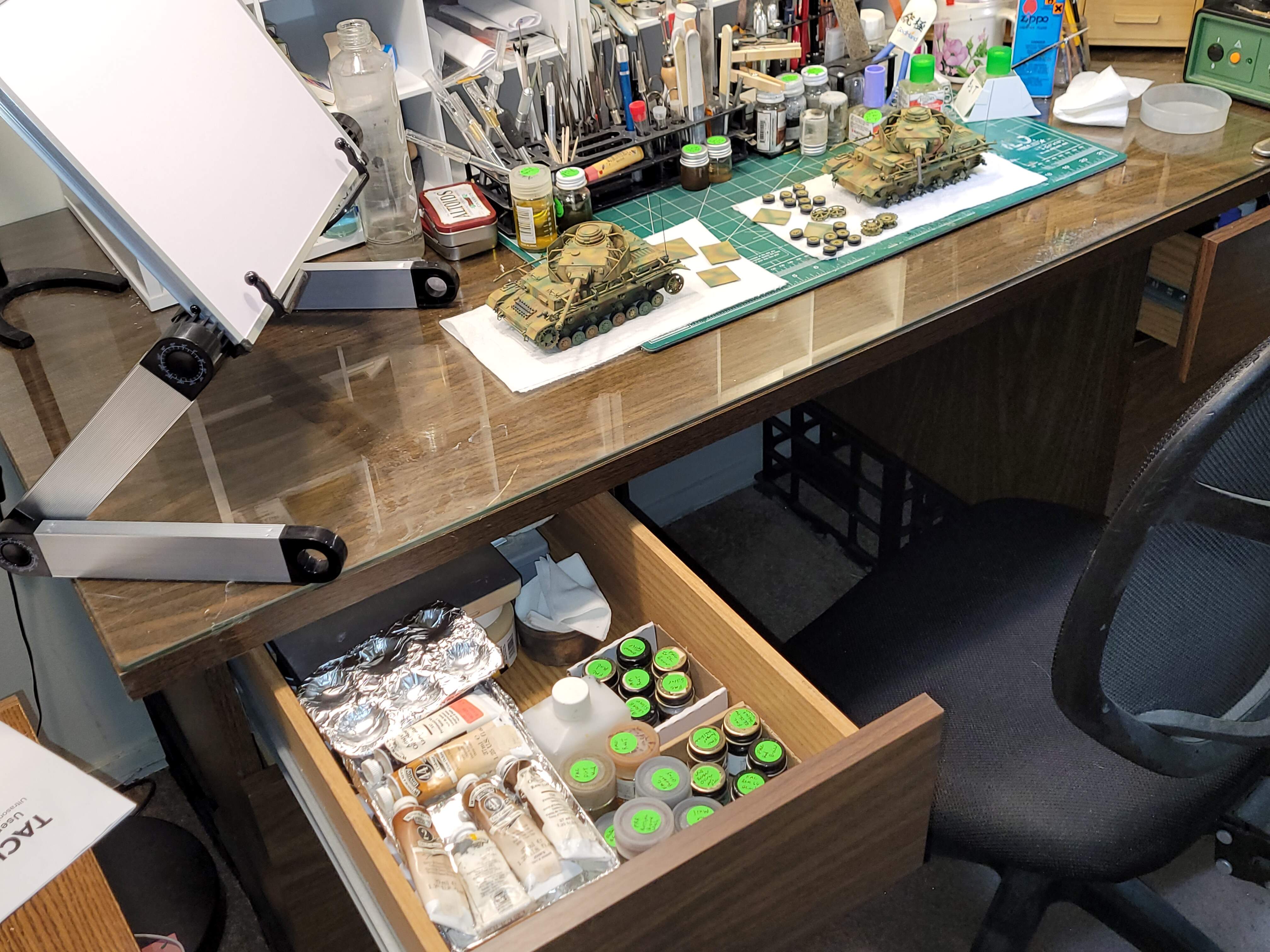

I had to wrap the guinea pig :pig2: before continuing regularly scheduled Pz IV programming :slight_smile:
While cleaning up the hobby desk and organizing after the King Tiger project, I decided work on the H & J concurrently.

Minor Update - working on detail painting. Painting the attached tools was very quick and easy on the King Tiger, on the Pz IV’s its slower due to more items and a little more difficult.
For the Pz IV J, I decided it needed a black lacquer main gun as well. Detail wise, still have the fire extinguisher & wire cutters remaining plus touch ups.
