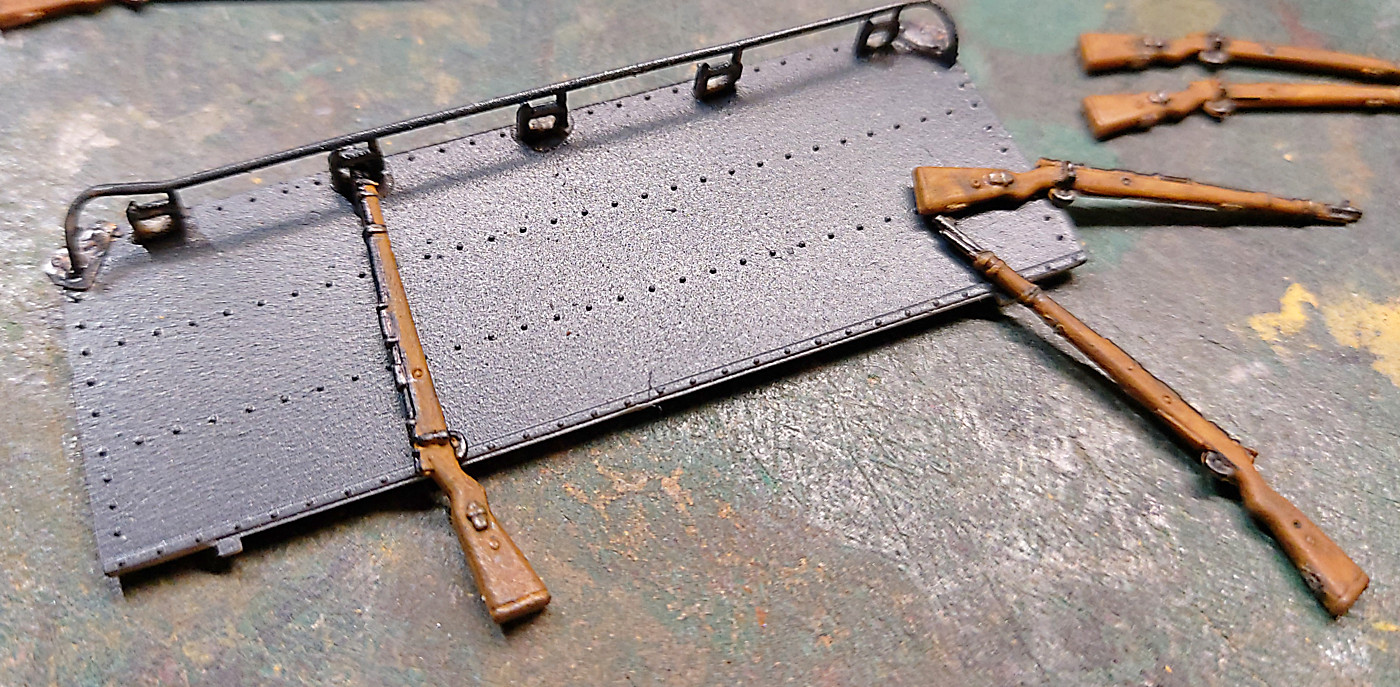

Thanks. It helps. I think my issue is that the Trumpeter parts are too large, hole too small, and will need to be filed down. The rifles simply wont go through the molded part. See image.
bruce
The molding process probably didn’t allow the proper dimensions so the designers had to choose:
  1. right size hole → outside is too big
  2. right sized outsides → material thickness makes the hole too small
Compare the relative sizes of the outer dimensions and the metal thickness on this:
compared to the Trumpeter parts
I suspect that there wasn’t much free space in the 1:1 clasp either.
Why bother designing a clasp if the rifle can be inserted/removed without opening the clasp …

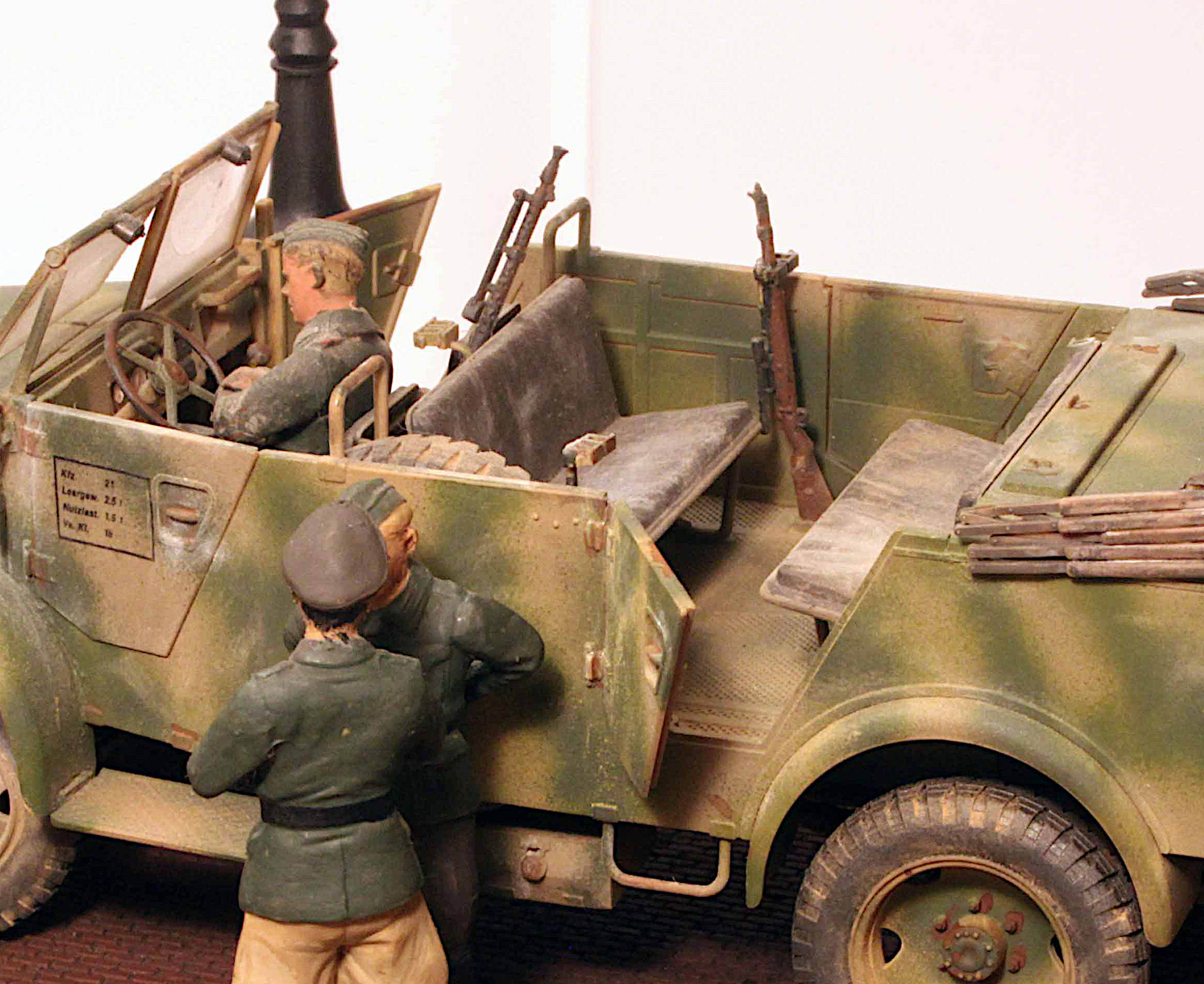

Sd.Kfz. 7 at Jacques Littlefield collection
This might help Bruce:
From the Aber Steyr kit I am building:

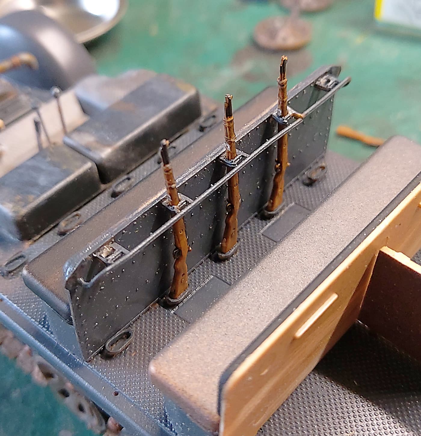

Thanks guys. I found a solution. I used a bigger hammer. Nah what I did was cut the back of the clamp, the part against the seat back. Then force the rifle through the hole. This has to be done hard enough to open up the hole without breaking it.
petbat they look the part. In hindsight because the rifles are so prominent the clamps need to be better than what is in the kit. ‘Next time’ I’ll use after market parts. Take note if you are considering this kit.
The image below shows a dry fit and how the gun clamps are very ‘chunky’.
