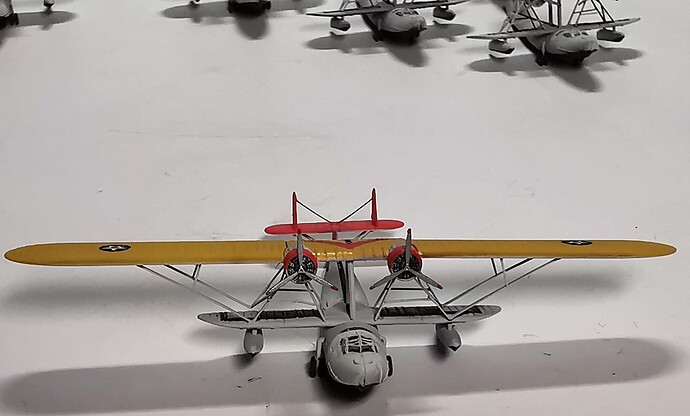

Guys, I am glad I can report that Langley´s airwing is finally finished :innocent: : I can tell you it felt for me as I am finished 12 planes in 1:72 scale simultaneuosly so I can tell you my next project will not be an aircraft carrier…
This is the final result after removing of all mask, painting the cockpit details, the propellers and the black bows:
and finally some zoomed pics of the one aircraft with complete wings
I am very satisfied what I achieved with these small planes. Now I just have to attach the stored dismantled wings and finally all the aircrafts to Langley´s flightdeck :innocent:
Thomas

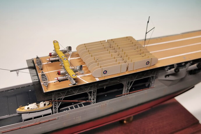

Not much left to do now… I made an underconstruction out of evergreen for the dismantled wings and glued the wings evenly onto it. The fixing belts were made out of thinly cutted masking tape, painted in vallejo 332
next comes finally the aircraft on their final resting place :innocent:

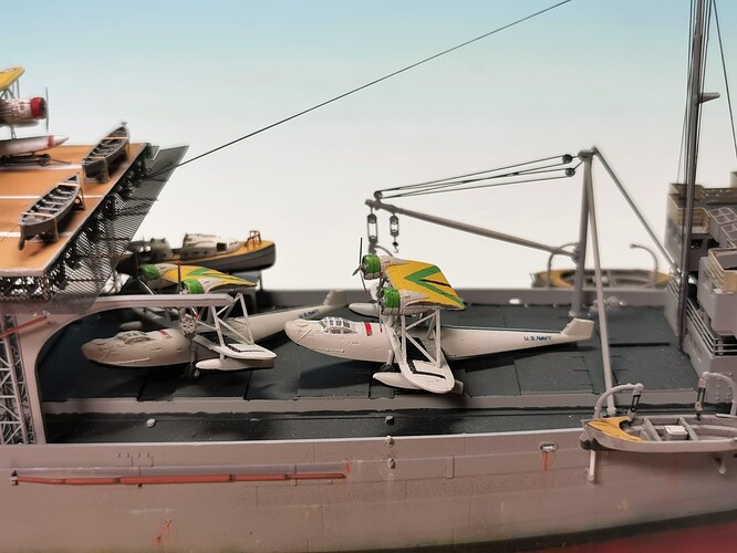

Finally crossed the finish line and commissioned my USS Langley today. I think this (and maybe my heavy cruiser Zara) is the biggest ship so far I have accomplished. It was a demanding build with that much etched and extra 3D-printed parts and extra planes but in the end it paid off and I am extremely proud of the outcome of this “little” kit. I like the colorful look of the whole and enjoy looking at the details.
Building the kit without all this extra would let down the whole enterprise as the girders would look toyish and with just the six Consolidated P2Y planes provided inside the kit the deck would look sparsely. If you really like something different out of the “usual” grey fleet and are prepared to add some ellbow grease and upgrade parts than you can add a stunning model into your showroom stash!
But enough talking - these are the final pictures:
I would like to thank you all who watched my build and stayed along my side with good advices, very useful pictures and constructive comments. You all kept my Mojo high (I needed your support at the end when I had to finish all these tiny aircrafts…). I hope I have not dissappointed your expectations :blush:
