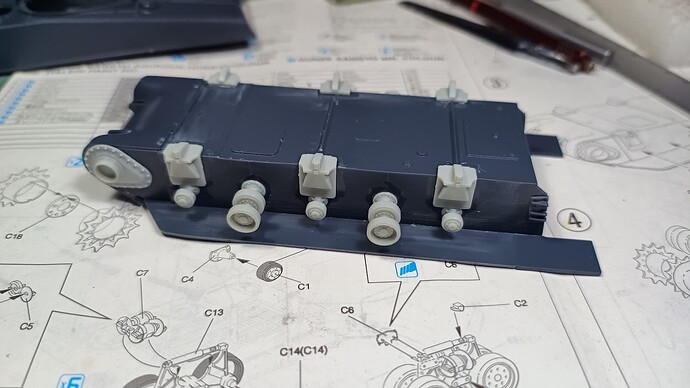

I have had various Dragon Sherman kits in stock (purchased at very low price, less than 10 euros each). Most of them are their very early releases, with lots of issues. I decided to work with those and try to detail them and improve whatever possible as a learning curve, studying the details missing.
First couple of kits are Korean War themes:
I got Eduard photoetch sets that include the fenders too
I do not know if I will build the flame thrower as is or turn it into a 76mm turret tank using another turret yet.
Work started with converting the lower hull for the HVSS suspension. Nuts and bolts and details will be added as I am looking into reference and photos.
