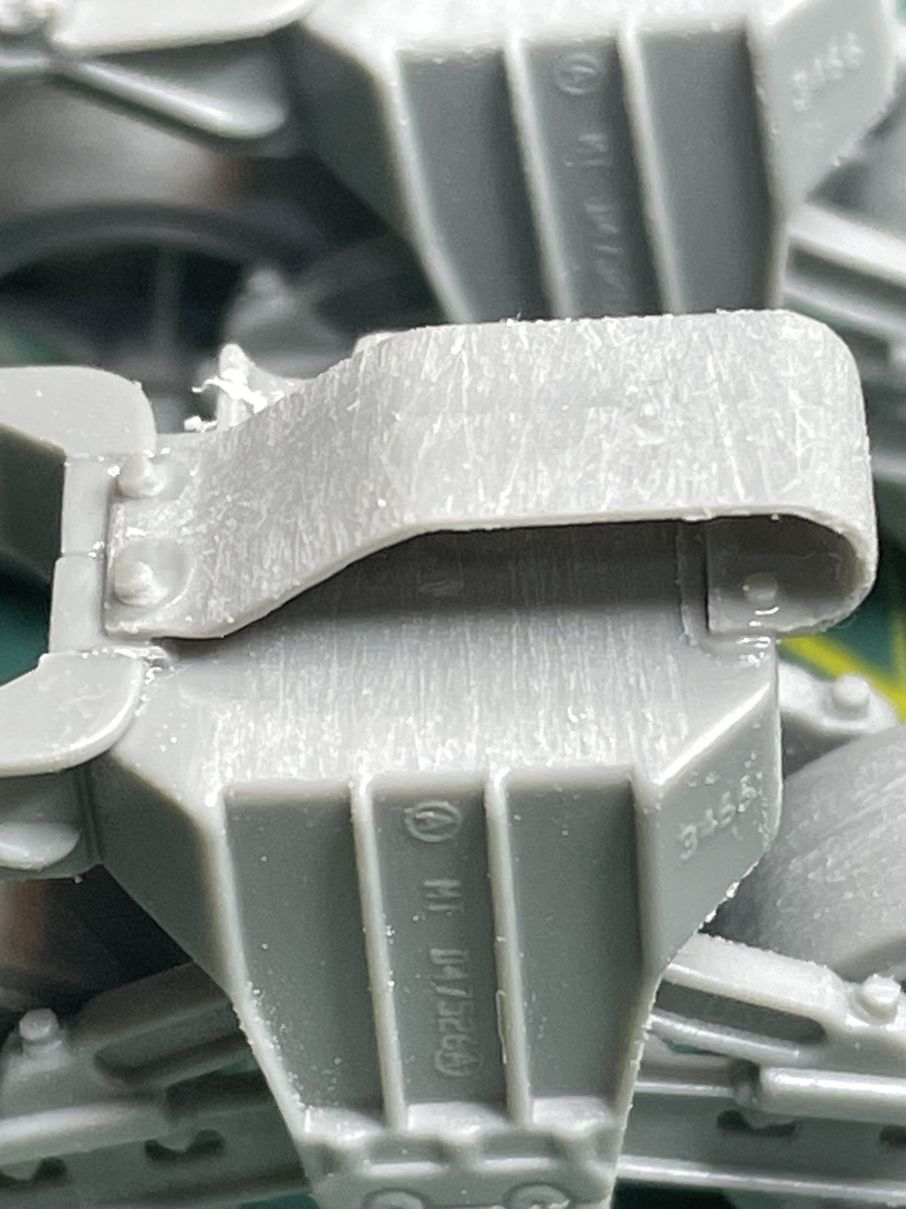

It is a basic kit, I like that I do not have to remove things, just to add detail and texture. I need to source foundry markings and numbers if I can.

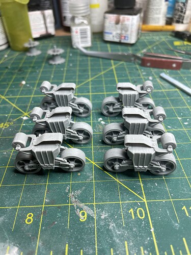

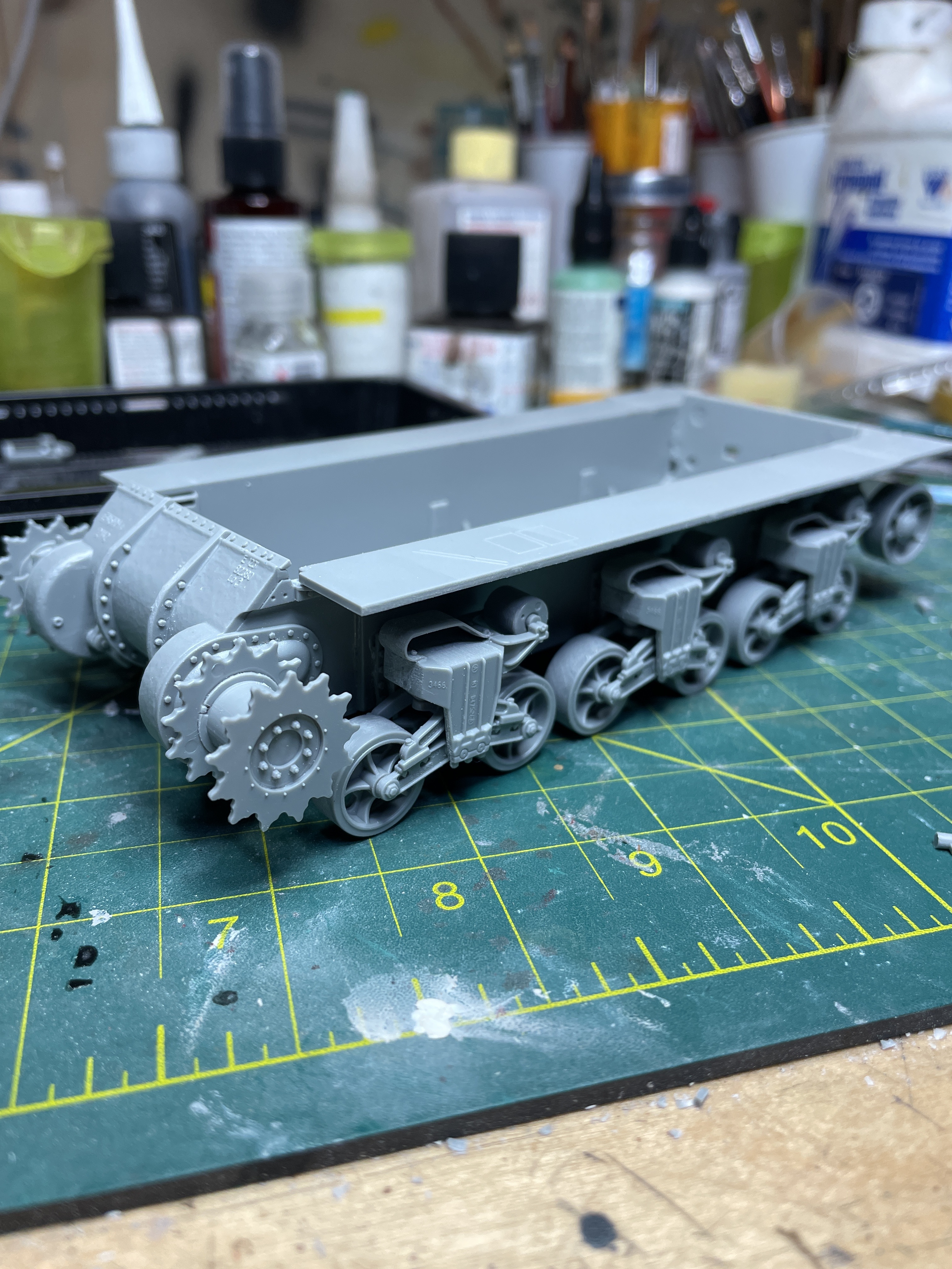

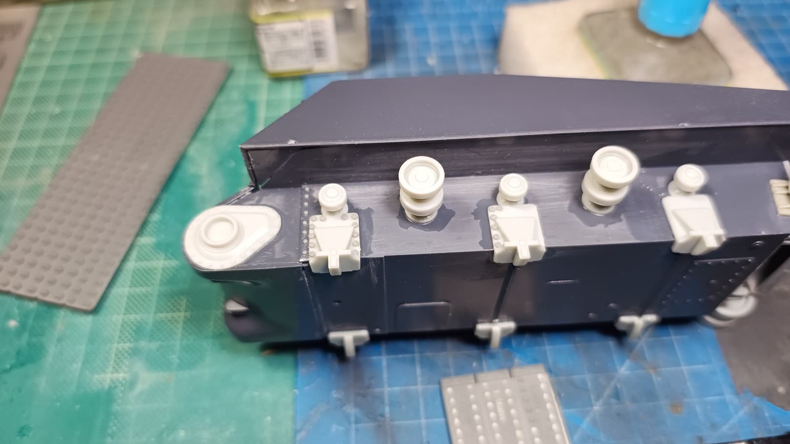

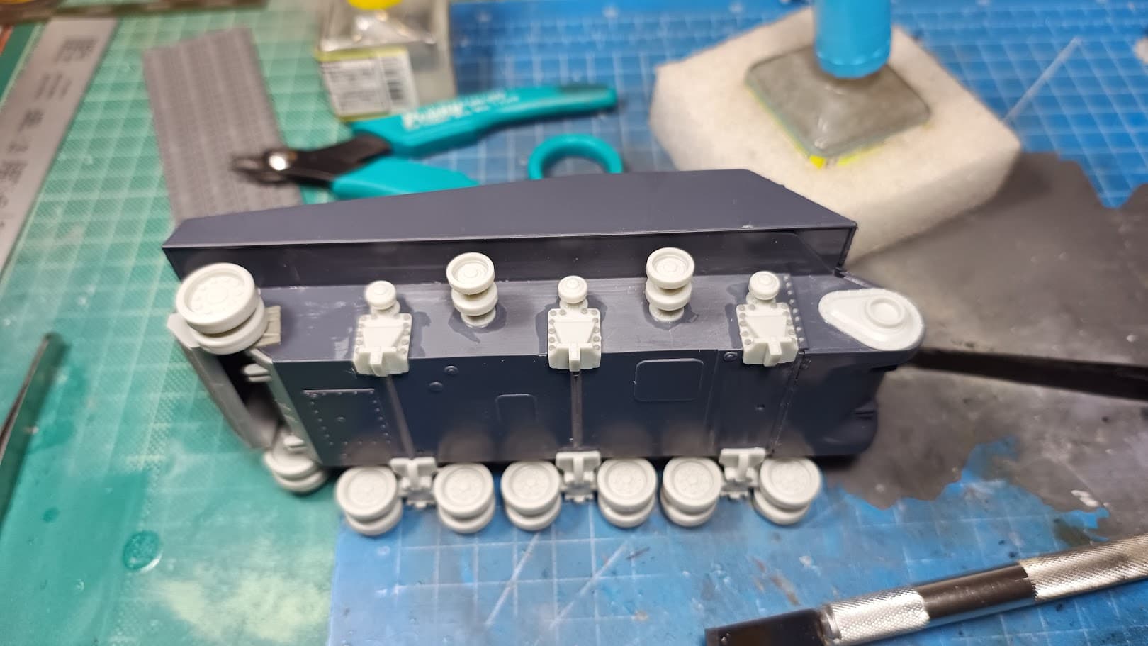

Finished up the bogies for my Sherman III. The track skids are a bit thick and needed to be thinned down. Also, there are bolts available on the sprue for the skids even though they are not mentioned in the instructions.

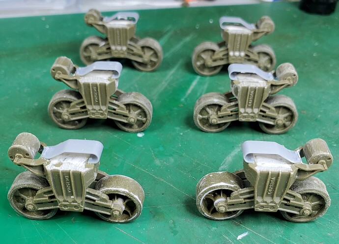

How odd you finished your bogies about the same time I pretty much finished…and ready for paint. I added aftermarket skid plate from ARTO from South Korea, where the bolts have the safety wire detailed. All road wheels are Asuka and/or Panzer Art since the Tamiya ones are junk. The first two bogies in my pic are photo referenced to having two different road wheels. All in all, great job you’ve done!

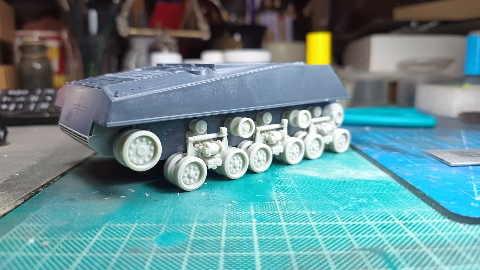

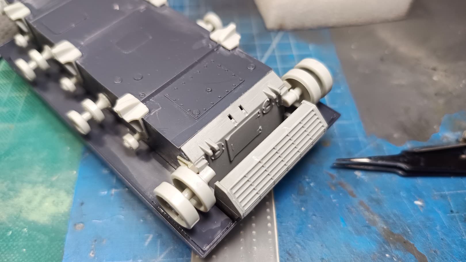

Some details added to the suspension
The rear plate is a left over from another build, it was way better than the kit one. The same goes for the exhaust deflector.

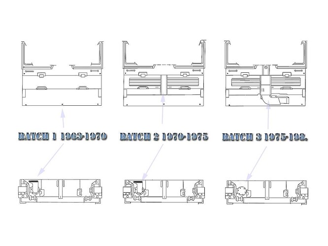

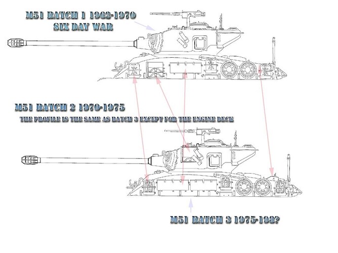

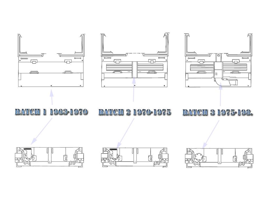

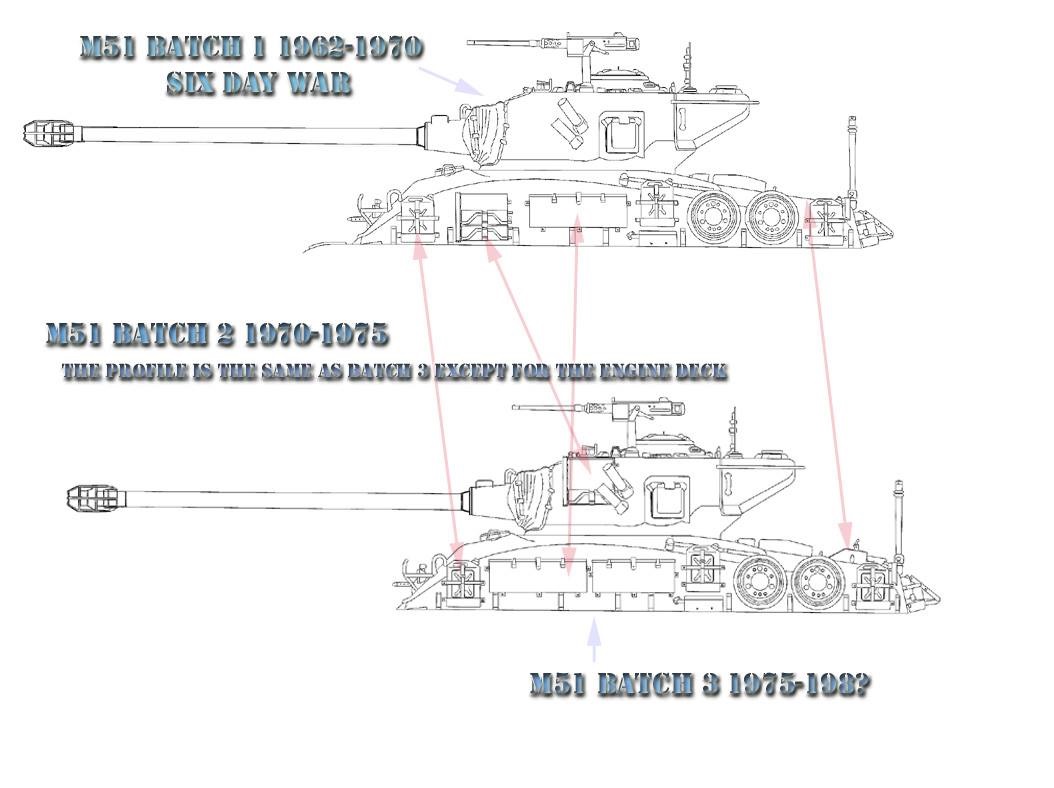

Nice choice, Erik! I make no claims to being a Sherman expert, but I’ve done some reading on the M51 and. since you asked, I will point out one big detail issue with the Dragon kit. If you want to do a Six Day War M51, the engine deck and exhaust are incorrect. They are for late M51s, post 1975 I believe. In '67 the exhaust was still on the rear lower hull and not on the engine deck, nor were the louvres there. There’s an article on the M51 on the IDF Modeling site that explains it well. The pics no longer work there, but the descriptions are pretty good. Hope this helps if you decide to make the changes!

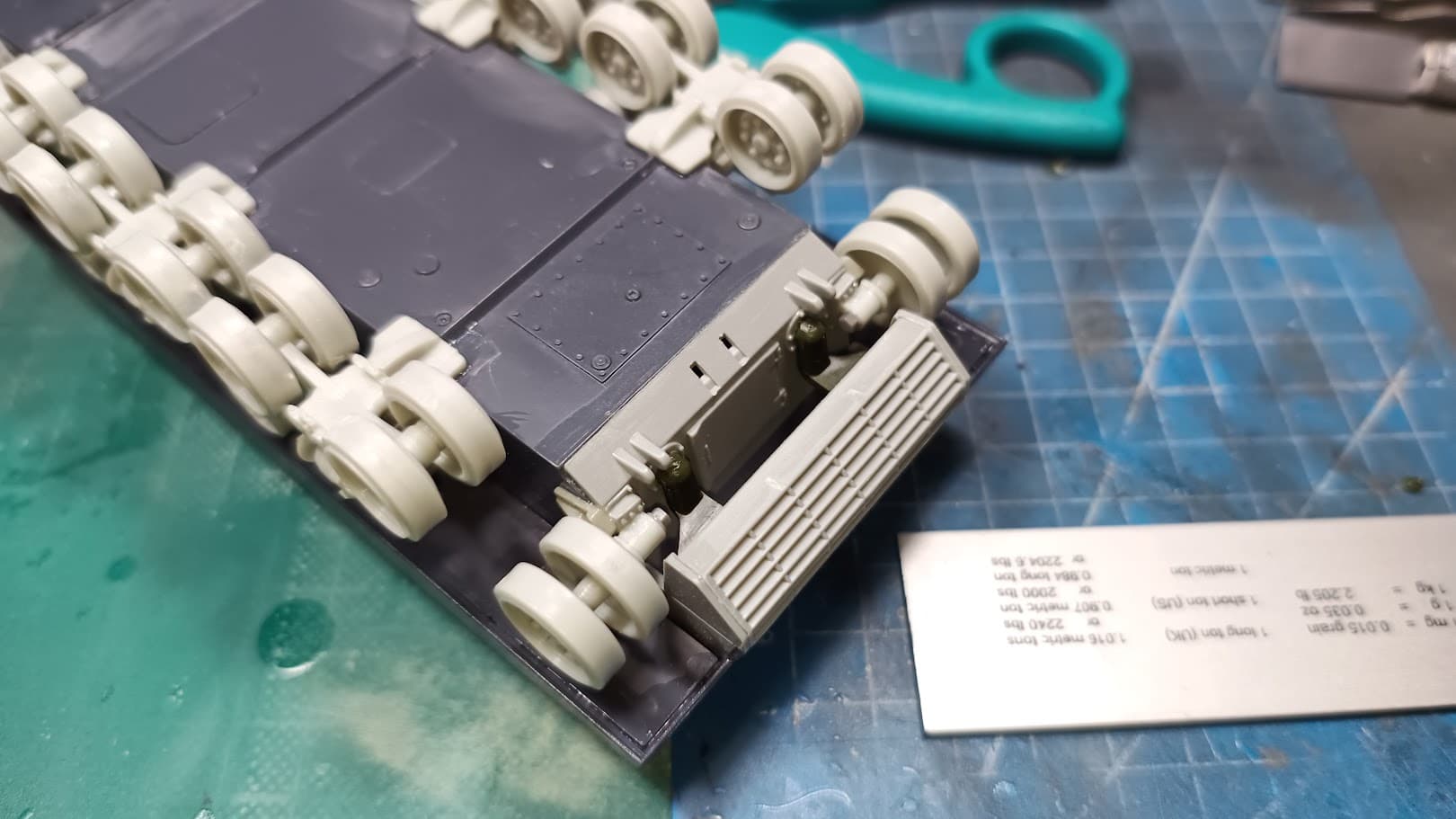

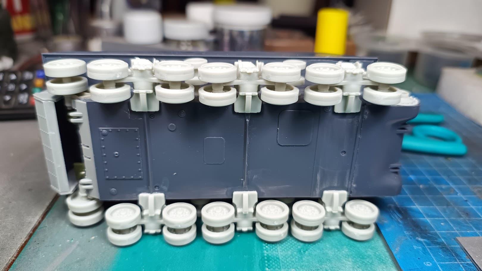

-46 here with the wind chill, so mostly staying inside, good for getting bench time in, finished off the lower hull.
