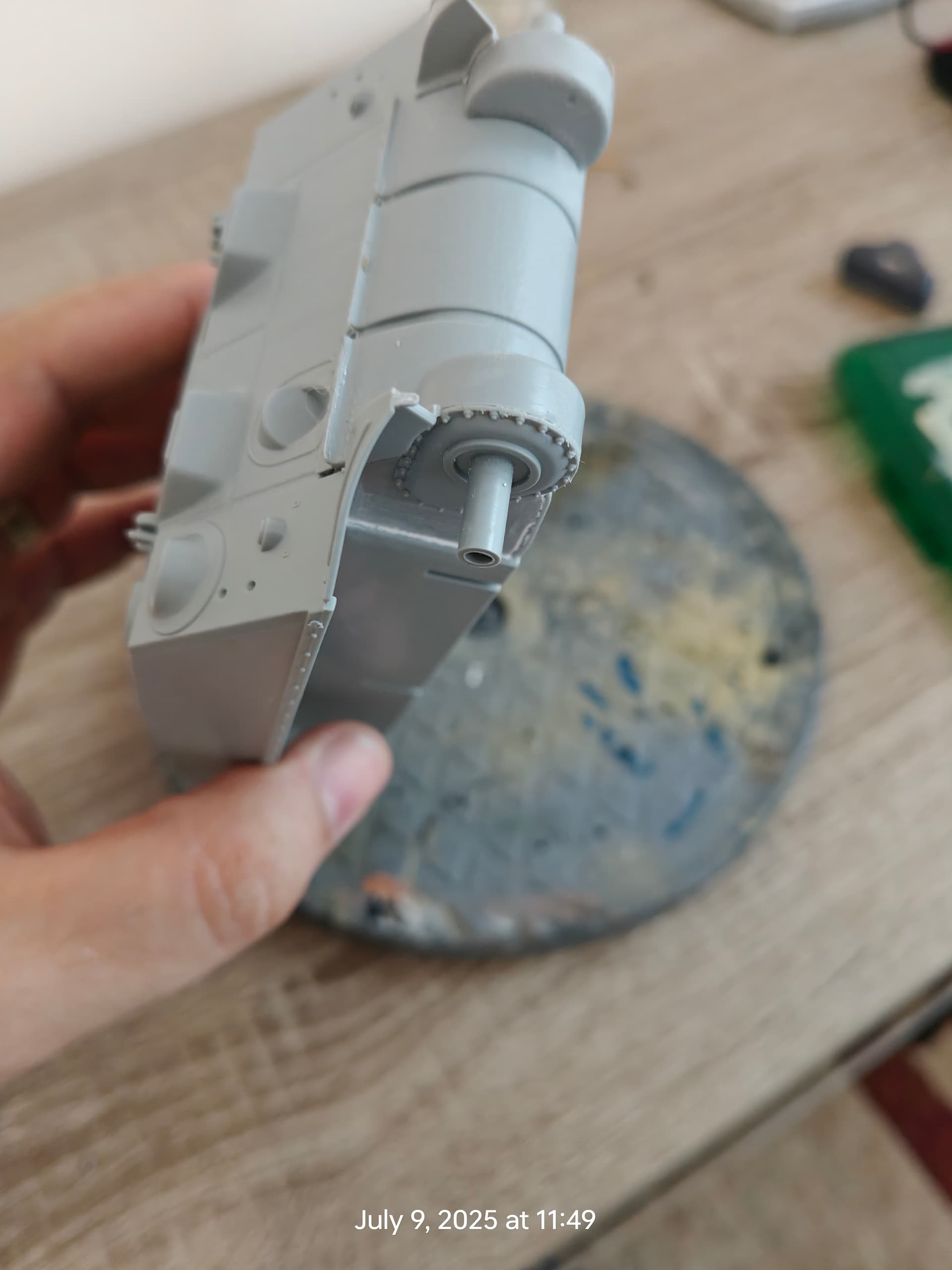

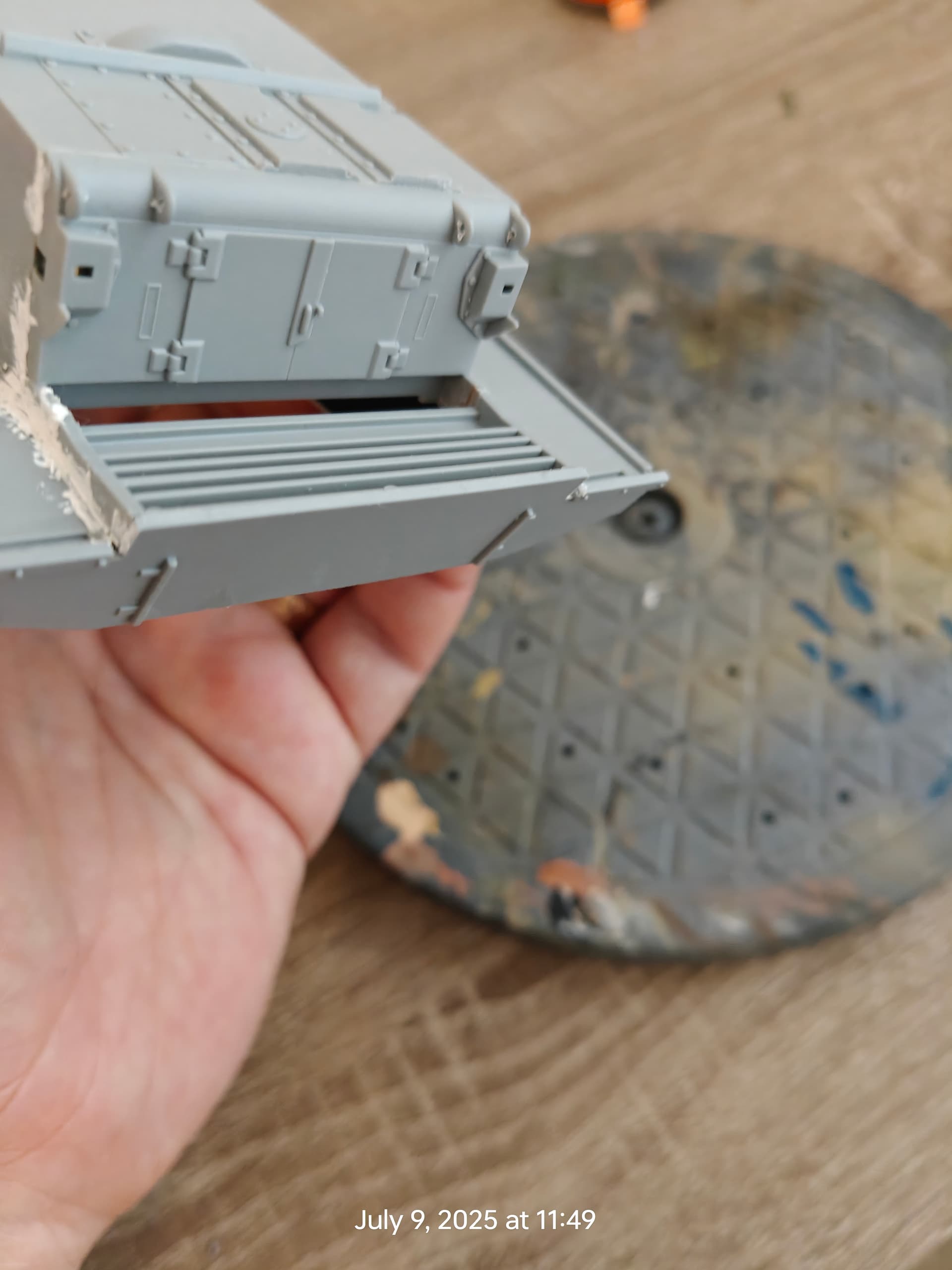

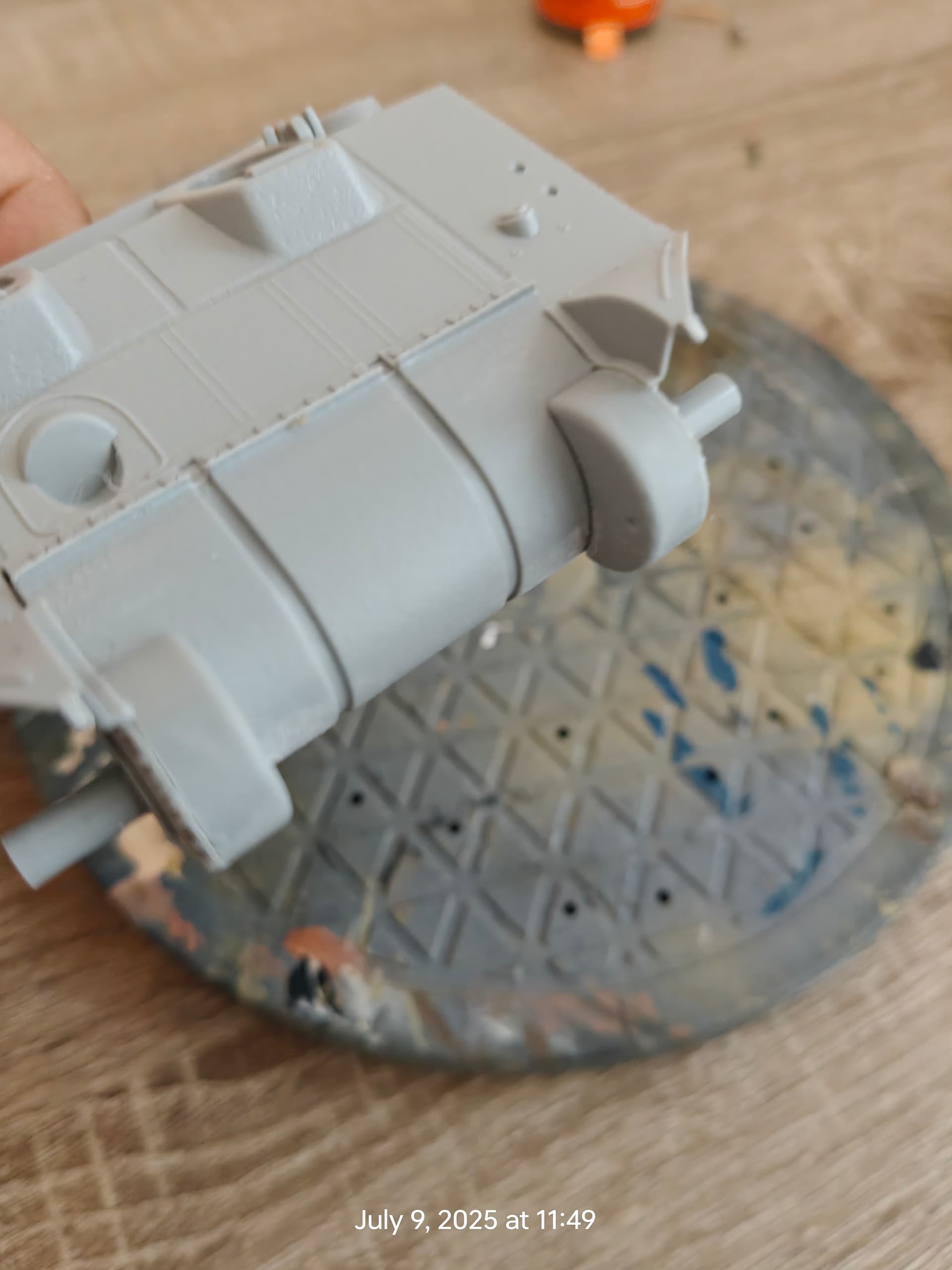

While I am very busy till mid August my idle hands put me to work.
Added the transmission and shortened the lower ith approx 5mm. Removed the forward tow shakcle mounts as they were very low and small. So I need to scratch build new ones. Also need to fill that hole in the back and to build that wedge in the color photos.
