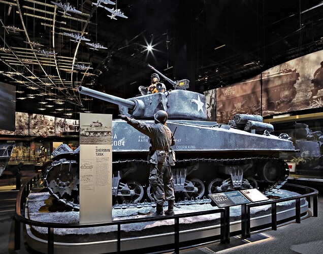

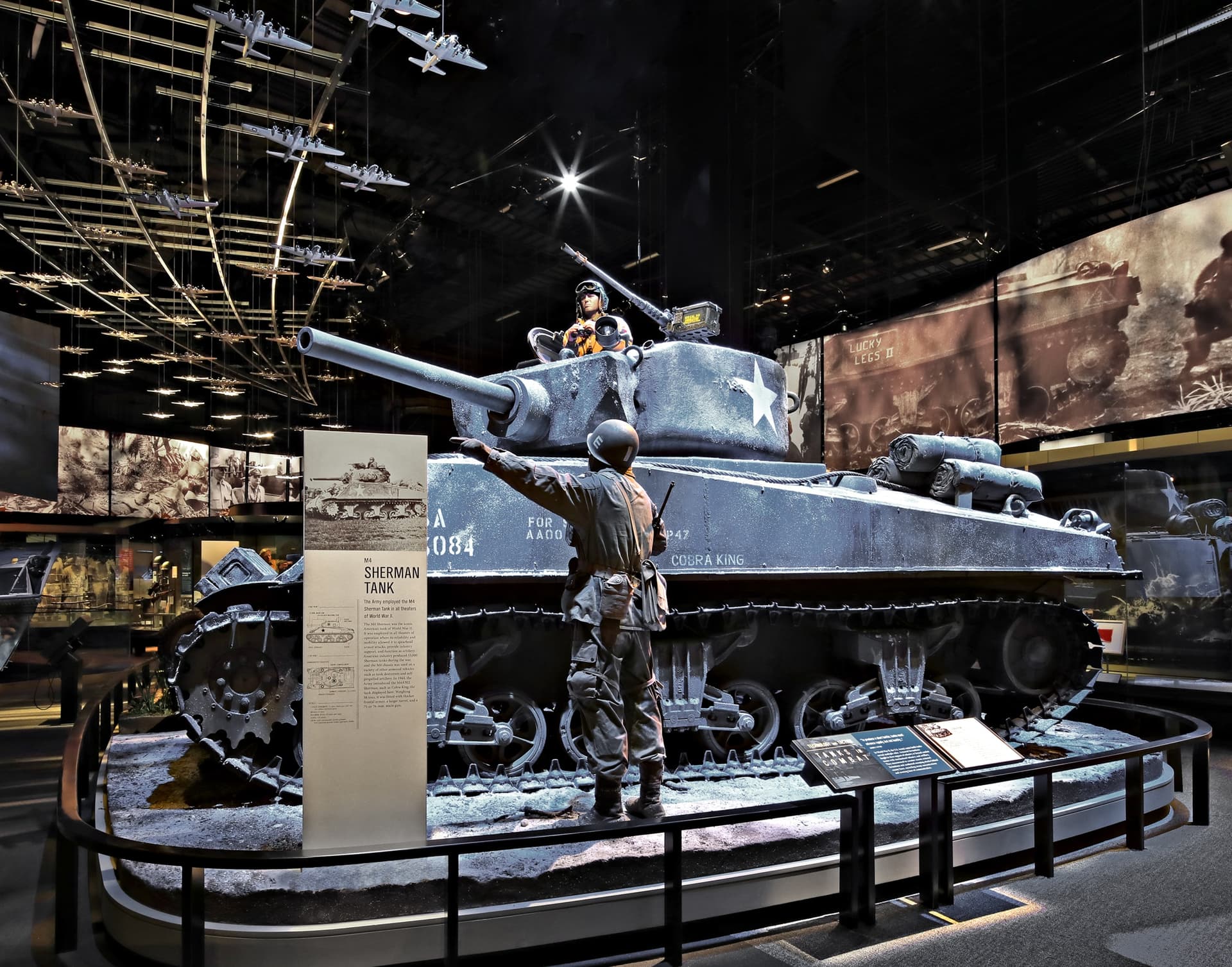

The original “Cobra King” after restoration. The tank is on display at the National Museum of the United States Army at Ft. Belvoir, Va.

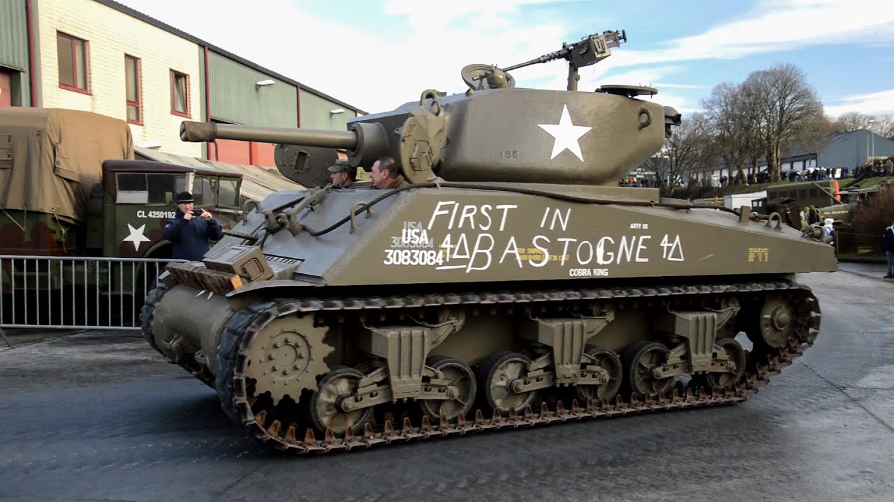

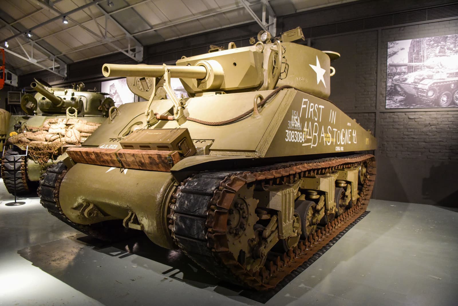

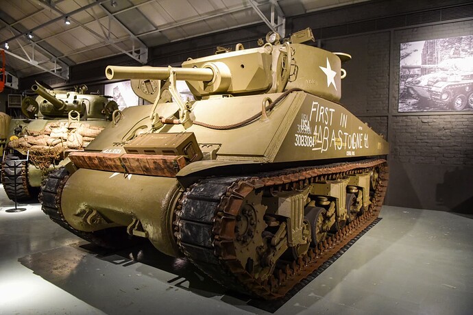

An M4A3E2 Jumbo, painted to replicate “Cobra King” as it rolled into Bastogne. On display at the Bastogne Barracks, Belgium.
Great video from our friends in Belgium, showcasing their “Cobra King”.

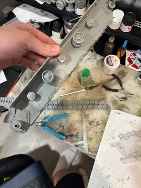

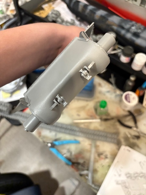

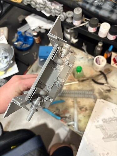

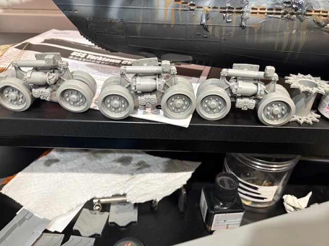

Here is my progress
I have been doing tid-bits of the model and want to finish the roadwheels today and paint the underside.
Looking solid so far. :+1:

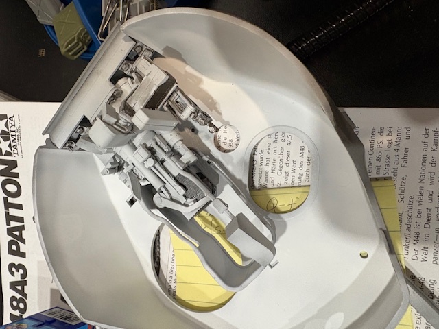

Does anybody know if there is a Sherman turret interior in 1/35?
Or an engine?
Something to hang in the M32 crane.
CMK did a turret interior.
Rye Field did an engine.

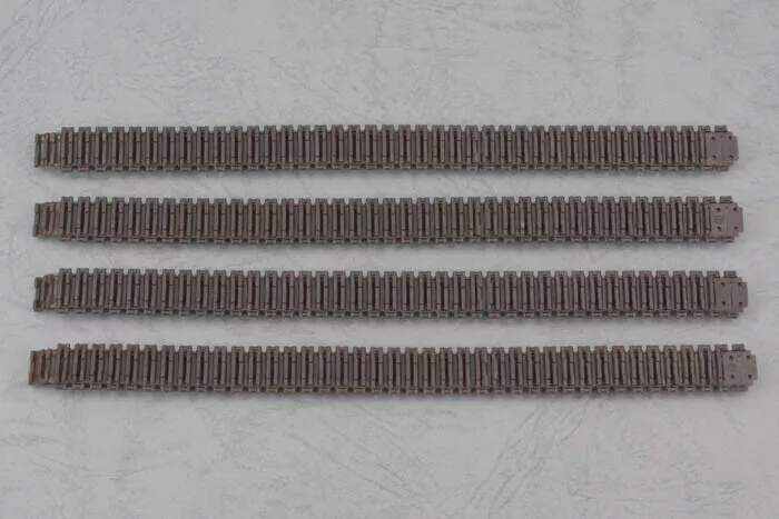

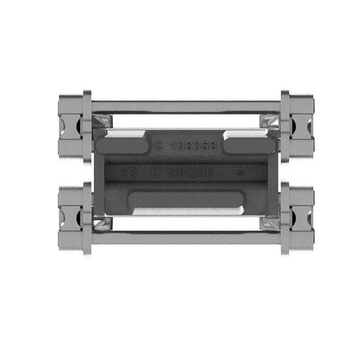

You can get the T-49 “Three Bar Cleat” tracks from Asuka.
1/35 - Tasca/Asuka - Sherman T49 " Steel Cleat" Flexible Tracks. | eBay
Or, if you don;t want to mess with “rubber band” tracks…
1/35 QuickTracks T-35074 Tracks T49 for M4 Sherman - C55592 end connector | eBay
Aside from the CMK set already mentioned, Resicast also has a Sherman interior set.
However, you would probably be a lot cheaper off buying one of the plastic kits of 76 mm Shermans with interior and using the turret from that. You can then also build just the hull as a German ARV.

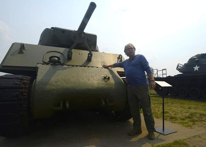

Camp Ripley’s MN Jumbo

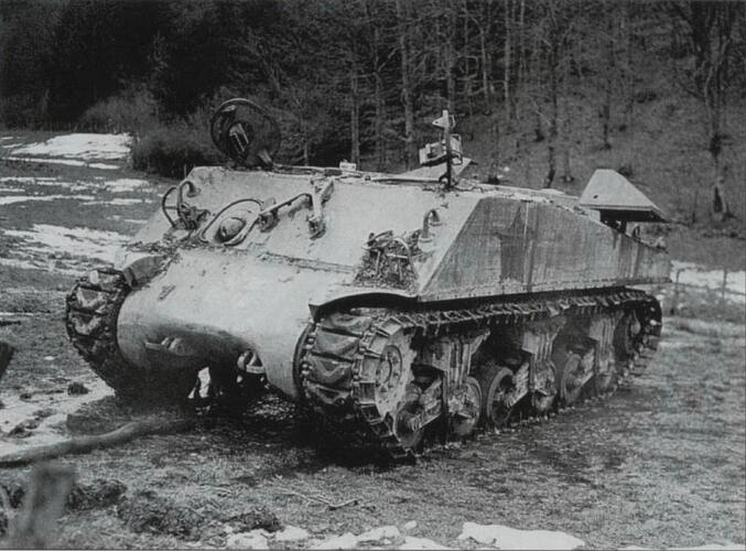

I couldn’t find a photo yesterday on a quick search, but trying again:
This is a photo of a Sherman captured by the Germans, who removed its turret (and who knows what inside) then apparently used it to tow disabled vehicles with. The picture was taken after it was recaptured by the Americans.
It’s a 75 mm, wet-stowage M4A3¹ without its turret, but who says they never used any 76 mm tanks for the same purpose? (Or: How many people will be able to tell the difference in the first place? :slight_smile:) Notice the disc wheels on most bogies.
¹ That it’s an M4A3 is clear from the open engine hatch with the big deflector on its underside. It’s obviously a large-hatch hull, but the gun travel lock is high up on the glacis, meaning it’s not a 105 mm tank. That same travel lock doesn’t stick up above the edge of the glacis, so it’s the short type fitted to 75 mm tanks, as 76 mm tanks had a taller one.

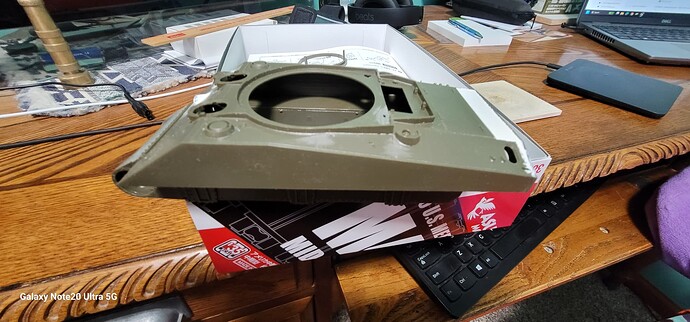

I think I have too many Tasca/Asuka Sherman kits. Will have to see how many I can get done.
I started with this one trying to convert it to an early PSC machine in North Africa. Modified hull rear with vertical rear panel, modified antenna mount on hull front and modified hull machine gun housing.
