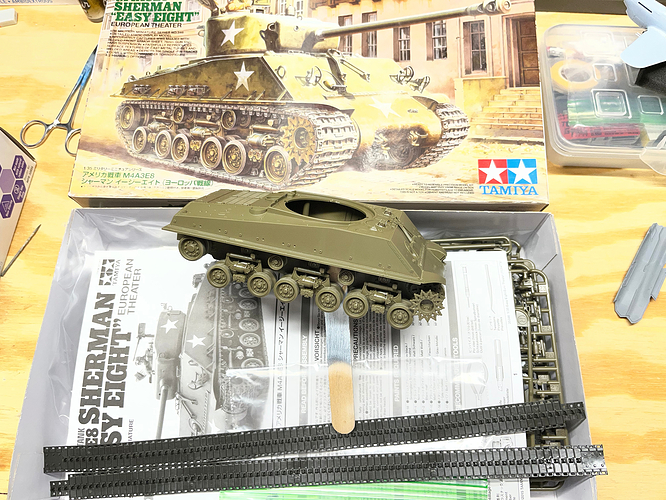

Started kits allowed? I’ve got a Tamiya M4A3E8 that I assembled up through the bogeys/running gear (unsure of the term—not an armor guy) but haven’t touched in at least a year.
if not I’ll find something else to build.

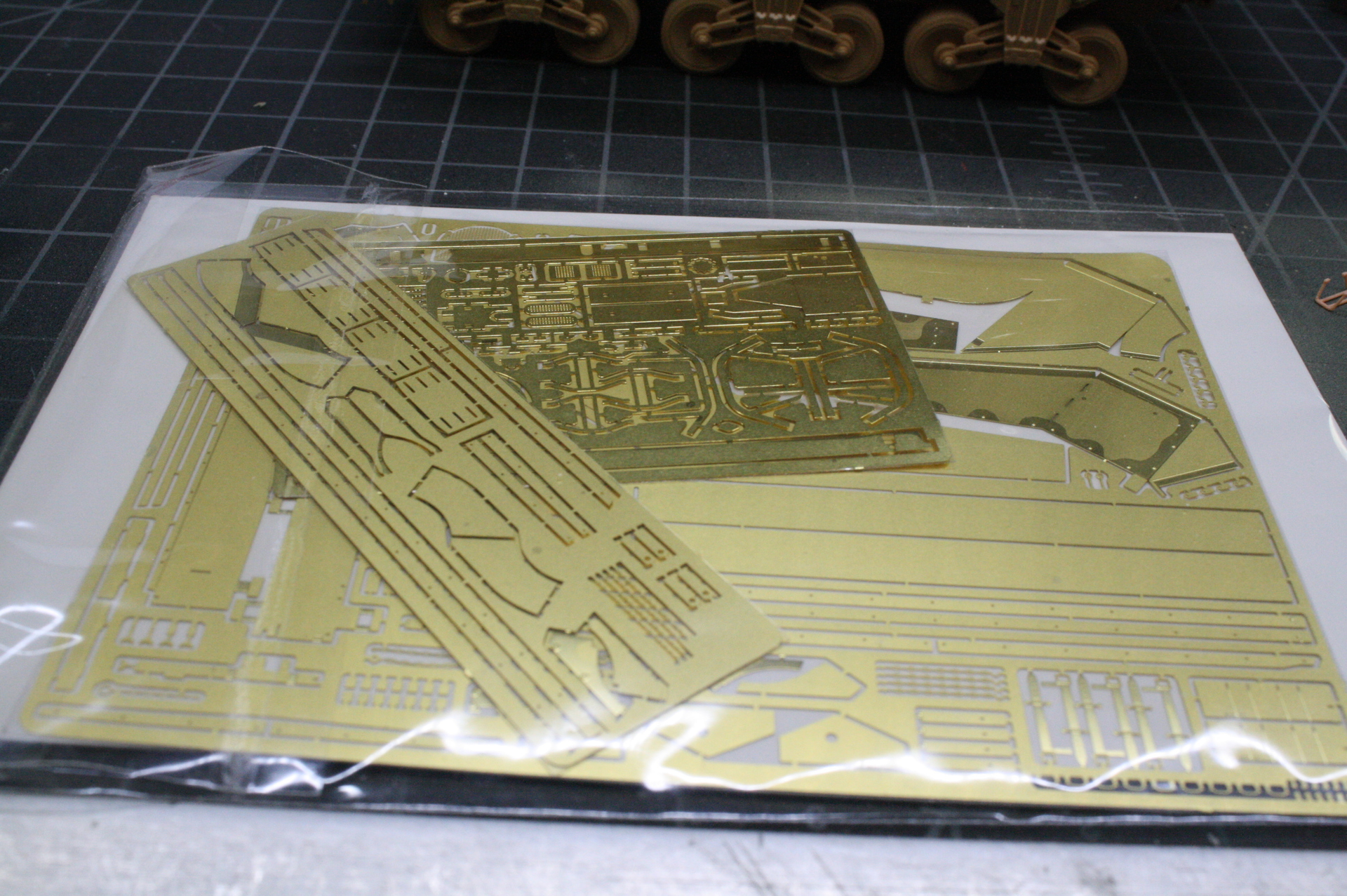

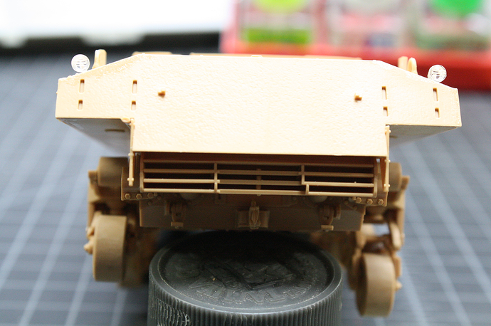

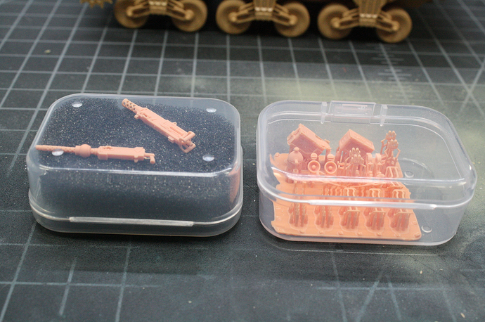

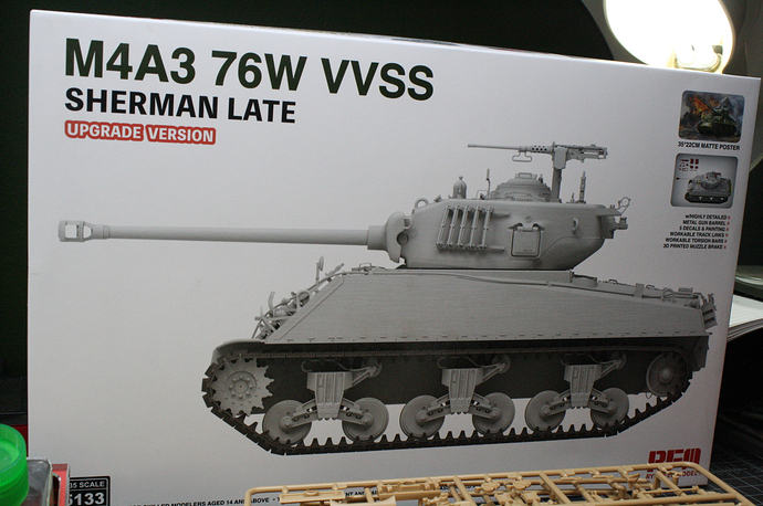

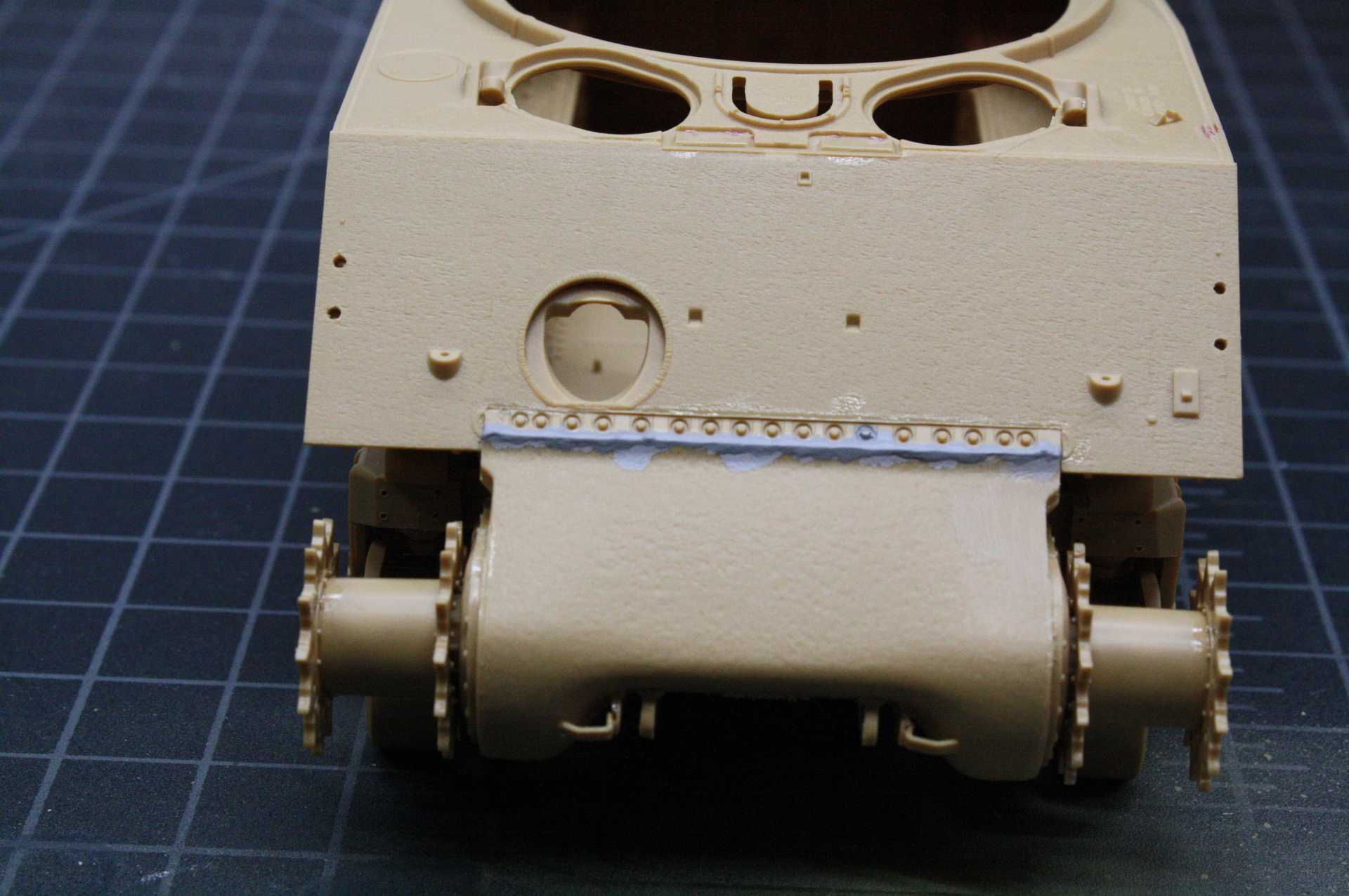

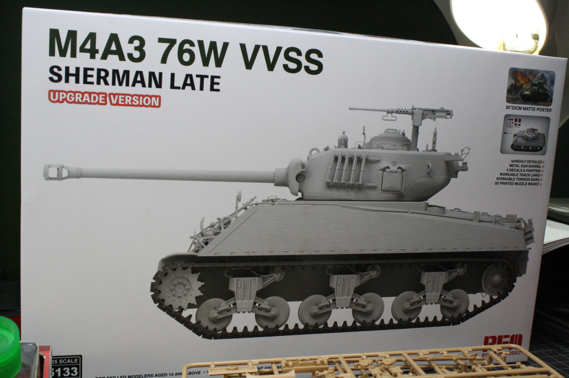

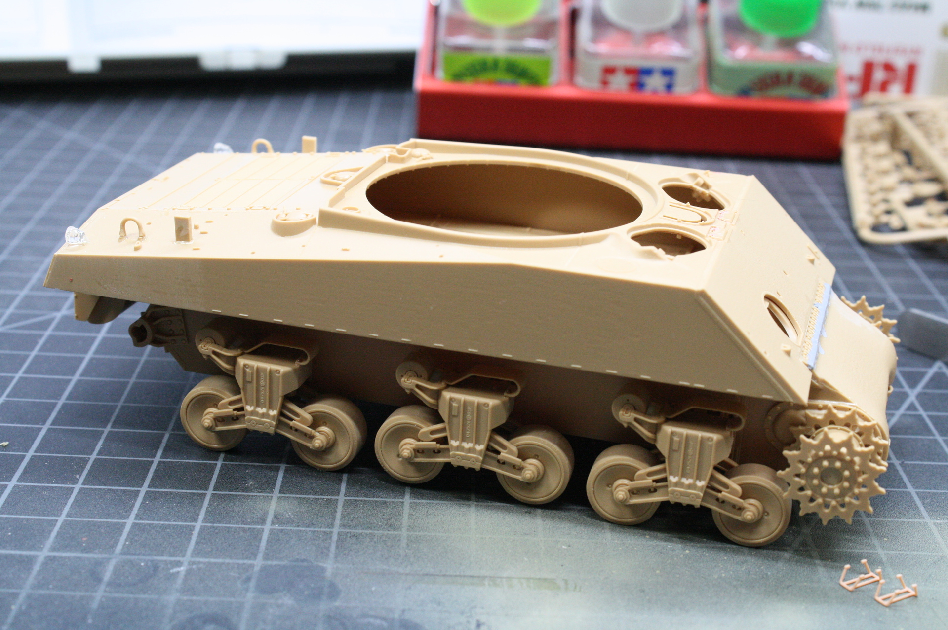

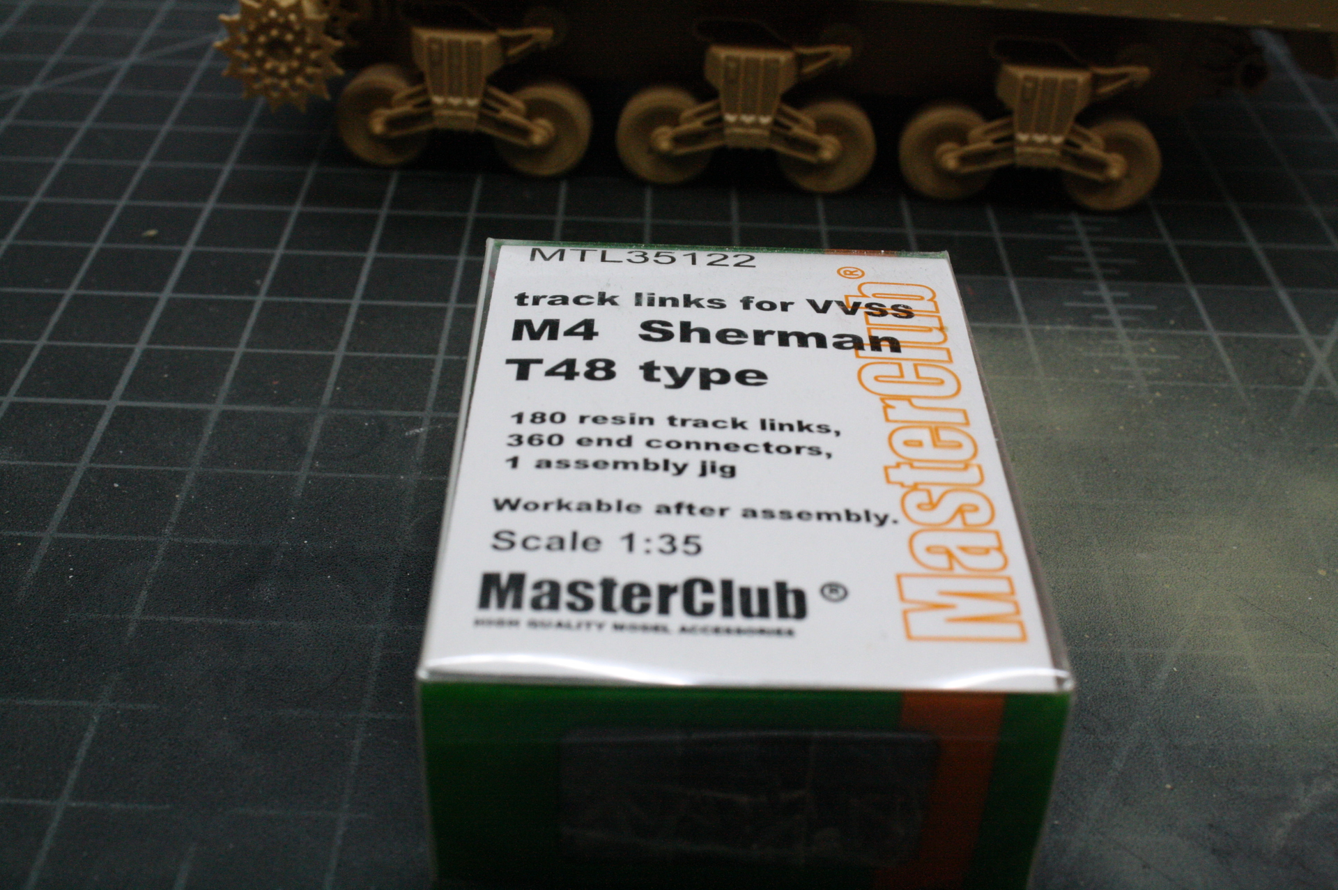

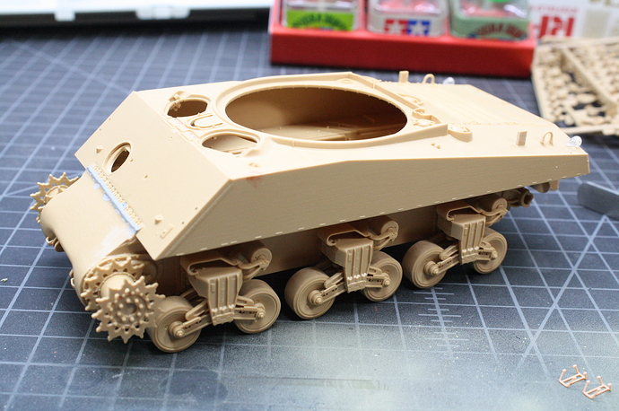

I’ll be joining in with my RFM kit #5133 M4A3 76 (W) VVSS Late Upgrade Version.
I started it for Shermania 2025 but it got sidelined. So now I’ll continue construction and hopefully get it finished for this Campaign. Everything comes is one box - Kit, PE, 3D printed parts, metal barrel, indy tracks. Lots of parts! Not for the faint of heart! The only thing I replaced were the tracks. I’m a real Shermaholic and am loving this kit. Although the bogies were the hard part - 16 parts each and working VVSS springs. Now that those are done, it seems to be smooth sailing. (Famous last words!)

Those bogies!!! I’m currently into the bogie quagmire. Managed one and taking a break. :sweat_smile:
Find any tricks to easier assembly or did you just grind through?… I left the wheels until last and “persuaded” the suspension arms into place. :grimacing:
The bogies are a nightmare. This was a conundrum that took me several days to figure out. If you follow the instructions it’s just impossible, the parts fall apart in your hands.
First, I CA glued the springs into their “cups”. Then I put the front and rear half of the bogies together, trapping the cups, springs, and suspension arms in between them. Then I glued up the wheels and axles, and when the bogie units were dry, I spread the bottoms and snapped the axles into place. All the parts have to be pre-cleaned and all ready at once for this to work. It’s about the only way to get them all together.
Oh, the bogies. Like a trip to the dentist, necessary but not too many folks favorite place to hang around!
I hated building their suspension as well, and wasn’t too impressed with the fit in other places.

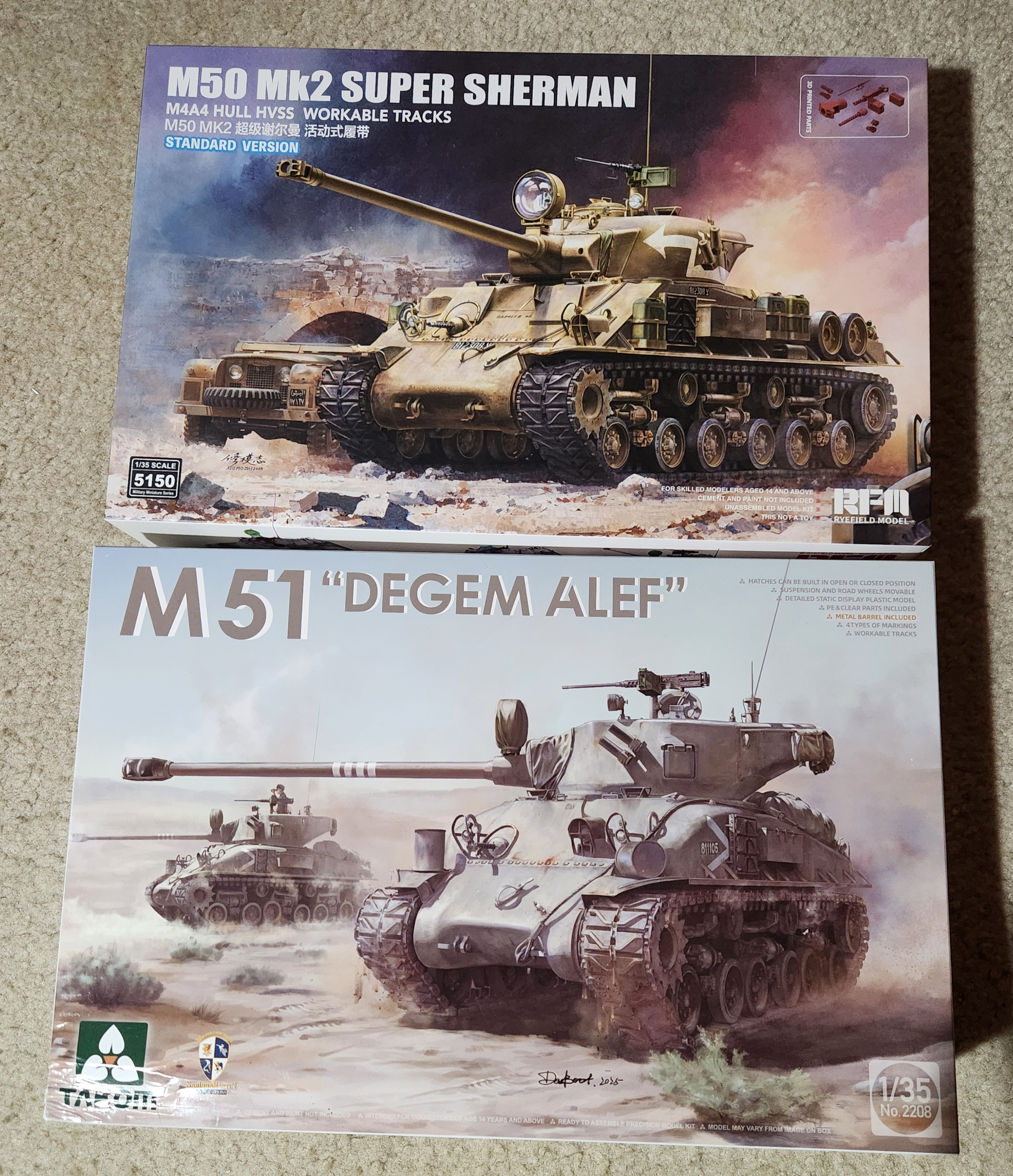

I’ll enter another 2 Shermans like the ‘25 one. These are my choices.
