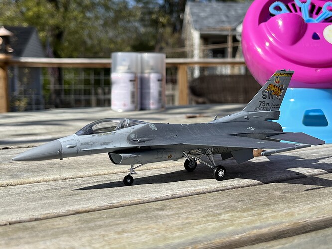

I see you painted the wheel bays before the exterior color. I wanted to do that but wasn’t sure how I’d mask off the bays. What’s your plan for that?
Looking good!

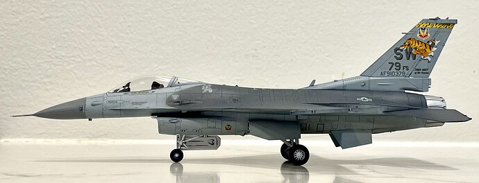

Flat coat today. Next bay doors, missiles, and the tailpipe.
Getting there….
The white glue I used for the canopy created some crazing that will require polishing compound. Didn’t foresee that being an issue.
Looking good though… Nice tail decals as well.
Really nice F-16 Build. My favorite jet!!
Looks excellent! Makes me want to build up my Tamiya F-16CJ right away
Yeah, this kit makes me want their 1/48 or 1/32 version.
Very nice, you don’t see them that often without any onrdnance.
You sure don’t. Growing up I always liked the look of a slick Viper, so I decided to leave everything off. Considered adding AIM-9Ms to the wingtips but decided against it just for that reason.
