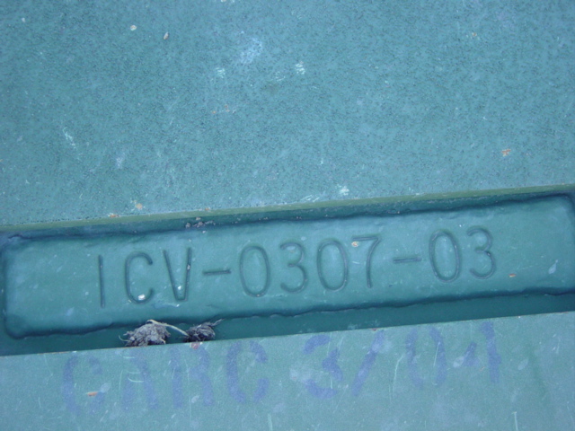

another simple thing most of the kits miss is the ID plate on the front right side. something so simple but would have been easy to include (i have seen it on the Academy kits)
it is the Type - Number built - Year built
There’s a kit of a different vehicle coming out soon that may have different ID plates, in case you build more than one,

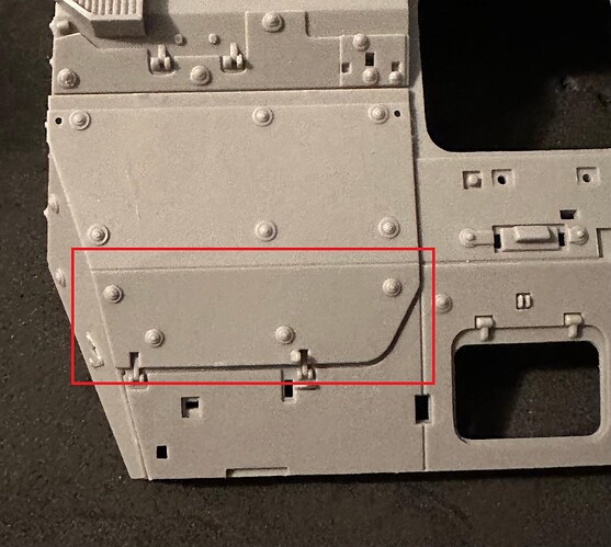

What you’ve done is superb, However, quite a few things still need to be done - some much more difficult because of how Trumpeter did their applique armor. For starters, this needs to be done:

You may want to design the whole portion of the engine hatch in front of the line, and let the modeler cut it off and replace it on the kit part. Because of the new bolt arrangement I think this would be the easiest solution.

you can carefully shave those bolt points off with a sharp knife by using just the very tip going around it taking tiny slices until they come off then can be transplanted to a different spot. you can see here i removed 2 rows on the right side ready to fill the gap as the LAV only has 4 plates on the front not the 2 bigger and 4 smaller ones like on the Stryker (another error carried over on the Trumpeter kit)

Nicely done so far! But your statement about the Trumpeter kit being the easier one to convert is debatable. Here’s why:
The lifting lugs on the FB versions are behind the armor joint. The armor is notched to allow for it. On the DVH A1, the lifting lug is in front of the joint - the front piece of armor is notched to accommodate it. This is any easy fix for the AFV Club kits as the armor comes in separate pieces. Since Trumpeter’s armor is cast on it’s a little trickier.
