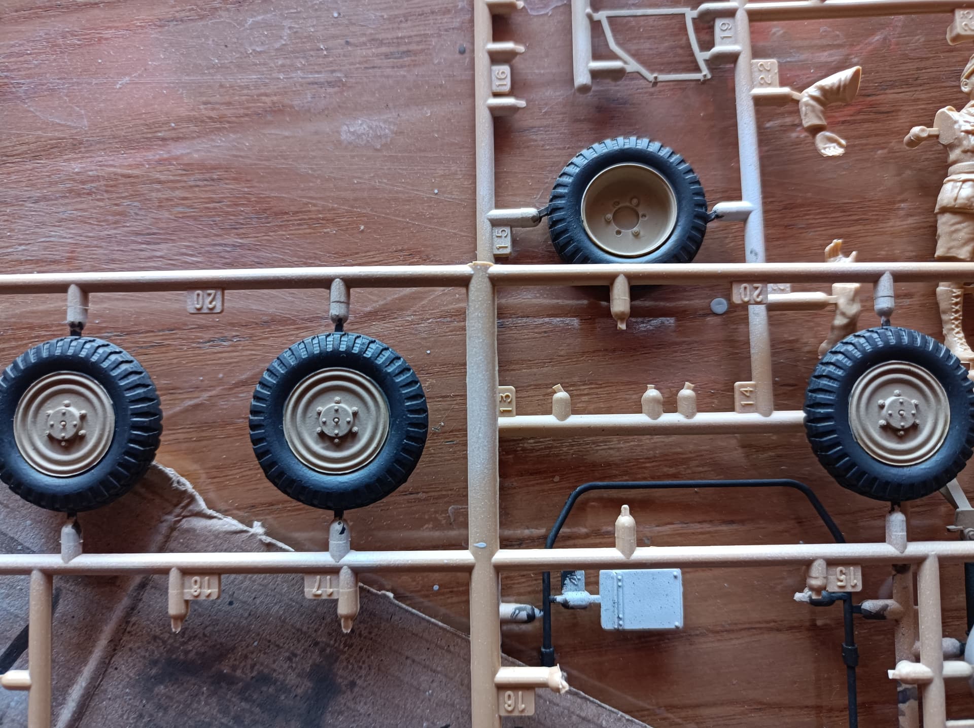

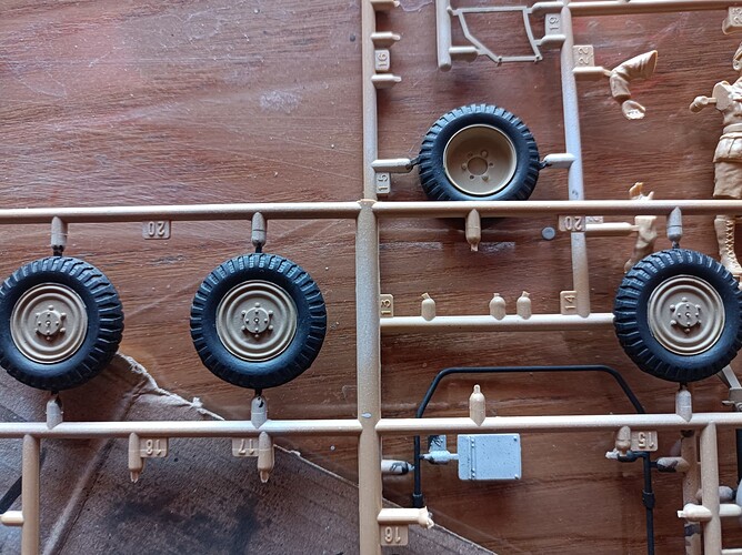

I tried the Italeri paint with a brush, just got it wet with thinner and had a pass on the wheels.
It went much better than I expected:
They could use some micro-corrections, I am going to take a second pass tomorrow to correct mistakes.
The paint texture looks fine (except on some places where I can clearly see paint excess), I am really glad I finally managed to find a way to brush paint without streaking.
It really saves the bother of setting the airbrush up and I can work in the living room without eye protection and respirator.
They look great!
Very nice!
Ken

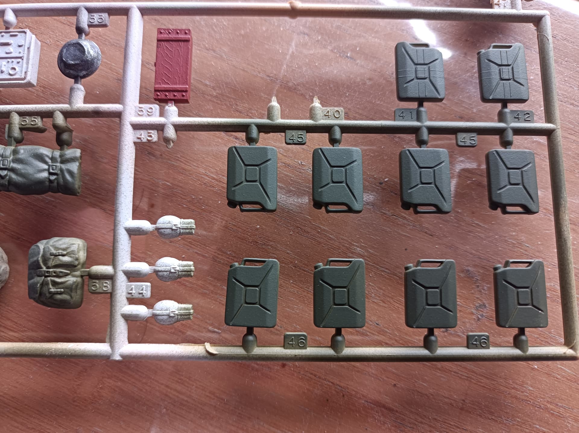

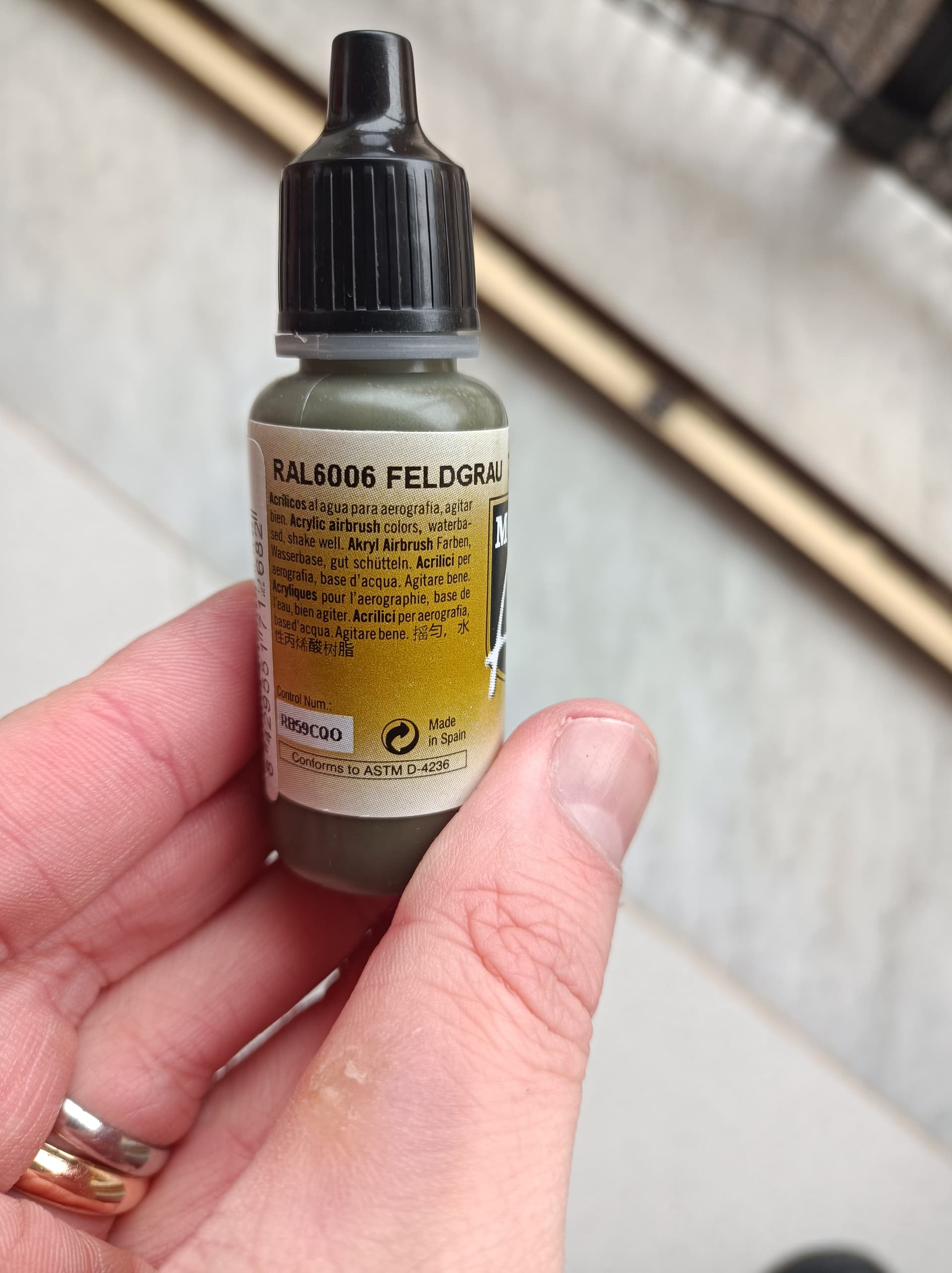

Look at the jerry cans, this is the first time I spray German Grey, straight from the bottle with very little thinner, shaken AND stirred (lol).
Is it supposed to be so…green?
You, using FELDGRAU, this color is for German uniform, for German AFV you need use PANZERGRAU.
RLM 66 to be precise.
Damn, I feel so silly.
Bought that grey in bulk with other colors after asking which were the most common colors for WW2 tanks.
I suppose I will use this some day.
Will get the correct one, thank you.

RLM 66 is a Luftwaffe color, with RLM being Air Force specific colors. All the other German armed services used paints to RAL standards. RAL 7021 was the specification for the gray used on Panzers.
Well one thing is for sure, neither are Field Gray.
