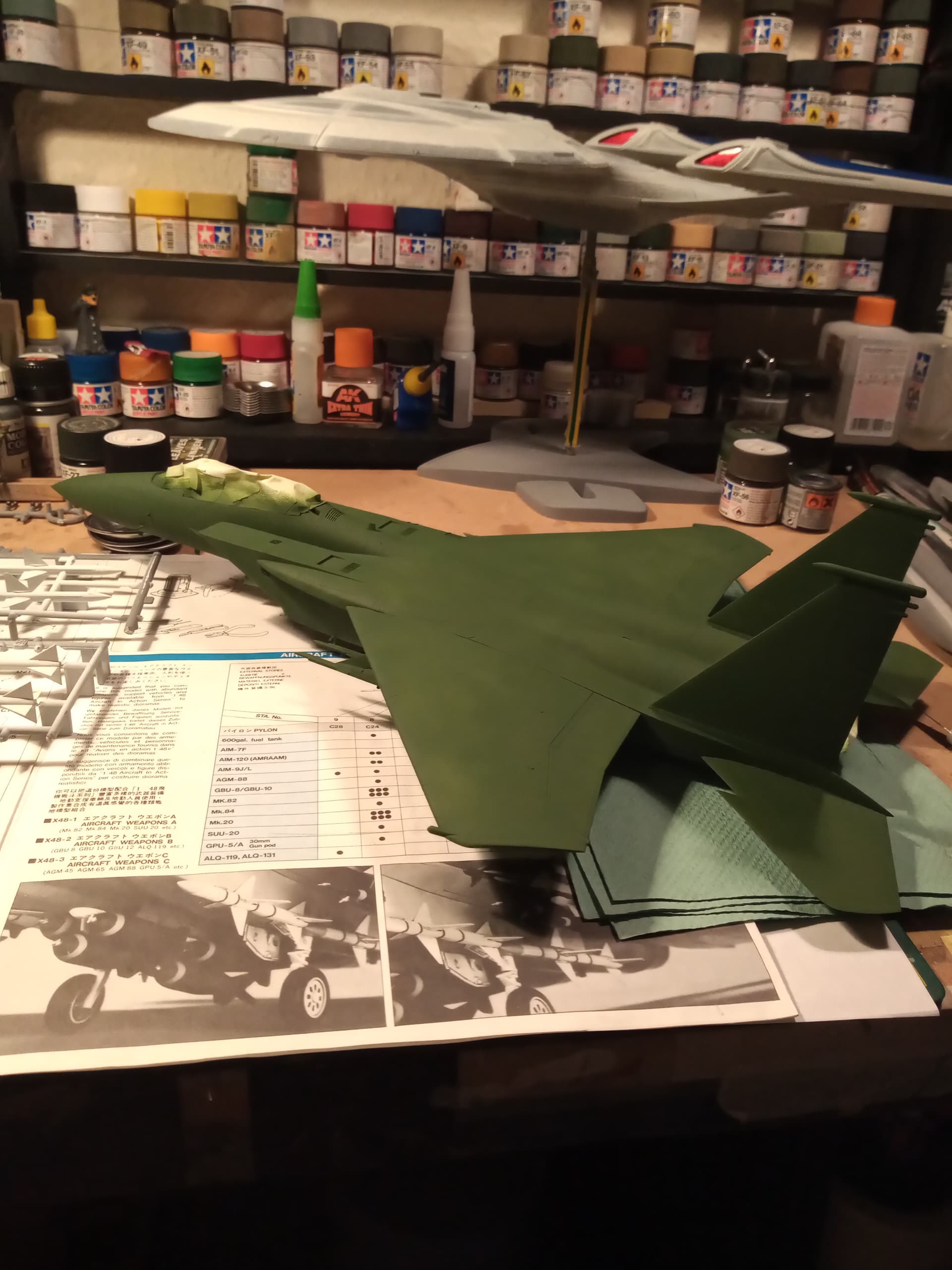

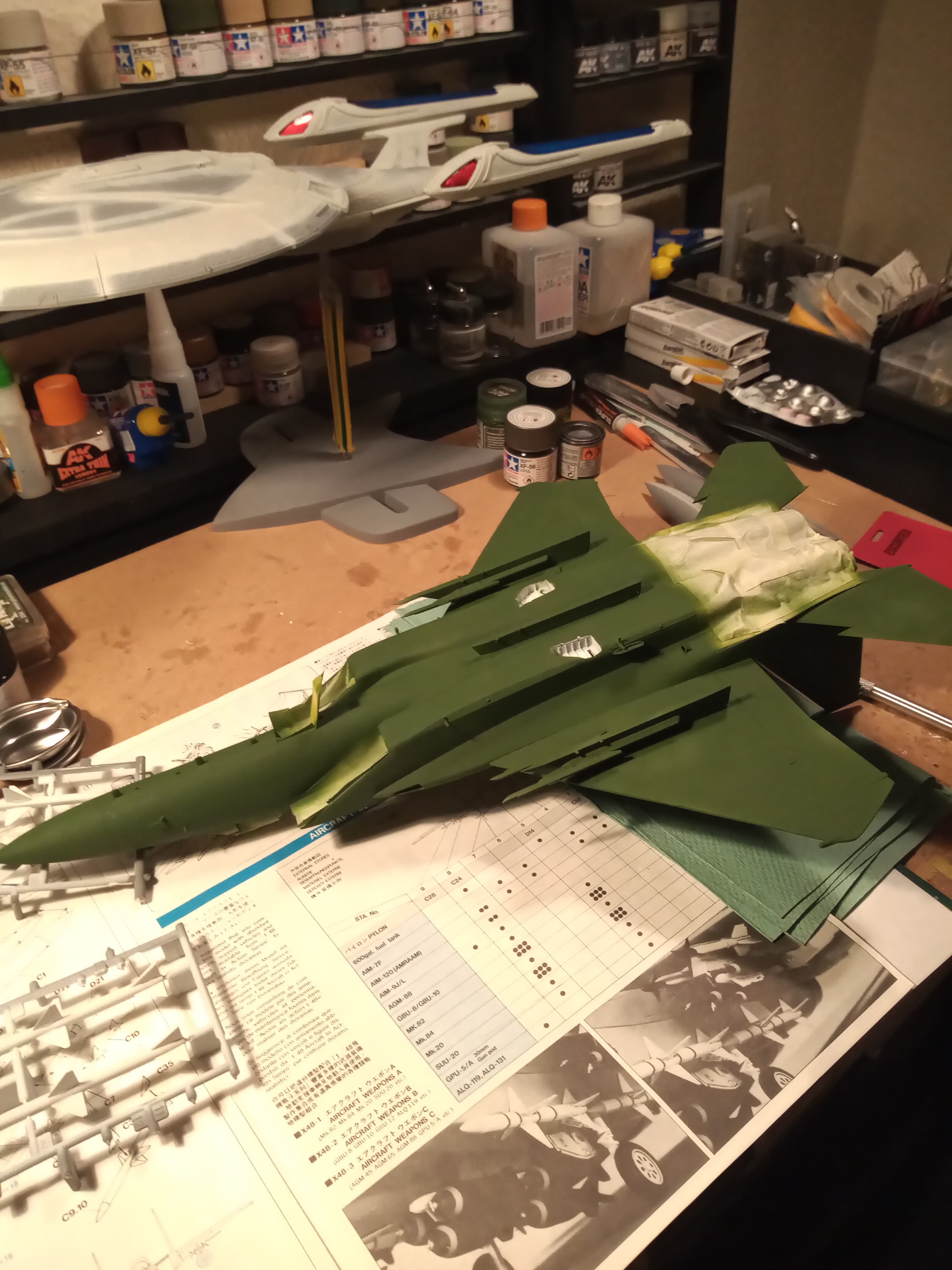

The Eagle is now green…
RC 083 to be precise… FS 34102 … Now it’s on I actually think that’s the right colour … Pretty happy with that
It looks a bit patchy in a few places, which is partially the light, and also areas that I know are going to be covered by one of the 2 remaining colours

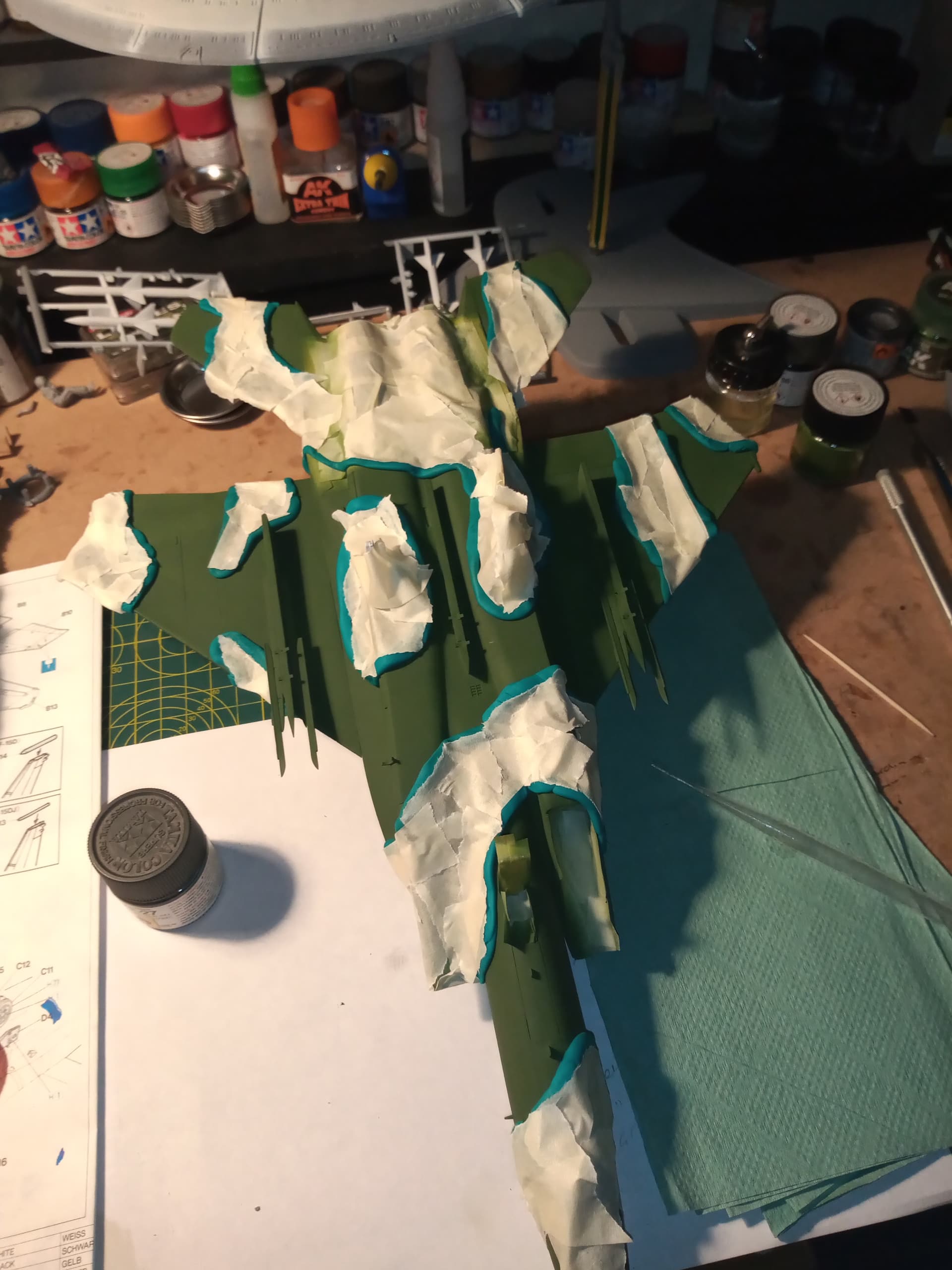

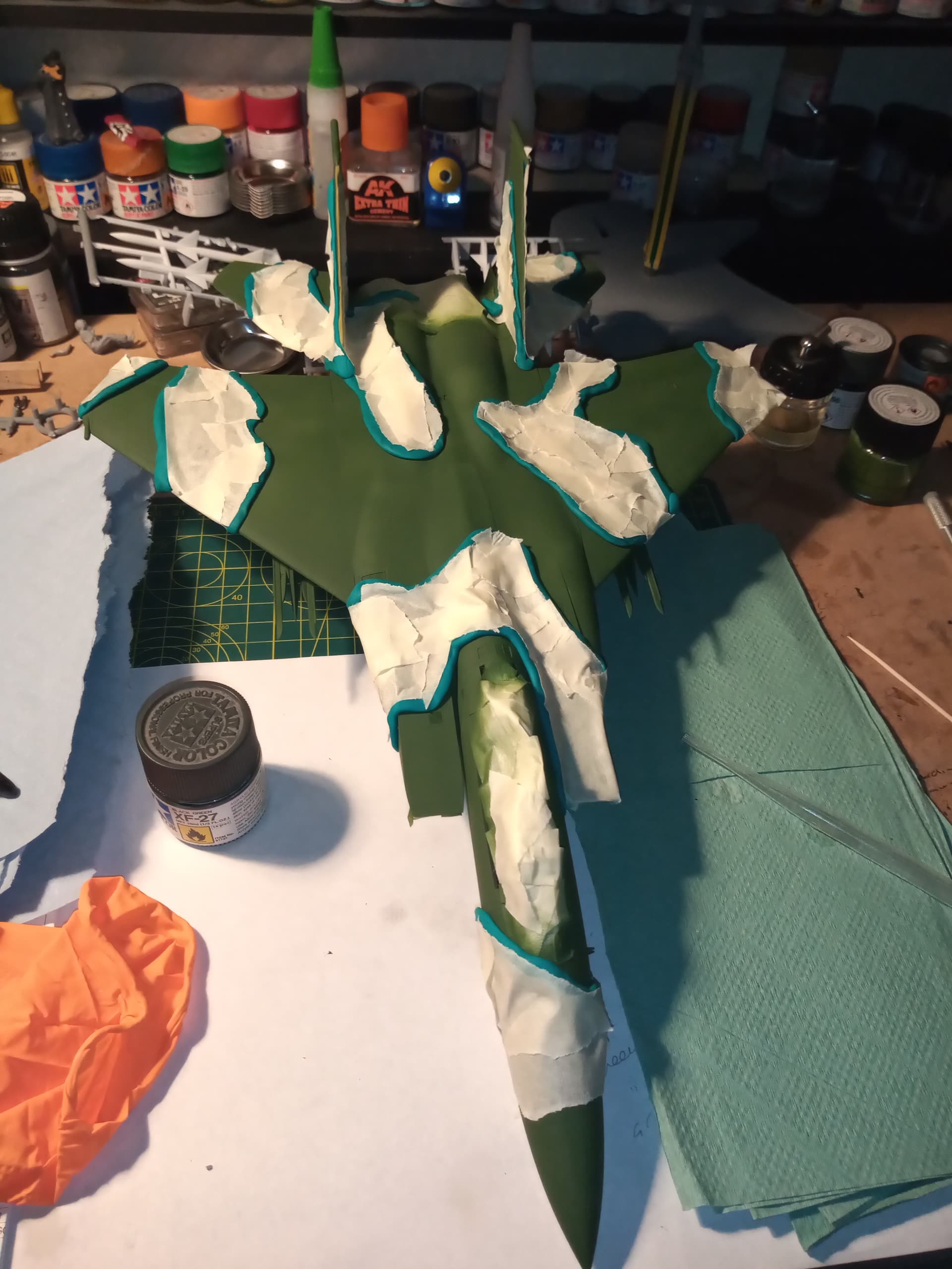

First set of masking done…to late to paint so will tackle that tomorrow after work …
I’ve taken the bold step and decided on Tamiya XF27 black green for the darker shade of the green…

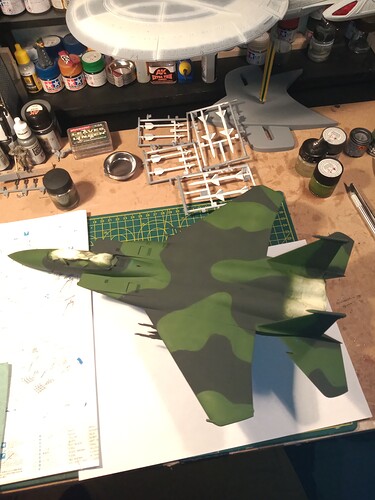

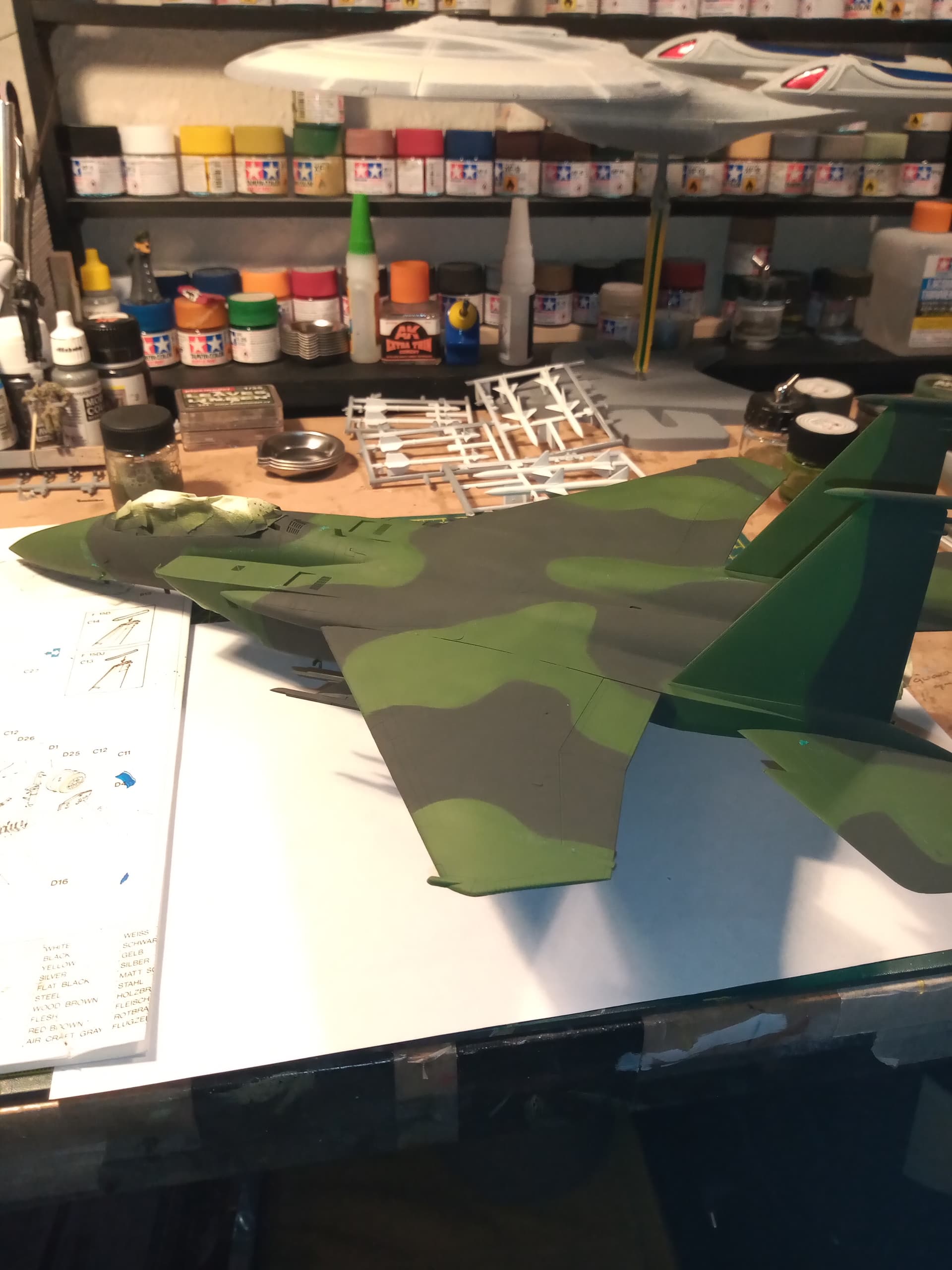

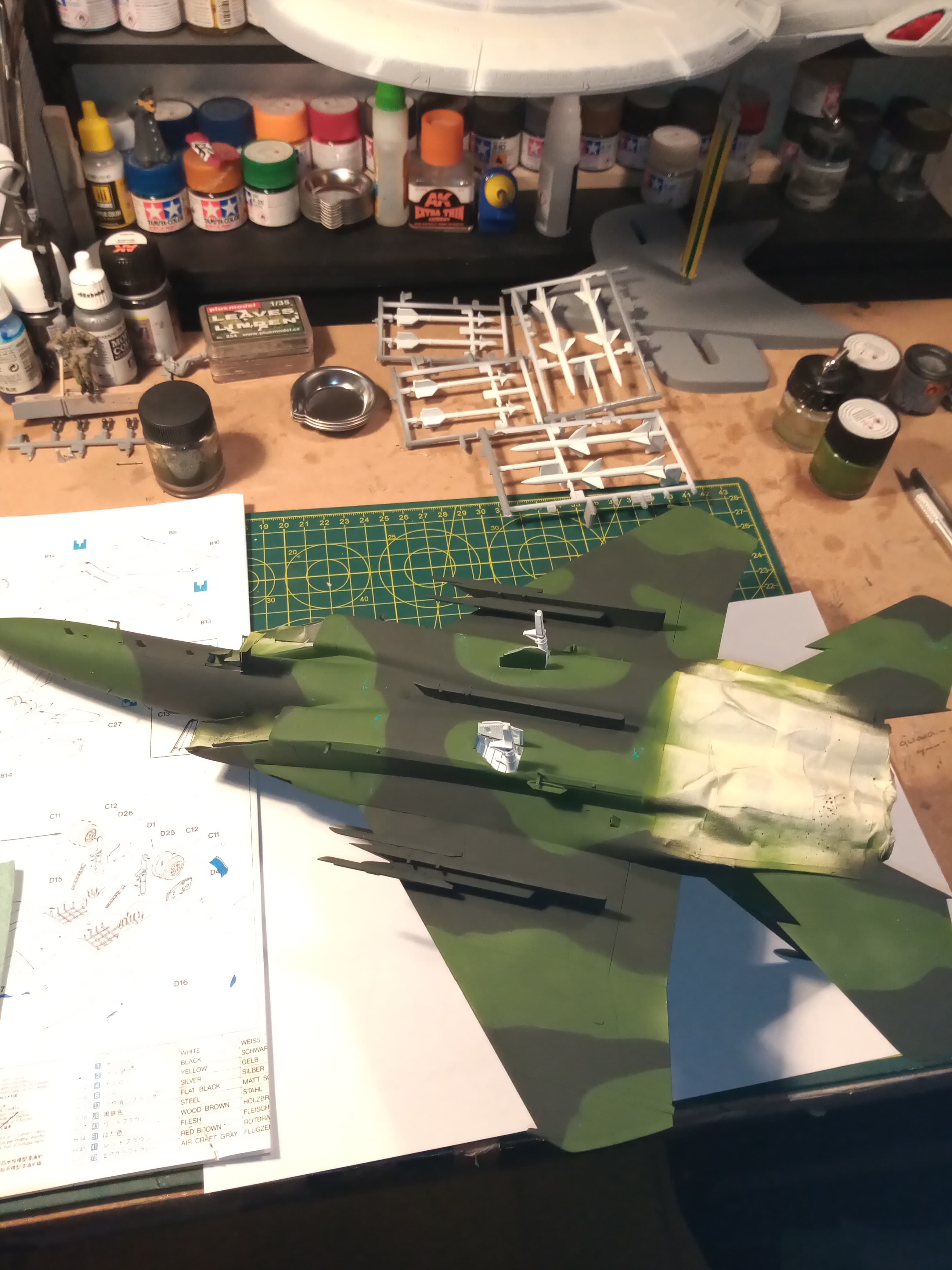

Some more paint in place …
Happy with the XF27 black green… I think this has the look . …
The grey is up next, I think I will be using the AK RC 243 fs36081…looks about right.
The brighter green bits you can see are the left over bits of play doh I used as the masking outline. Nice and easy to remove, just hadn’t got around to it.
