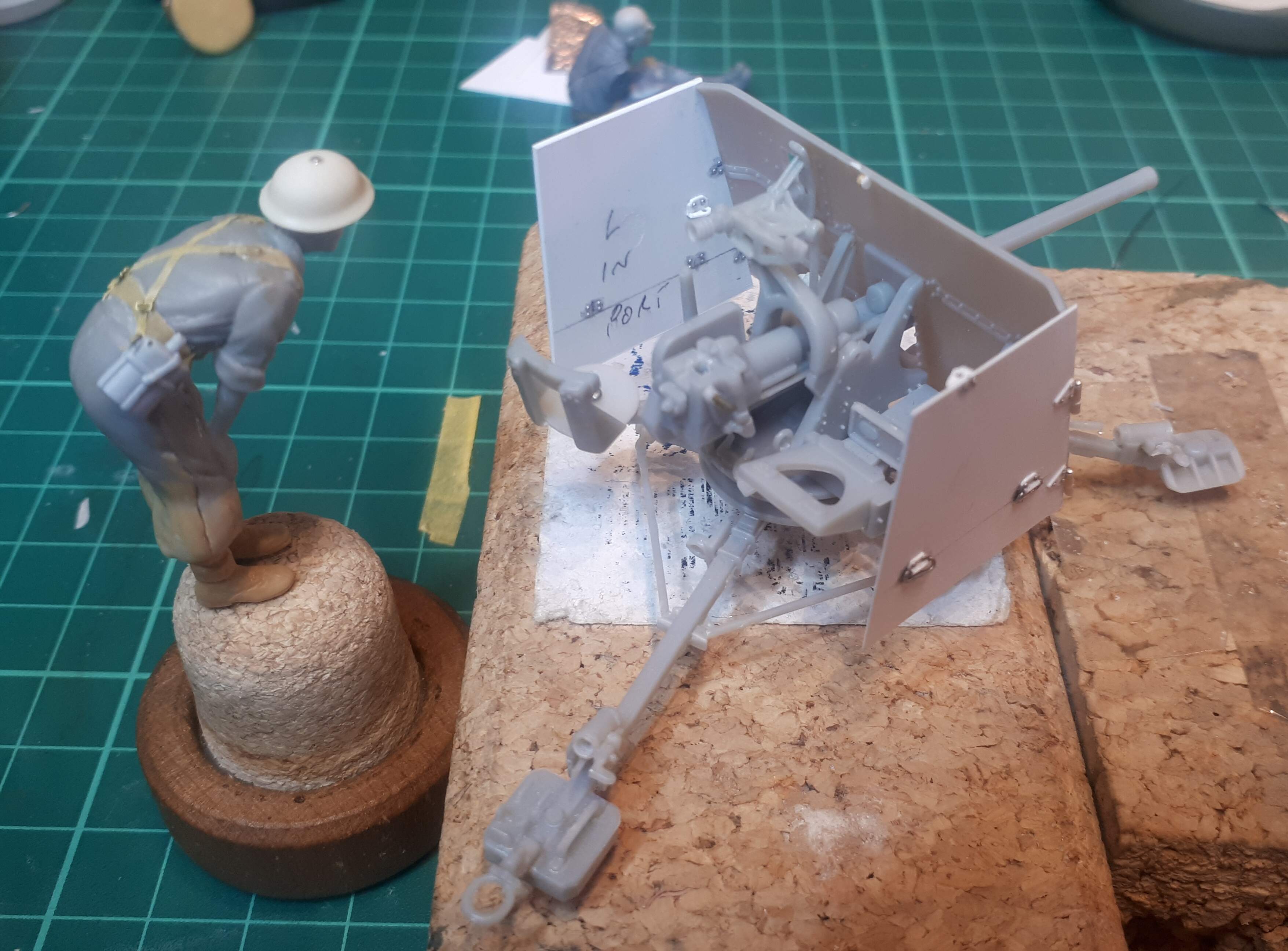

So I count this as the most conversion work I have done on a figure so far… not that it’s anything like the dramatic alterations that Jerry Rutman has shown us.
First I had to razor off the guy’s lower legs. These were replaced by a pair of lower limbs from a Tamiya Desert Fallschimjager figure. This also helped to give him a bit more height because the original sculpture is a bit short.
Next I had to bulk out the lower trousers using Tamiya two-part putty. This stuff is very useful for rolling out into thin sheets, but it is very sticky, so you need to use plenty of talcum powder to stop it from staying on the cutting mat or your fingers. Ironically, I then found I had trouble getting it to adhere to the resin figure.
I also used the same putty for the belt and the wider part of the shoulder straps which go over the shoulders.
But the rest of the webbing was made using Tamiya masking tape. The beauty of this is that you can a) thread it through the photoetch buckles and b) it actually sticks to the model whilst you work with it!
The buckles, by the way, came from the excellent Aber 1/35 Assorted Buckles & Straps Detailing Set # 35A21:
Aber 1 35 Assorted Buckles & Straps Detailing Set 35A21
To help stiffen / attach the masking tape and also soften any rough areas of sculpting I used Mr Hobby 40ml Mr Dissolved Putty # 119:
The water bottle was added from another resin figure set and the binoculars come from a Minart Russian equipment set. The strap was made with foil from a pudding lid.
Finally the helmet was courtesy of Ultracast with a top rivet made from punching pewter sheet. This was a very useful technique which I first used on the new shields for the 2-pounder. Below is a sneak peak of how this is coming along…

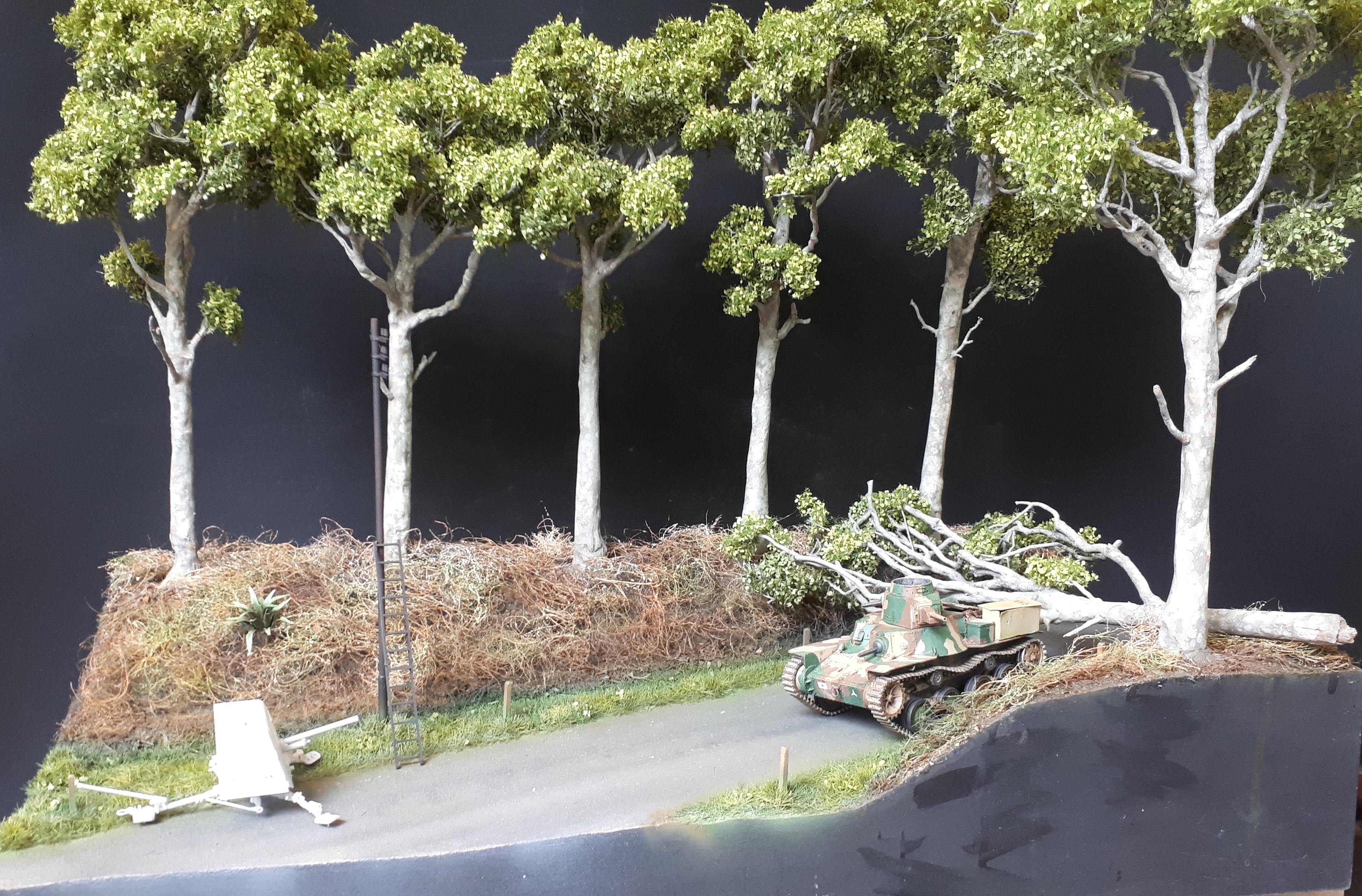

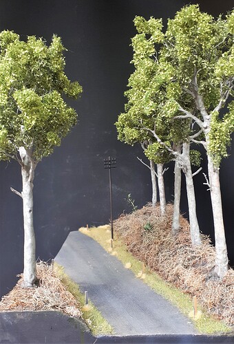

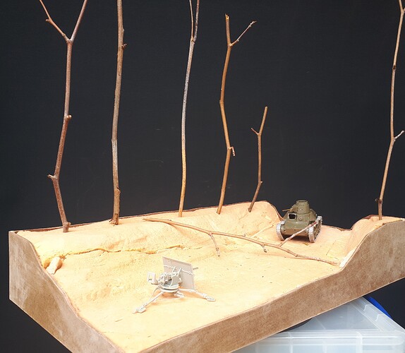

Apologies to all for the lack of recent updates… work has been busy and having two teenage boys aged 16 and 18 taking ‘milestone’ exams probably hasn’t helped.
But rest assured that I have been covering quite a lot of ground (quite literally) in recent weeks…
So here’s a question: how DO you create a jungle? I had absolutely no idea when I started this project…
Really nice. Quite often, I find that figuring out how to ask the question, goes a good way to providing the answer, as I think you’ve demonstrated.
Mal
