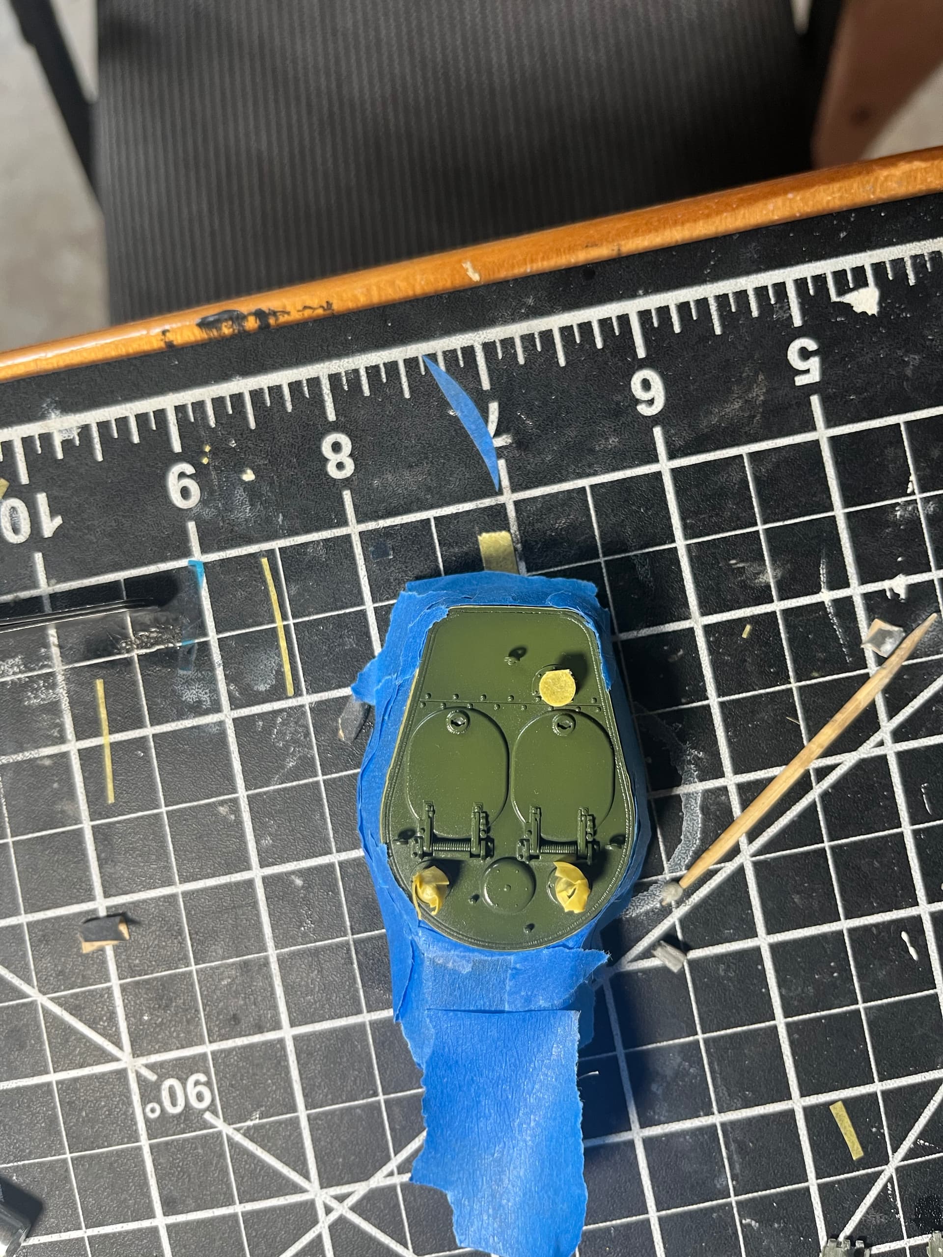

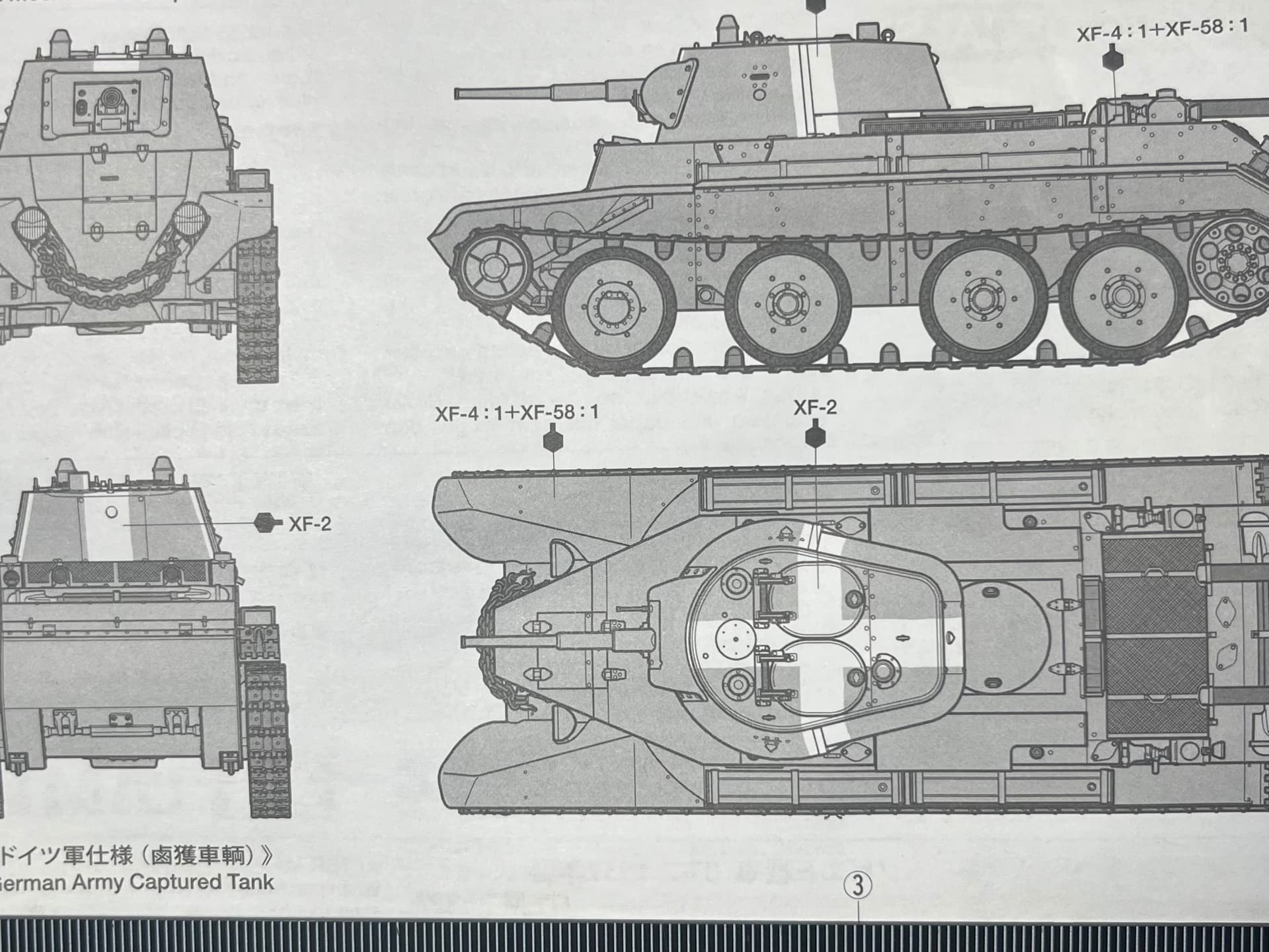

I am in the final stages of painting my Bt-7. I want to do this scheme
Which is commonly seen on tanks right at the start of Barbarossa
I only plan to the top cross as reference photos I’ve seen don’t show the side or rear stripes.
The challenge is there are a number of obstructions in the form of hinges, bolts, and periscopes that make this a challenging masking job.
I do understand the in field this was probably done by a guy who was a peasant a few months prior so may be rough. I am mostly trying to reduce overspray. I could free hand it but I don’t know if my skills are up to snuff!
I used Tamiya masking tape for curves, it is a little elastic so conforms to the surface details a bit more.

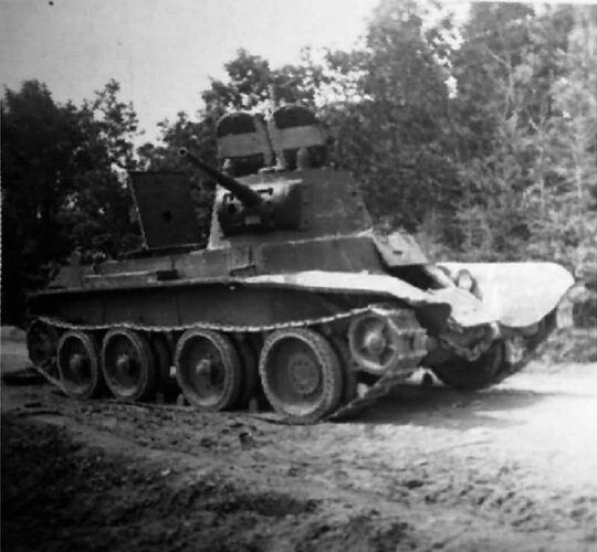

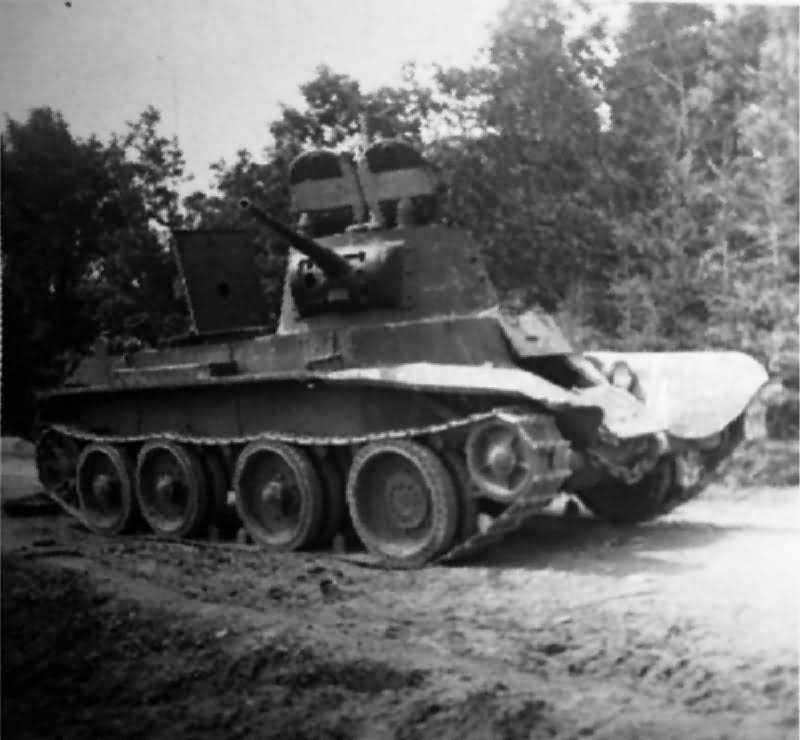

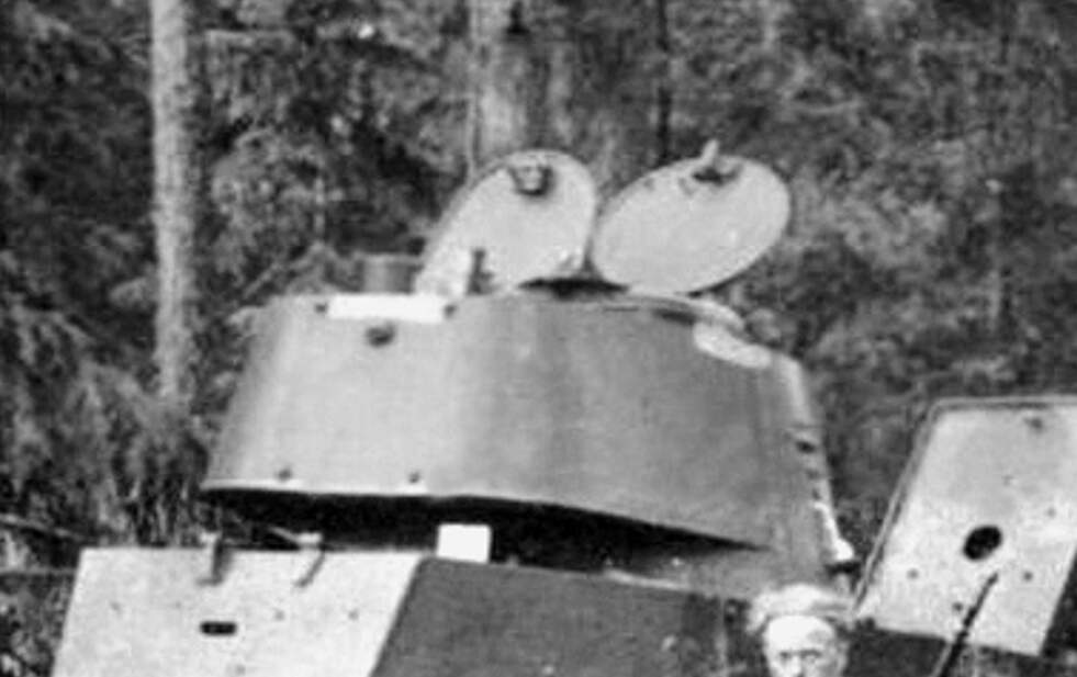

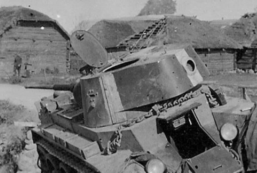

A roof-only cross is far and away the most common but there are a few photos with stripes on the turret sides:
If you wanted to be a little different there are photos where the cross has crept off the roof for a few inches:
KL
Neat pictures!! Thanks!
