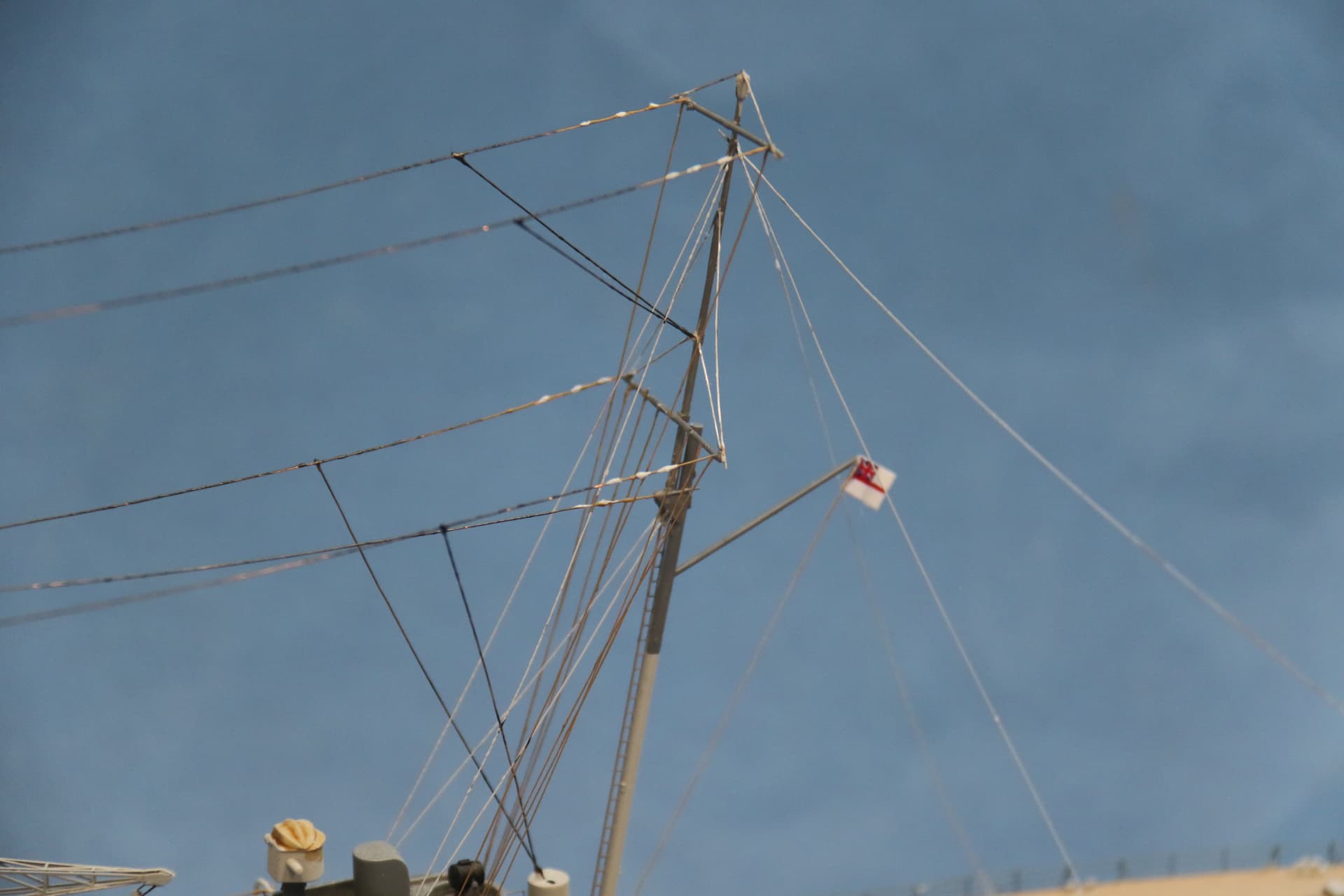

Your rigging looks great Si! Do you do it with fishing line or wire or sprue?
I always bend my masts when rigging, that why i try use brass for masts and yards.
Tom
Hi Tom,
I use copper wire, this is sourced from the cables for electrical kit that no longer works around the house. I roll it straight under a steel rule and on a flat surface with a bit of give in it. For me it has two advantages, it doesn’t put any strain on plastic masts and yard arms, the other on long horizontal runs like aerials, which are not under tension it gives a realistic natural sag.
Cheers, Si :beer:
Hi Si
I will try the copper cables. I used very fine wire from an old shielded TV cable, but it was so soft that it cannot be touched after installation. It stretched so easy that it lost the tension quickly.
Thanks for the tip.
Tom
Good luck Tom,
The copper fortunately has a bit of spring in it so it is not that fragile, I do sometimes bend it out of shape trying to get in place, but at least it will role straight again.
Si

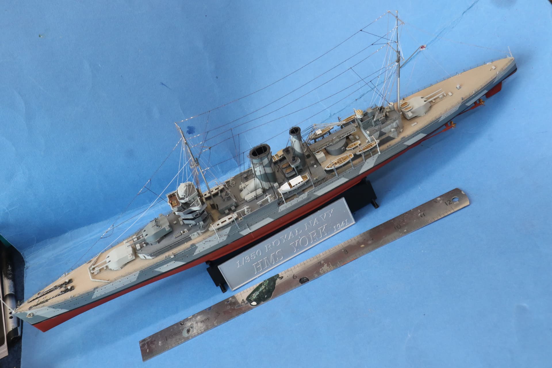

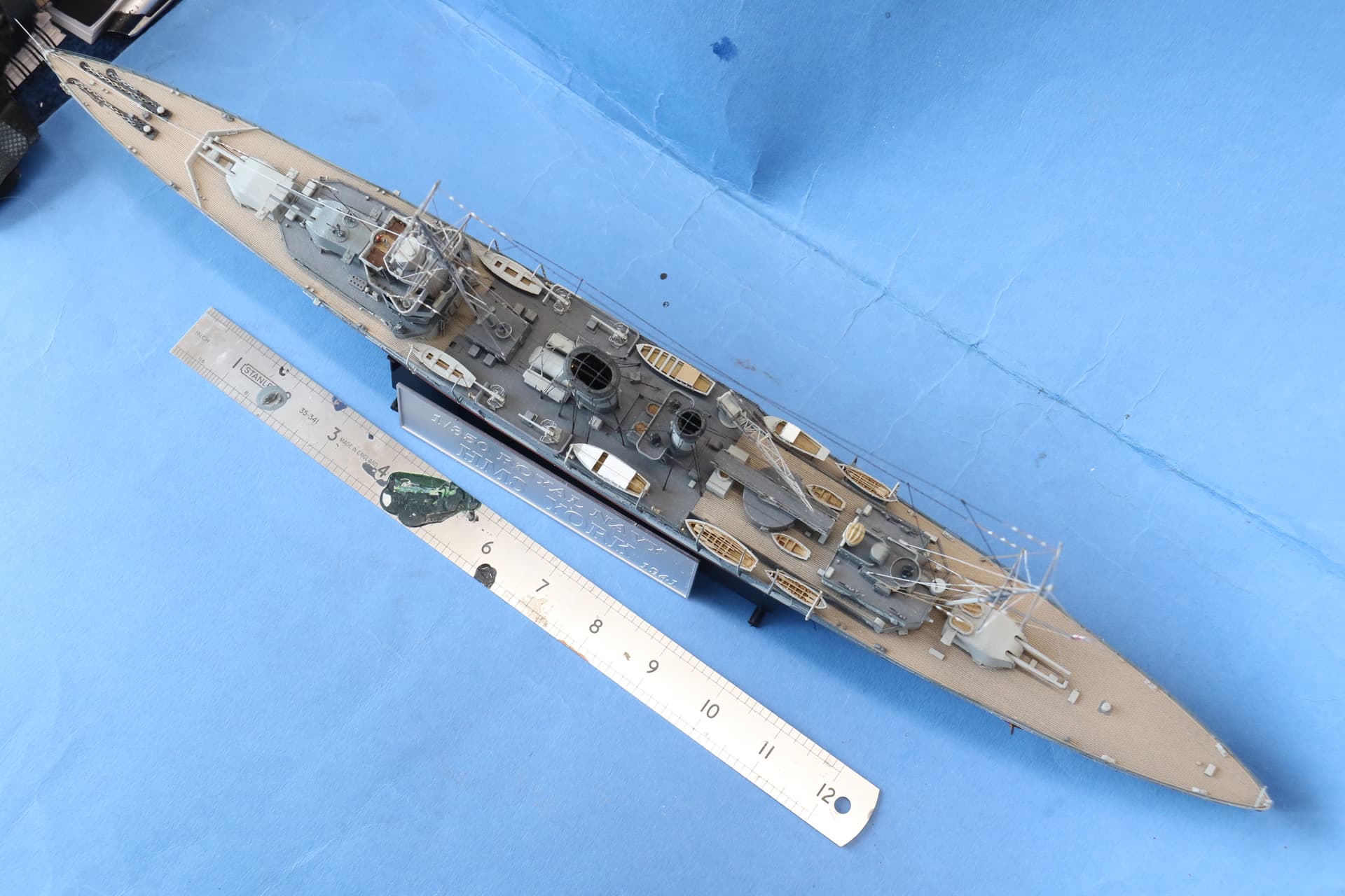

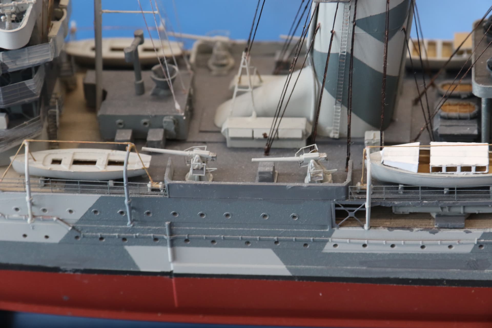

Finally Commissioned the HMS York, this has been an interesting build of an interesting ship, there were a few corrections along the way, but on the whole a nice kit to build.
All in all the Eduard etch was rather good, the etched turret detail included the correct 20mm layout for B turret for her final fit.
Another British Cruiser coming soon.
Si
