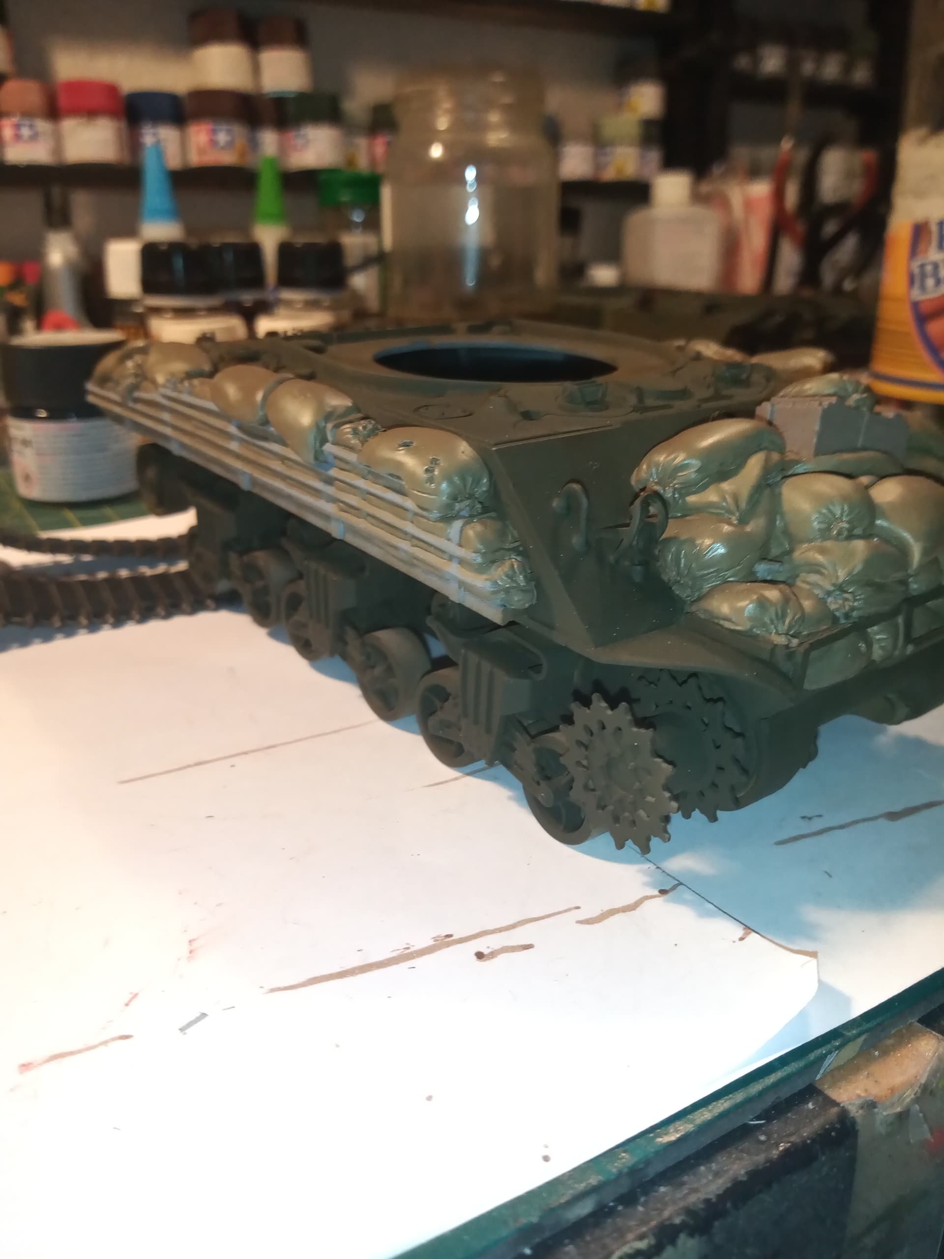

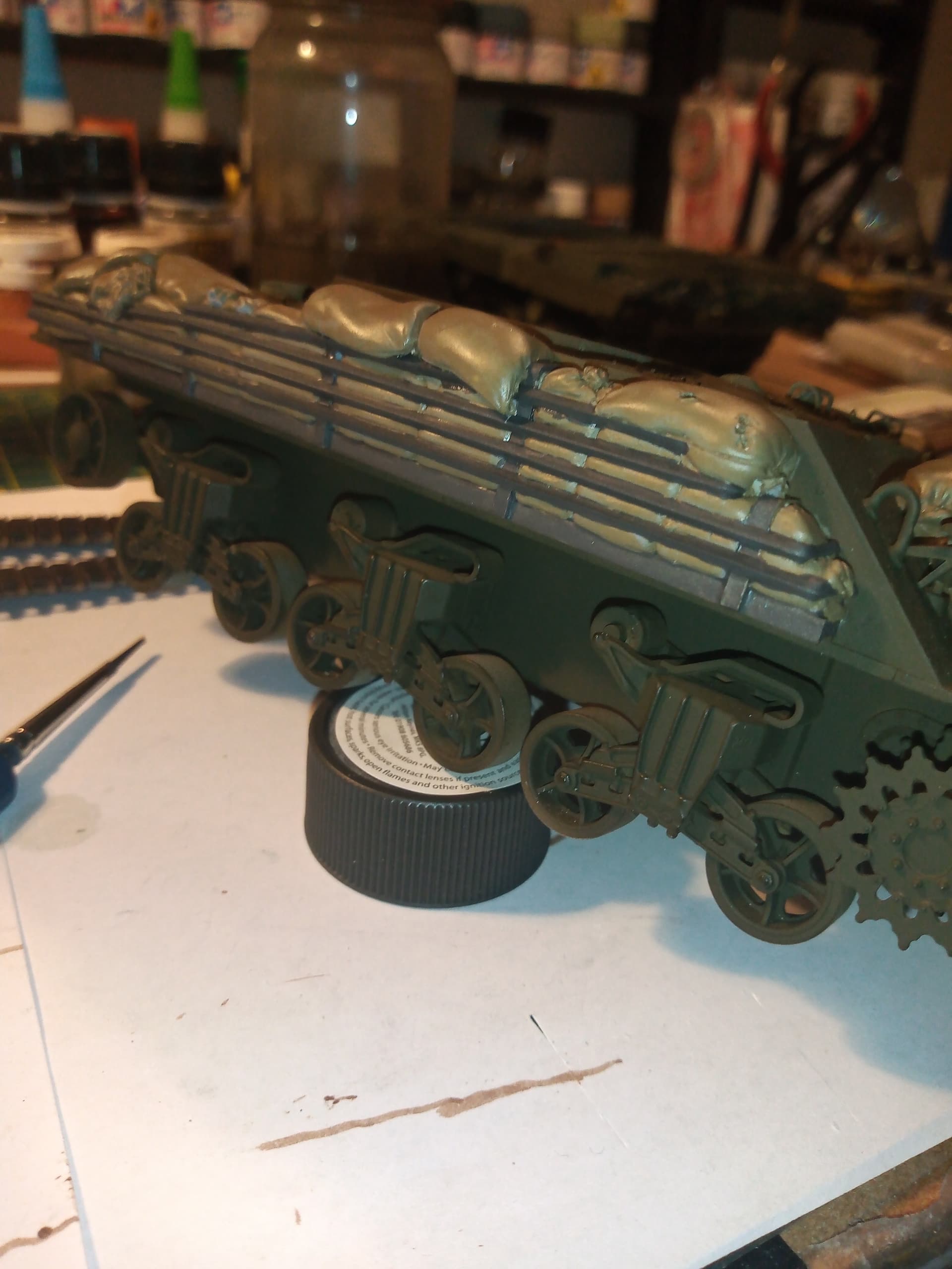

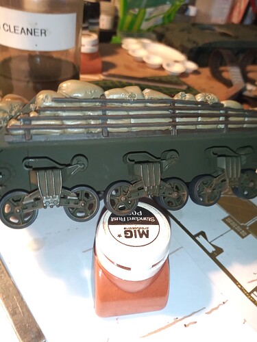

To get stuck back into it, I will do the metal frame for the sand bag armour… Tamiya Dark iron on the way …
Nice to see you move something stalled onto the bench John.
Lol… I know, the stalled work had stalled… Last time I posted was 7th April… …
Still, one side is done with dark iron…
Will get the other side cracked now.
And 10min later … Other side’s done.
Will start on the wheel rubber tyres tomorrow… :+1:

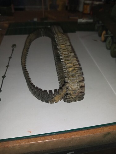

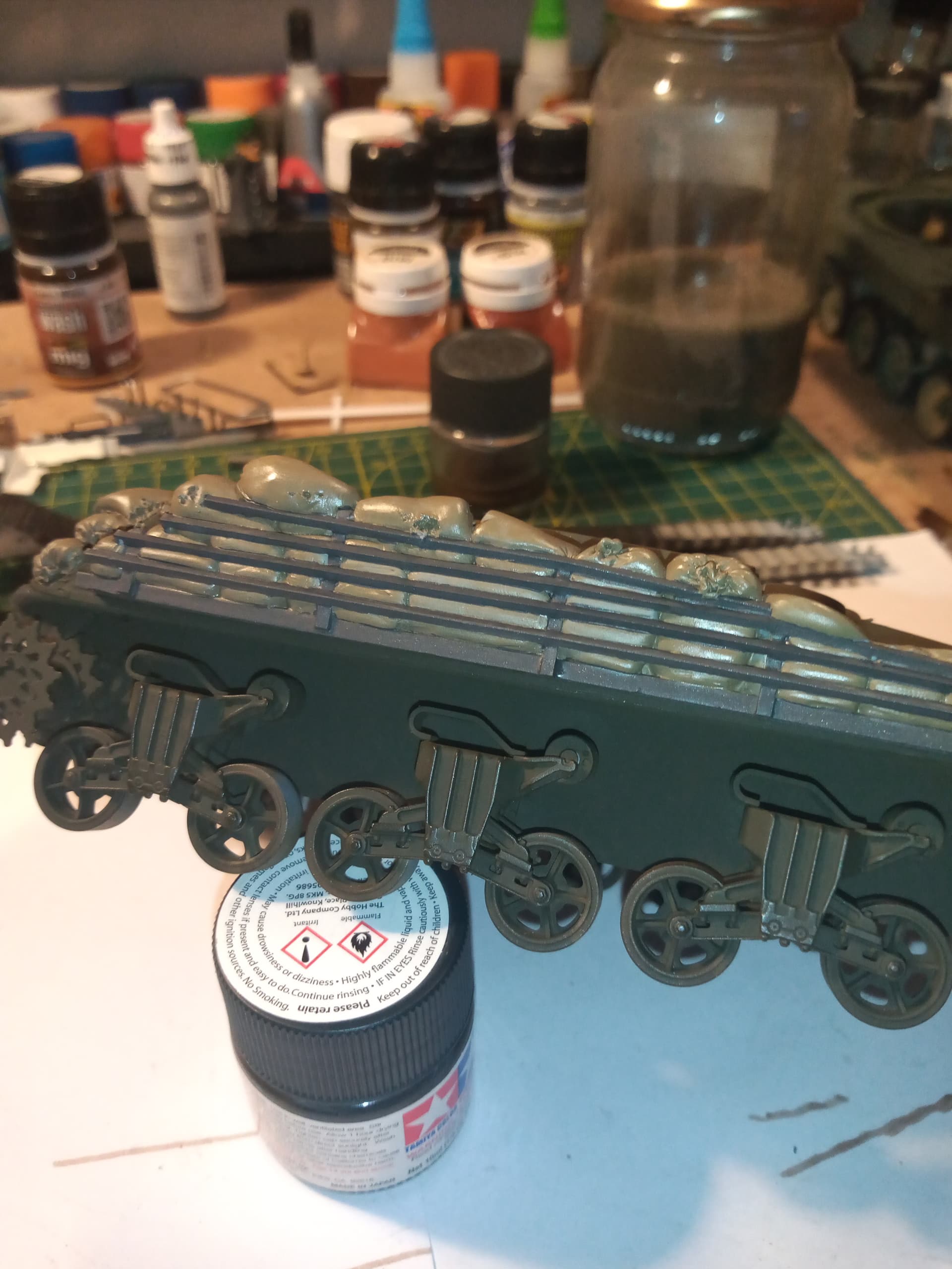

Wheel tyres done and I did another Mig track wash on the metal sandbag frame.
I need to add some lighter rust areas with the MIG track rust and some light rust pigments…

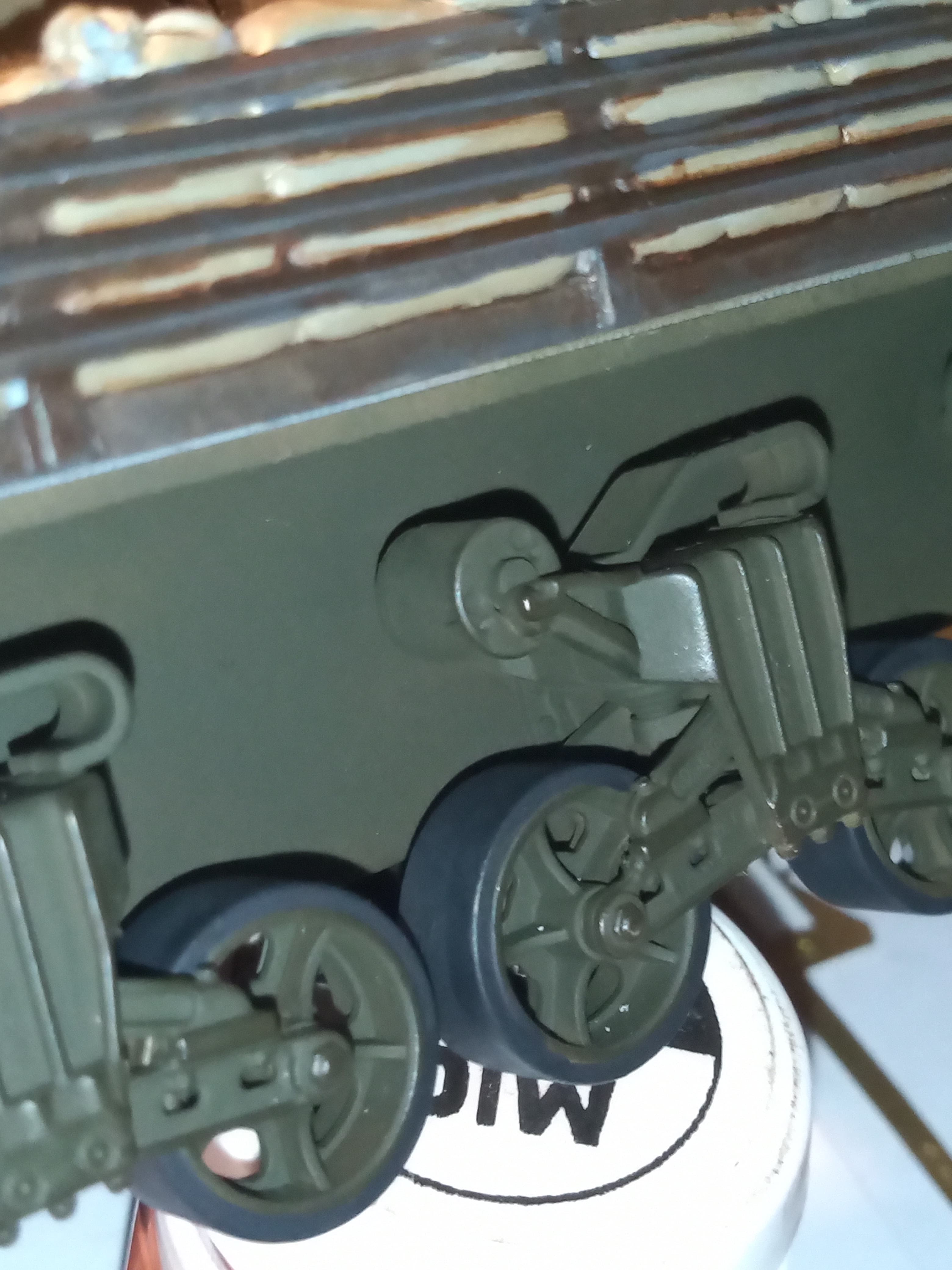

Ref the return wheels below,
Would they have had a more bare metal finish on the contact surface ??
Any Sherman guru’s please… Not sure on the tracks and the colour…
I know the chevron leading edge would be worn and metal finished, but what about the rest of the track, was it rubber over metal ?
Those tracks were all steel, so would oxidise to a brown and then get polished through friction when running. I think they were delivered in a protective greyish black coating but it very soon wore off.
Cheers Tom… So I’m thinking dark iron as a base then oily steel highlights ?

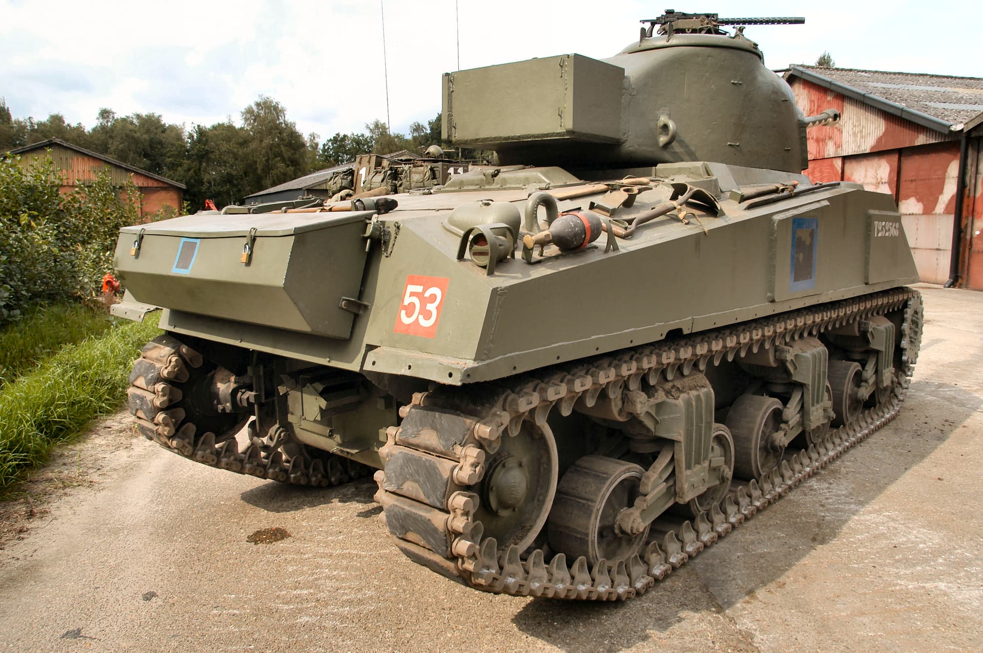

That’s a good wat to go. Dark Iron base with metallic grey highlights for bare metal andf a light rust wash. These particular tracks have the Duckbill cleats used during winter ops. Used by both American and Commonwealth vehicles.
Shown on a Canadian (I assume) Sherman.

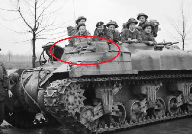

And here on another Canadian vehicle; this one is a Canadian Ram Tank, converted into a “Kangaroo” personnel carrier (thanks @petbat for the correction).

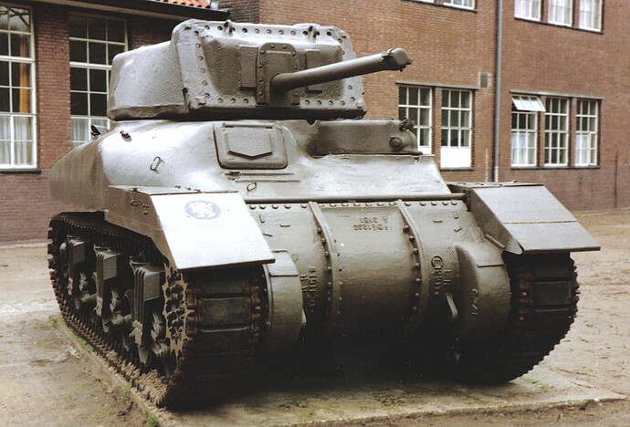

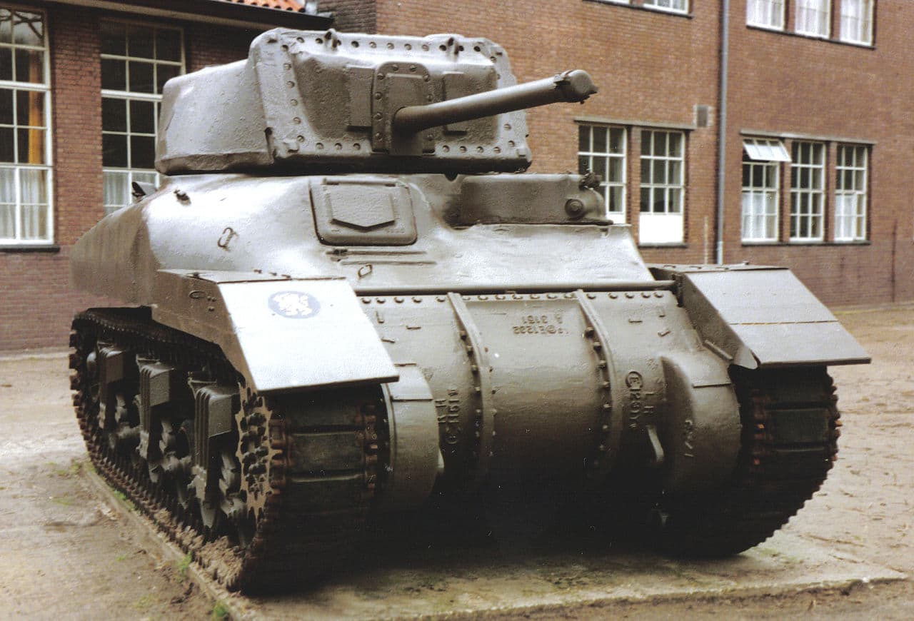

This is a Ram Kangaroo Reynier. The hull is not a Sherman but the Canadian Ram tank, itself based on the M3 not M4. Note the Mg Turret:
I so want to build a Ram…
My apologies then. I suspected it was a Ram Tank, but wasn’t sure of it.

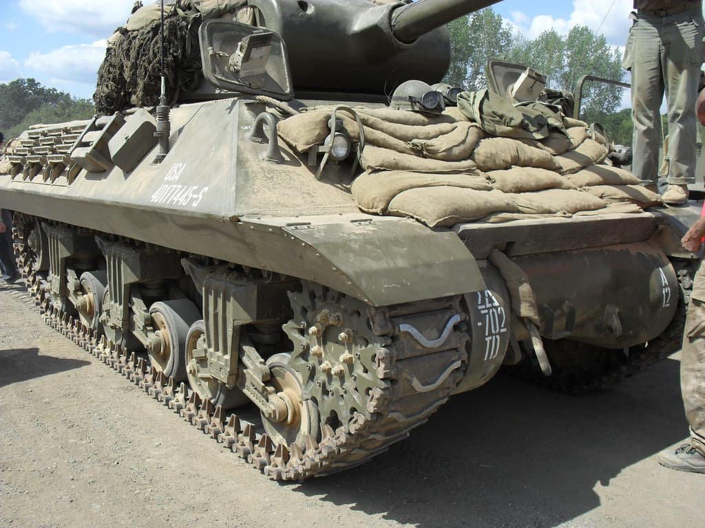

@Johnnych01 These tracks were ‘Muck Magnets’. They were either coated in Mud or layered in dust. I’ve seen a few ‘Runners’ with this type (Most runners have the rubber block type as they do not damage roads). Here is a good representation on an M10:
