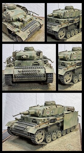

BTW - the Takom upper hull fits pretty well on the Tamiya lower hull…
Looks nice once assembled…
…painted and weathered…

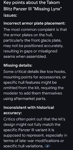

AI, Missing Lynx & Takom Pz III ausf N
…makes a fun read…

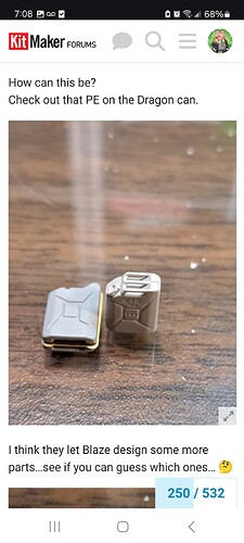

5 Fit the kit fits well the jerry cans not so much due to an error with the PE. This can be side stepped by removing the alignment pins.
While annoying it’s fixable.

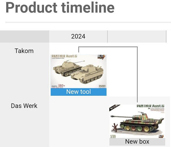

WWR Das “Takom” Werks SuperBlitz Late Panther G, DW35041
5 Price ~$24.99 via Pre-order at Andy’s HHQ, incredible :astonished: :open_mouth: :hushed: price
