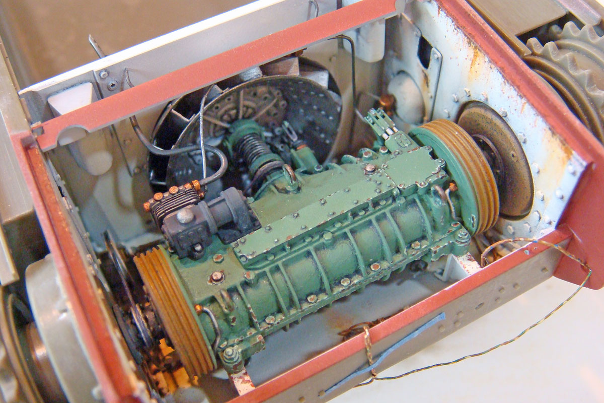

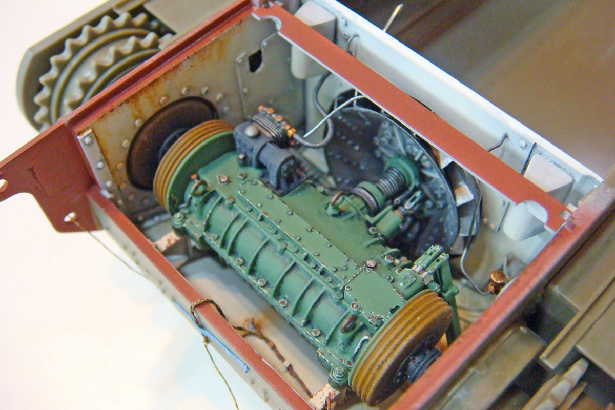

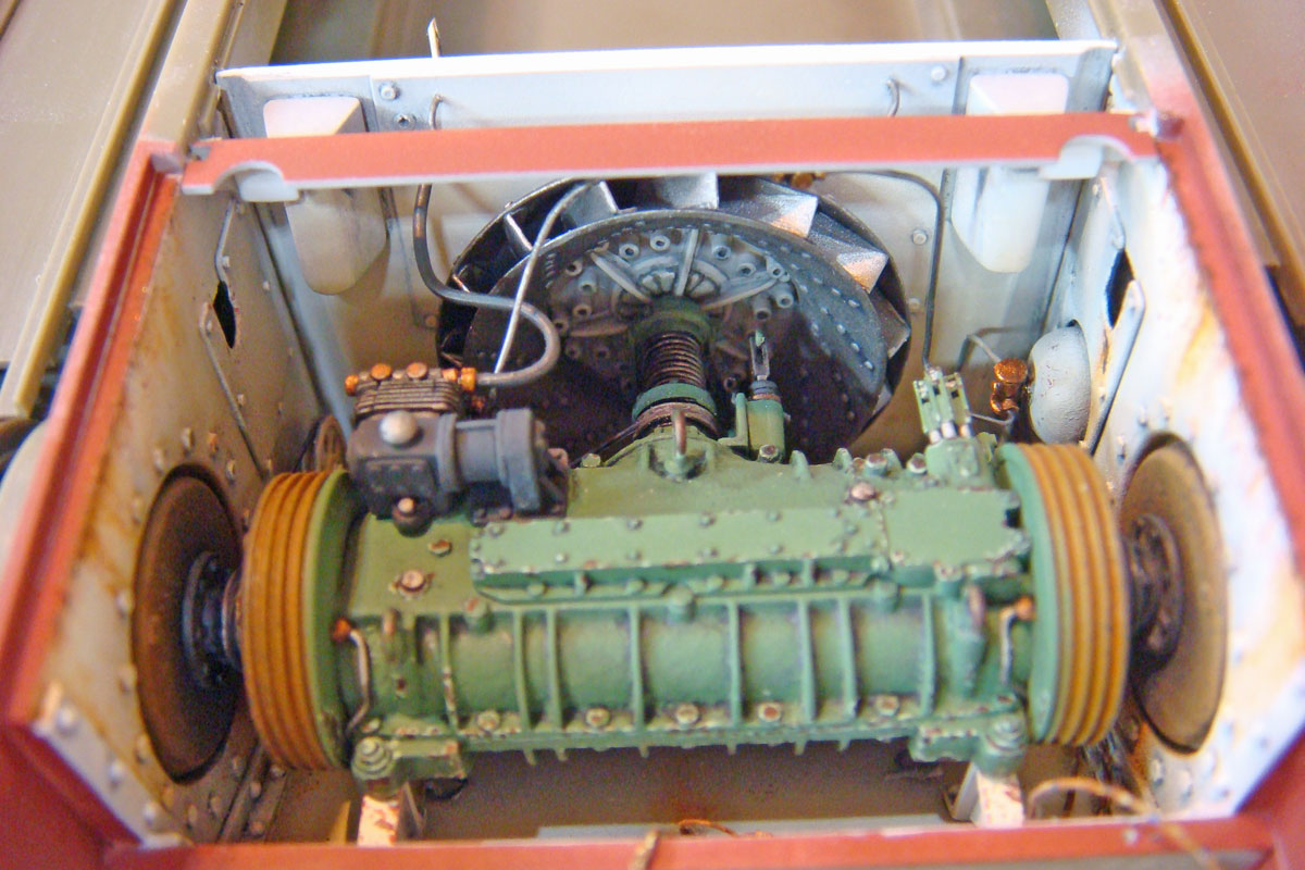

Here’s an example of a Churchill tank gearbox (which went into the back end of an AFV Club kit). I chose to laminate the styrene to build up the basic shapes, but there are other ways this could have been done.
The finished Churchill tank gearbox installed in the AFV Club kit.

You have discovered my secret. I never attempt to build anything to the exact dimension to start. Most parts are slightly oversized and then sanded/trimmed to final size.
You should know the mantra better than most: If you ain’t cheatin; you ain’t tryin’.
Excellent gearbox, by the way.

Cheers on the gearbox props!

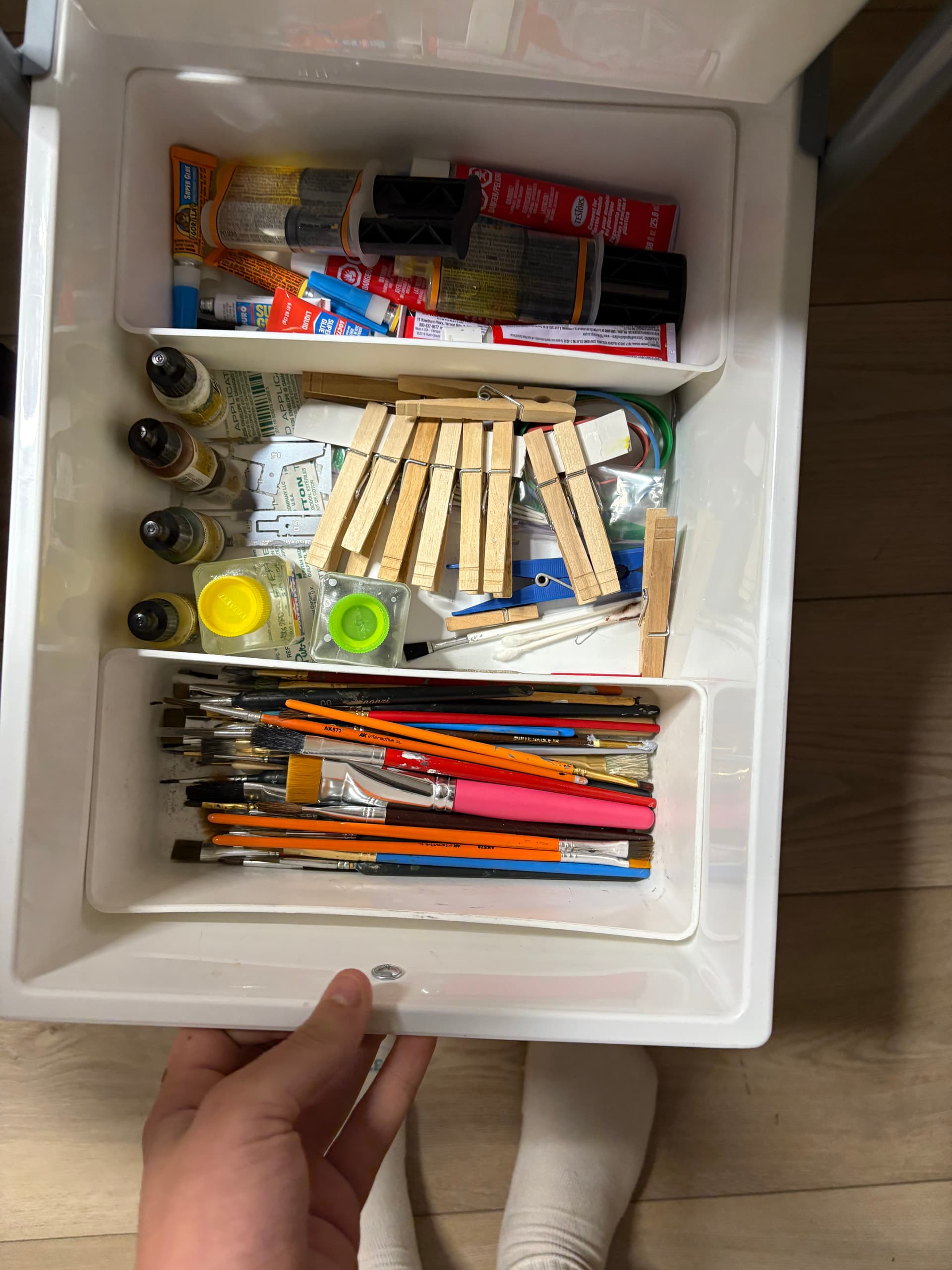

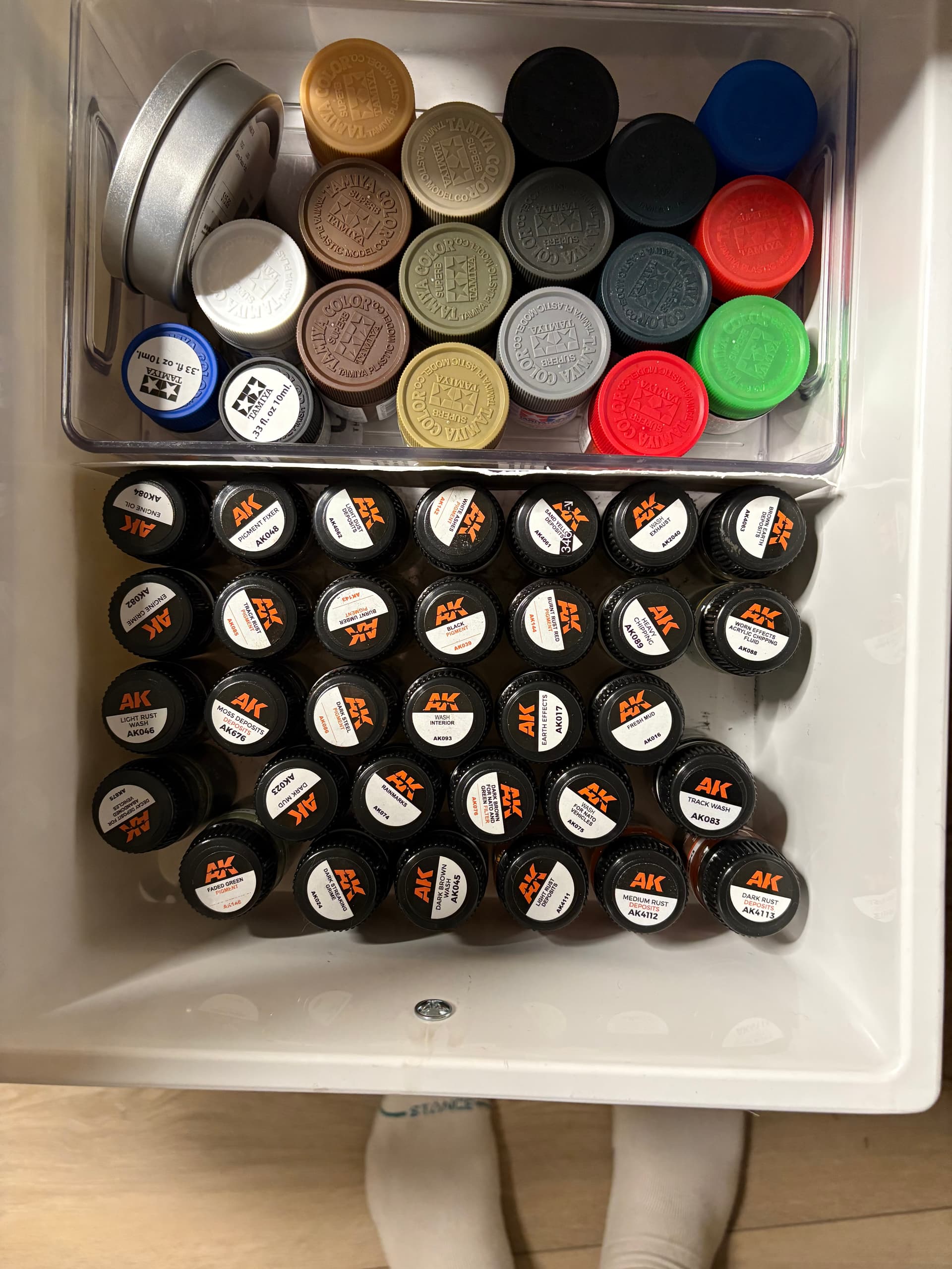

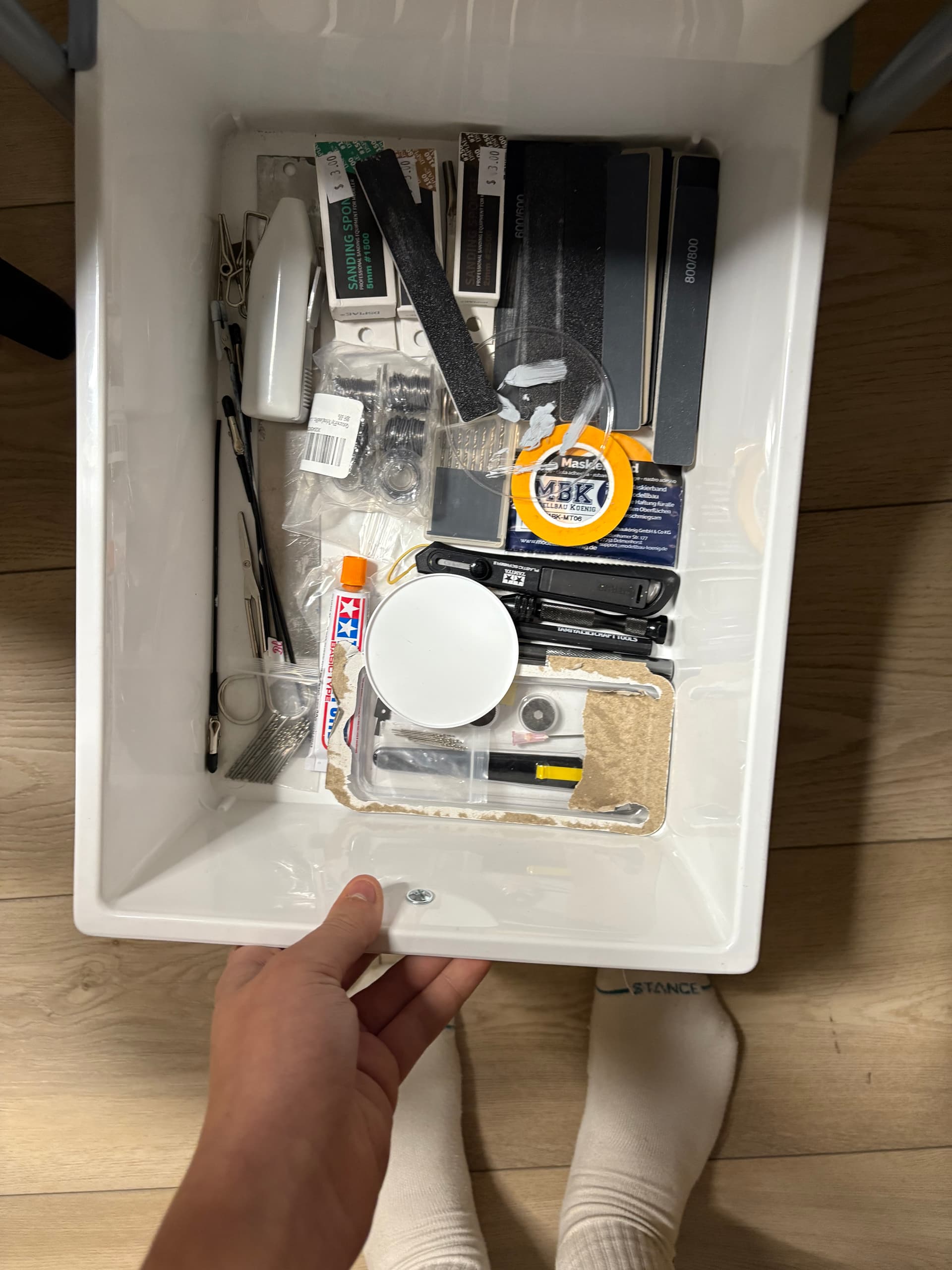

This is what I have for my modeling tools and paints, please recommend anything I don’t have or need.

Everyone’s needs are different. That may very well be all you need to accomplish your goals. The wooden clothes pins - I haven’t uesed them in decades, but found myself using them last week on my C-46. Who even knew trhey were still in the house? (nearly everyone has that drawer - you know - old AAA batteries, rubber bands, post it notes, clothes pins…)
No matter which genre you model, you may one day test out the waters with PE - a Hold and Fold is invaluable for this. You can even use it to make your own parts from brass shim stock, which itself is another good thing to have on hand.
Personally, I find I use my Dremel with either a rotary saw or a steel cutter almost every modeling day. And a pin vise with a nice assortment of micro drill bits.
An airbrush is not an absolute necessity, but they sure come in handy. They don’t have to be top of the line either - I started with one that used a spare tire as an air source.
Like any other hobby, you just need to decide what it is you want. Shooting for example. Hmmm…
Speed? Accuracy? Both? Neither, I just want to convert perfectly good bullets into loud noise at the range? You’ll find all of that right here. ![]()
You’d fit right in on AR15.com by the way - you’ve already got the obligatory feet in the photo technique down. At least your socks match.
Maybe a set of fine grade needle files.
Needle files + nippers make it easy to clean up the injection gates.
No need to destroy sharp scalpel blades by mistreating them with the
rough work of cleaning sprue gates and mold flash.
Saved me lots of money and fingertips …
Upon further review, I notice the pin vice. And a roach clip - always good for modeling. First down!

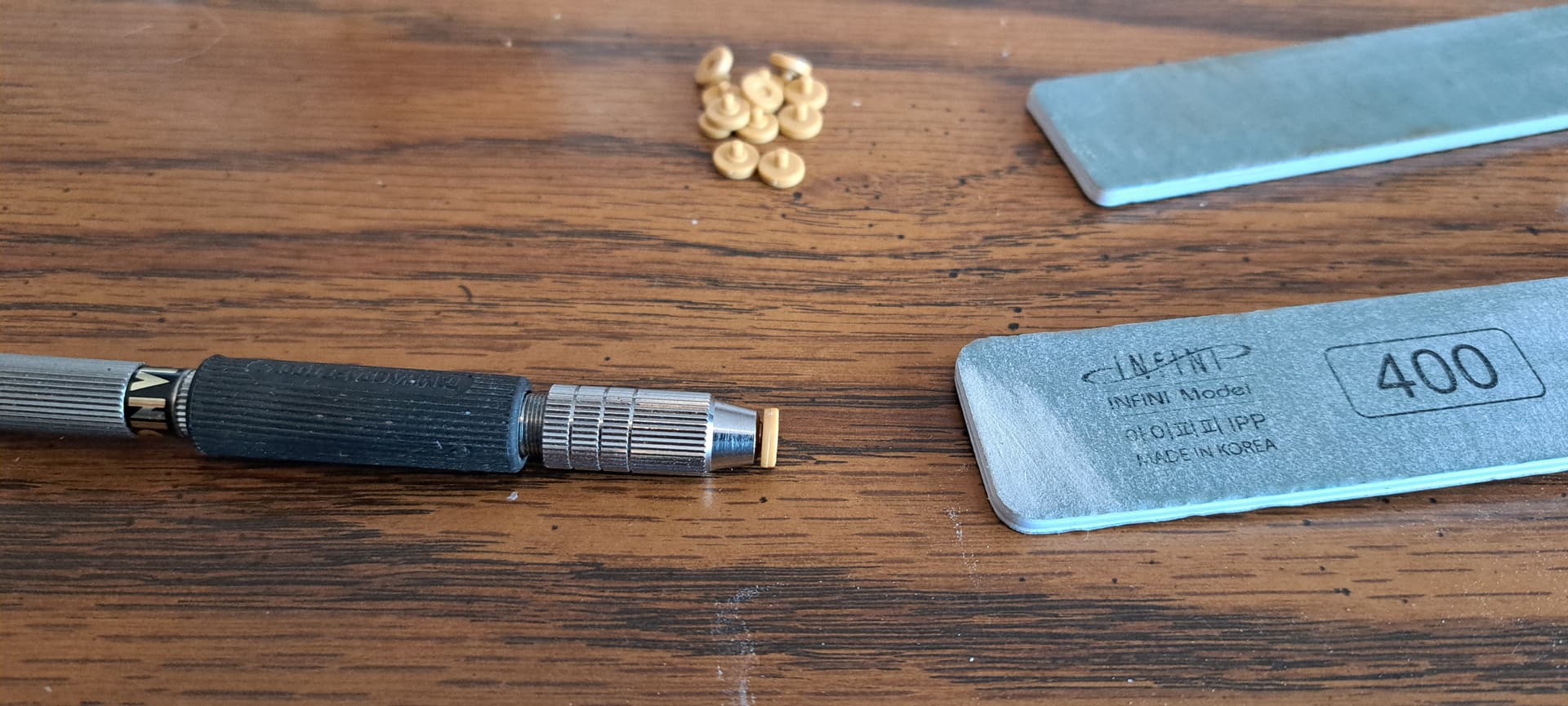

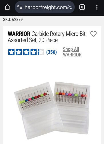

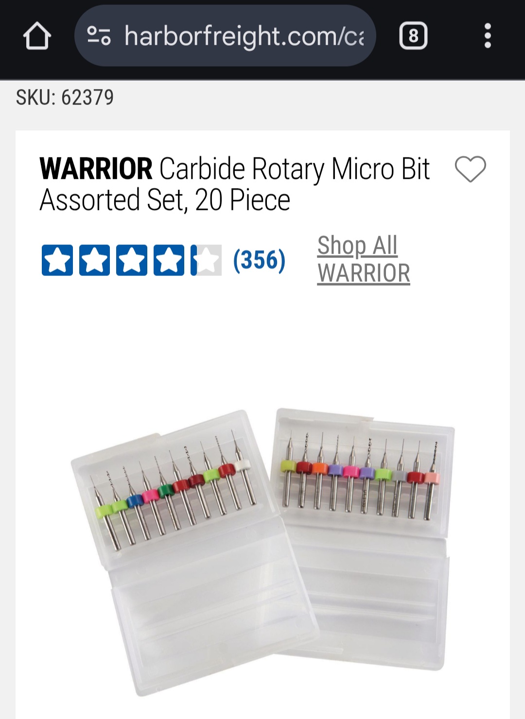

Speaking of model building tools, if there’s a Harbor Freight near you, for $7 these are fairly decent small drill bits. They can be held in hand or with larger pin vise etc.
There’s a lot of useful information in the various build threads on the forum regarding tools, tips & techniques.
Example some types return rollers can be mounted in pin vise to help remove mold seams with sanding stick
