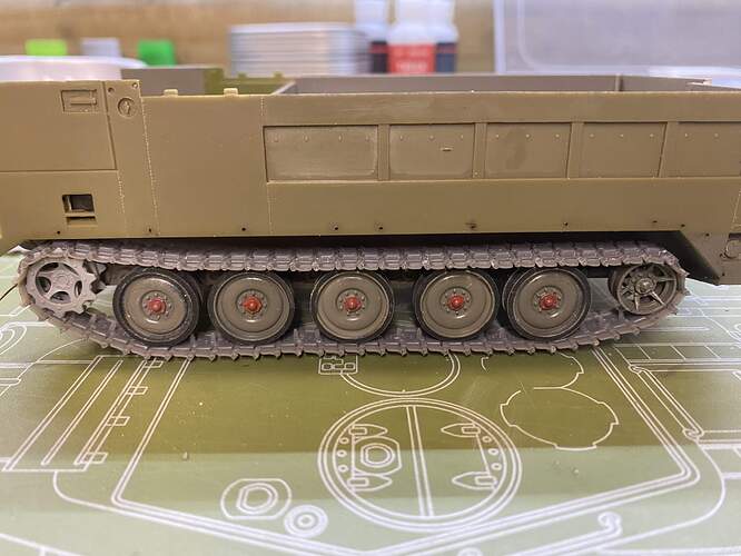

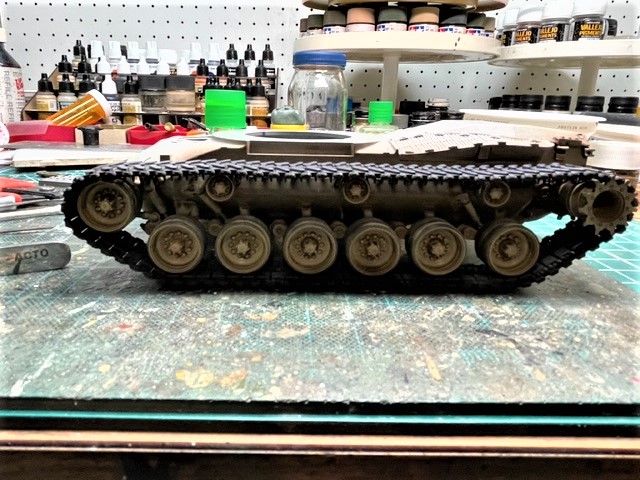

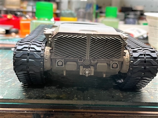

64 links per side of the Fat Frog tracks. 63 is too tight- I think if the track is properly adjusted the top run should just touch the top of the middle road wheel. Real thing is 65 per side.
To quote @Armor_Buff , “4 hours 16 minutes assembly time.”

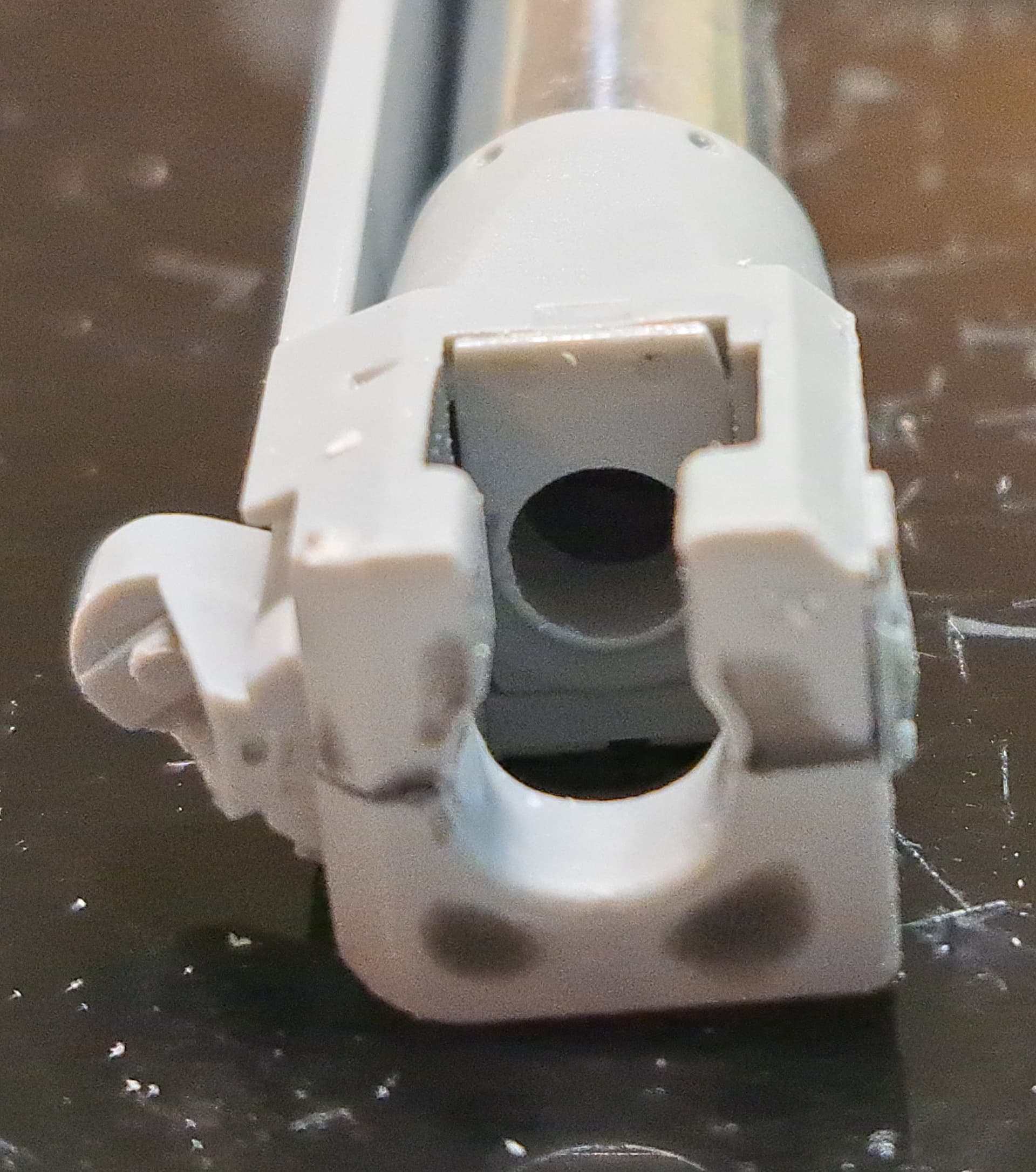

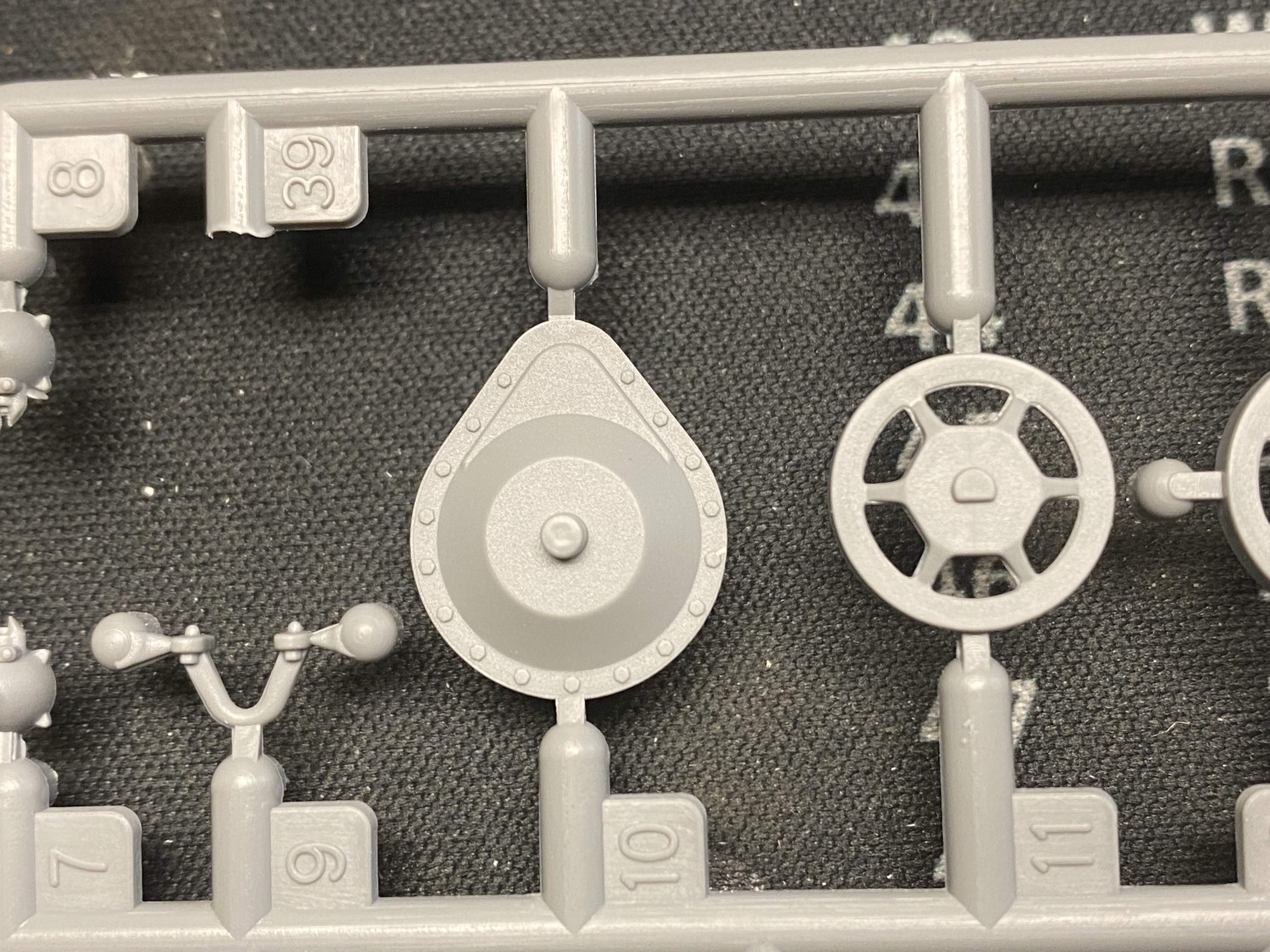

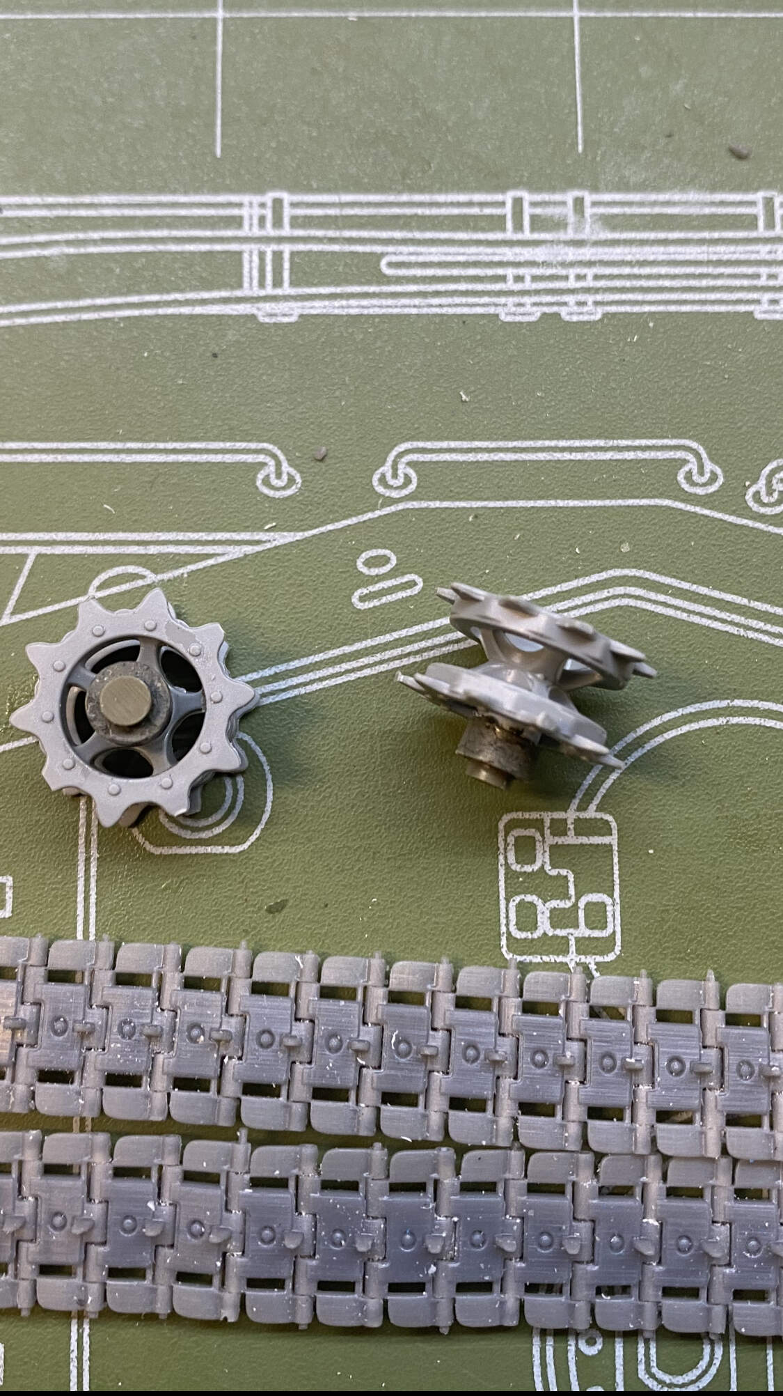

And if anyone cares, this is a Dragon M113 final drive:

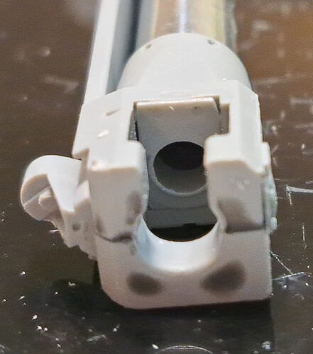

And this is basically what Academy, old AFV Club and Tamiya’s M113 final drive looks like. Tamiya has a blind hole, but the depth and major inner diameter are the same.
Modified Dragon drive sprockets.

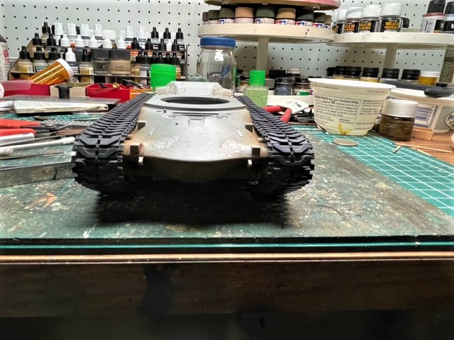

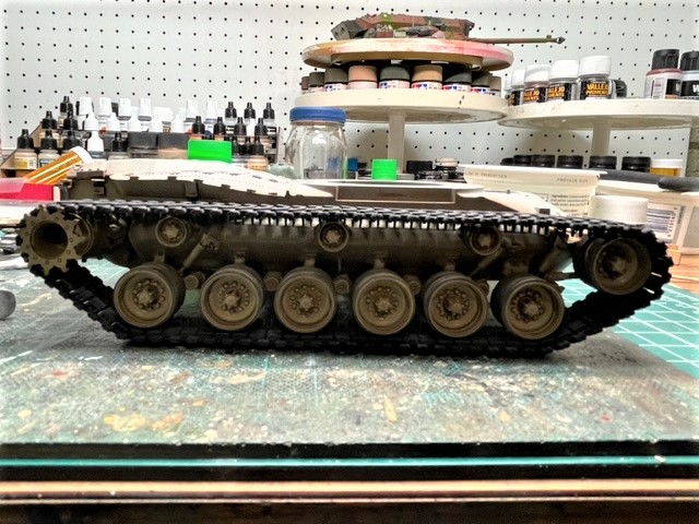

FINALLY!!! Two weeks after I received the TakomM48/60 tracks I have both runs together. The Magach build stalled while I was waiting for them to arrive but then real life intervened and really cut into the bench time. Like I always say “No plan survives contact with the enemy.” If you have high end nippers i.e. God Hand or ZM then clean up is minimal and they go together nicely with a bit of care if you want them to remain workable. There are enough links to do 2 complete runs (box says 78 links each) plus about 8-10 extras in case you lose some or screw up. Decided not to try to reposition the idlers as that that would necessitate not just removing and repositioning them but I would need to cut and lengthen the adjusting rod. I can live with it and they don’t seem to be as loose as I first thought. With any luck I just might get the upper hull finished by the weekend. The DS tracks will go on the Revell West German M48A2.
Al, the tracks look fantastic to me! Very nice!
4 hours 16 minutes well spent!

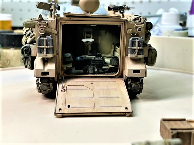

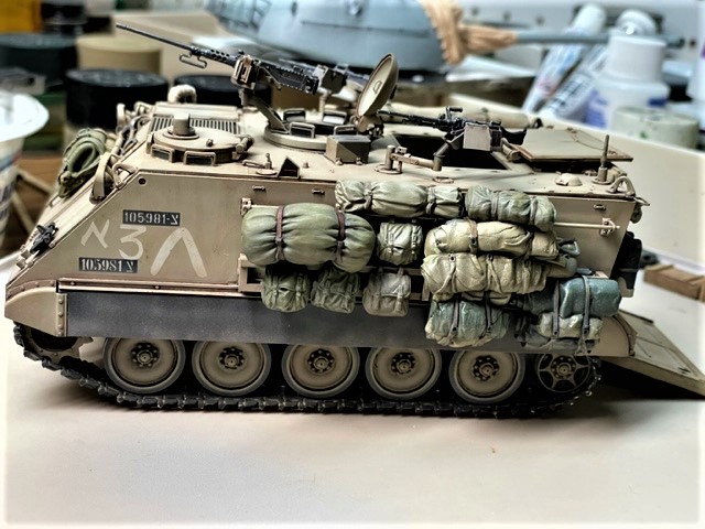

IDF113#3
IDF113
IDF113#2

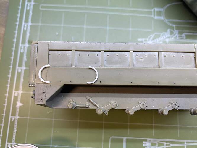

Anyhow, after being inspired by our own mad scientist @justsendit , I coiled a bunch of evergreen channel and angle pieces around a hole transfer punch, clamped it and tossed it into some very hot water in a Tupperware dish.
This was what it looked like after it cooled. (These remind me of the centering spring found in Harley Davidson 5 speed transmissions)
This took longer than I care to admit.
“Why are you wasting my time with this stuff, Al?” You might be asking….
So here’s where I am:
All this nonsense ate up a sizable portion of the morning and I still have some trimming to complete, but what else do I have to do?

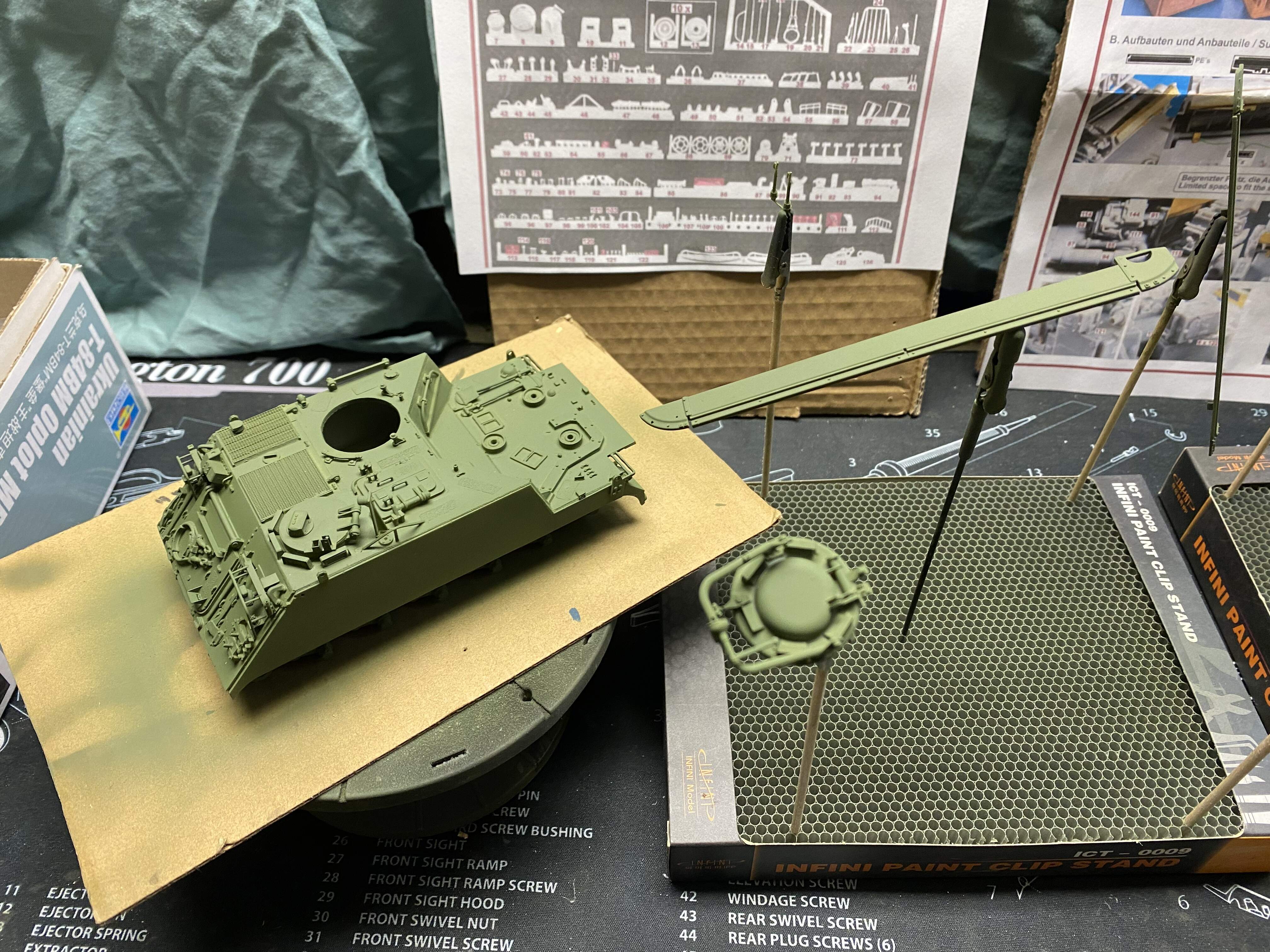

Big day in the paint shop. Flat coat on my Humber Scout Car and ASLAV-R, primer and base coats down on the SdKfz 263 and the Landrover WMIK with Milan, and white sprayed inside the Renault FT.
I haven’t laid this much paint since the wife voluntered me to paint the son’s entire house…

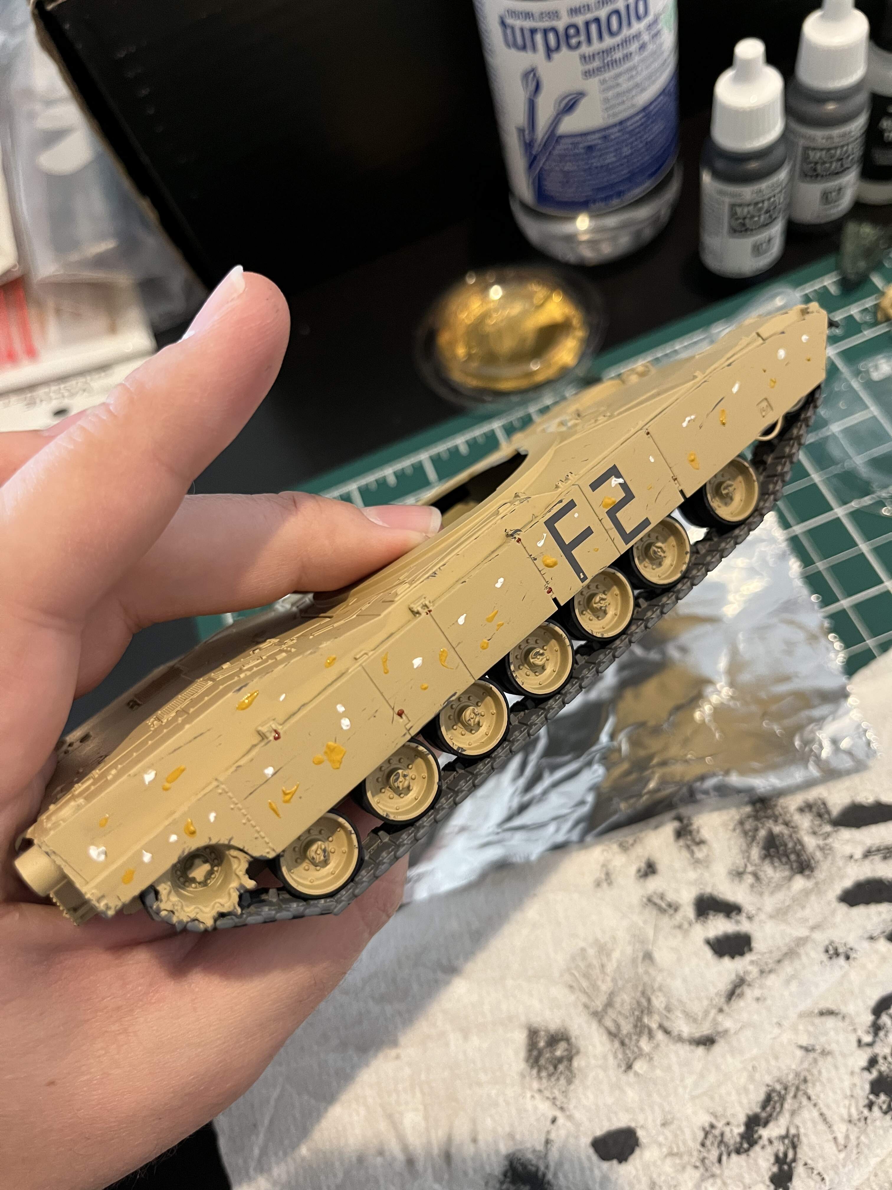

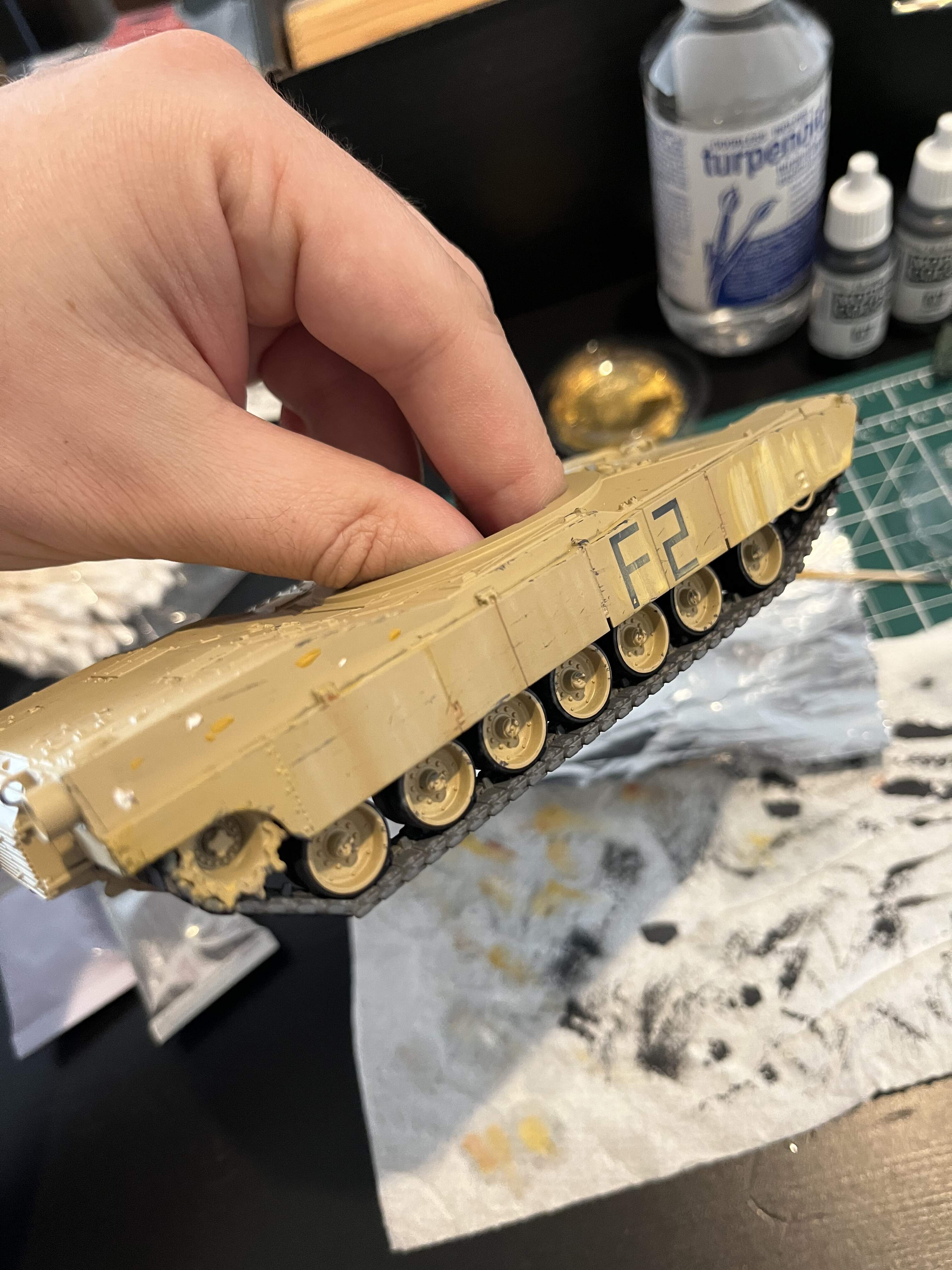

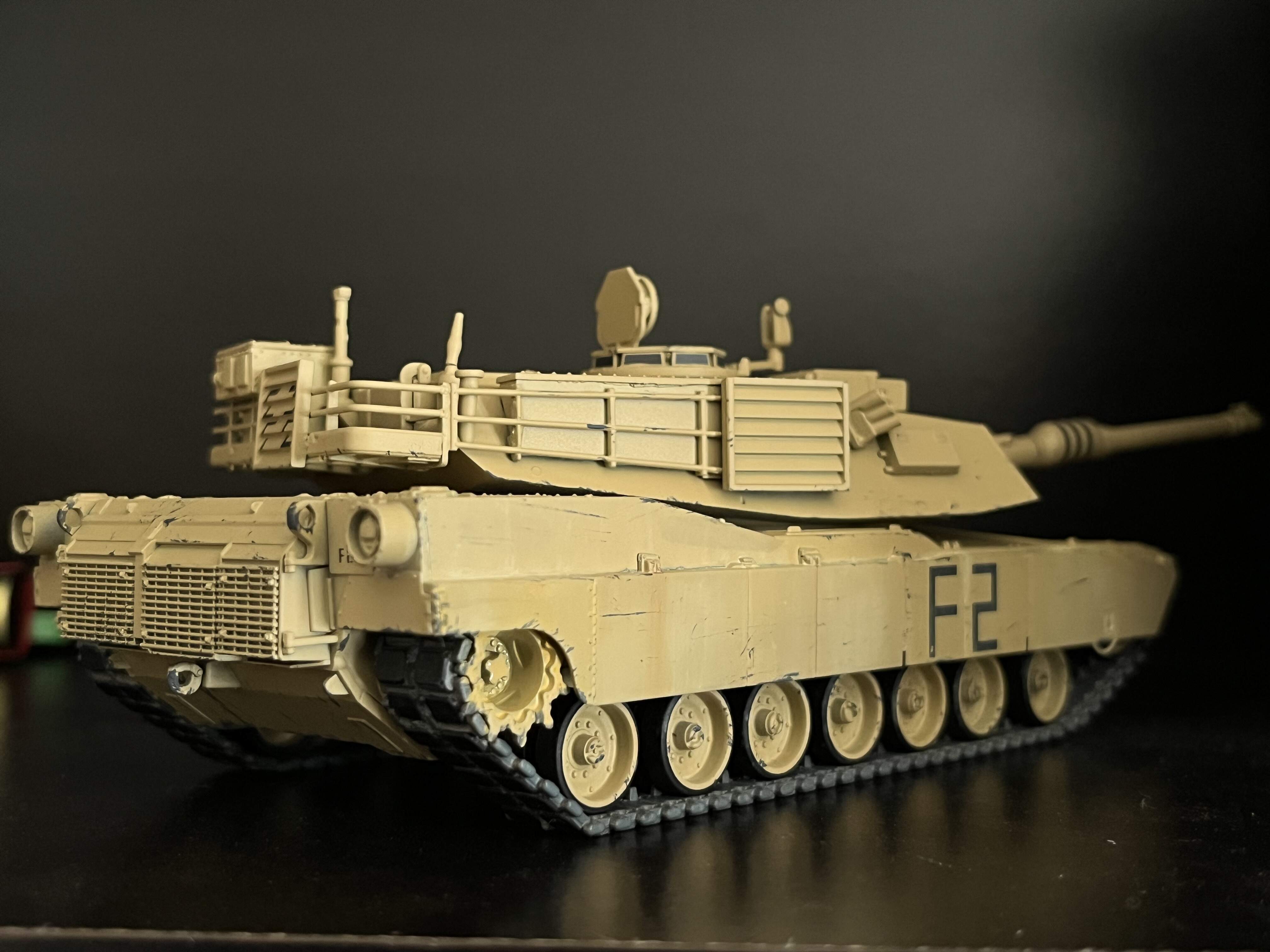

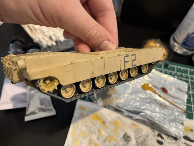

Picked up the 1/48 Abrams to finally tackle the oil weathering after putting it off for about three years.
Fairly happy with the progress so far.
