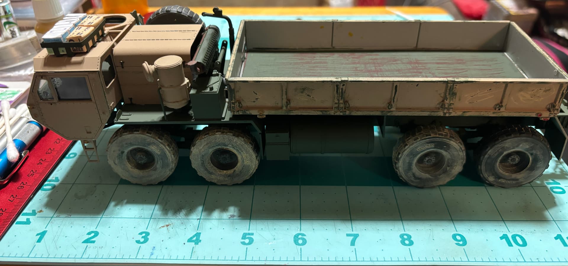

The cargo bed is progressing…
I made the new tie-down points out of the afore mentioned .022 mm solder. I think they look OK. They aren’t all perfectly uniform; but still.
I used Tamiya XF-67 NATO Green as the base color. I then put on a light coat of flat varnish and a hairspray coat.
The top coat is Taimya XF-78 Deck Tan.
Hopefully work won’t get in the way too much and I can start chipping and maybe touch up a couple areas. More to follow.

They shouldn’t be uniform after repeated use they bend, and some are missing I think it looks great
Thanks! I was thinking that there would be a fair amount of wear and tear; but you know how the rabid rivet counters get! :crazy_face:

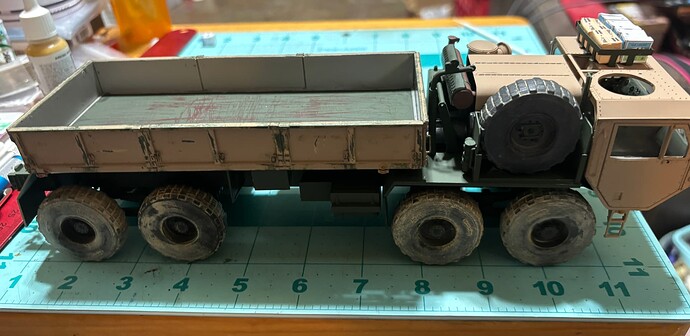

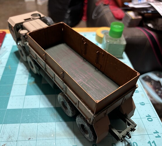

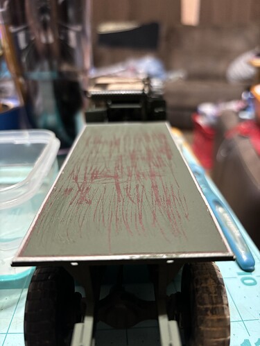

Here’s how the scratching and chipping turned out on the bed too.
I didn’t want to get crazy with it since a lot of it is going to be covered up by the gun mounts and gear I’m working on.
Looking good. I like the tie-downs and how the bed turned out.
Thanks, Gino! Hairspray chipping is still something I’m pretty new at. It’s a fine line between realistic and overdone.
I guess in the end, it’s only paint! :crazy_face:

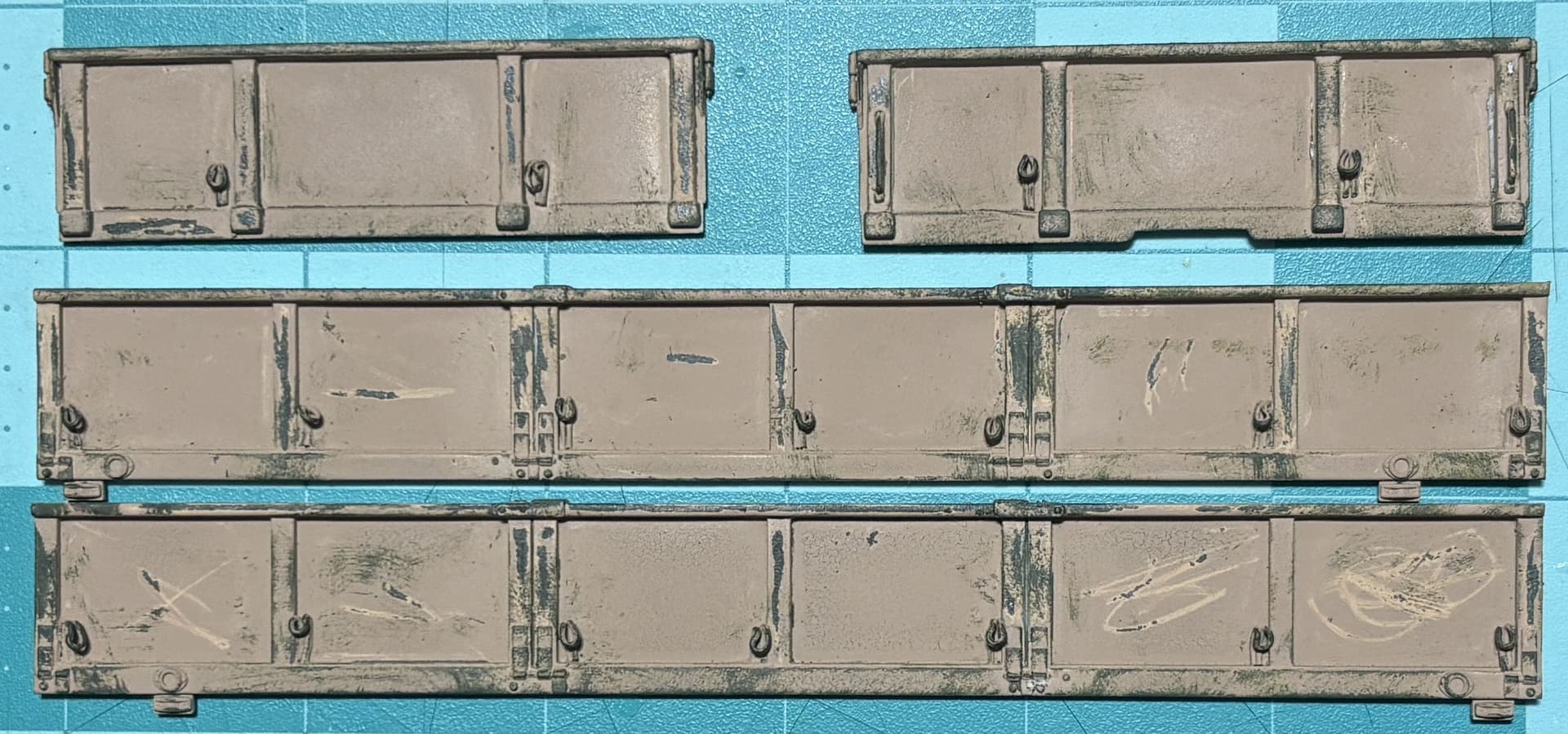

Here are the sides of the cargo bed chipped and dry brushed. I still have to paint the reflectors and side lights.

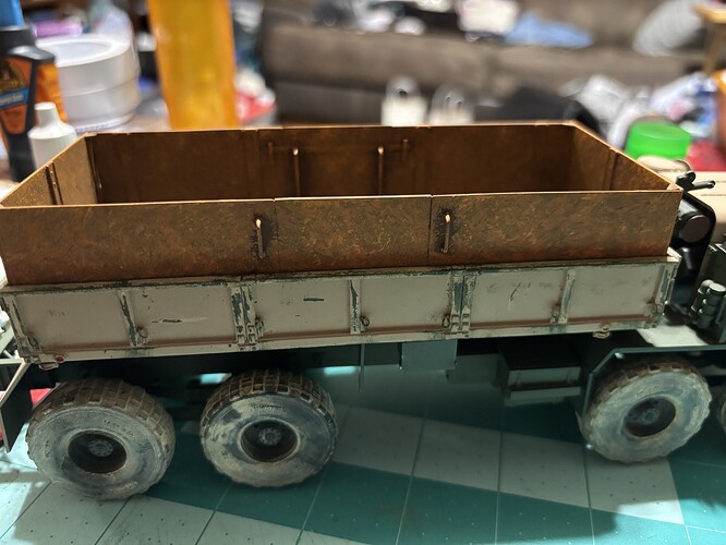

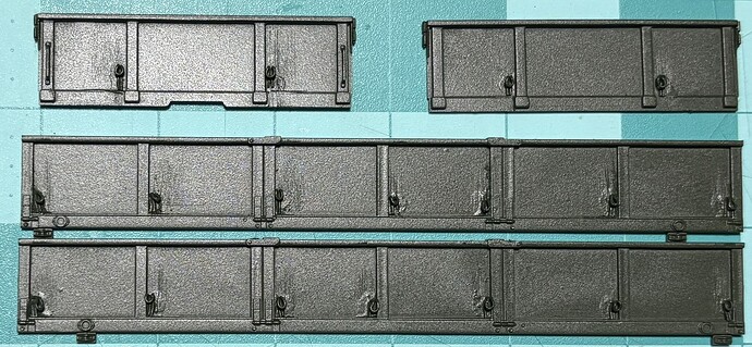

The bed armor is finished! It was my first time using AK’s Rust Deposits set.

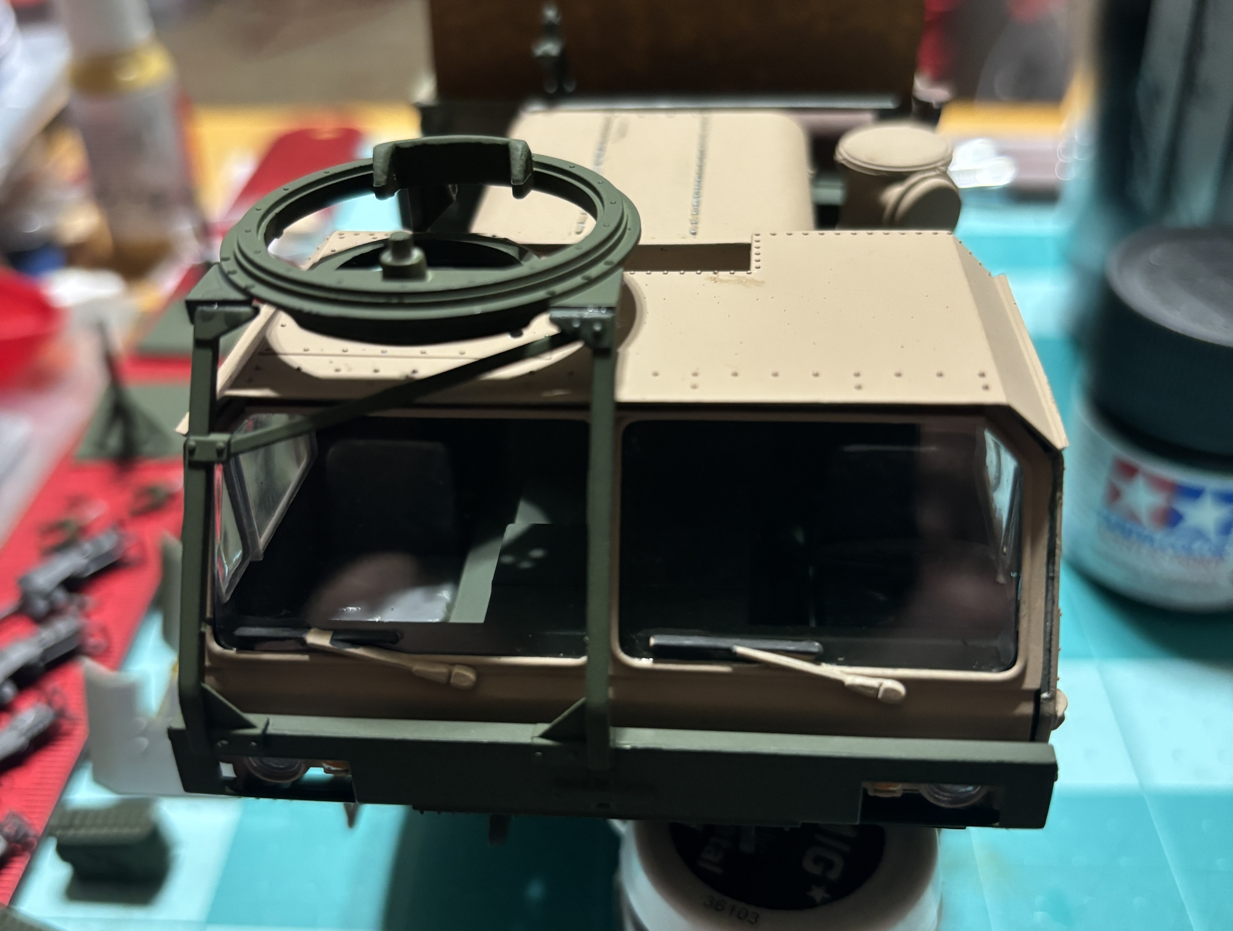

After a fun weekend at the lake playing ham radio guy, I managed to find some time today to get the turret ring mounted to the cab.
I’ve got the Mark 19s and the Ma Deuces painted and dusted with some Mig Gun Metal pigment. I still have to paint the shields and ammo; but for being a dog of a kit I’m actually liking how it’s coming together.
It is coming along great. The old Italeri kits can still come out pretty nicely with a bit of work.
Thanks, Gino! I’ve still got the assemble the crane and do some detailing on it then it will just be a matter of putting the finishing touches on the whole thing. :partying_face:
