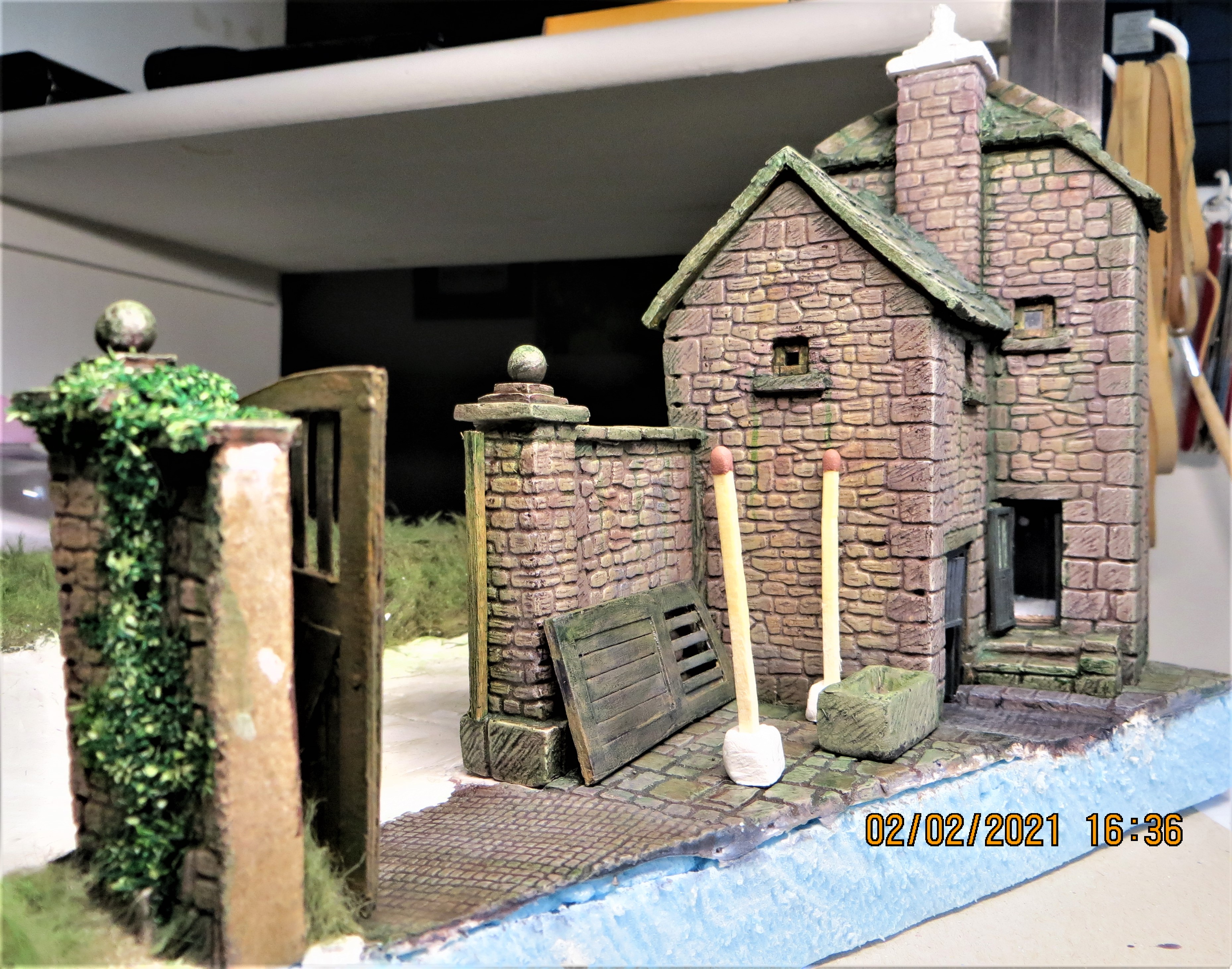

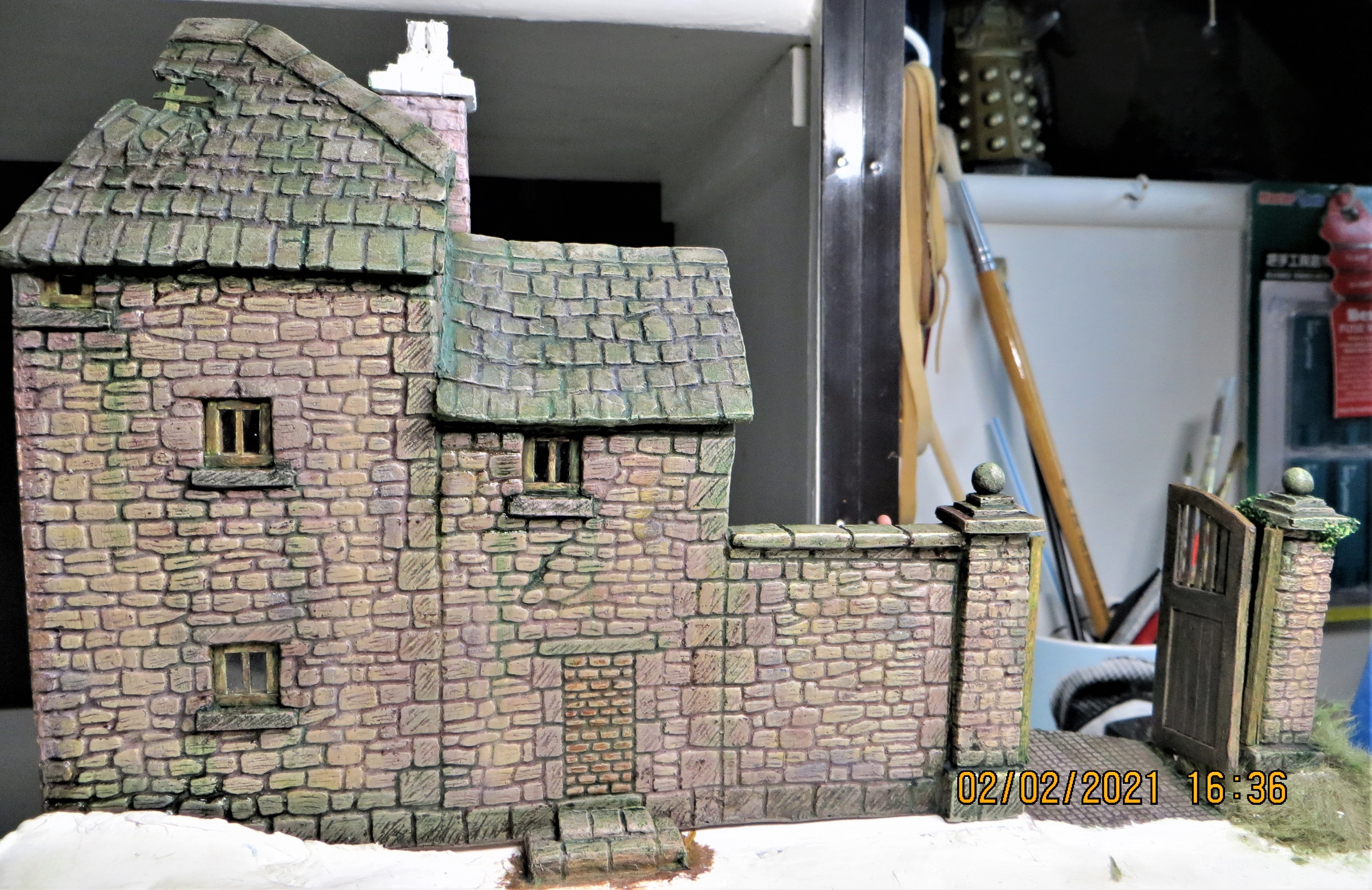

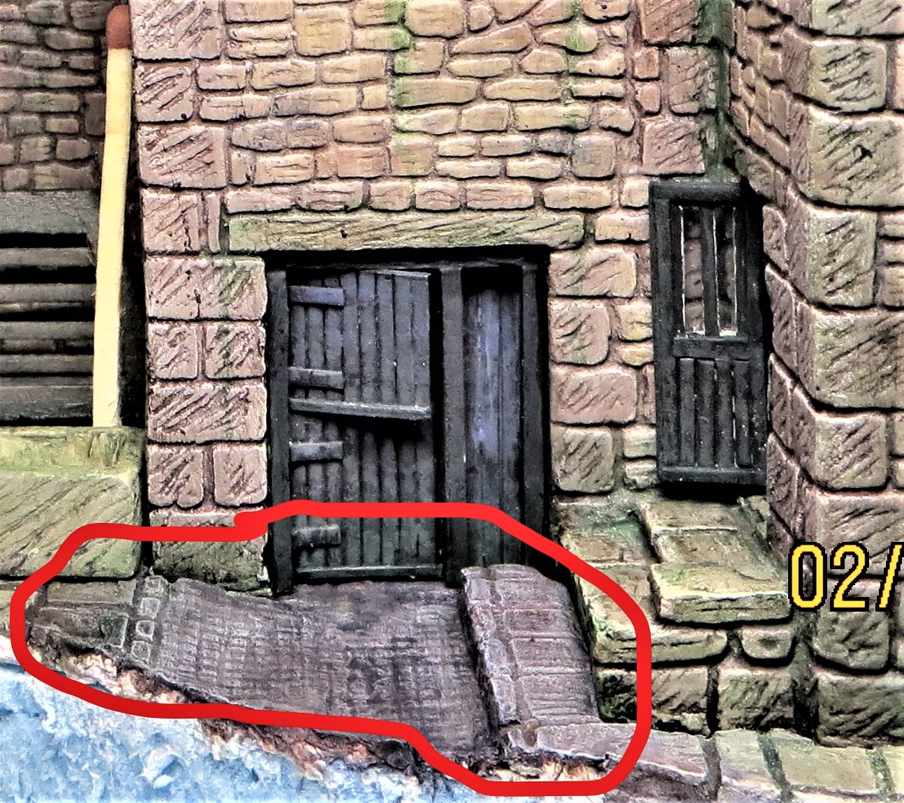

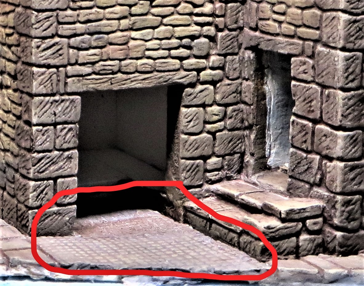

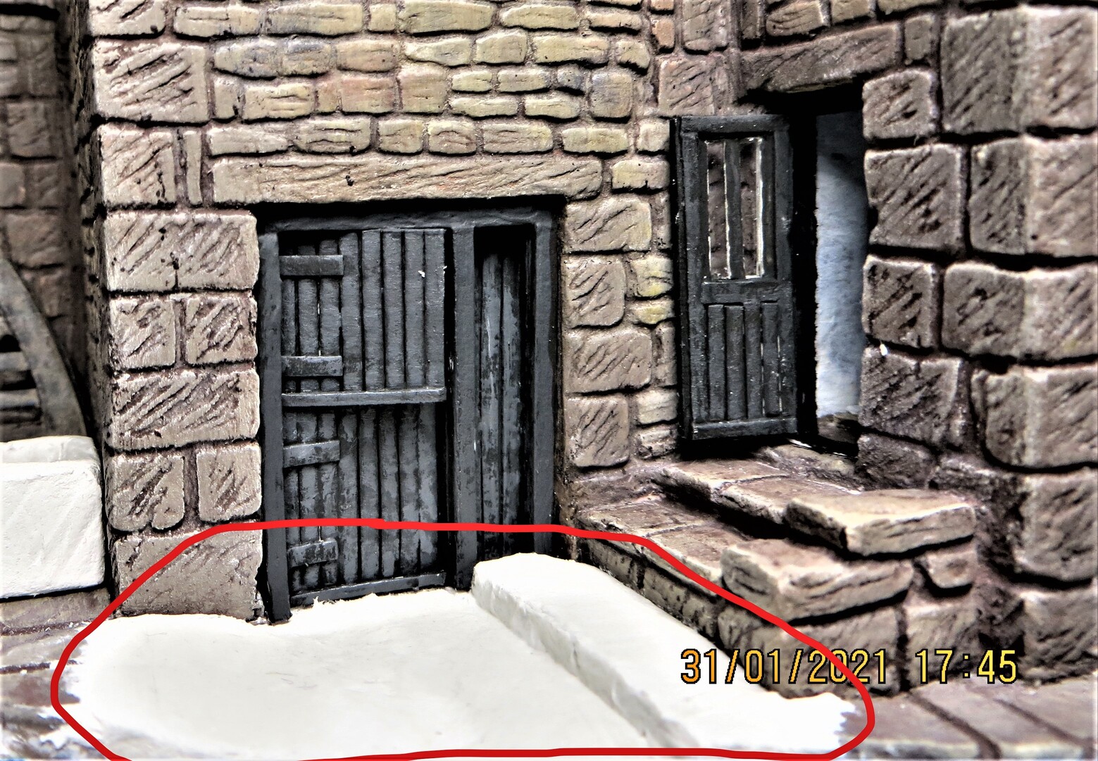

Had to rectify a schoolboy error, I discovered that my stable door wouldn’t have theoretically been openable as the doors would open outwards and the groundwork in front was too high so would have fouled it, :angry:.
So I dug up the incorrect area…
Put down some fresh DAS and rescribed the area…
And have now started to repaint it…
Phew! :slightly_smiling_face:.
Cheers, :beer:,
G

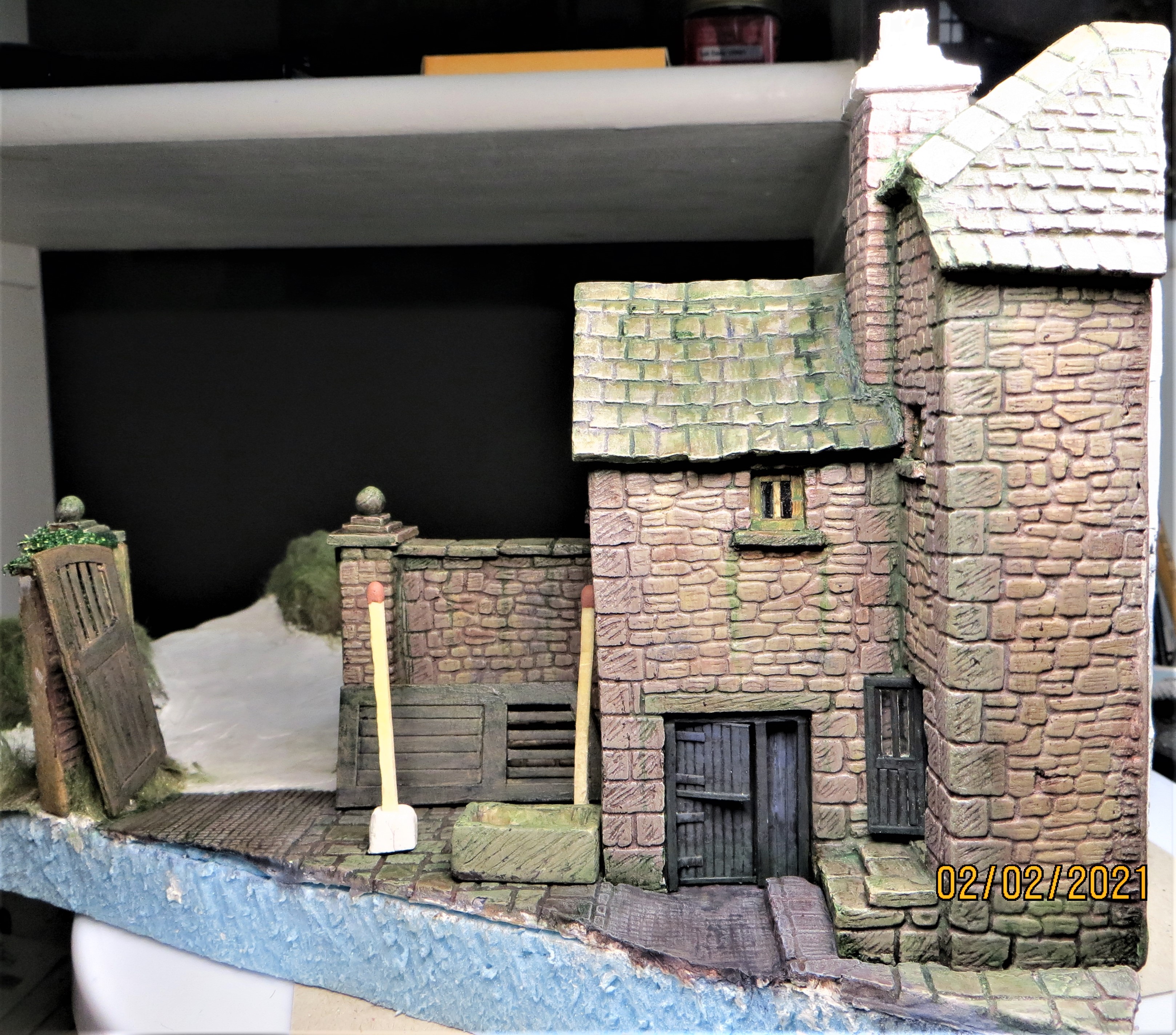

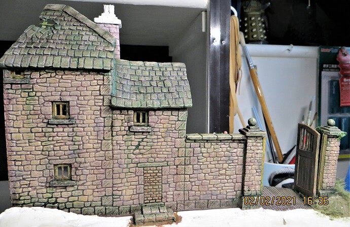

Hi all,
Also spent some time starting to weather the building, working on the chimney, and beginning to work on the posts for the lean to. The DAS forming the stone post supports will be filed square and scribed and painted once the clay has fully dried.
Cheers, :beer:,
G
Some great colours and tones being laid down there. And the lean to posts… Genius !!
Thanks John, your feedback is much appreciated, :slightly_smiling_face:.
G

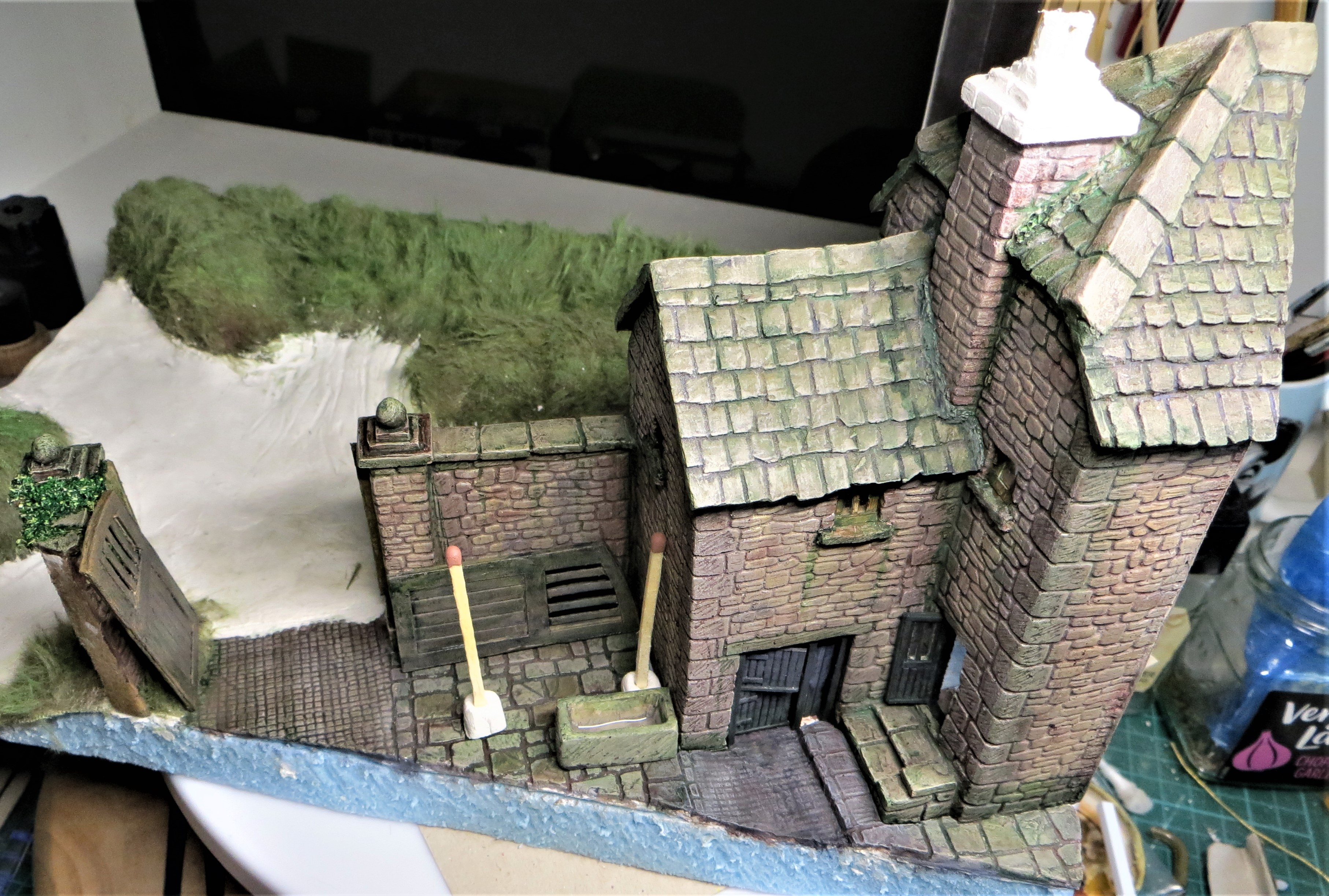

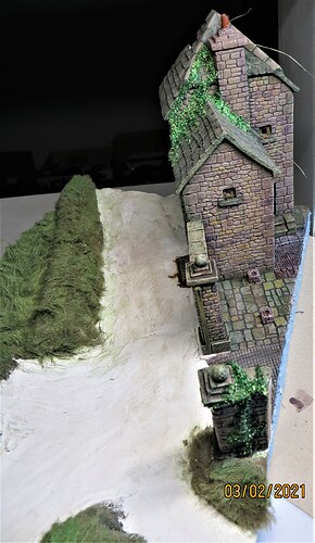

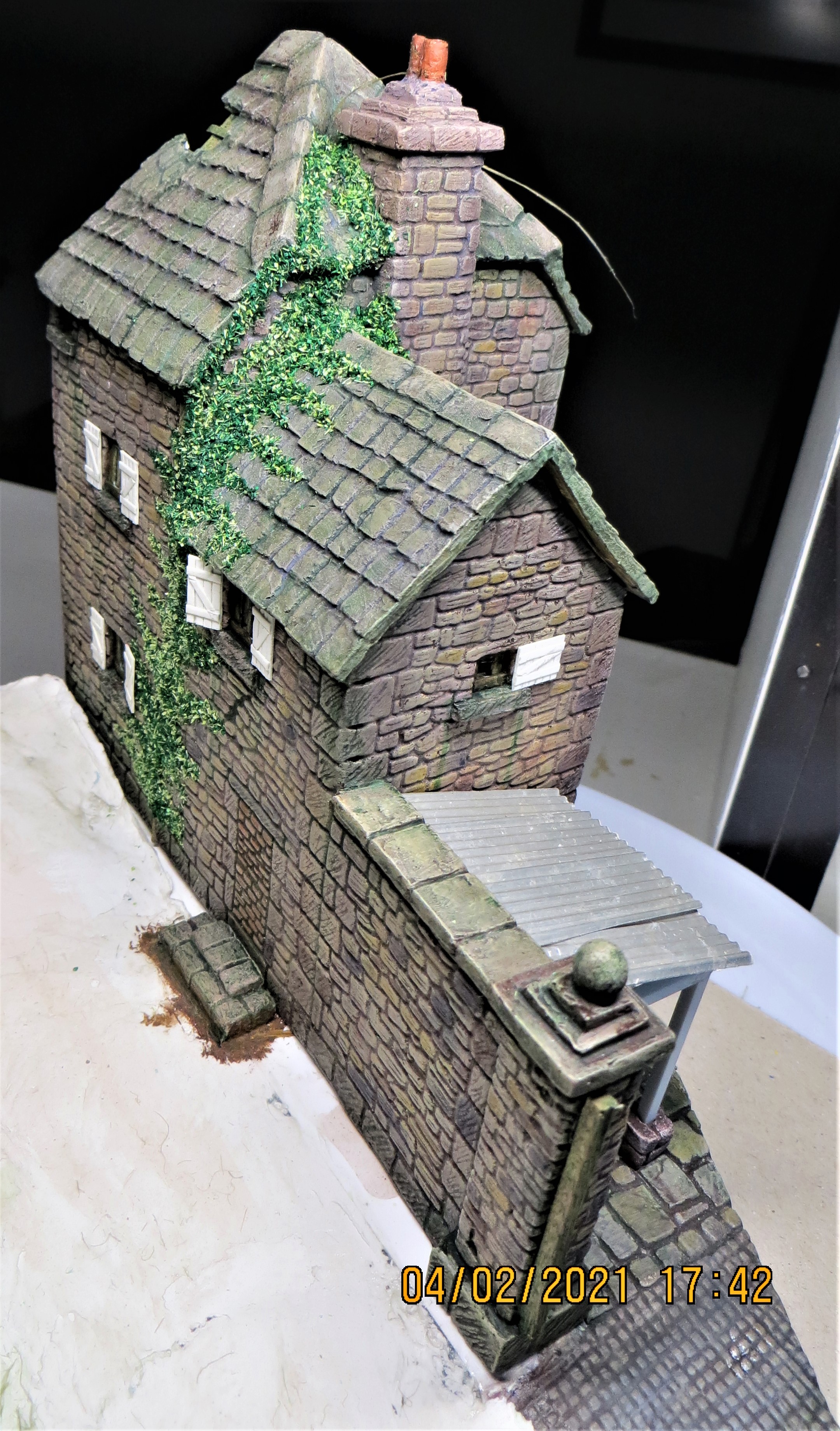

Hi all,
Had a couple of hours to spare so thought I’d paint up the chimney and start to add some ivy, :slightly_smiling_face:.
I will apply a second layer once dry to bulk it up, and trim off the twine branches that are hanging down the back.
Cheers, :beer:,
G
That’s looking great G. The ivy gives it the olde worldy look. It’s a little masterpiece in the making.:+1:
Thanks John, :slightly_smiling_face: :+1:.

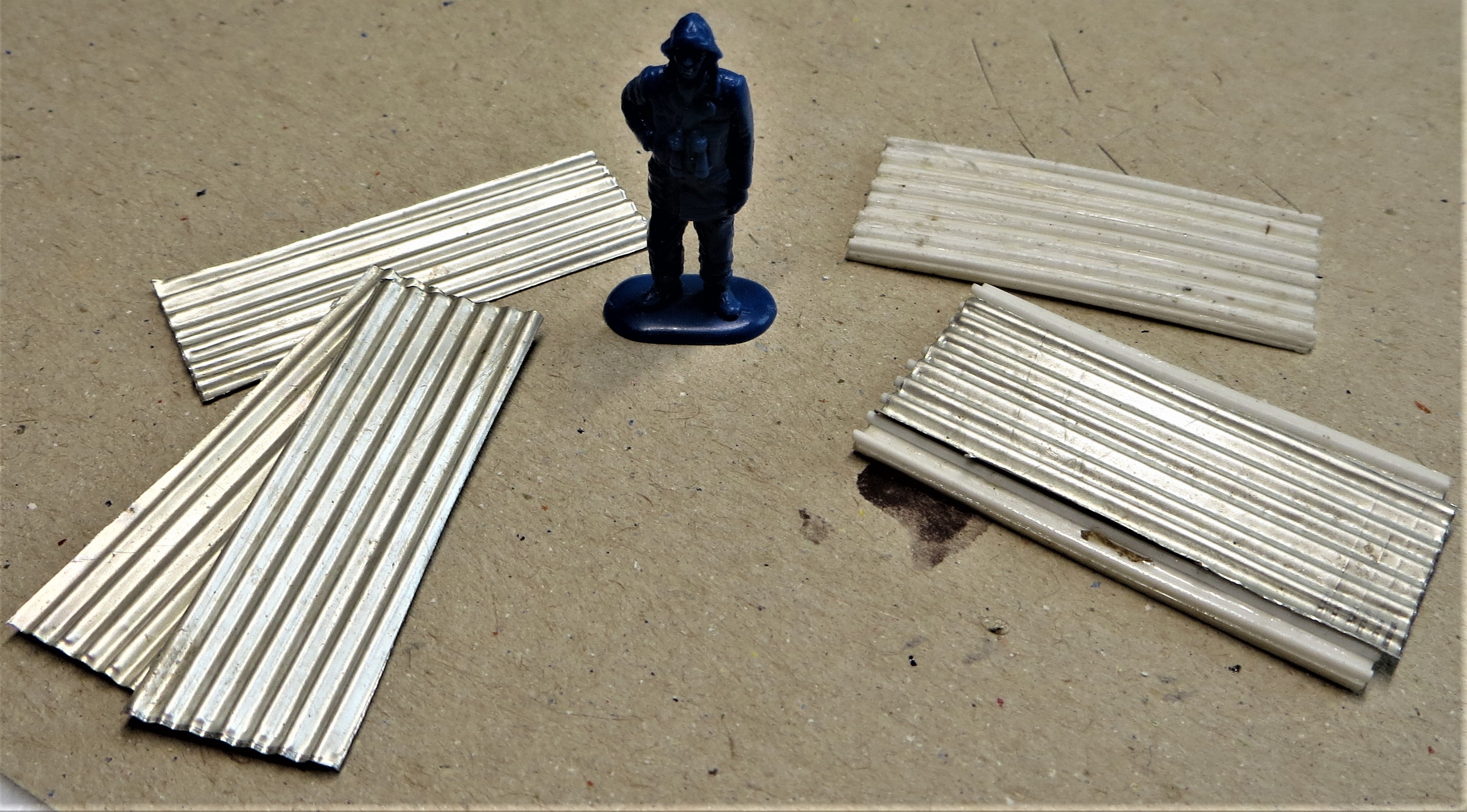

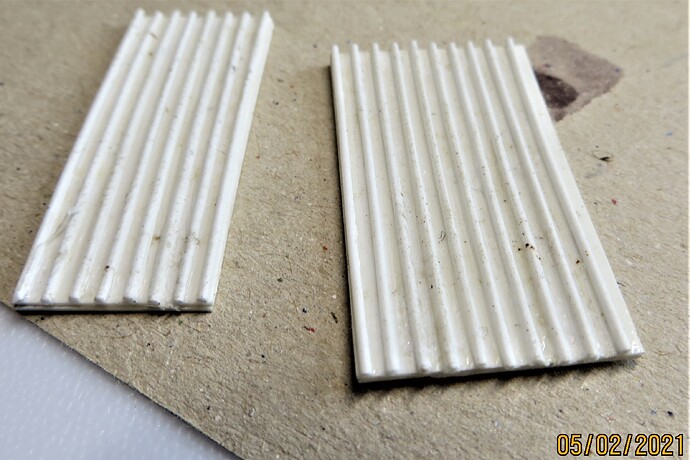

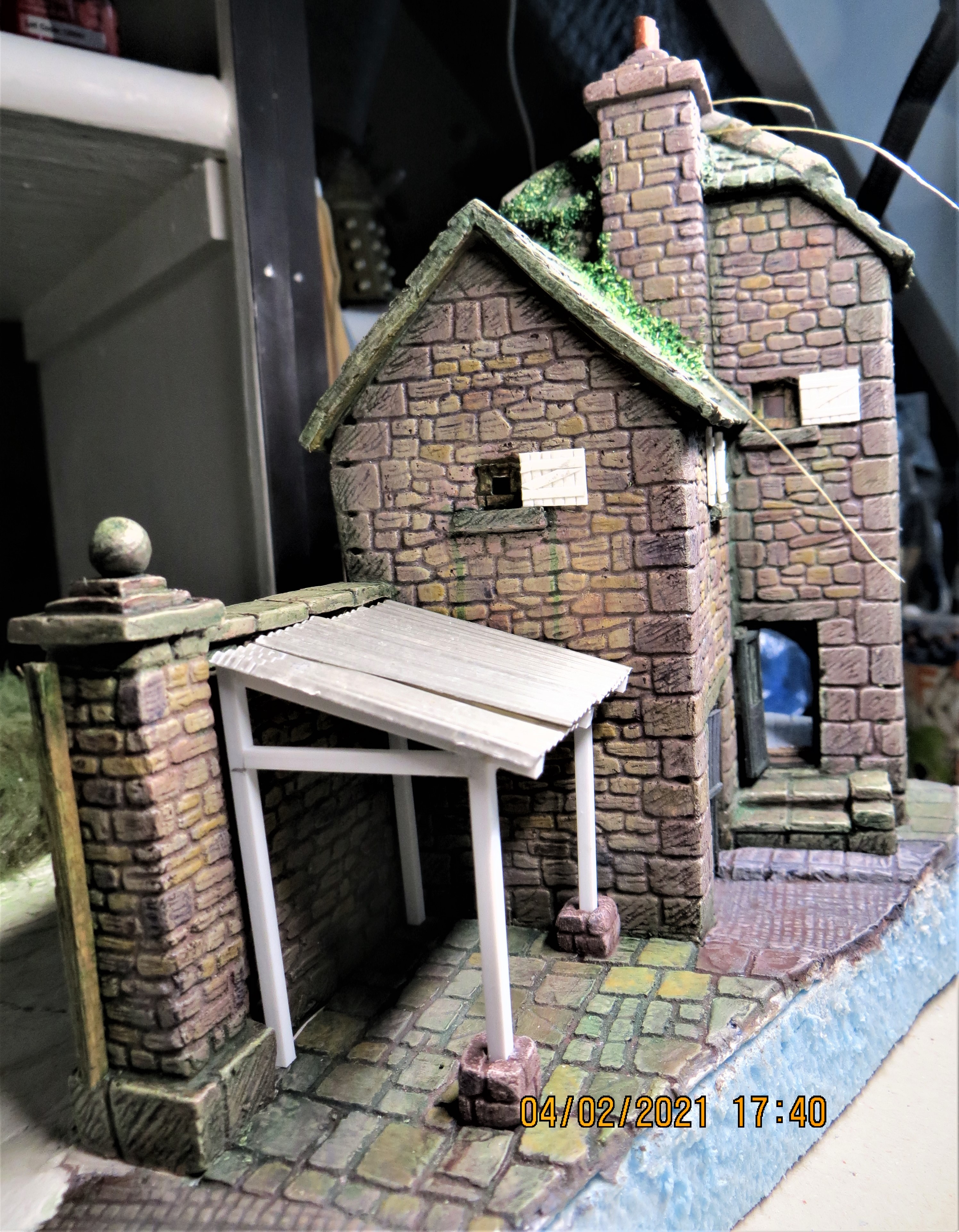

Spent an hour cobbling together a jig to make a few sheets of corrugated iron for the lean to roof, not accurate, but it’s the best I can do for now, :roll_eyes:.
I had intended to purchase a corr-a-gator in both 1/35th and 1/72nd, but the companies over here I’ve looked at don’t have them in stock, and delivery from the states, at the moment, is crazy, :pensive:.
G

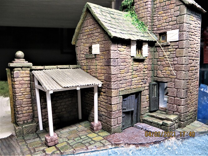

Hi all,
Added some shutters to some of the windows, and started building the lean to frame,
Cheers, :beer:,
G

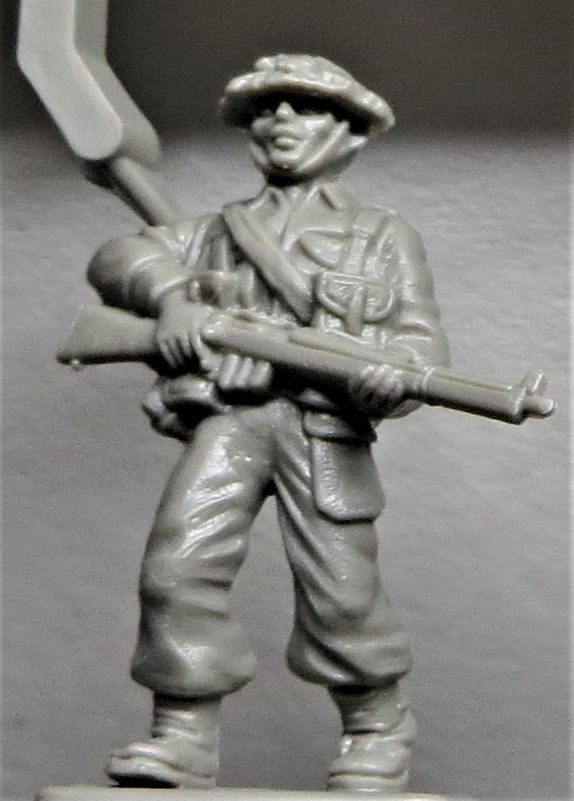

Hi all,

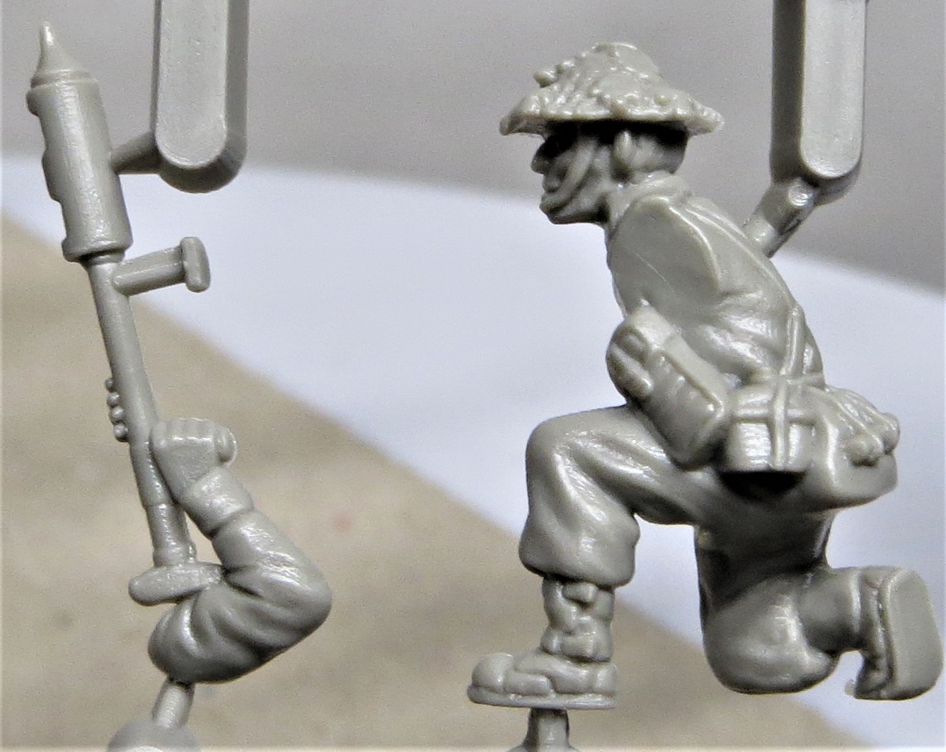

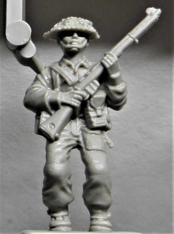

Finally, some plastic arrived today in the form of my figures for this build, first glance looks very promising, :slightly_smiling_face:.
Cheers, :beer:,
G
Shutters make a big difference to overall look of the farmhouse and Lok very nice.
The lean to gives the courtyard a nice feel of authenticity. How did you do the corrugated sheets? They look great to me and once weathered will be perfect :+1:
Those figures look cool and nicely detailed… Painting them is going to be fun …

John,

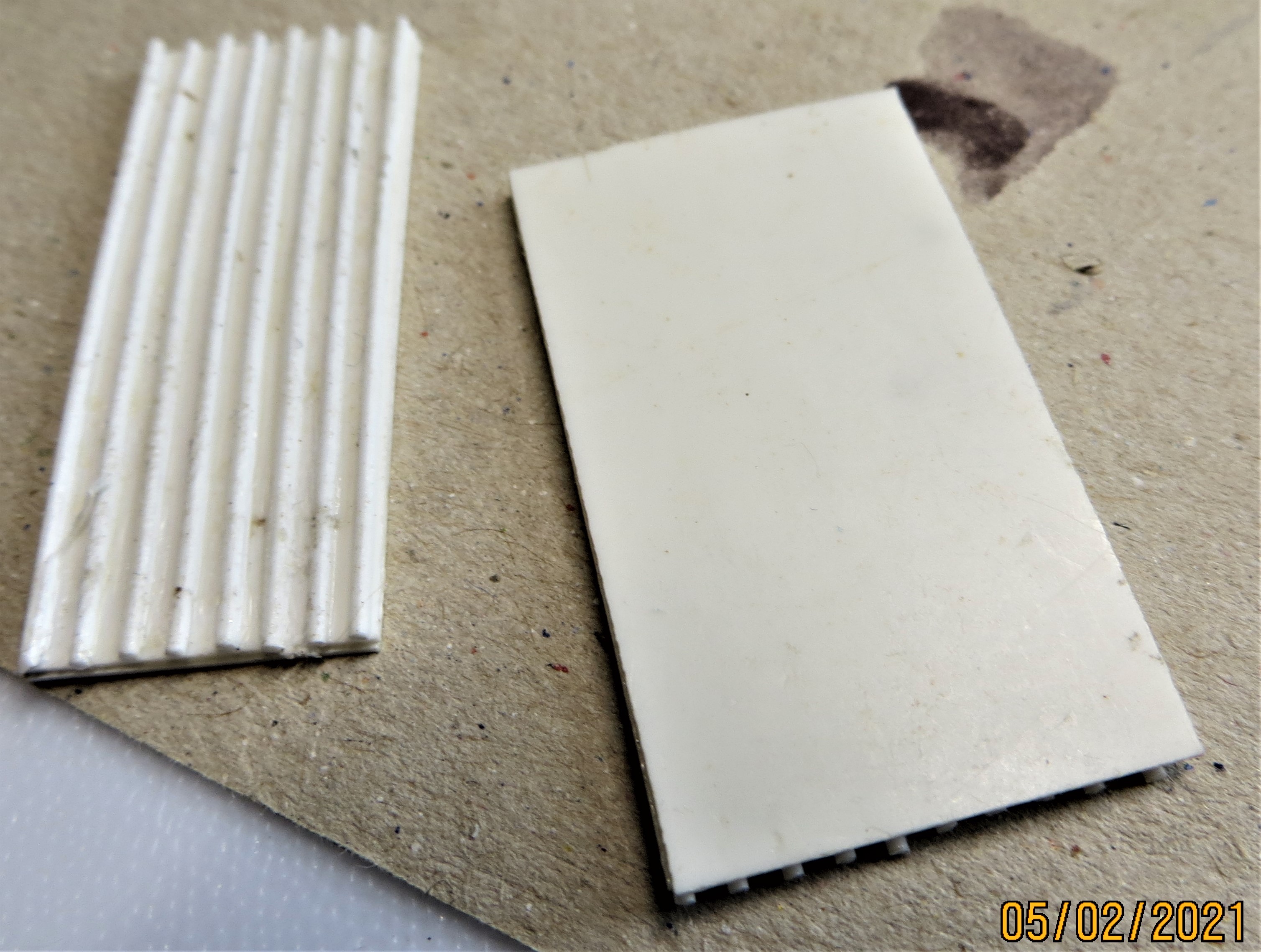

The corrugated sheet was made from a thin aluminium, cut from a ready made meal tray, and pressed between a rough-and-ready little jig I cobbled together from 0.8mm styrene rod and plasticard (see images below).
I sandwich the aluminium between the two parts and squeeze gently in a bench vice. It isn’t probably that accurate…hence wanting to eventually purchase the ‘corr-a-gator’ if they’re ever back in stock over here, :roll_eyes:…and it only does one sheet at a time, but it gives an impression of corrugated sheeting.
The Valiant Miniatures figures seem okay, but are taller than Cpt. Ahab, so look a tad strange in doorways, etc, but fine in open spaces, :roll_eyes:.

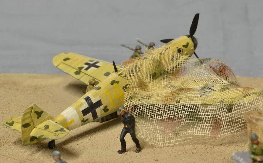

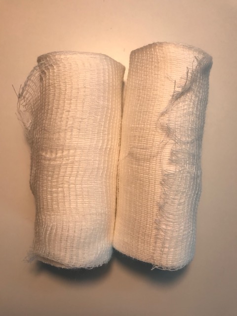

Hi, about camouflage net in 1/72.
Go to the drugstore and get this:
Here is an embarrassing example from one of my first dioramas…
Nice little corru jig, very smart and served its purpose… That would now be a keeper for me :+1:

That does have a nice tight square weave, and looks in scale as well.
