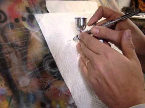

So I am not sold on needing the smaller needle. I saw something similar earlier but these shows a technique that should help with what your trying to do.
