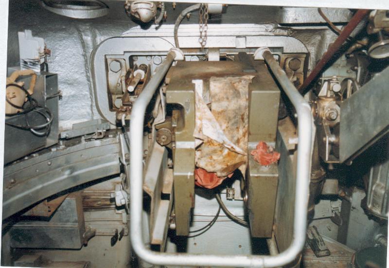

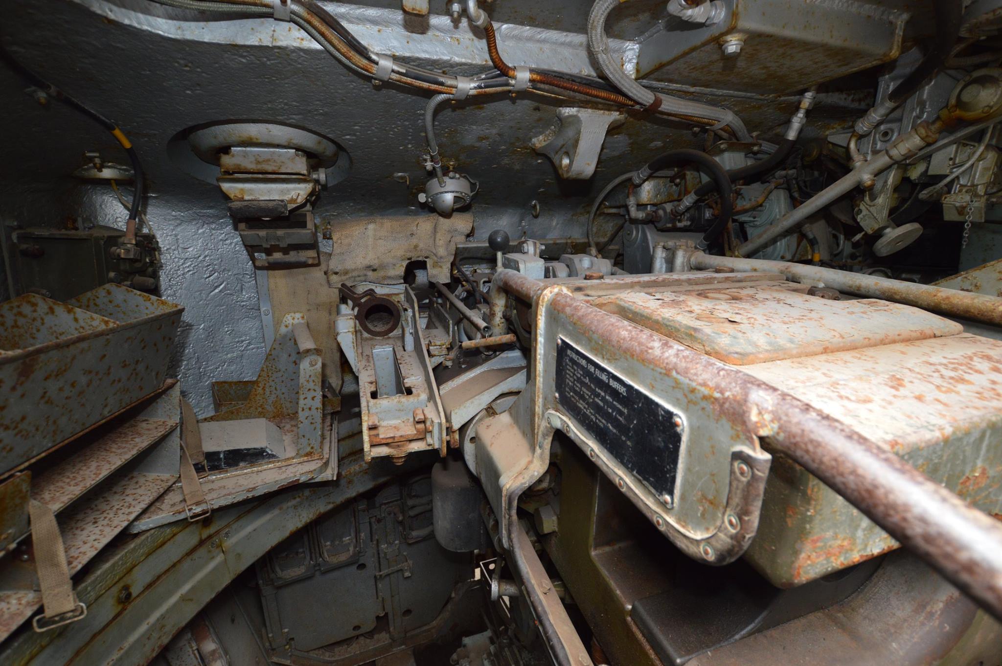

Actually when the RMG 50 Cal is fitted, it displaces the 30 Cal from it’s usual position, so 50 Cal in the usual Coax position - far left, then 30 Cal in the new hole - near left, then main armament - centre.
With
Without
Mal
Huh… and now I know. Thanks Mal!

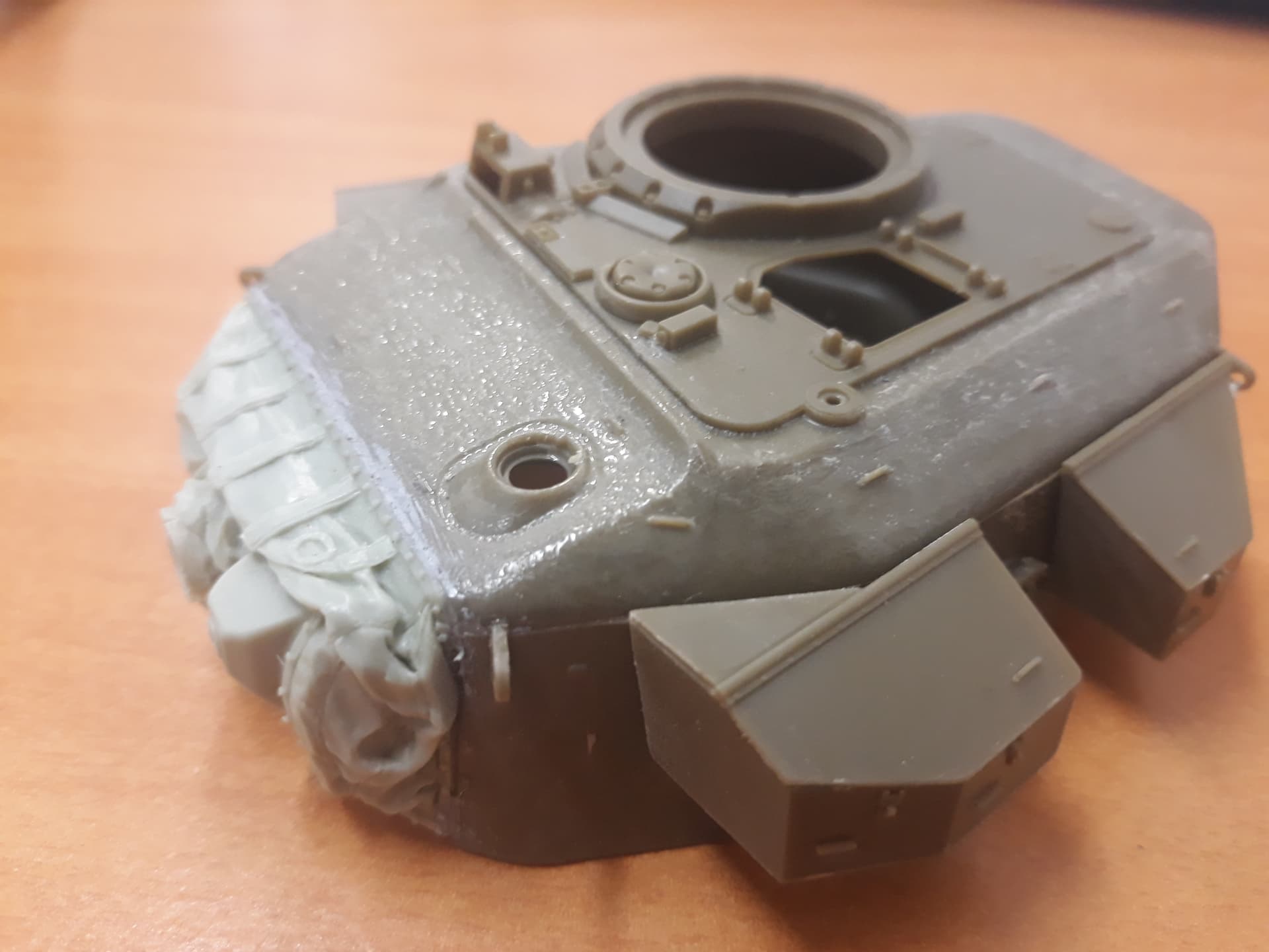

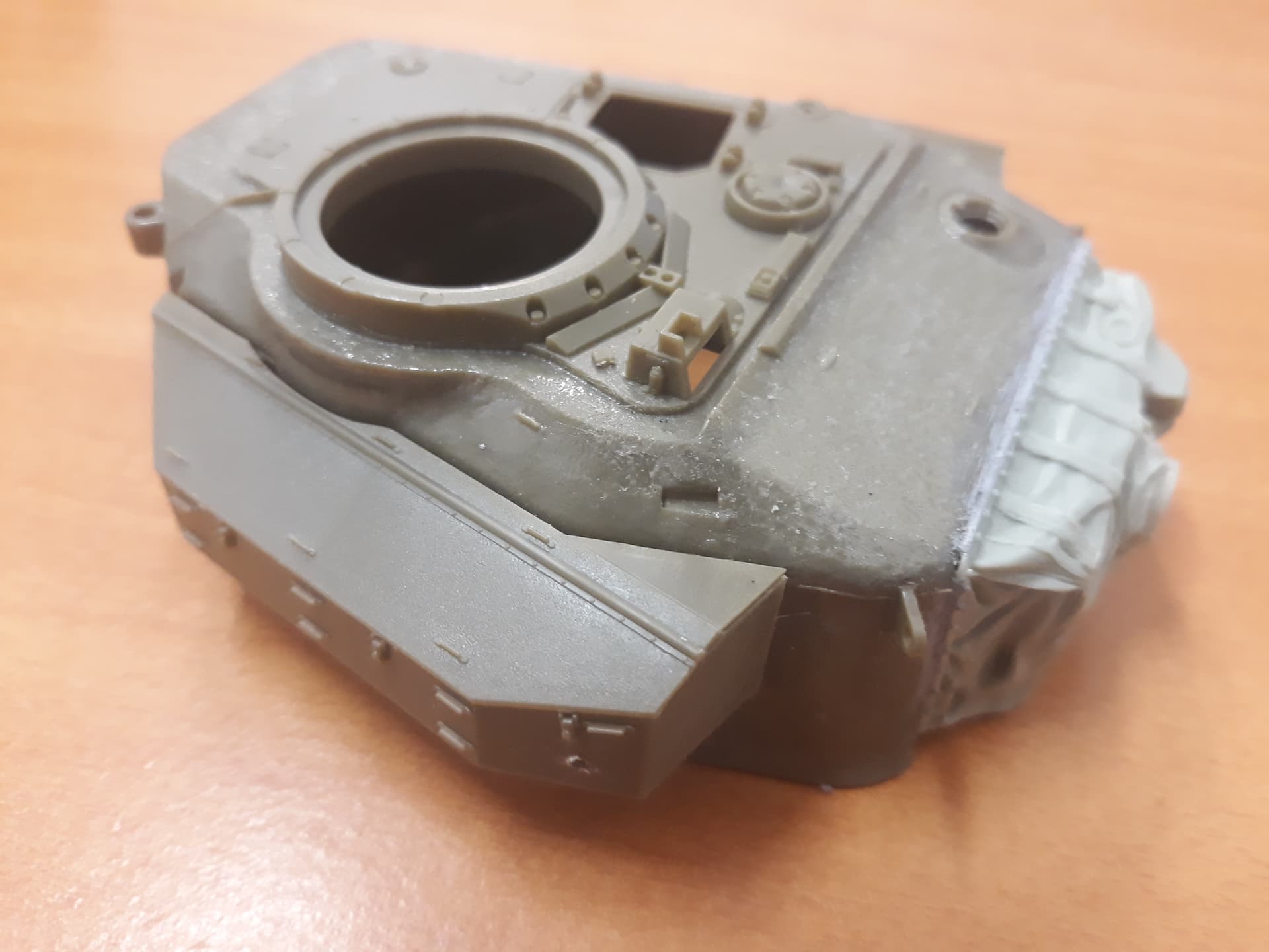

Just a heads up for those building a Gimel version:
On step 29 of the instructions do not add part P58 and add the periscope as on the normal vehicle.
Part P58 should be used on Mk3 based vehicles:

The 35059 cover is also suitable for an Aussie Mk 5
H gtdeath
well spotted .
I had spotted that they also got it right on the Gimel 2.as this is a Mk3 turret wrong on the Dalet kit
I have pictures and seen pictures of a Shot Kal Dalet on a Mk 5 turret with the episcope removed and ground down to allow that plate extra plate to be fitted , but only seen it on the one in Laturn which has a slightly different Gun sight mount.

Dalet is the same case
Mk 5 based:
2lkwefl
Mk3 based:

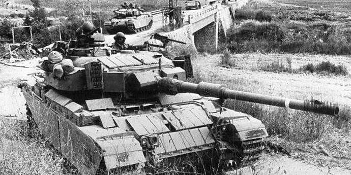

I have not quite figured out yet the different ERA tile setup on the hull front. There are two types of tiles but I am still searching on when the IDF used each type and on what hull.

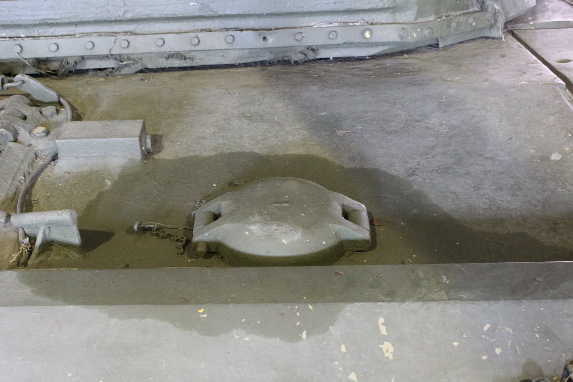

Another detail AFV did not add is the larger armored filler cap next to the driver’s hatch. It should be the same as the cap on the rear right side of the engine deck on Shot Kals.
The third is definitely Kahalani’s vehicle. The crest of the 7th Brigade is clearly visible on the front-left mudguard with no.2 in the middle marking the 77th Battalion (the second of the three within the brigade) which Kahalani commanded during the YKW. The two rings on the barrel also indicate the second battalion. It has three antennas and looks like the right storage bin on the turret is slightly damaged.
The same vehicle from a different angle:
dd91f567276f31535c7fb9d07d456527
The first and the last are of the same vehicle, from slightly different angles. It has three antennas, indicating a battalion commander vehicle and the right storage bin on the turret appears to be damaged. I can’t see the brigade crest, but it has two rings on the gun barrel indicating the second battalion within a given brigade.
I don’t know about the second one, but it has two rings on the barrel, again indicating the second battalion.
It looks like these photos are either of the same vehicle (Kahalani’s), or perhaps two different ones (Kahalani’s and his deputy’s) belonging to the 77th Battalion.

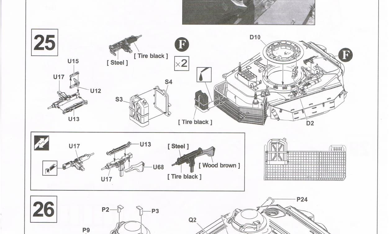

G17 is the Uzi rack of the loader. Is there one for the commander too? I can’t see it on the instructions.
Thanks, Nikos. It looks like IDF tankers started to store their personal weapons outside the tank based on experience gained during the YKW.
Yeap, there are weapons all over the roofs of vehicles in photos

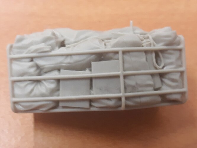

the barrel and parts are from the set … I will work on it … Was such a short basket mounted only in later versions (Gimel) ??
There were trays without a mesh, such as on the resin additive? :thinking:

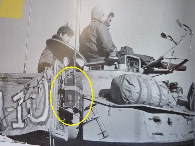

This is a “backpack” radio? Why is it mounted?
