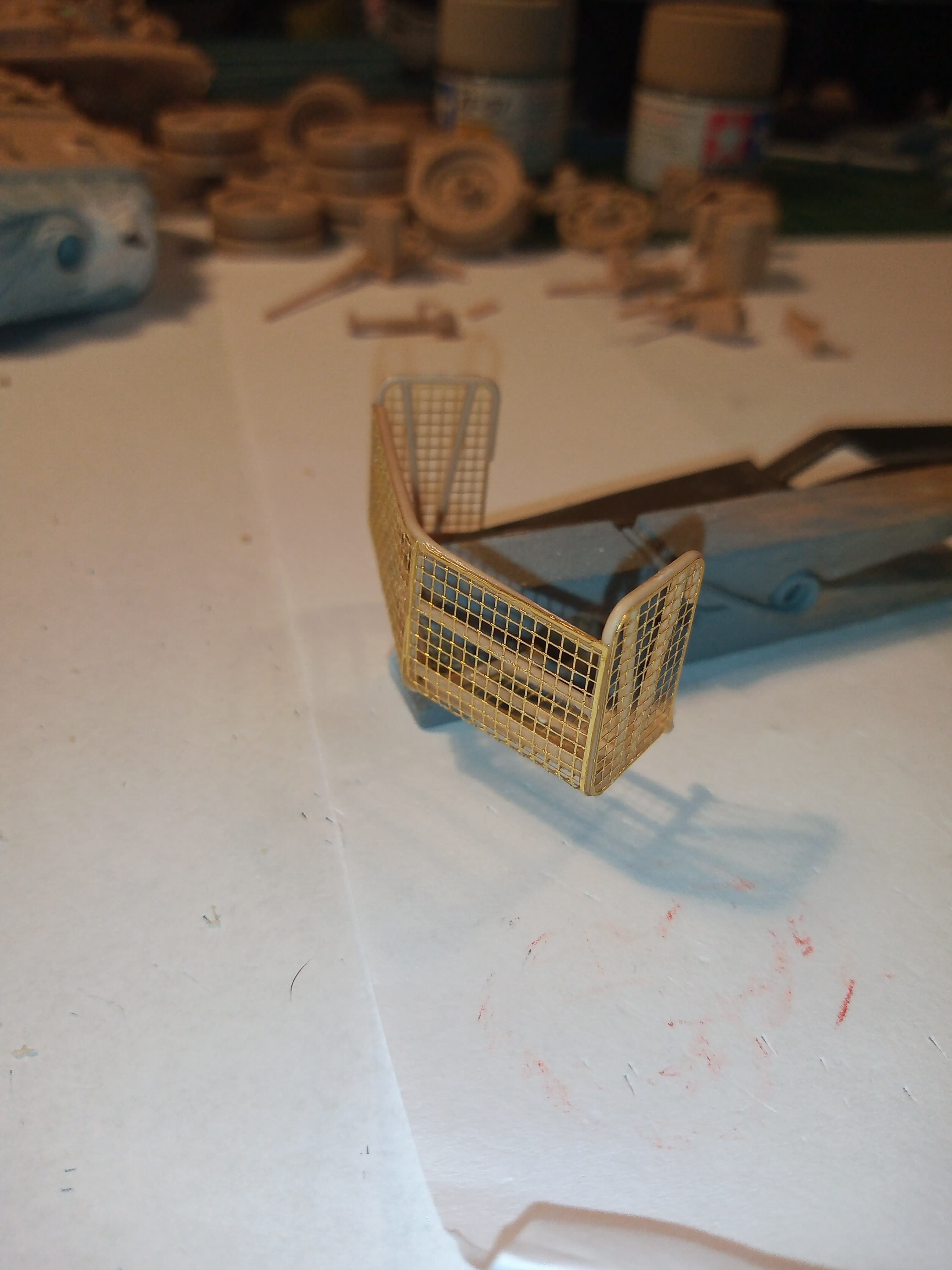

There is a mesh included in the resin set. The mesh is factory addition.
Thanks for the info! I got the net without the net :wink: was the net always in the real tanks?
It was always on the real thing.
Thx :+1: :metal:

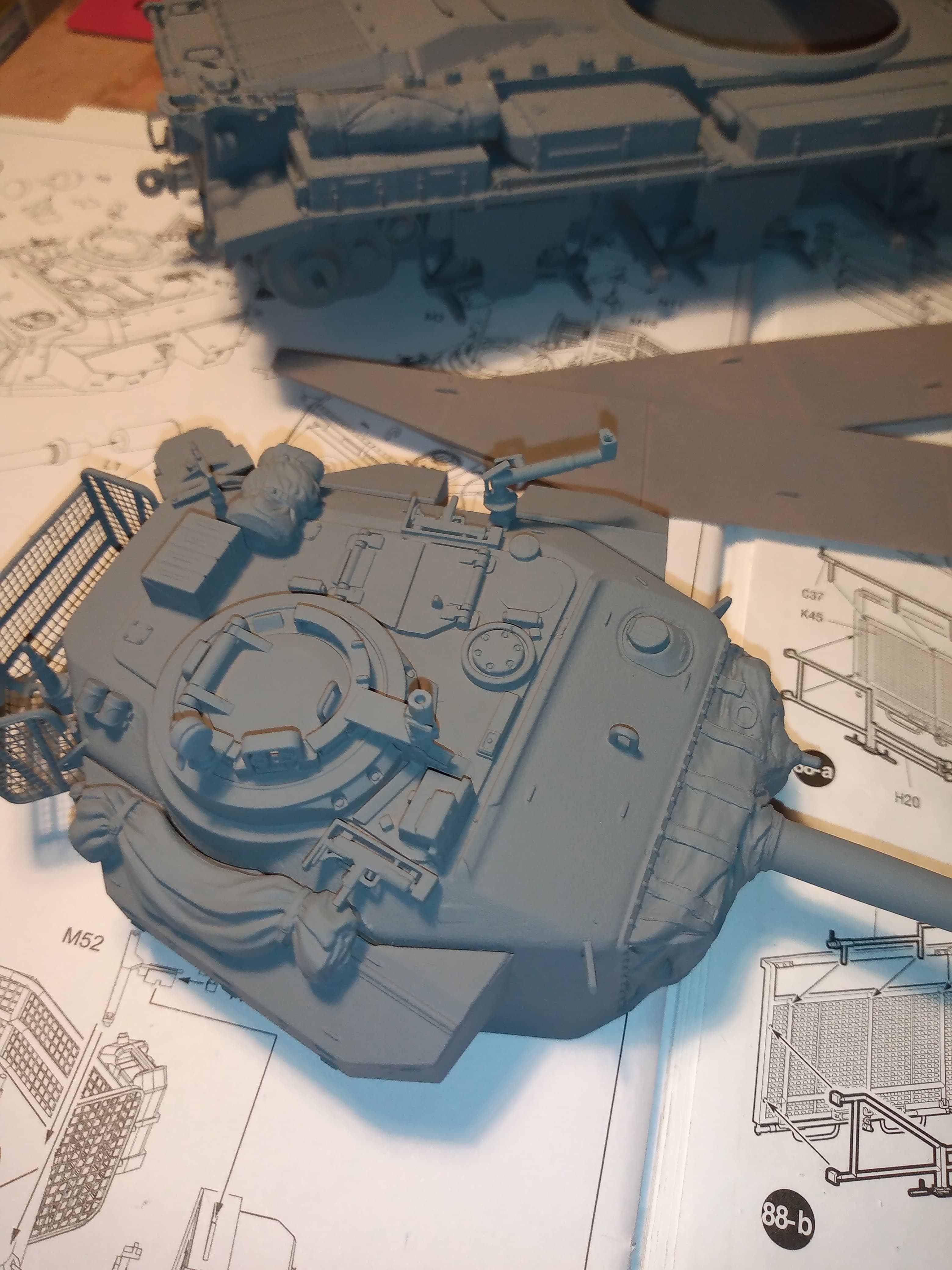

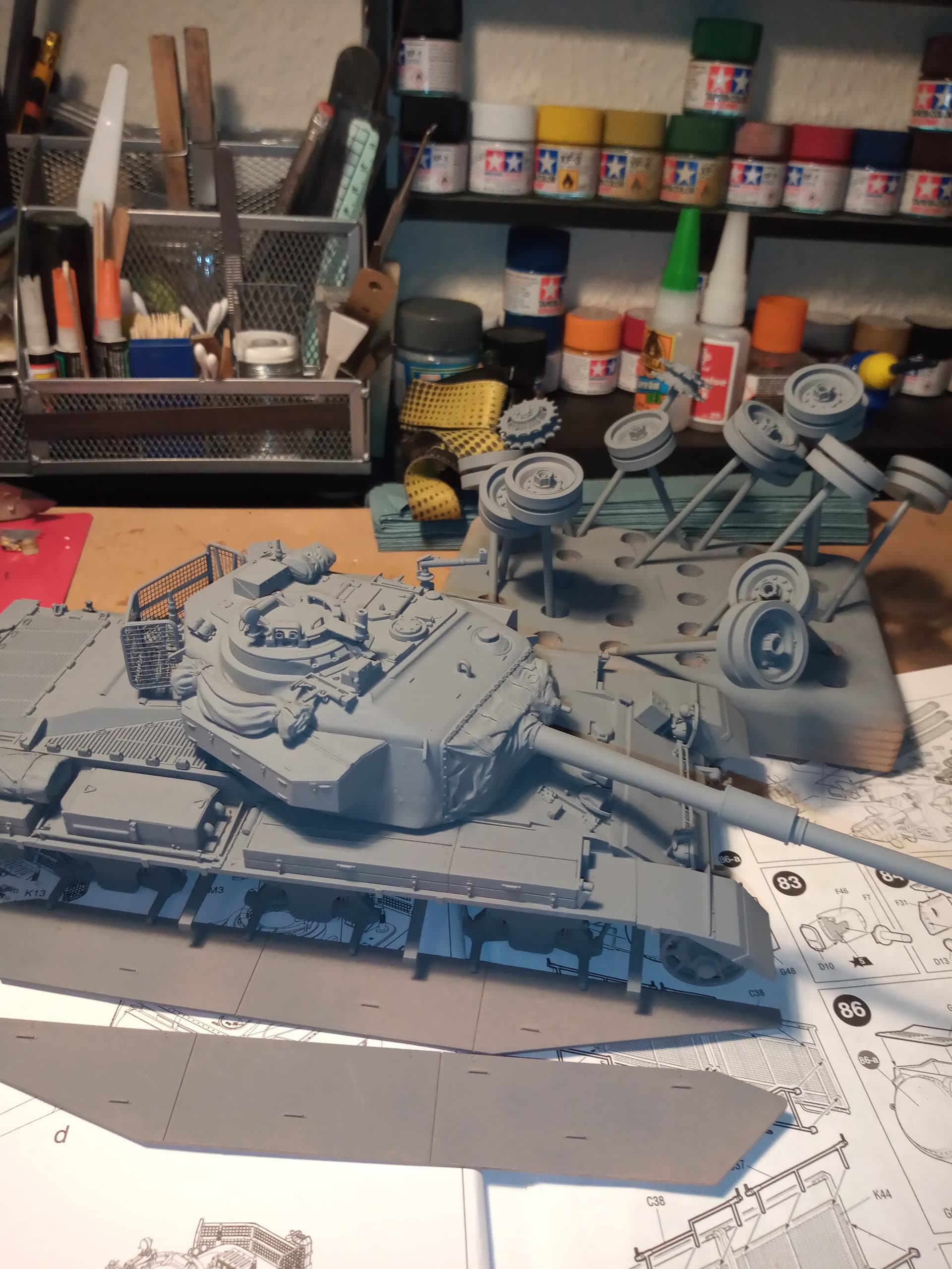

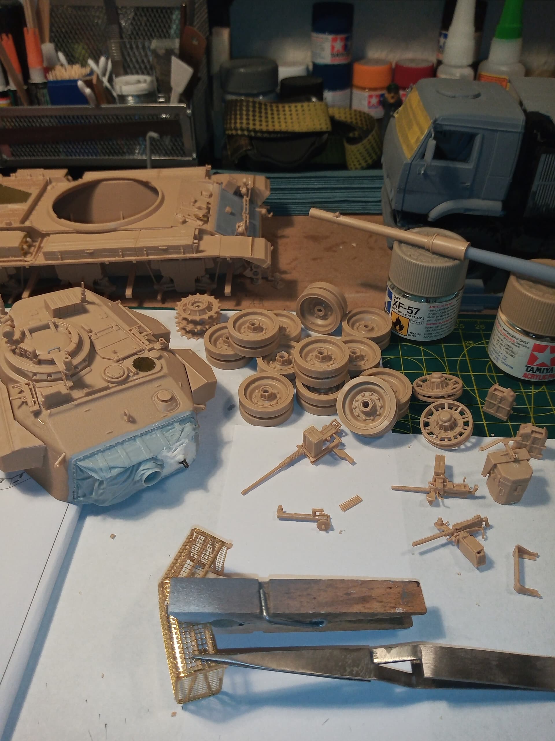

Just been getting all the fiddly bits ready for the turret and doing the wheels… Don’t ask me how I forgot about those lol.
Also put the barrel together, fitted the coax barrel, and did the PE on the rear basket.

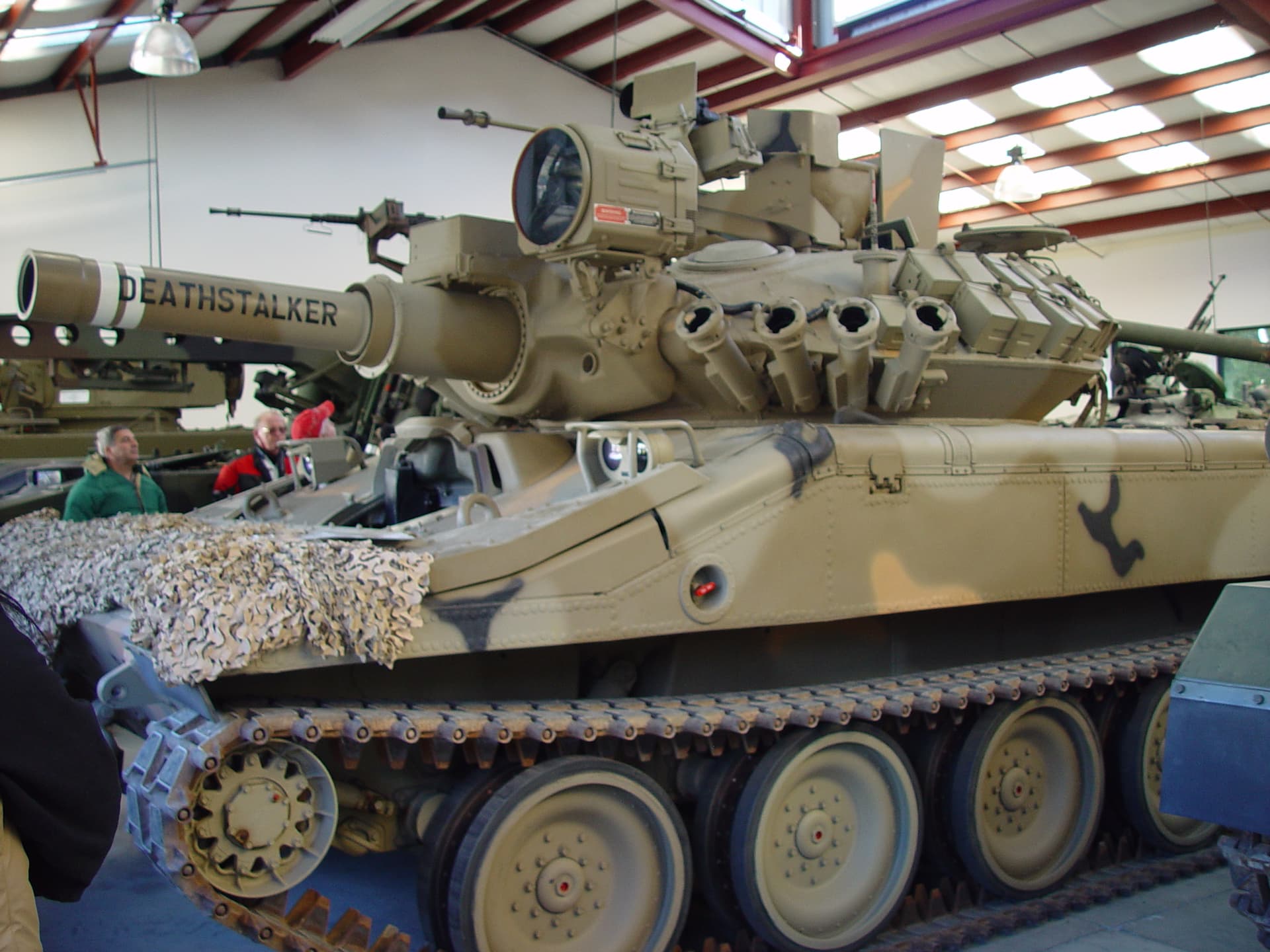

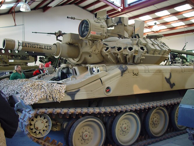

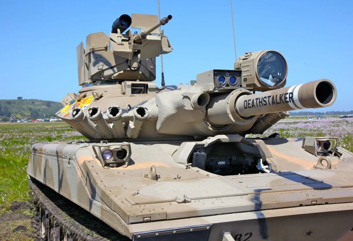

I’d go with black:
Searchlight
Black Jerry cans
The mg cables had either grips for pulling them, usually triangular or bare ends. They just go down the hatch, not too far down, so that the commander can pull them from safety.
The searchlight might be the same as the one used by Sheridan light tanks but I cannot confirm
It looks the same…thanks for info on the MG cables :+1:
I have photos of white, grey and sand cables. They are usually coated with plastic

Primer is on.
Next up is track assembly, and the .50 firing mech and cables …:+1:
