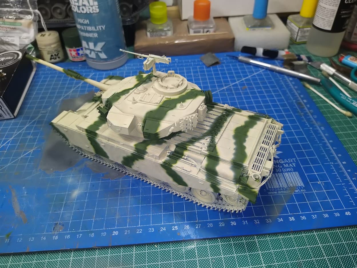

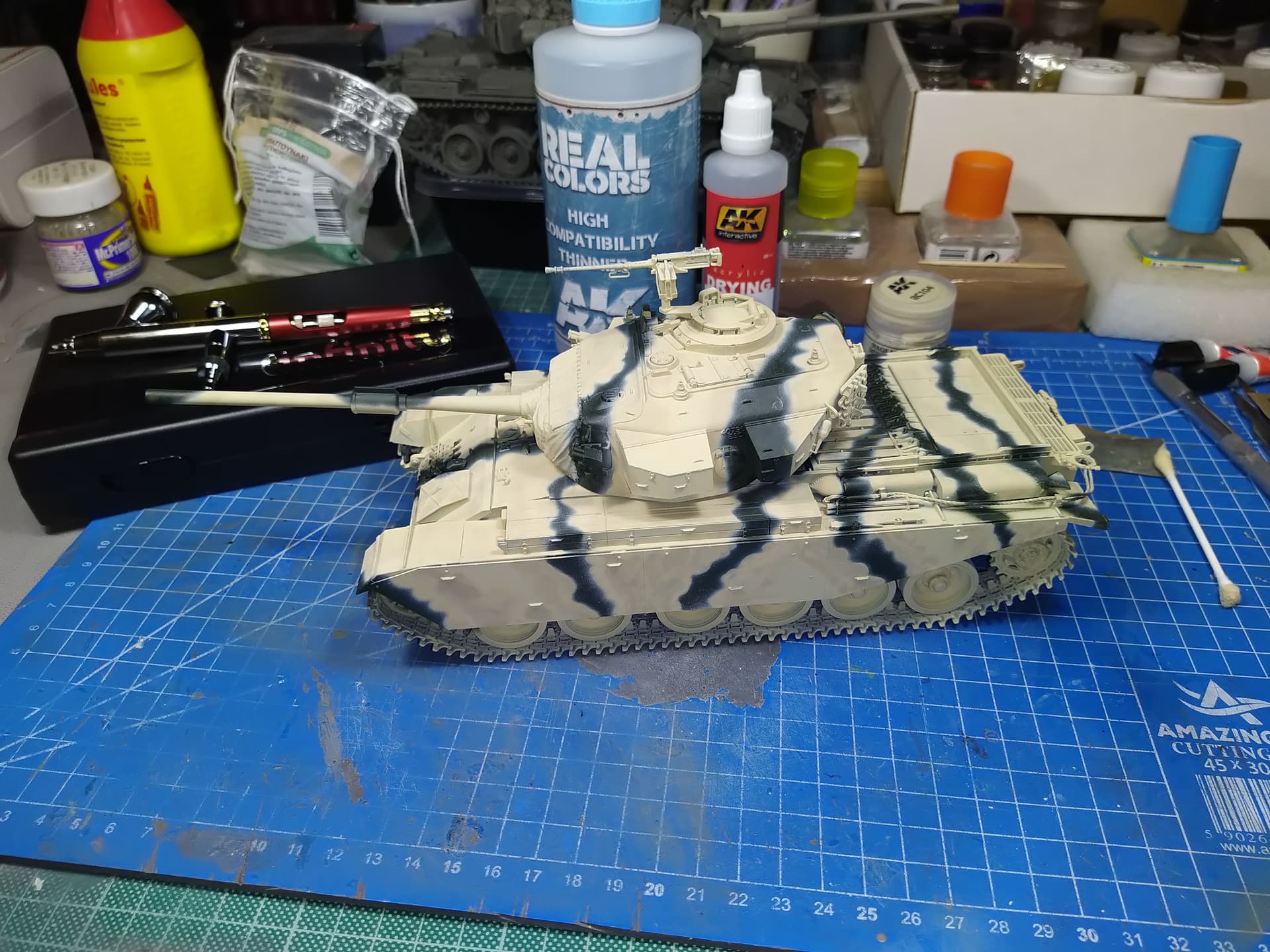

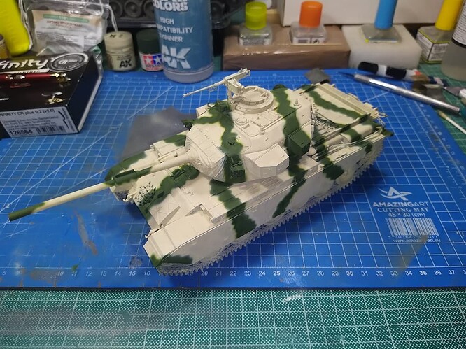

I sprayed the basic camo outline, some corrections and curves needed, but I am happy with how it will look.

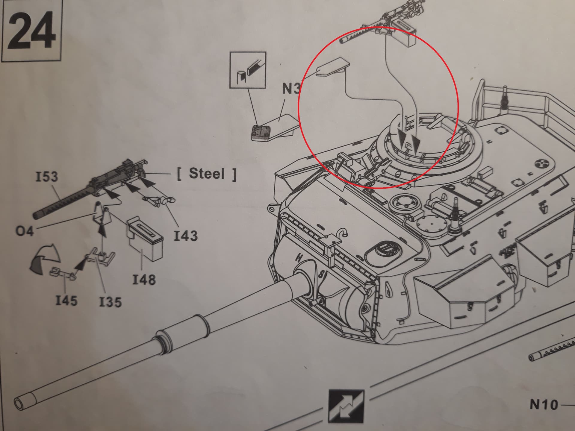

I have a question - how to mount the rifle on parts N3 and part N3 to the commander’s cupola and how do parts I 35 and I45 relate to it?

From what I understand of the sketch the base plate must be glued between the 2 raised lines on the skate ring.
Olivier

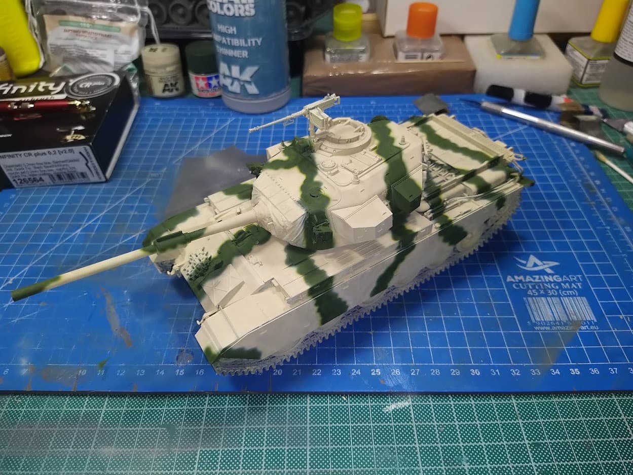

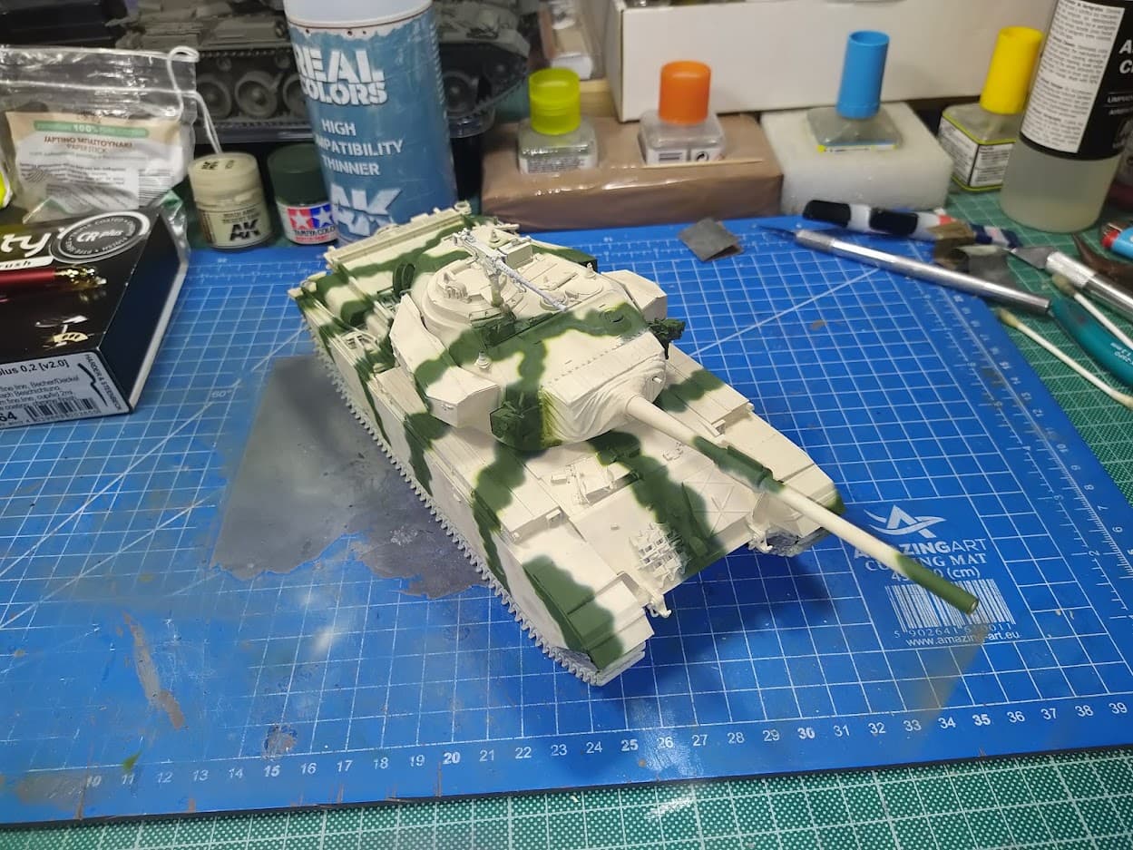

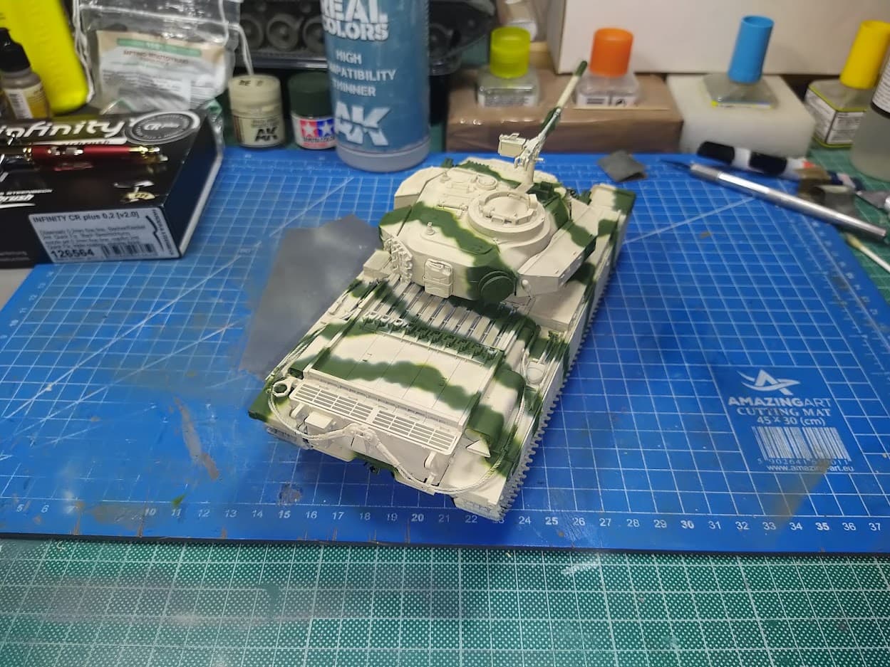

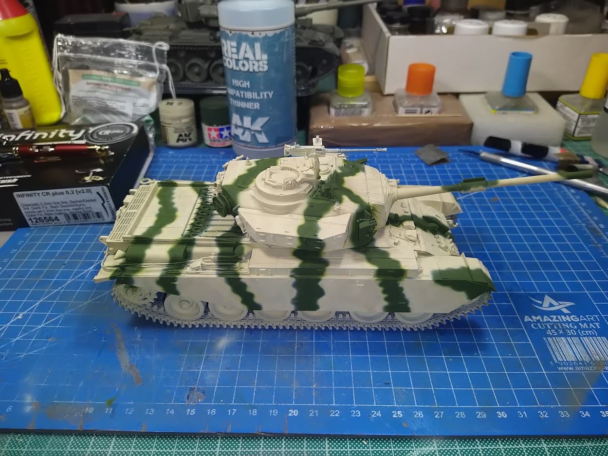

Main camo paintjob done. I reverted to NATO Green over the Bronze green i had used at first.
Now for the detail painting and the tracks.
Looking very convincing and promising!
then follow the instrctions. Assemble the mg mount (I35, O4, I43, I45, I48, I53) and place it between the two raised line on the skate ring.
Then place part N3, after removing the raised detail,next to the mg mount.
That’s what I missed… ![]()
Thank you Nikos!! ![]()
