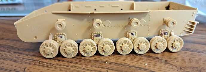

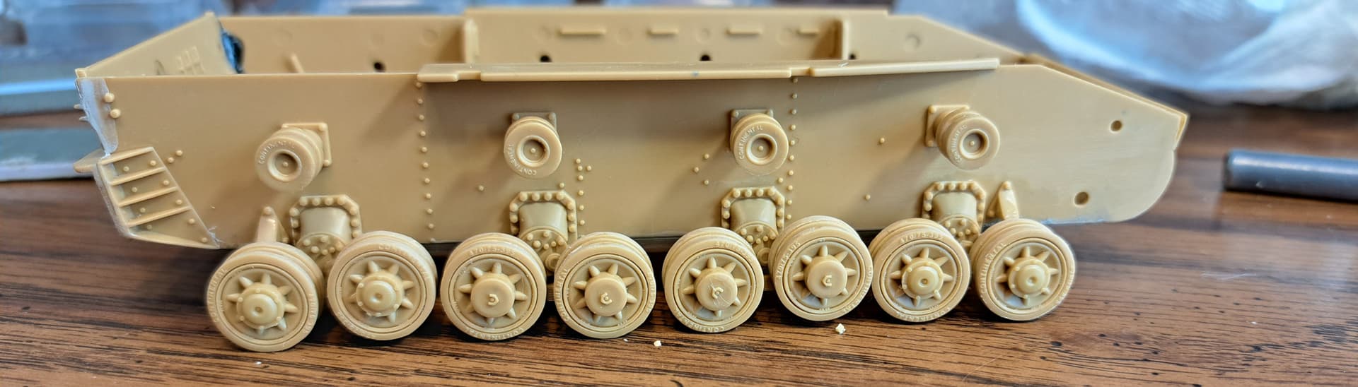

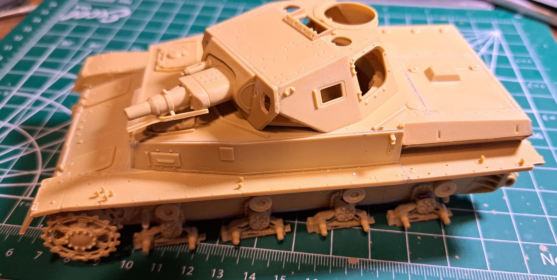

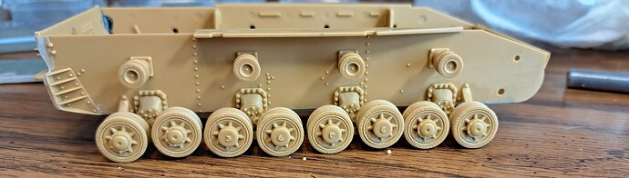

Made a bit of progress on the build…
…the working suspension is a bit fiddly but pretty sweet.
Getting there Wade. I really should look at getting a Pz IV. Only ever had one, which was ages ago, the Academy one and it was a dog of a kit … only kit I have ever actually binned once started … I have seen you and Angel @ayovtshev build some superb ones, so theres some great inspiration there …

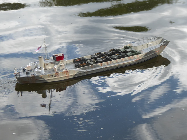

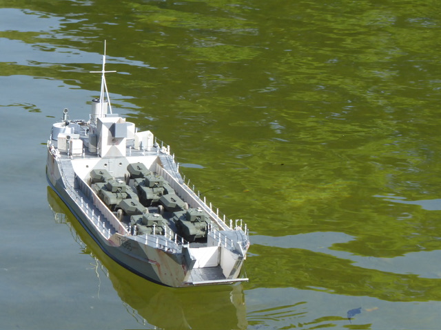

The Higgins boat was really a Personnel craft, the craft in the centre is an LCT(4) which are very easy to scratch build as a waterline model or there is (was) an Accurate Armor kit but it is a bit pricey. Incidentally the censor has been at work on the picture, there was no LCT60, it will be 600-609. The 212 on the dark stripe on the front of the bridge is the LTIN, the Load identification number. The dark stripe will be either red(Juno), blue(Sword) or green(Gold) beach indicator
My LCT(4) before reloading her with a Canadian Artillery Battery and renumbering LCT876 with red stripe for Juno Beach.

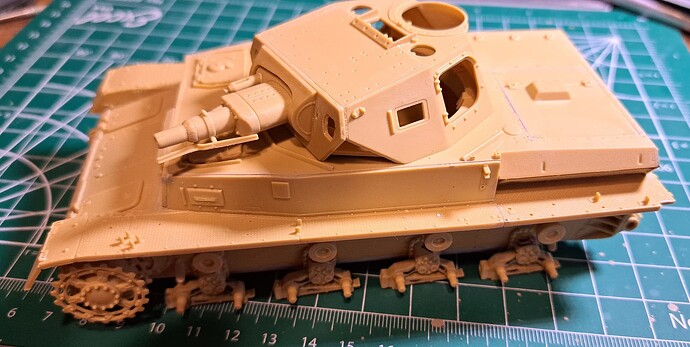

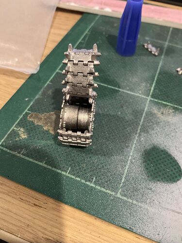

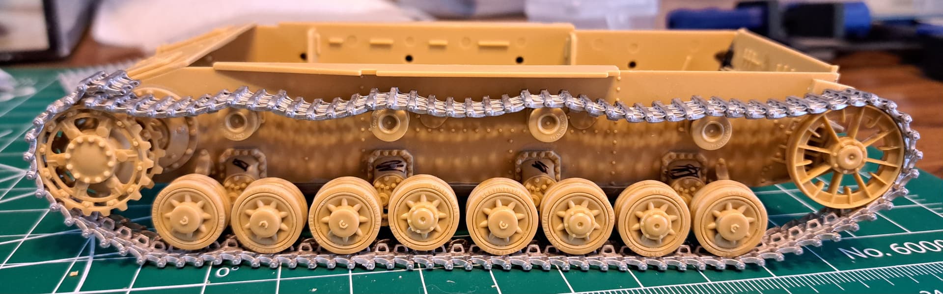

Test fit tracks today…will tweak for a bit less sag.
Love those Sector35 tracks so much more than Fruilmodel tracks.
Thanks for the feedback and images Andrew, I’ve followed some of your work previously and really enjoyed your fine craftsmanship, :+1: :slightly_smiling_face:…alas, something that I lack, :unamused:.
I limit myself to an A4 sized base, so an LCT, even if I possessed the skills, would be too big. Even an LCM 3 would be difficult to fit, hence my artistic license regarding the LCVP, :slightly_smiling_face:.

Thanks for those kind words. The place the small boats would be loaded with jeeps or similar would be a river crossing, smaller boats could be carried on trucks and launched into rivers off a half submerged trucks. Buffalo’s and DUKWs would be used as well and artillery could be firing across the river. So I guess your scene is credible in a slightly different setting.
Again, thanks for the feedback Andrew, maybe I have to rethink this one through…possibly a beach landing, have to see what interesting features I could replicate, I’ve always found sand a challenge in 1/72nd, so it’ll be a good test, :thinking: :slightly_smiling_face:.

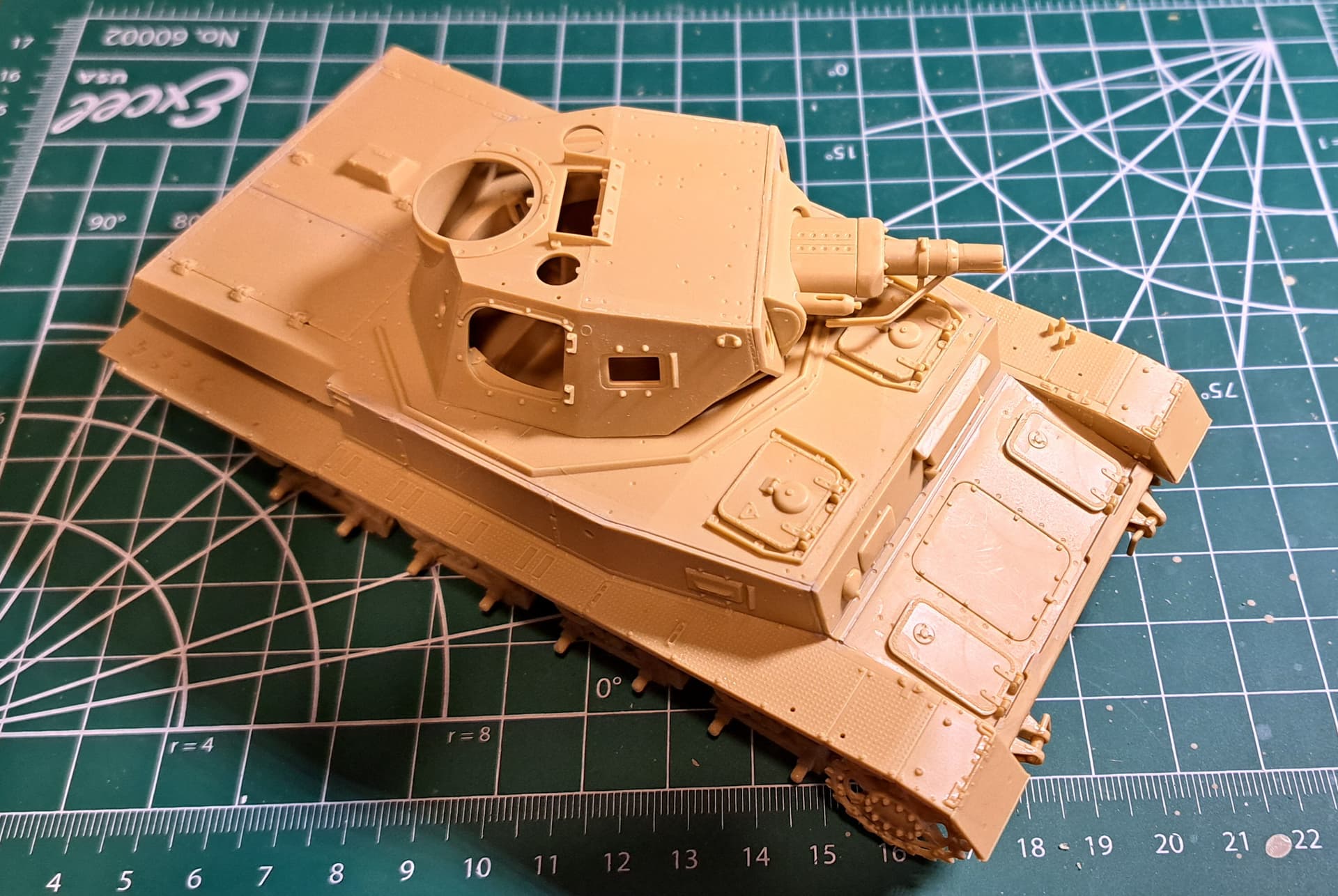

Added upper hull and working on turret…

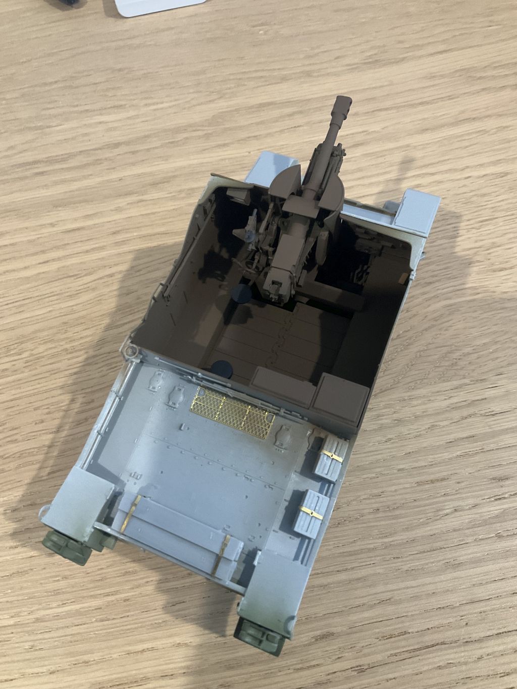

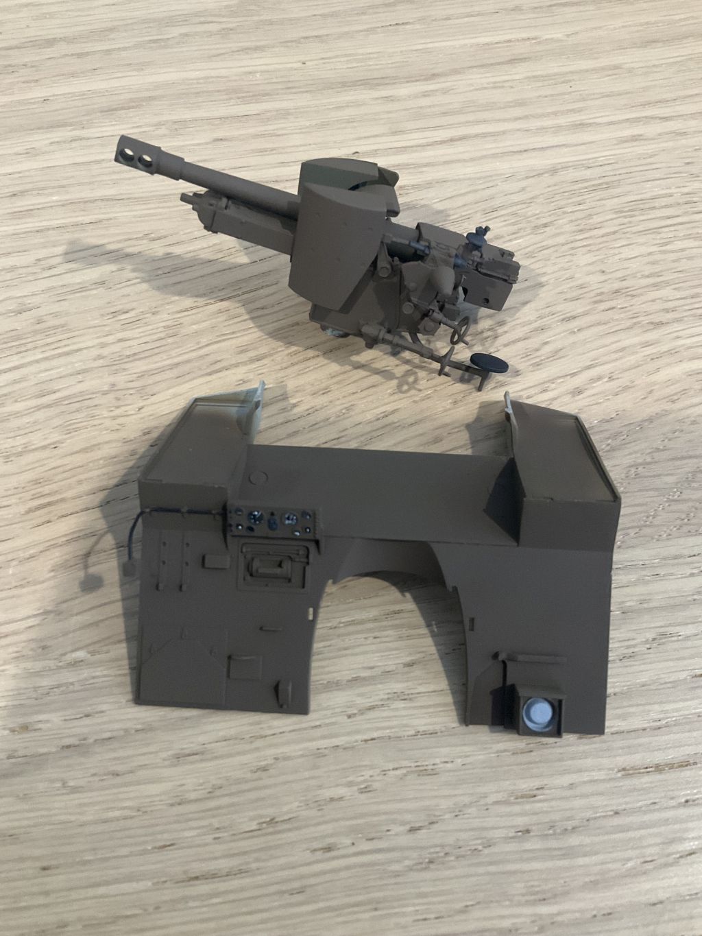

Okay, some progress made on the Sexton. I have base painted the interior and started on the detail painting. Dragon does not give you any decals for the gauges, so I hand painted them in.
After first painting the interior SCC 15 Olive Drab, I remembered that I should have painted it SCC2 Service Colour. The Sextons were delivered in SCC2 and there was not enough time to repaint these in SCC15 before D-Day - priority was given to repaint tanks and frontline vehicles. So a quick repaint was in order.
I have also started the Fruil Canadian Dry Pin tracks… worst Fruil tracks I have ever assembled. Every single link needed to be drilled out as they are partially blocked. Then I had to re-drill them to join them as the holes in the two links do not line up and have to be widened for the wire to pass through. Then, the runs all want to curl sideways. Using gentle persuasion I have to manipulate the tracks into a straight run.
Fortunately I tested the track with the drive sprockets Fruil supplies. If I had glued the two sprocket halves together without testing them, I would have been unable to fit the track as the sprocket is too narrow. I had to glue them with a slight gap so the teeth would fit!

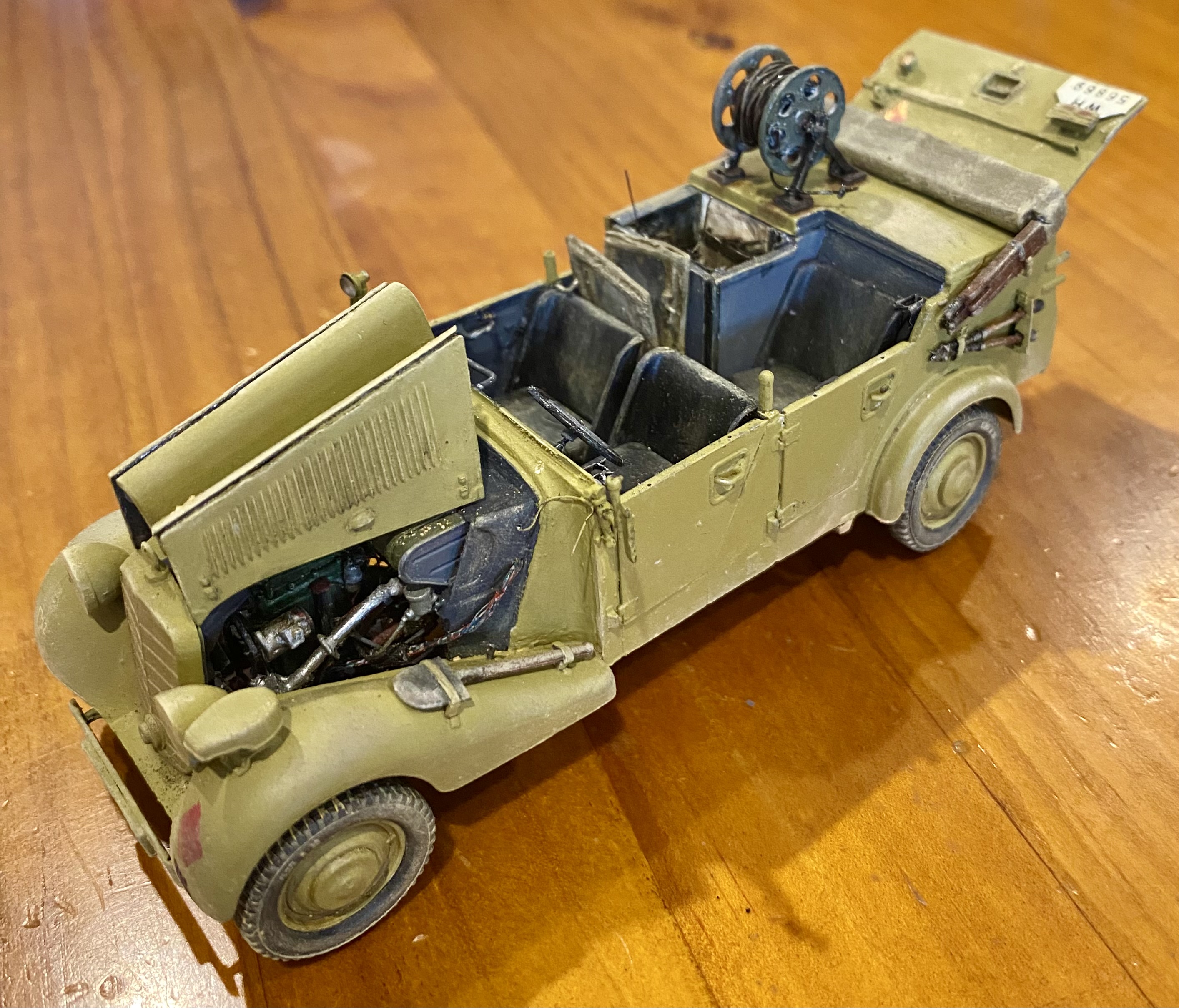

Again, thanks for allowing a late entry. I’m still wrestling with the windows and realise that I’m not very good at fitting and securing plastic windows. I’ve now muffed up five sets of front windscreens through either cutting the size wrong or getting glue all over them. I’ll have another go today at getting it right.
Still lots to do but this is where the Mercedes VK170 is at currently;

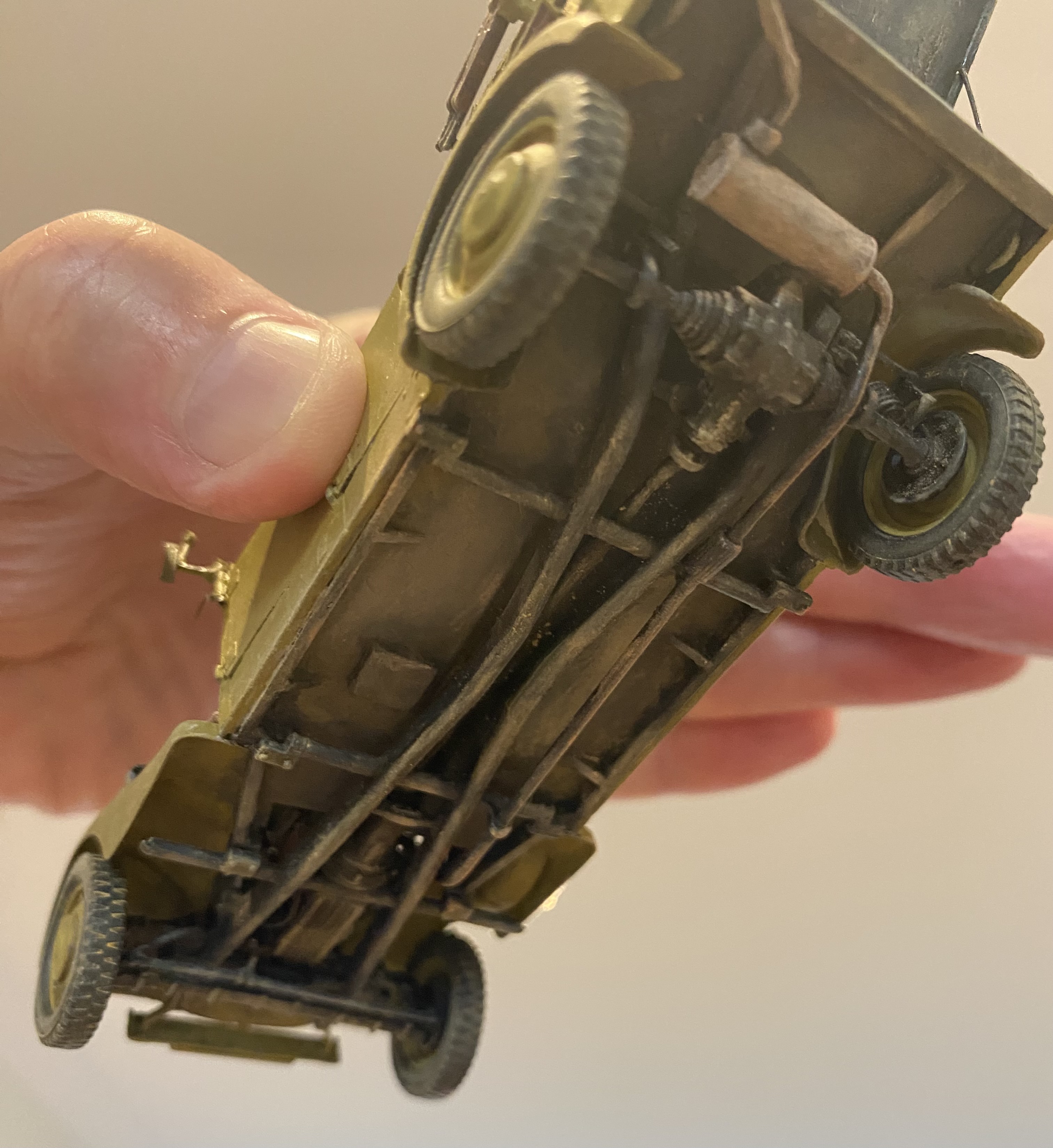

I’ve weathered the underside of the vehicle and I think it looks ok.

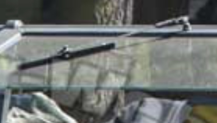

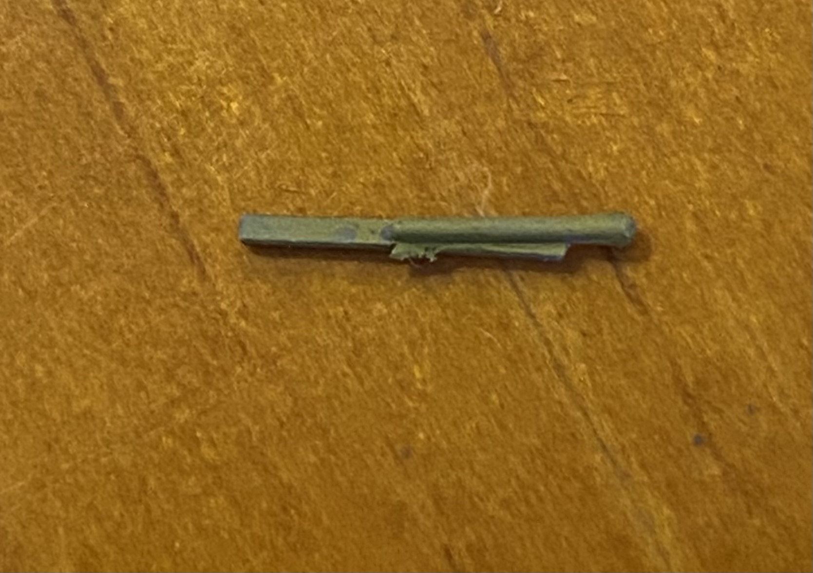

I also don’t like the kit issued windscreen wipers that are chunky and thick so I’ll make some better ones.
Kit issued;
Intention;
Have you tried the clear plastic from things like grape/ fruit cartons. I have used it a few times with good results.
Yep that’s the sort of plastic I’m going with now. The original kit issued windows were like scale bullet proof glass!
