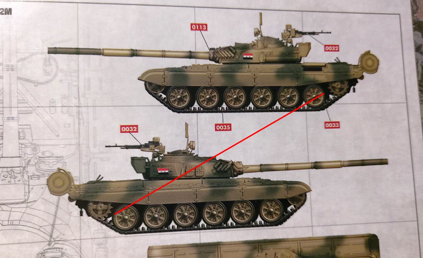

I’m installing the tracks. The instructions call for 95 links per side. But one side fits while another doesn’t. The drive socket on the right side is closer to the first road wheel than it is on the left side. AH images show the same anomaly. (See below). Have I stuffed up? Has AH stuffed up? Or don’t they line up on the real thing.
Maybe the drive wheels are further back on the right side!!!
It’s not a lot and I can cobble it together. But would it really be different?
The distance from the sprocket to the roadwheel is different because the torsion bars are offset. In real they are as long as the full width of the hull.
Olivier
As seen on this 1/72nd scale kit part (Modelcollect)
Point of order, on AFVs, the convention is to number road wheels from the front, therefore, the drive sprocket (or final drive if you prefer) is closer to the 6th roadwheel on the RHS - this is due (I assume) to the offset torsion bar assemblies.

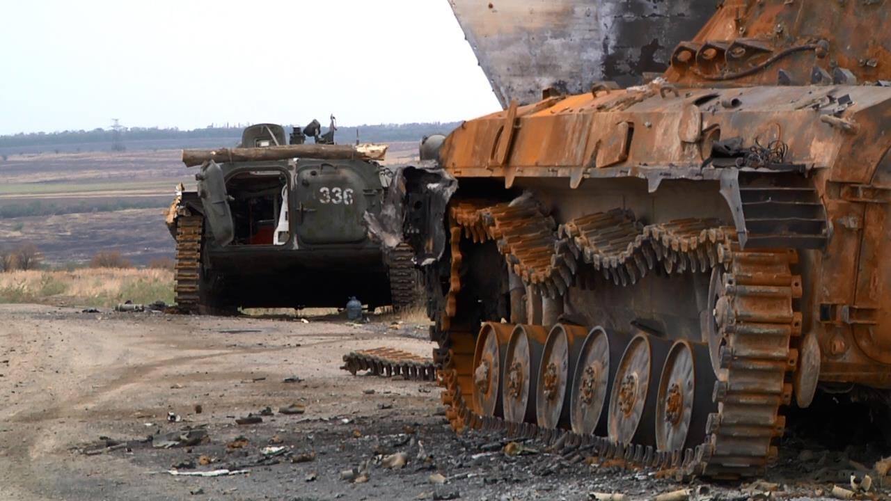

Like the others have said, you a lot of variation to how the track can end up. Here are a few more photos to help you figure out what you want to go with:
gettyimages-467623402-594x594
Just about anything you want to go with will work just fine!

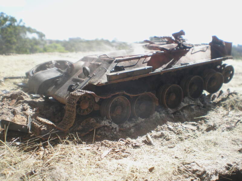

I Considered the tank was slowly moving forward when hit just above the tracks. So some momentum forward.
I think I will refine these poses.
Excuse the ‘pin’ holding the drive sprocket in. One dumb mistake that I’m keeping to myself!! :unamused:
Some progress.
Oil filters. Some fiddly bits yet to be done. Like the hatches. Next step is a clear coat then airbrushing on the burnt affects.
Everything is dry fitted at the moment. It’s missing the side skirts. They have been modified and will get attached later. Turret will be on the ground!
I’m beginning to ‘like’ this kit. I’m tempted to finish it as is. BUT I’ve come this far so out with the burnt paints.
Coming along very nicely. I too would be tempted to leave it as is. My only “criticism” is that if the tank were moving forward, even slowly, I would expect the broken track to not be sitting tight on the drive sprocket. Perhaps others can weigh in. I just think it might look better. That said it’s your build and if you are happy with it the go for it. :+1: :+1:
Thanks. I’ve looked at many many images. I’m not sure any two have been the same. So I’ll put it down to my own ignorance and leave it as is.
I put a lot of those images up, just to show that anything you want to go with would be OK, as you noticed there is so much variety in how the tracks end up. What you have looks fine. If you are happy with it, that’s all that matters!
