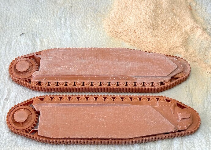

Typical of these SSModels kits there is a lot of cleanup on the rear of the hull. For some reason, the texture at the back resembles a plucked chicken. This requires a lot of sanding and the rivet details can disappear.
The back of the track sections was weird. It was very thick and soft & oily as if the resins had not cured. Working on one quickly fouled the sanding stick so I moved this project to the kitchen sink to use some dish soap & warm water. This went better but the material still seemed soft & oily. I remember someone else had a problem like this with another brand of 3D kit and set the parts in the sun to “cure” which solved his problem. My parts are sitting on a window sill now. We shall see if the material hardens There is going to be a lot more sanding needed.

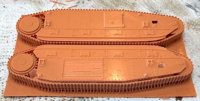

It seems there is a lot of sanding work on this kit because of all those printed lines.
There can be a lot of sanding in certain areas and it is not always easy to get to these areas. On the other hand, many areas are commendably smooth and need nothing more than a light sand to give the surface some tooth for the paint to cling to. Look at the picture of the hull and outside of the sponson’track assembly. Very nice work there by the kit maker.
