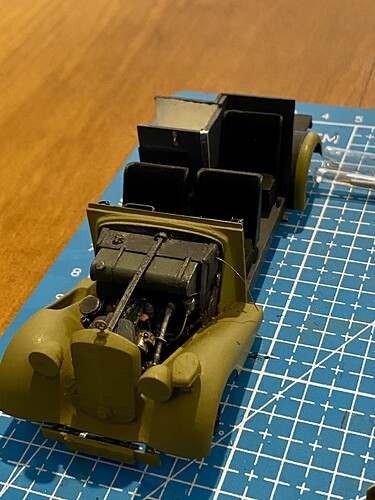

So to get me focused back on the VK170, I’ve still been ticking away at some smaller elements. I’ve resolved that I’ll be finishing this as a telegraph/line repair vehicle so there’ll be more work done to reflect that.
Not much change to the main body. I’m happy with the engine and wiring. There’s two wires coming out either side of the top part of the bonnet and these will be hooked up to the turn signals once I finish them.
I’ve also built a little rack to sit behind the front passenger seat, for the side windows which just clipped on. In the four seater sedan they were tucked behind the rear seat when not in use, but in the three seat version they were kept in the boot or behind the front passenger seat. The rack will work ok I think with the lower side butting up to the back of the seat;
And I’ve put in the windscreen wiper motors along with the wiring for them. This will be cut to length to fit into the dashboard to the right of the steering wheel.

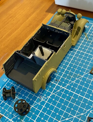

Sides are on albeit with a bit of gap and some wrestling. The equipment box now has supports in each corner. It will have the lid open and some things inside. Also the cable reels are being prepped. One to go on the back deck and one in the boot.
And a test fit for the equipment rack that will go in the boot along with the reel.

Ta Barney. I got the reels off an 88mm kit that I’ve got in the cupboard. I figure not all had the comms reels rolled up and sitting on the trailer whilst in action. I’ll just have to remember that I’ve already used them when I go to build it and scrabble desperately through the box for the reels!
I tried to scratch build them but no luck. I also had a look at sewing machine bobbins as a possible option but they’re too big.

I’m now wrestling with fitting the cable to the reel to make it look realistic and tightly wound. I get a certain part of the way then the bloody cable (it is fishing wire) just springs off and laughs at me! Perseverance will win though!
Consider using annealed copper wire, paint it with a Sharpie, or similar, or actual model paint.
Plastic rod (like fishing line) is just asking for trouble.
Copper wire is available in many, and very small, diameters.

Good advice @Uncle-Heavy ref the wire. I was using fishing line as that’s what was in the 88mm kit (it’s an AFV kit) that I grabbed it from. I’ve got some more suitable wire now so I’ll try that.
I’m ticking away at some of the add ons that I’ll need to make it a telegraph/linesman vehicle. That includes things like gloves (proper line worker gloves not the nice driving gloves that some officer figures come with) which I’m trying something new for me so I’ll see how that goes.
First cable reel done and installed in the boot. Some add ons to put in then I’ll close the top off but will leave the boot open.
