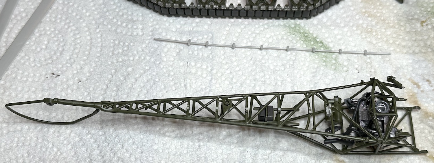

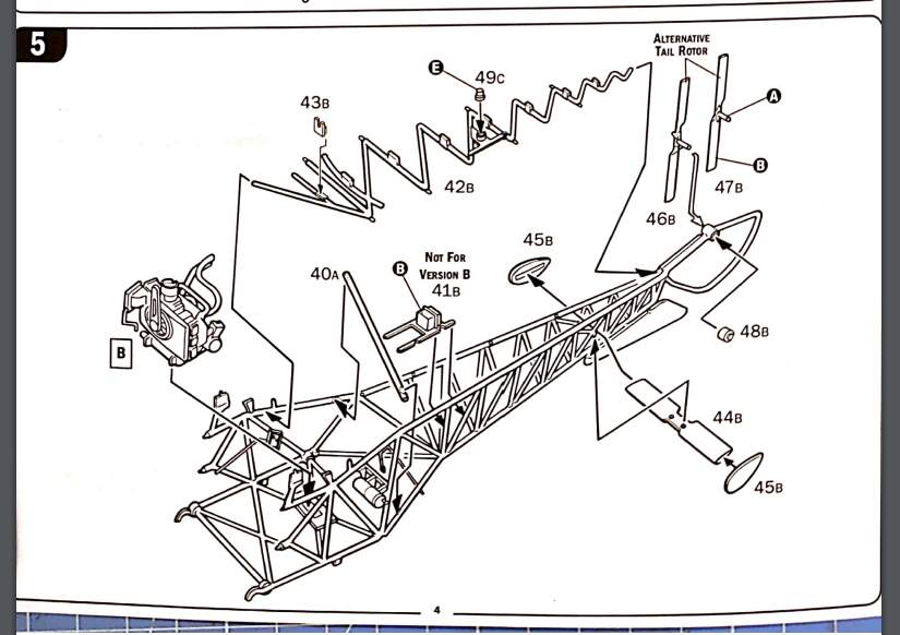

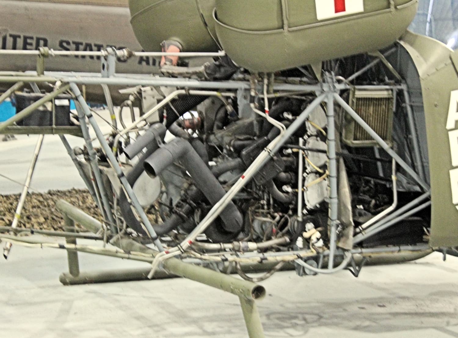

I got the truss top fitted and glued last night and find that it has really stiffened the structure up. There is a truss cross piece (40A) that is only vaguely located in the instructions and there are no mounting points molded into the plastic structure. A look at the reference pics show that it should go in a path which would go right through the oil tank mounted on the LHS. Out of the bad options I was thinking that the highly visible top location should be retained and the lower mount will have to go forward to join in the middle of a tube. Not good structurally. Or I could just leave it off . . .
For those who have built this kit, how did you handle it?

Ah, Italeri’s good old ‘it fits somewhere here’. I can usually figure them out, but that’s got me scratching my head!

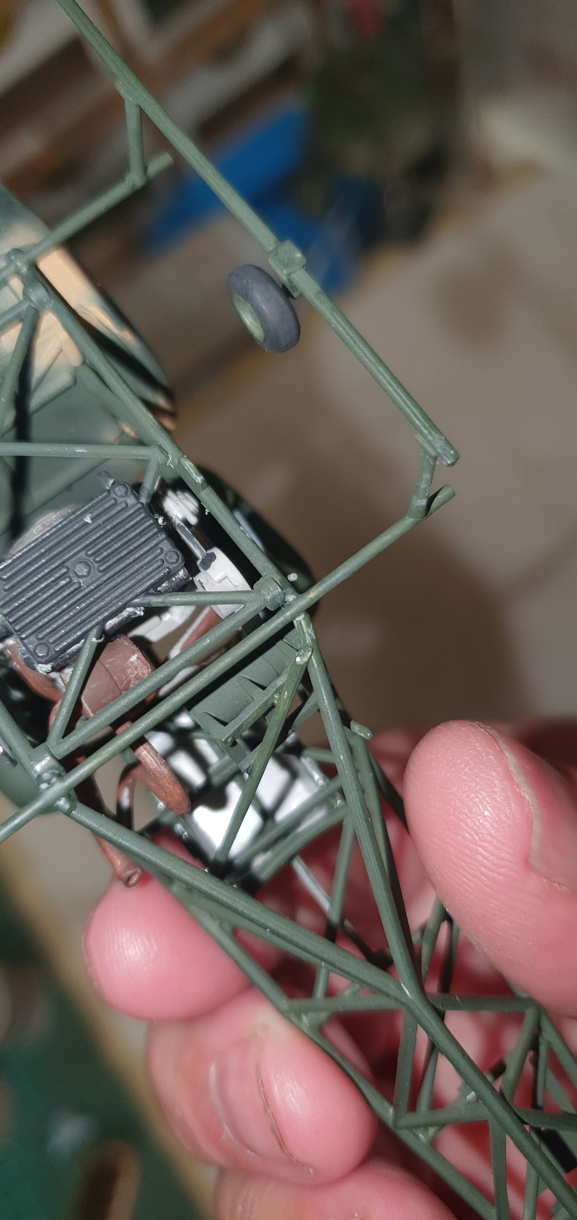

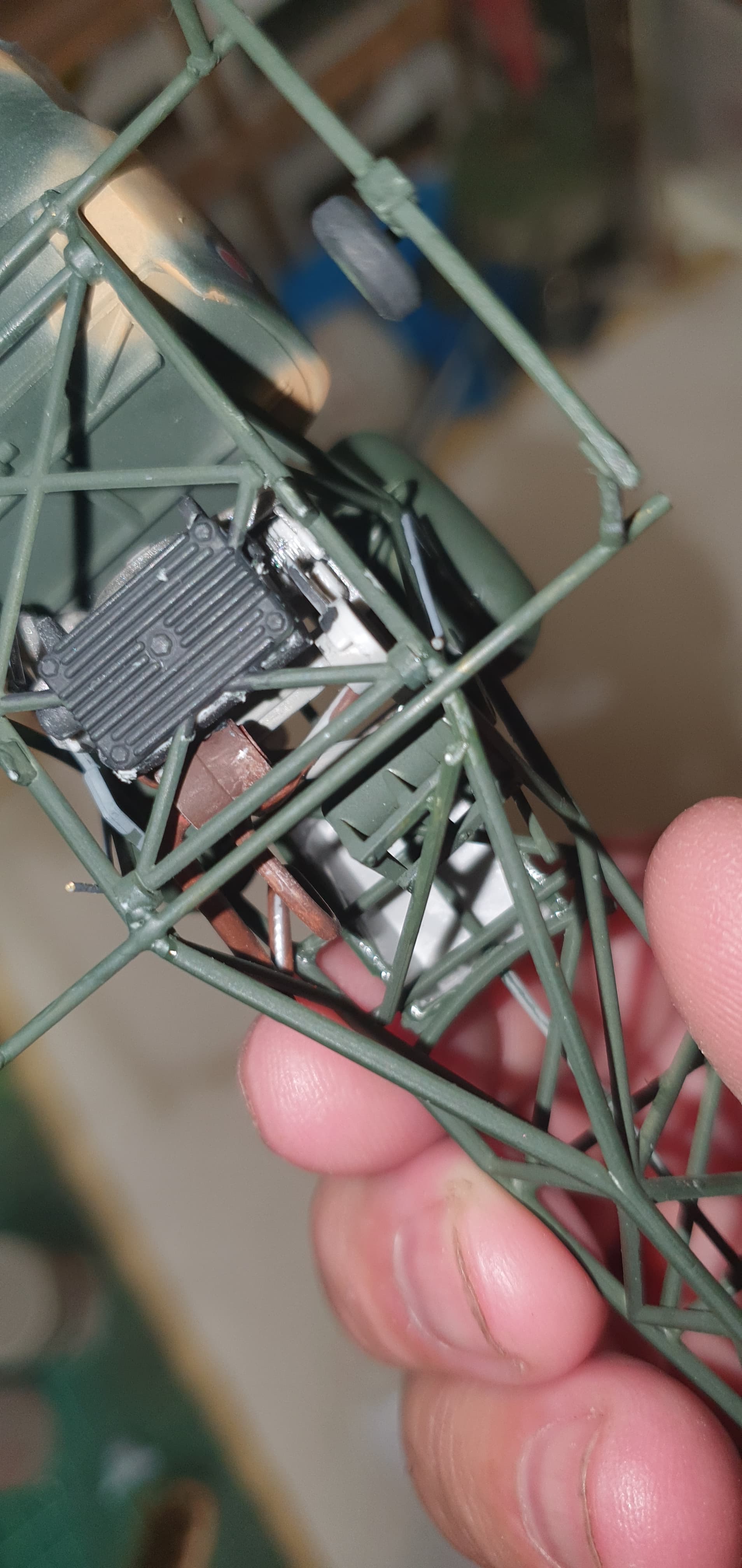

Find photos of the area is what i did, for finding location of cross member, it supports the backside end of oil tank and cut the top zigzag around the beacon area, to help put the engine in for after painting the framework,
Thanks Frank, I didn’t think to try that tube behind the oil tank. I’ll try it there tonight. It will have to be fitted after the battery is mounted which according to the pics of the real deal Italeri wants us to mount backwards . . .

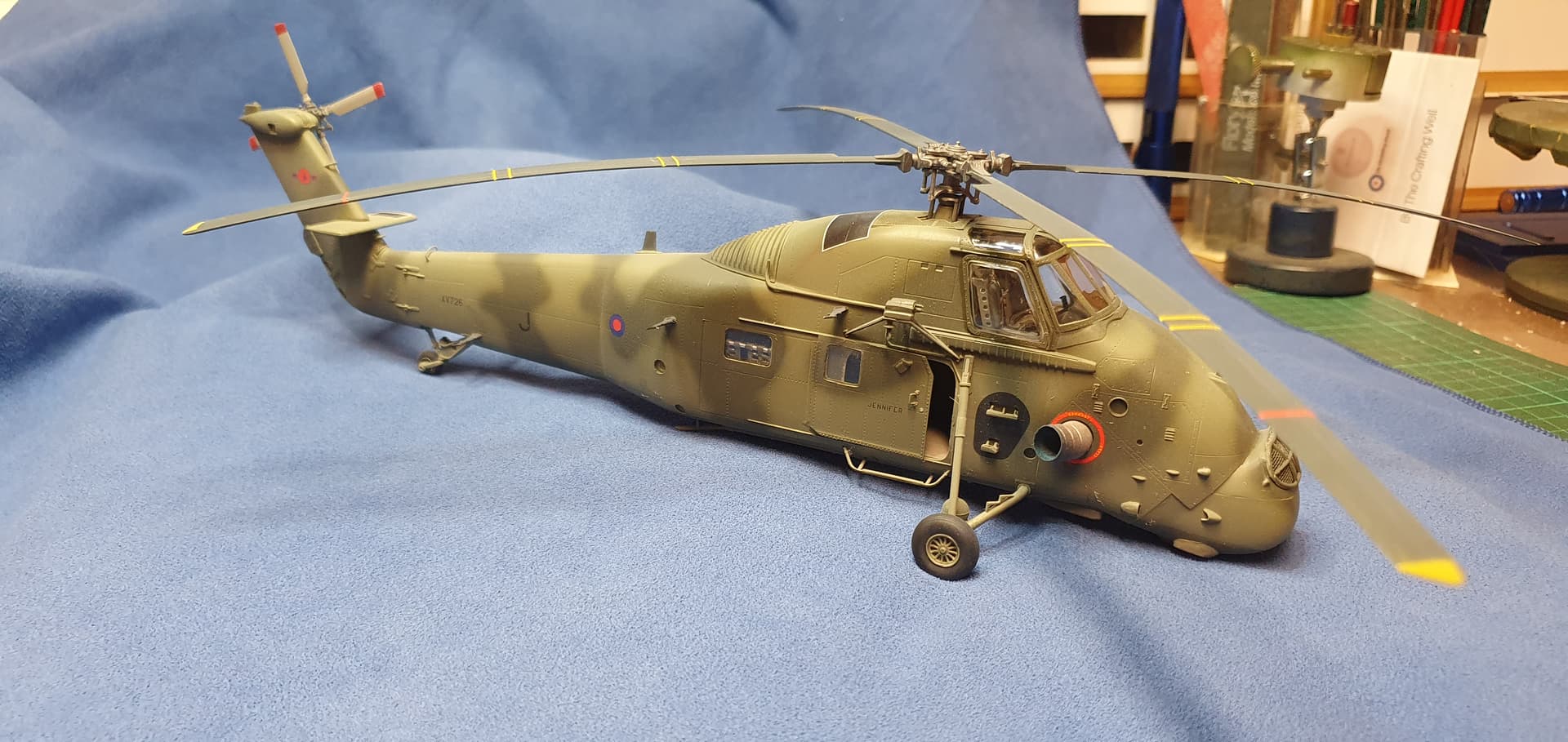

I love that Wessex. It inspires me to move my Marine H-34 up on the build list.

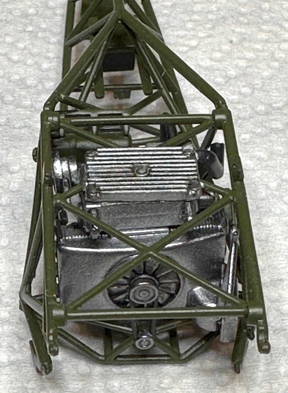

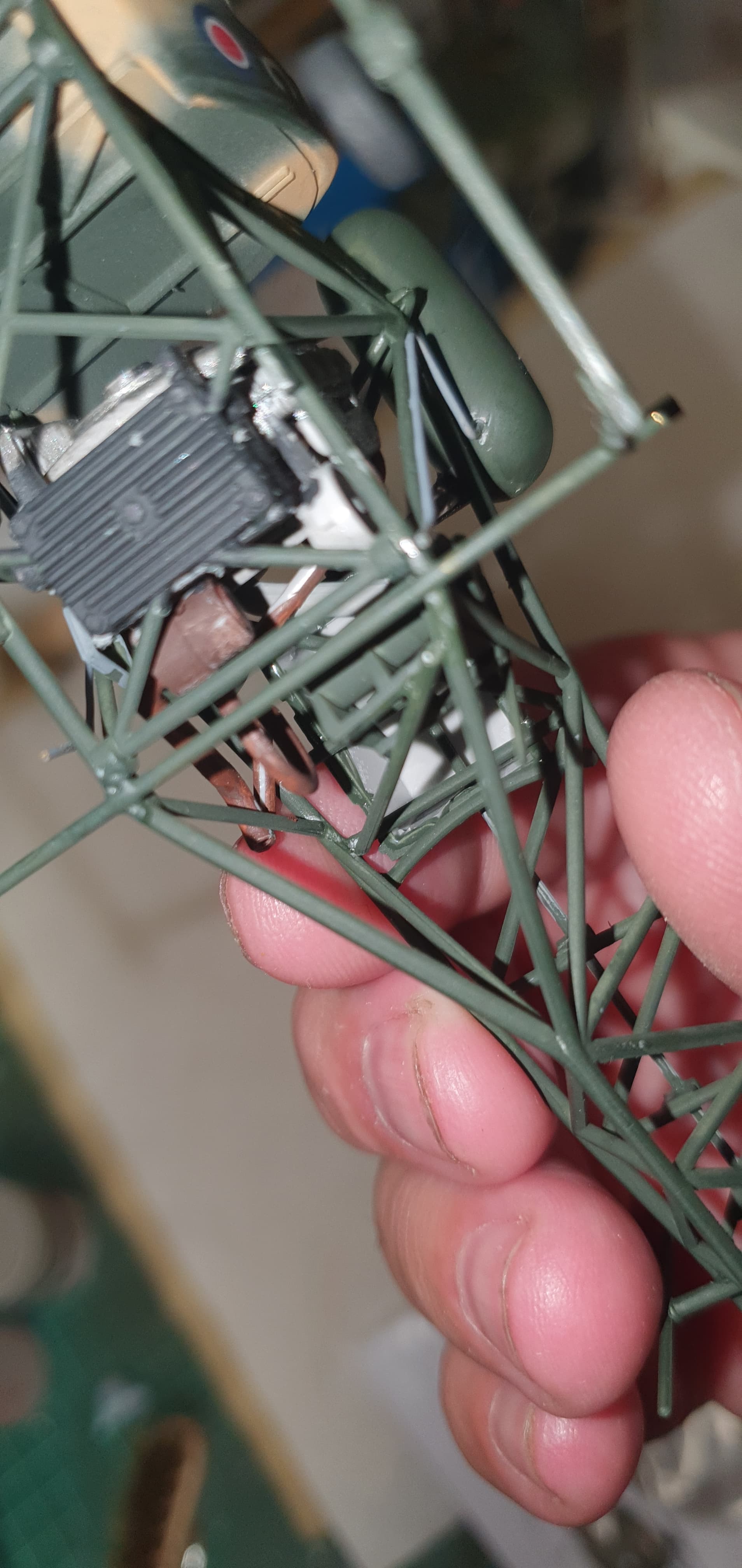

I got a little more work done on the Bell 47/H-13. The truss got paint and the motor mounted. As nice as everything looked in the trial fit, when the glue was on and the overhead truss was installed the motor no longer lined up correctly. Ooooh I hate that! I ended up looking things over and deciding that the gearbox being center in that overhead truss was more important than having the motor square in its mountings. The model will have to be examined carefully from below to see the problem.
I would certainly like to understand where I went wrong, I can only guess that my trial fits were not careful enough.
