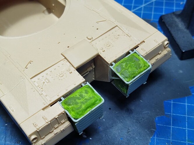

On with the build, another issue of the HobbyBoss Merkava 3 kits is that the rear hull baskets supplied in the kit are those of the Merkava MkIV, which are different in shape (more square and shorter)
Merkava MkIV
Merkava MkIII
YAzG716
I used the leftover parts from my Meng builds and added the canvas bags by using the hobbyboss parts and some tissue paper soaked in pva glue.
Chains and other details will be added later, as I keep on working on the details and corrections I need to make on the upper hull.
