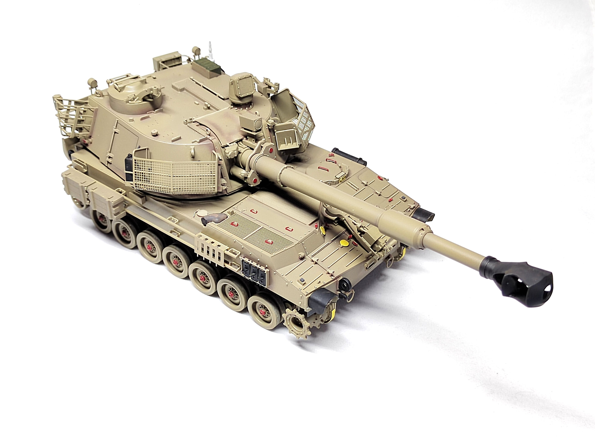

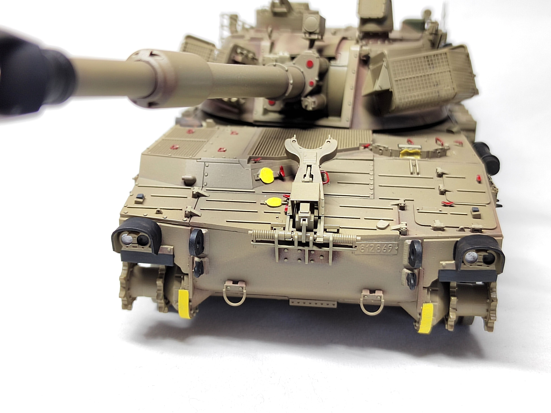

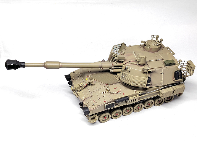

I sprayed the base shade on the Doher with AK Sinai Grey 1982. Then I enlightened the color for the highlights. The details have been painted according to the instructions and reference pictures.
Olivier
The decals are applied. I still need to paint more details according to reference pictures and glue the tools and the cleaning rod on top of the turret. The MAGs will be glued at the very end.

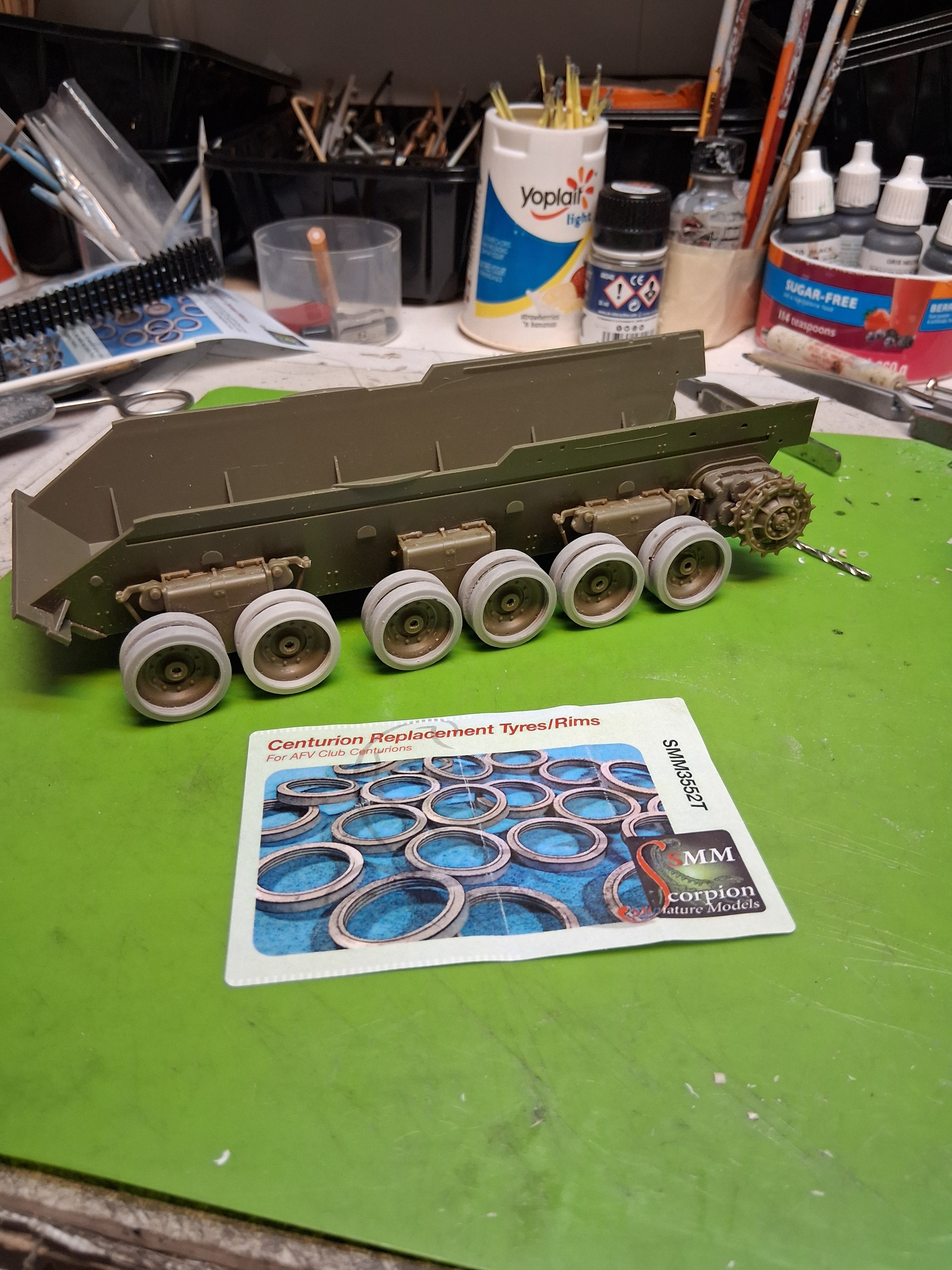

I finally got a start on my Sho’t. Typical AFV Club, soft plastic, several parts broken on the sprues. I’m using Scorpion resin “tires”. They fit, cleanly cast.
I forgot to post the pic of all the goodies…
IMG_4714 by Russel Baer, on Flickr
I’ve got duplicates of some parts so I’ll use whatever looks and fits best where applicable.
