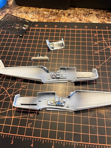

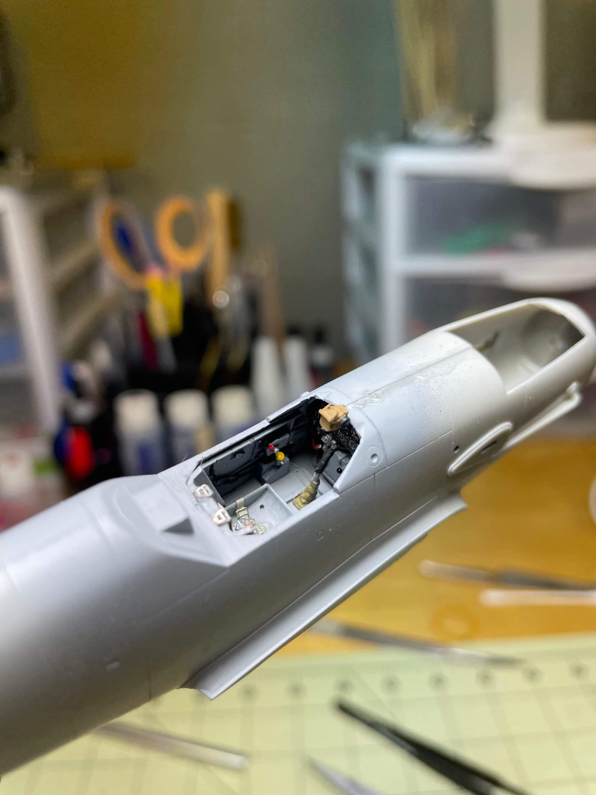

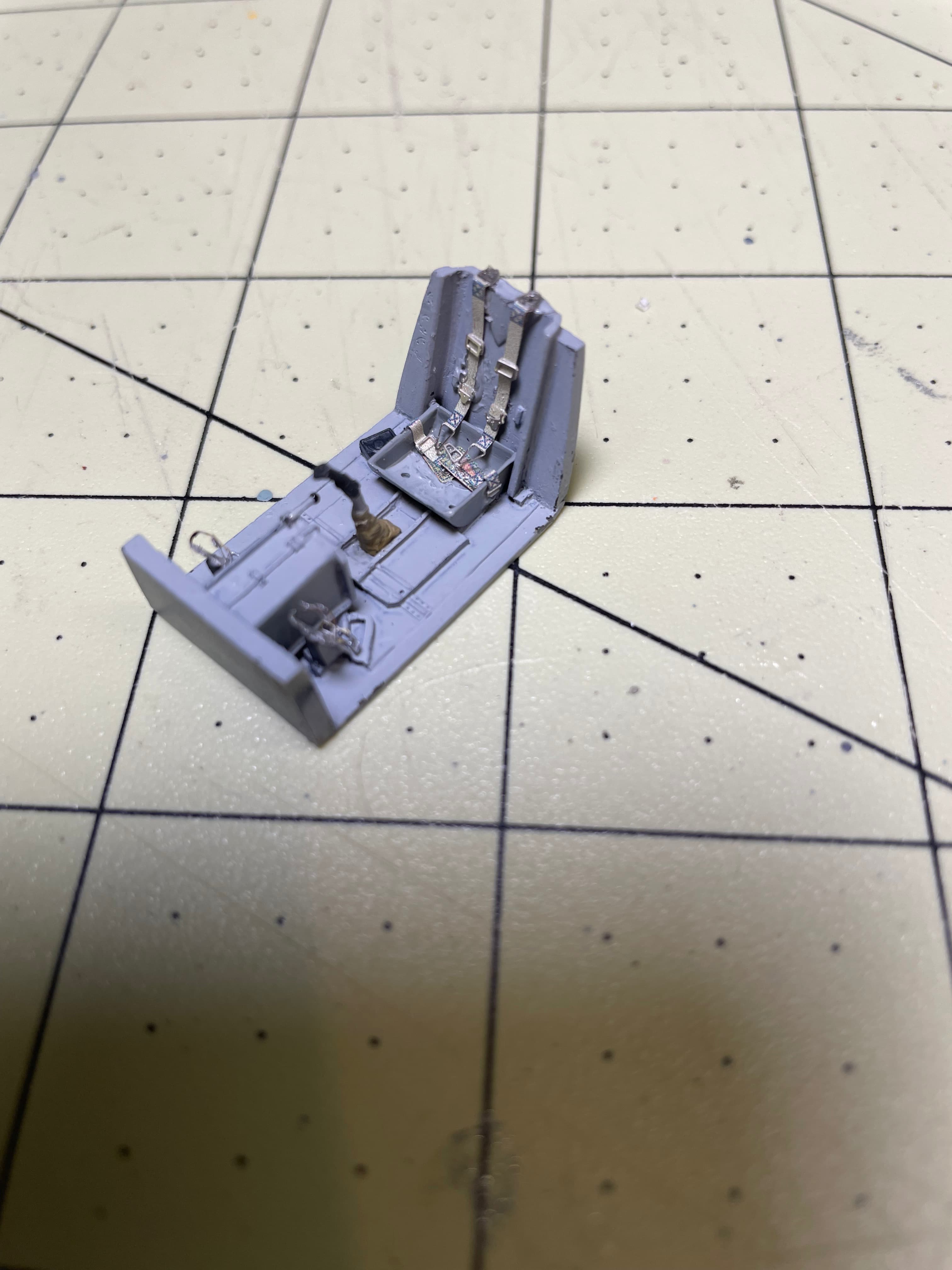

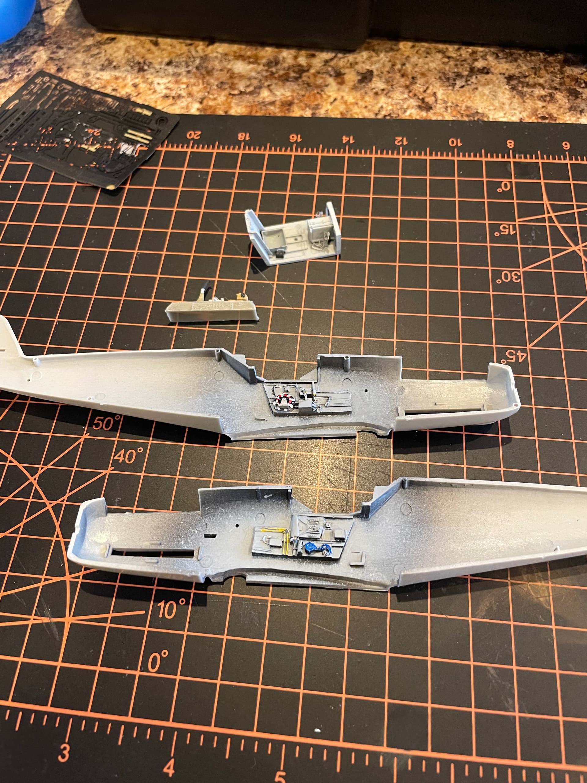

Got some more cockpit painting and detailing done. Photo etch seatbelts look really nice but I still don’t like using PE. Got the cockpit done and installed with fuselage halves joined up.

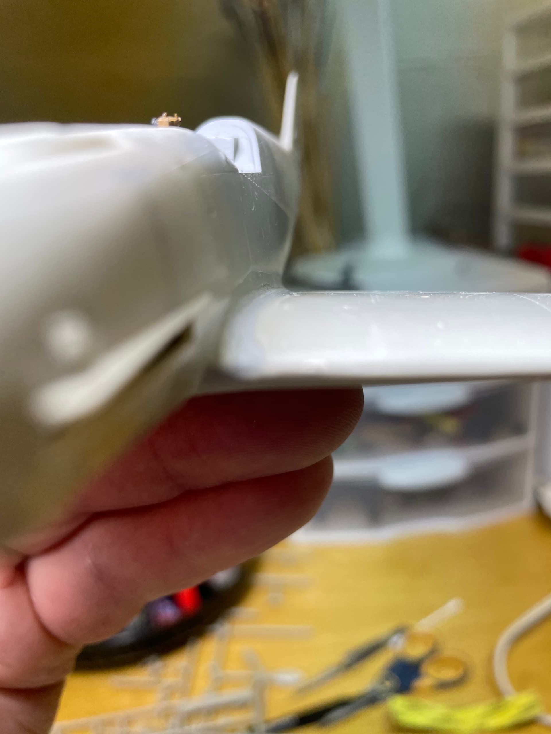

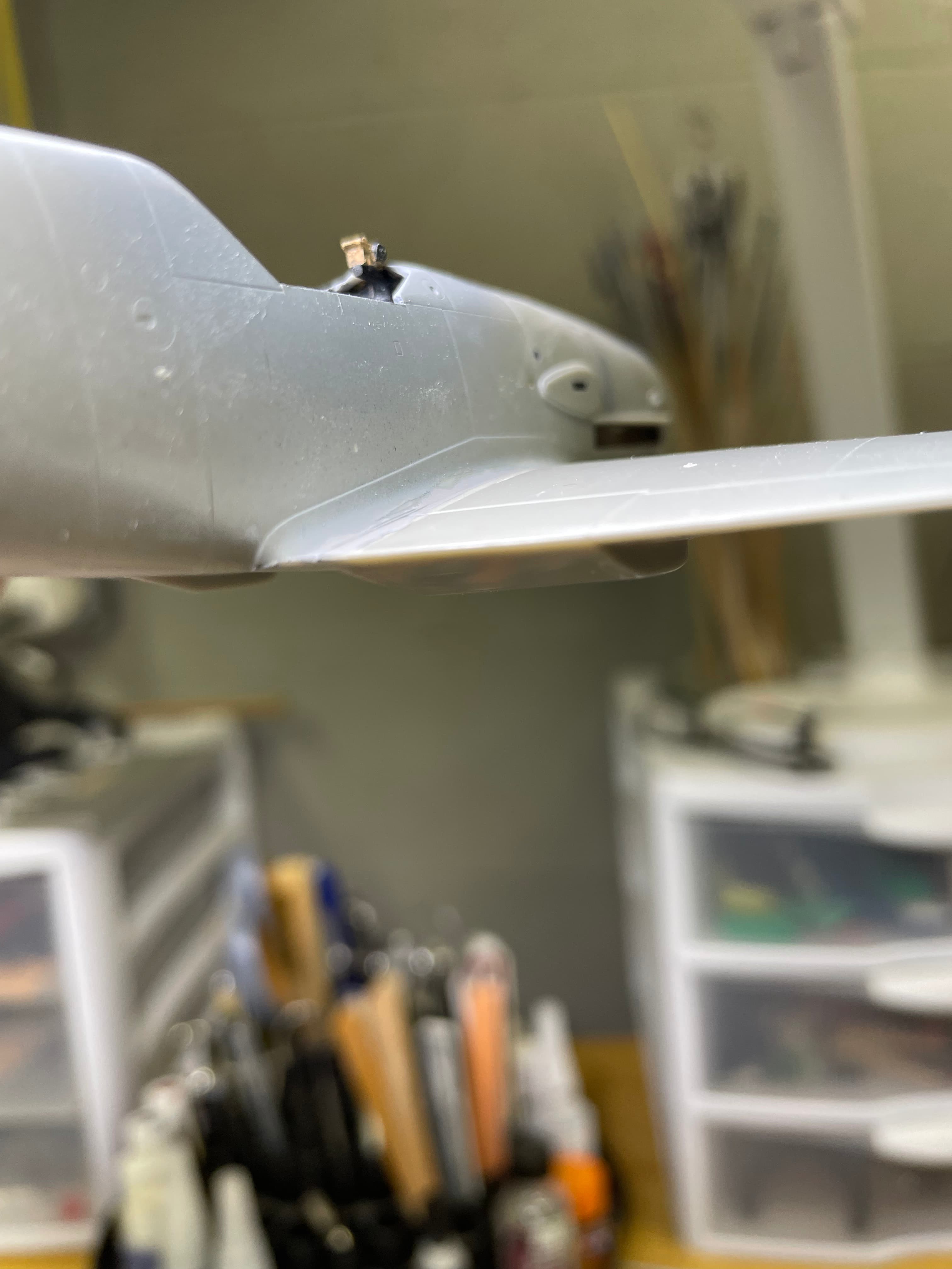

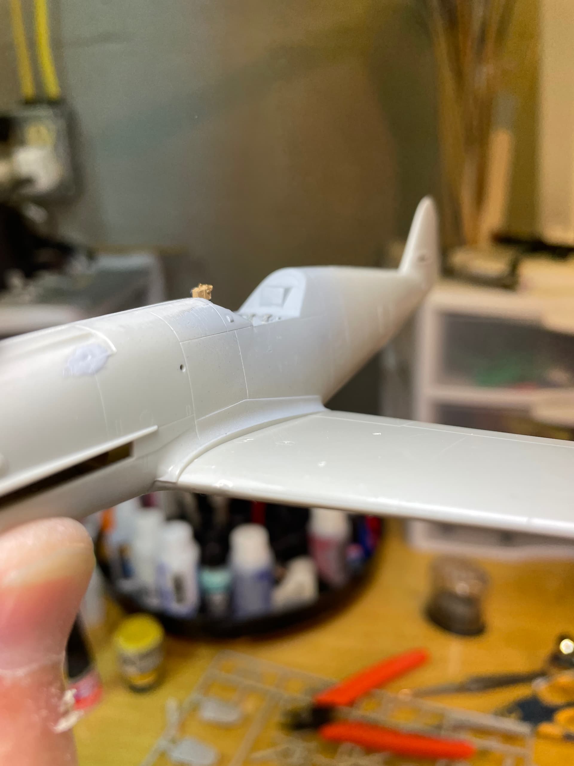

Well this doesn’t look good !!
Definitely not the fit you were looking for :grimacing:

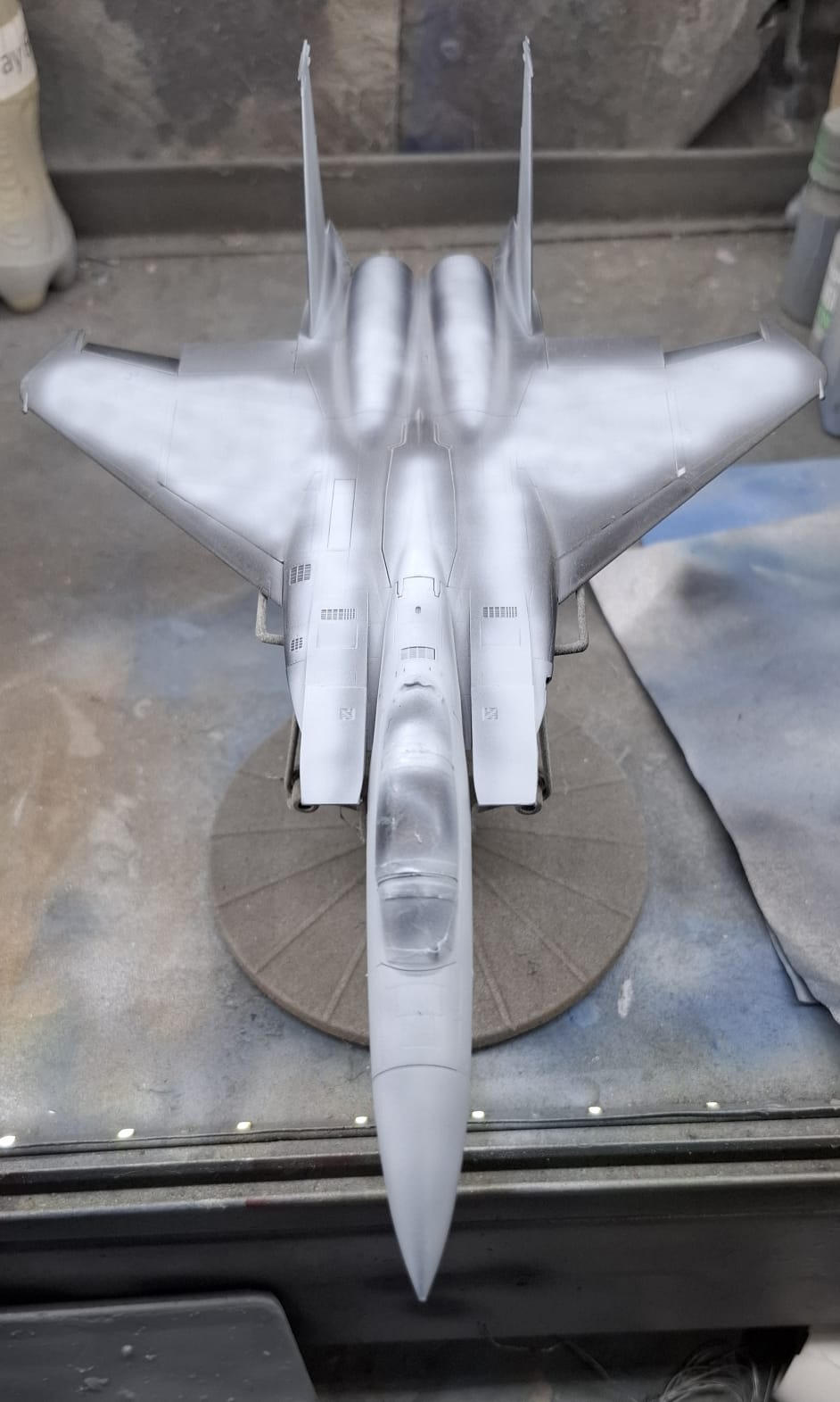

Finally some painting after a long pause :slight_smile: :slight_smile: :slight_smile:

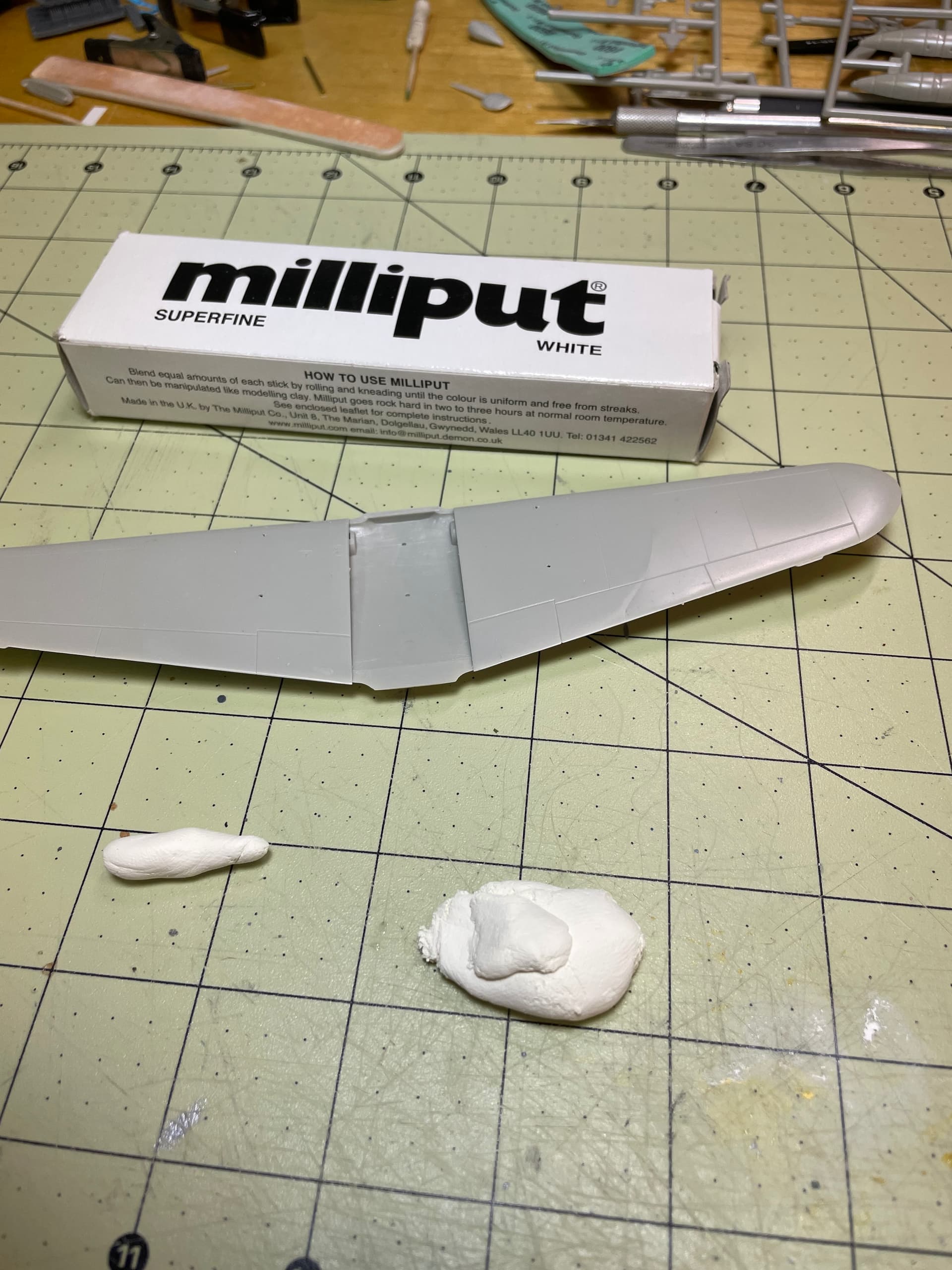

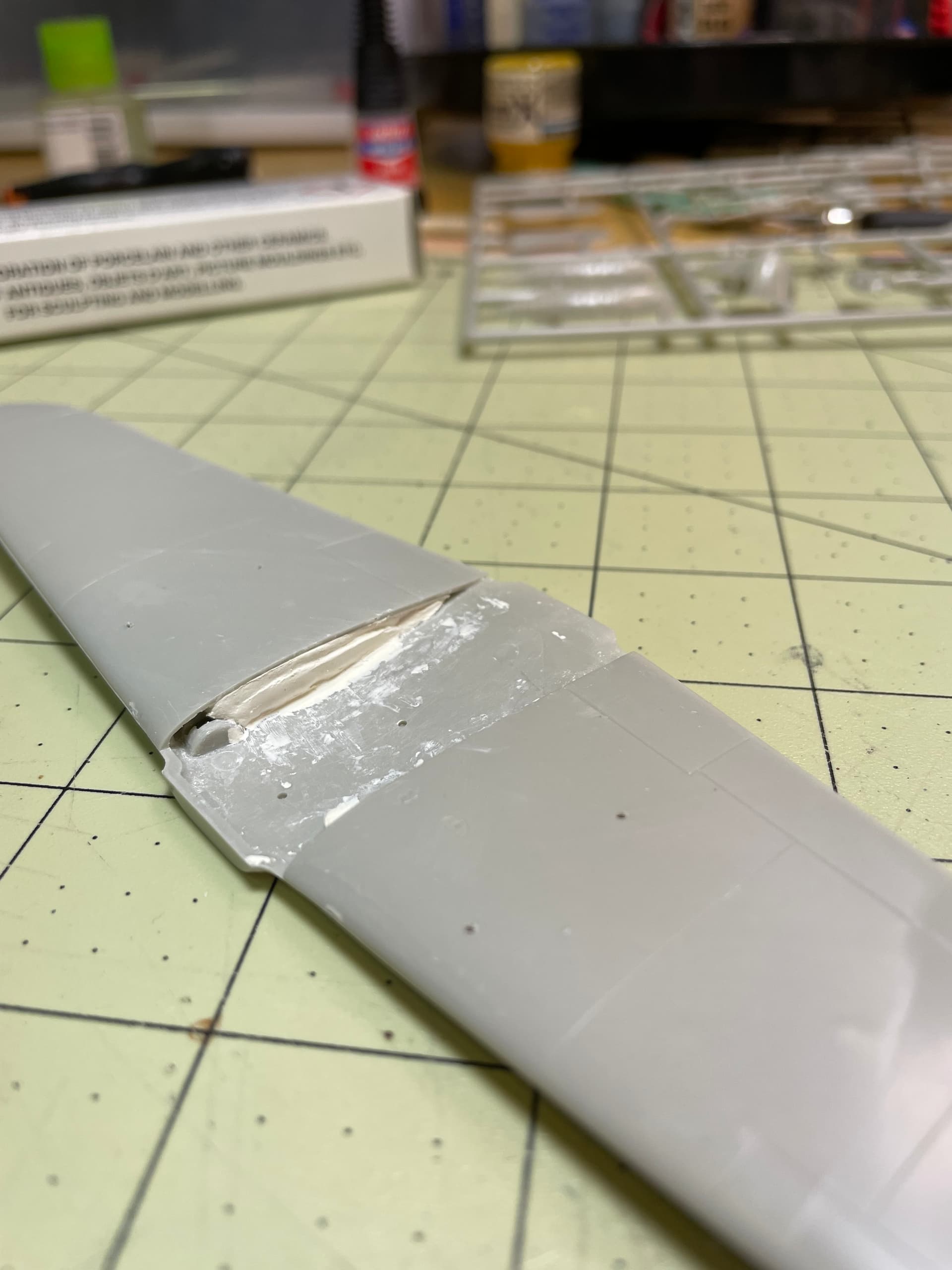

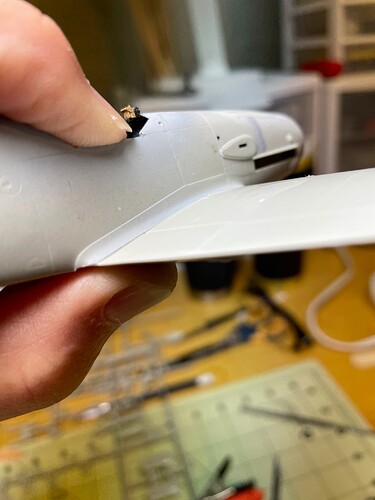

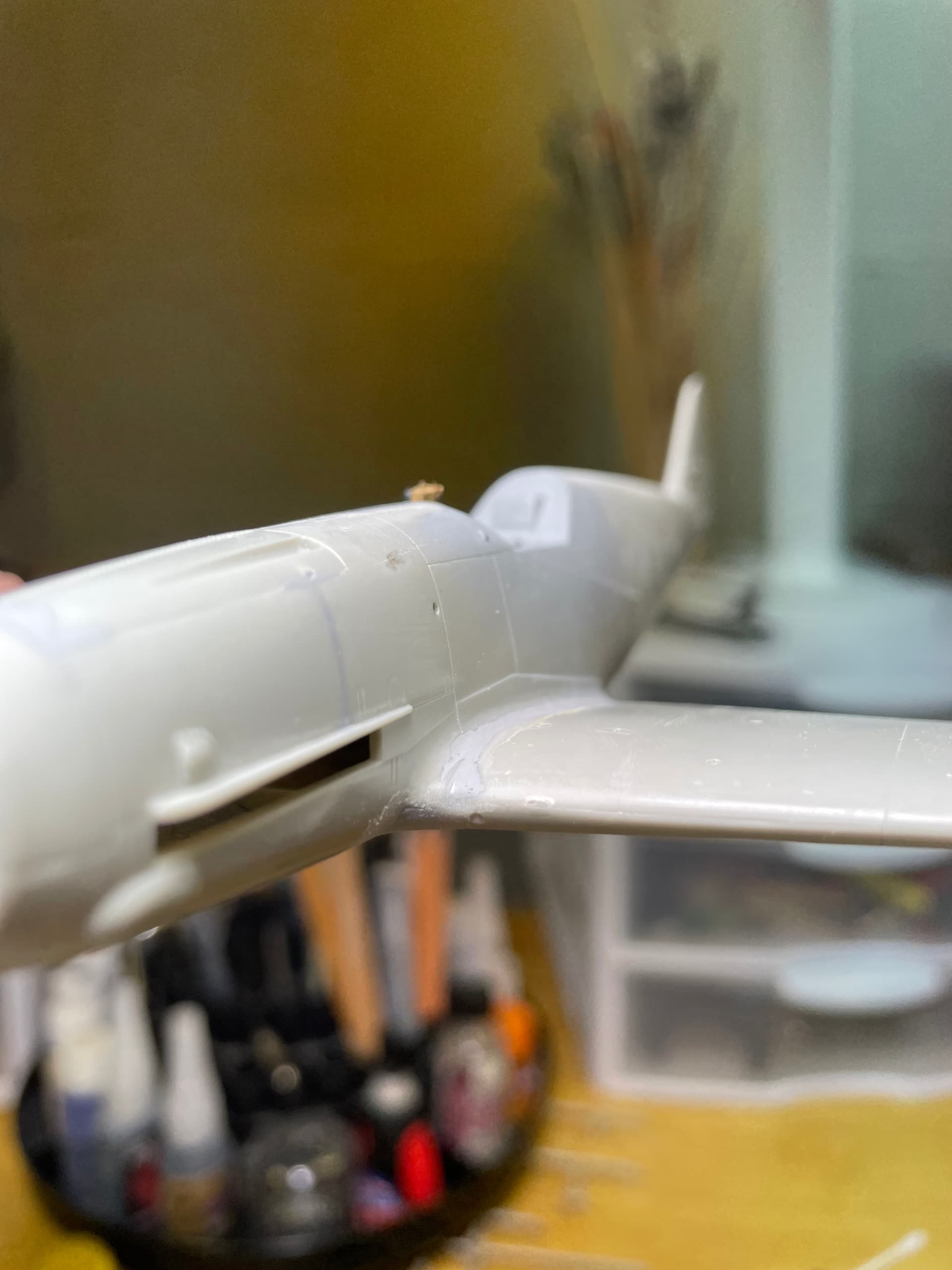

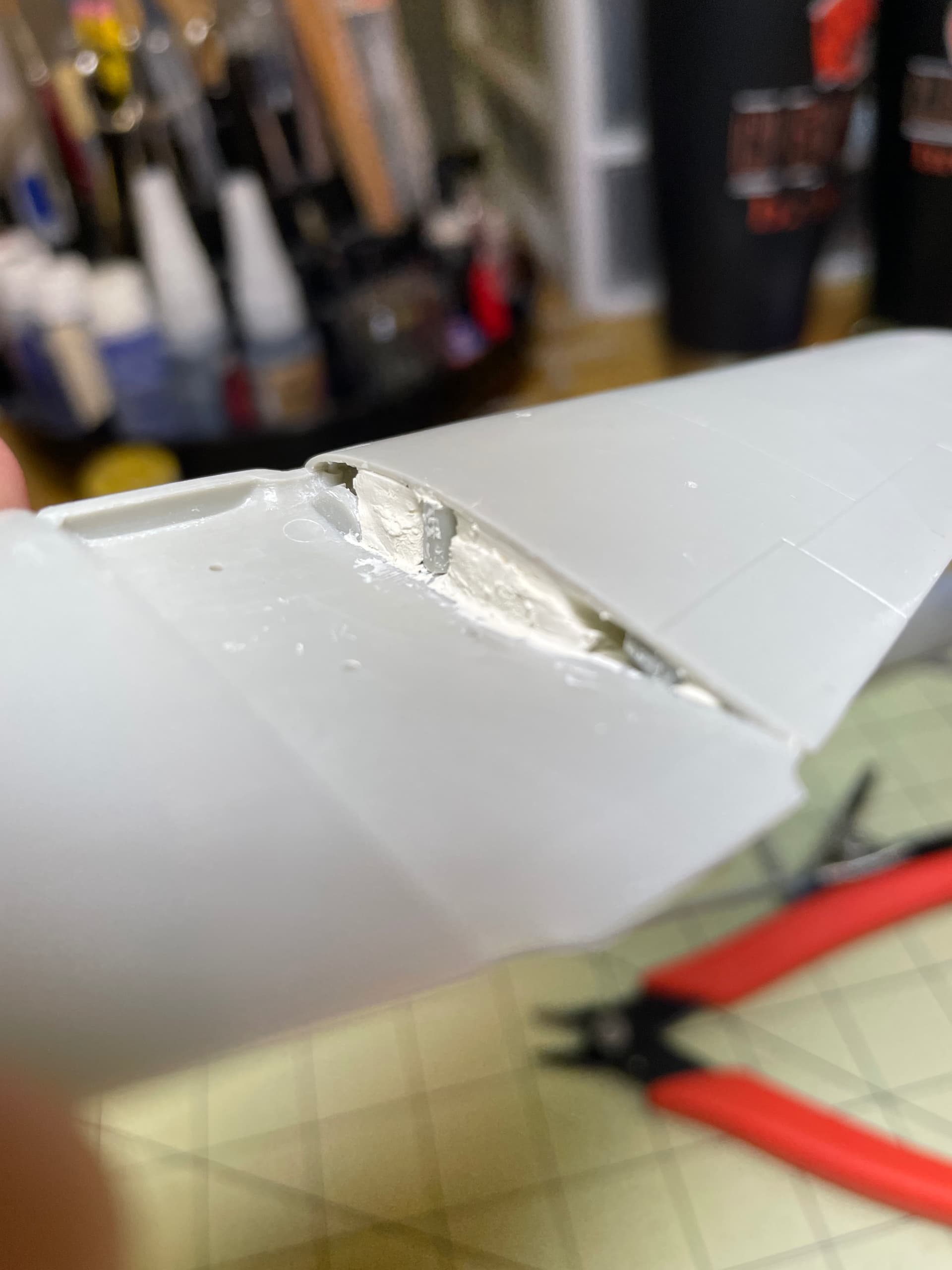

To reduce the step I decided to widen or raise the wing. I mixed up some Milliput and stuffed that into the wing along with some bits of spruce. This seems to have done the job. I’m sure I’ll need some putty and sanding to finish it off but so far I’m pleased with the results.
Nice fix :+1:
I second that - Nice fix.
Clever solution :+1: looks good
Agree, good fix.

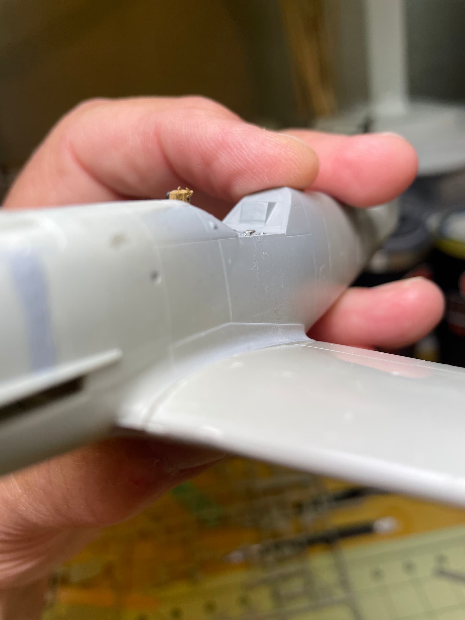

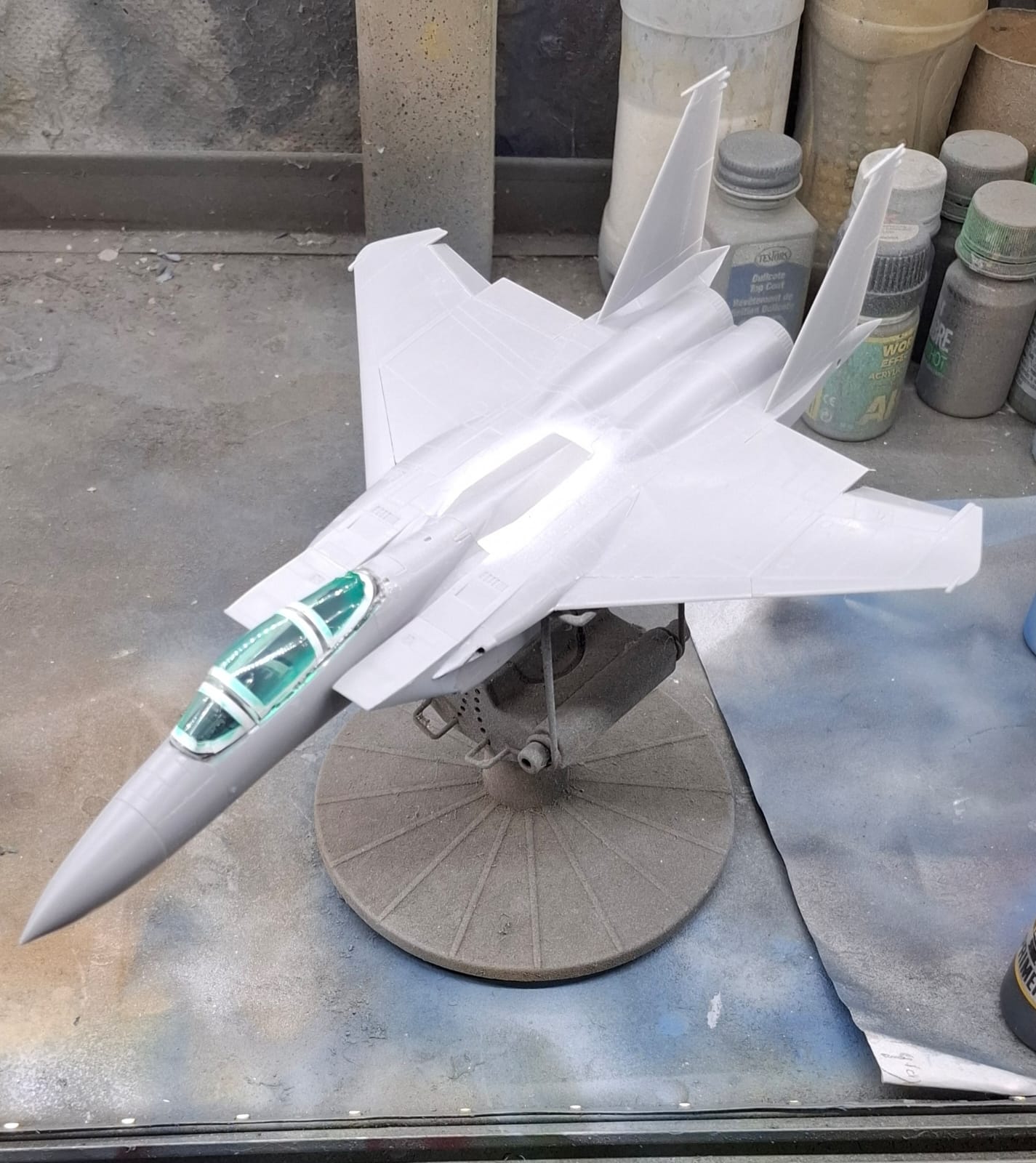

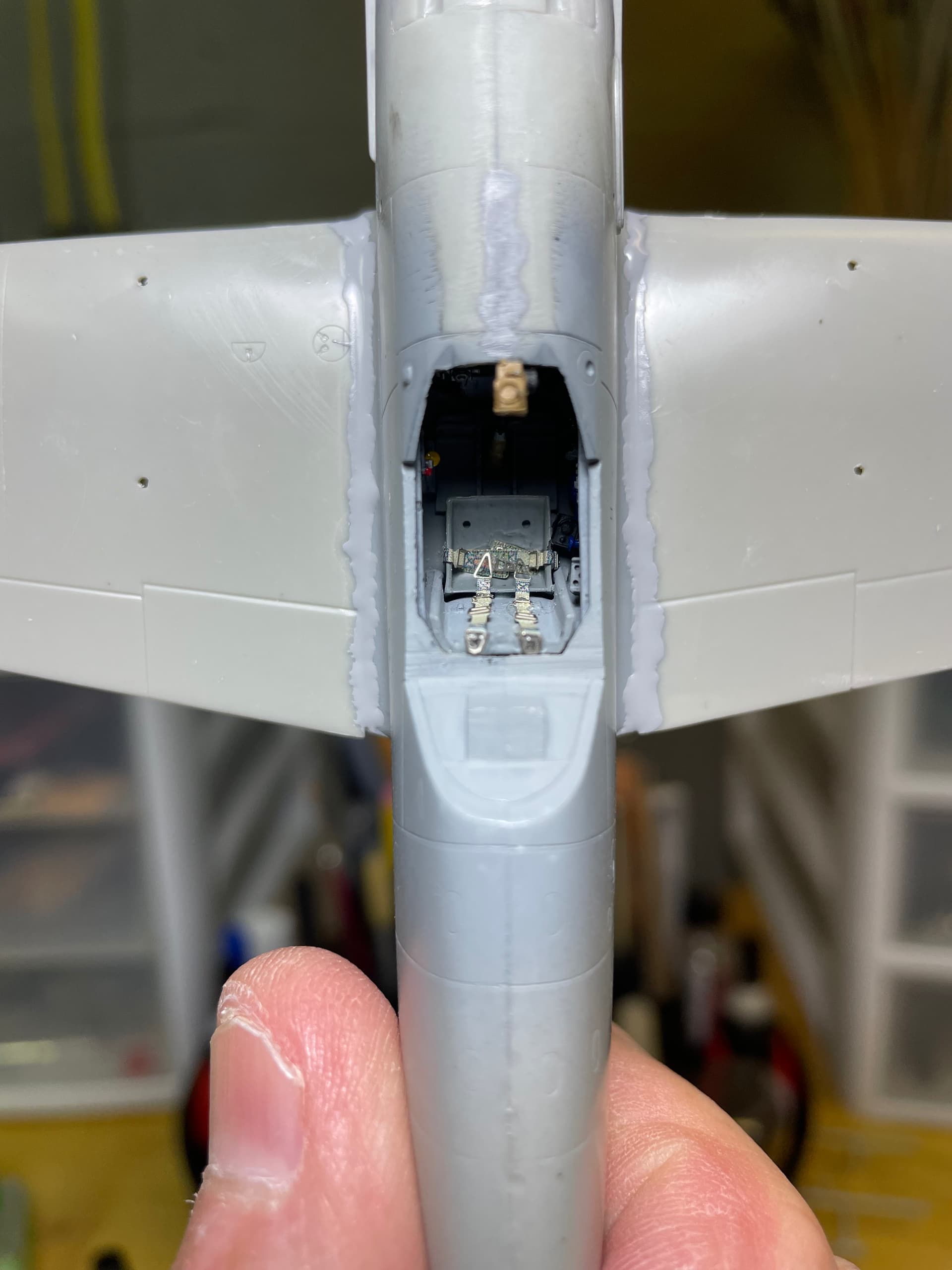

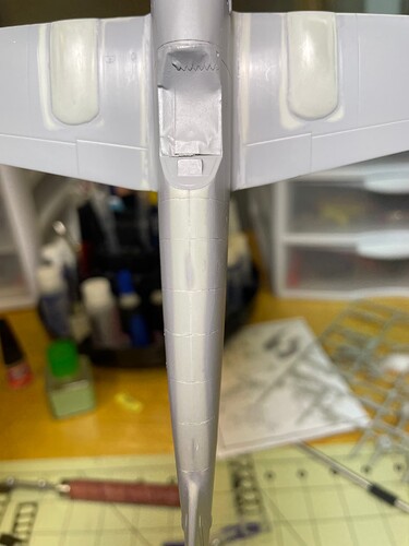

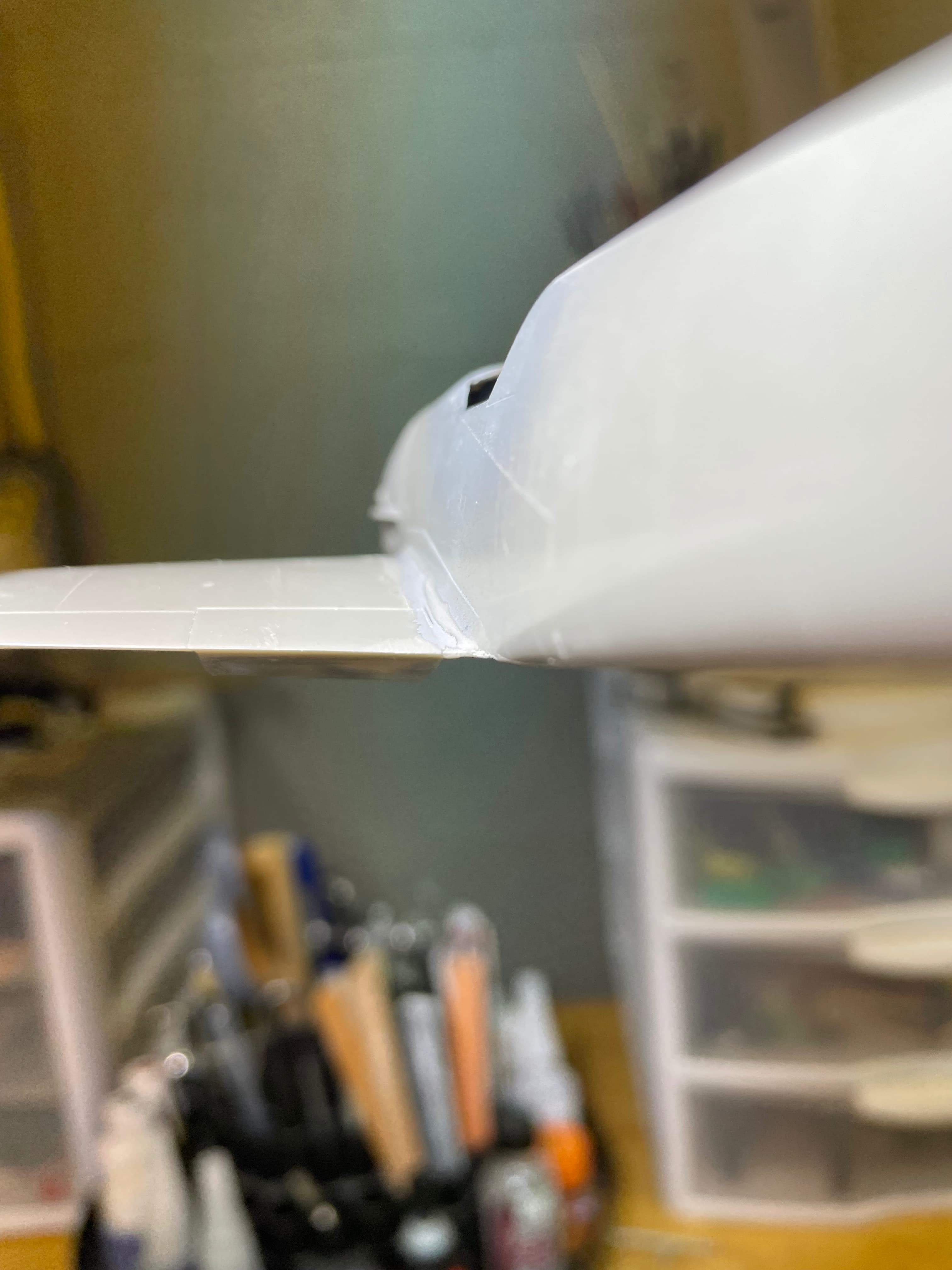

My next step in the wing to fuselage join is applying Mr. Surfacer 500 and now letting that dry.

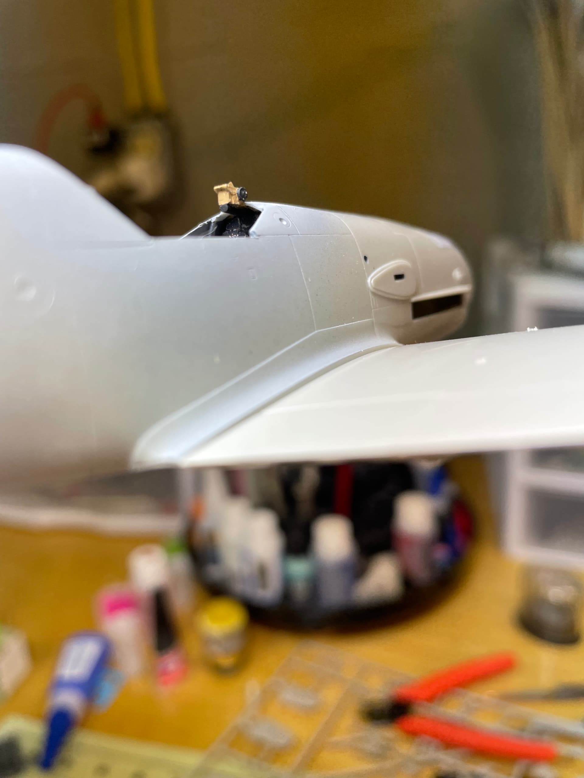

I put on some tape to protect the details and started sanding with a 400 grit sanding sponge. Got to this point.
I will continue sanding using higher grits to finish this off.
That is a big difference to what it was, well done :+1::+1:
Great fix…. Looks very good now.

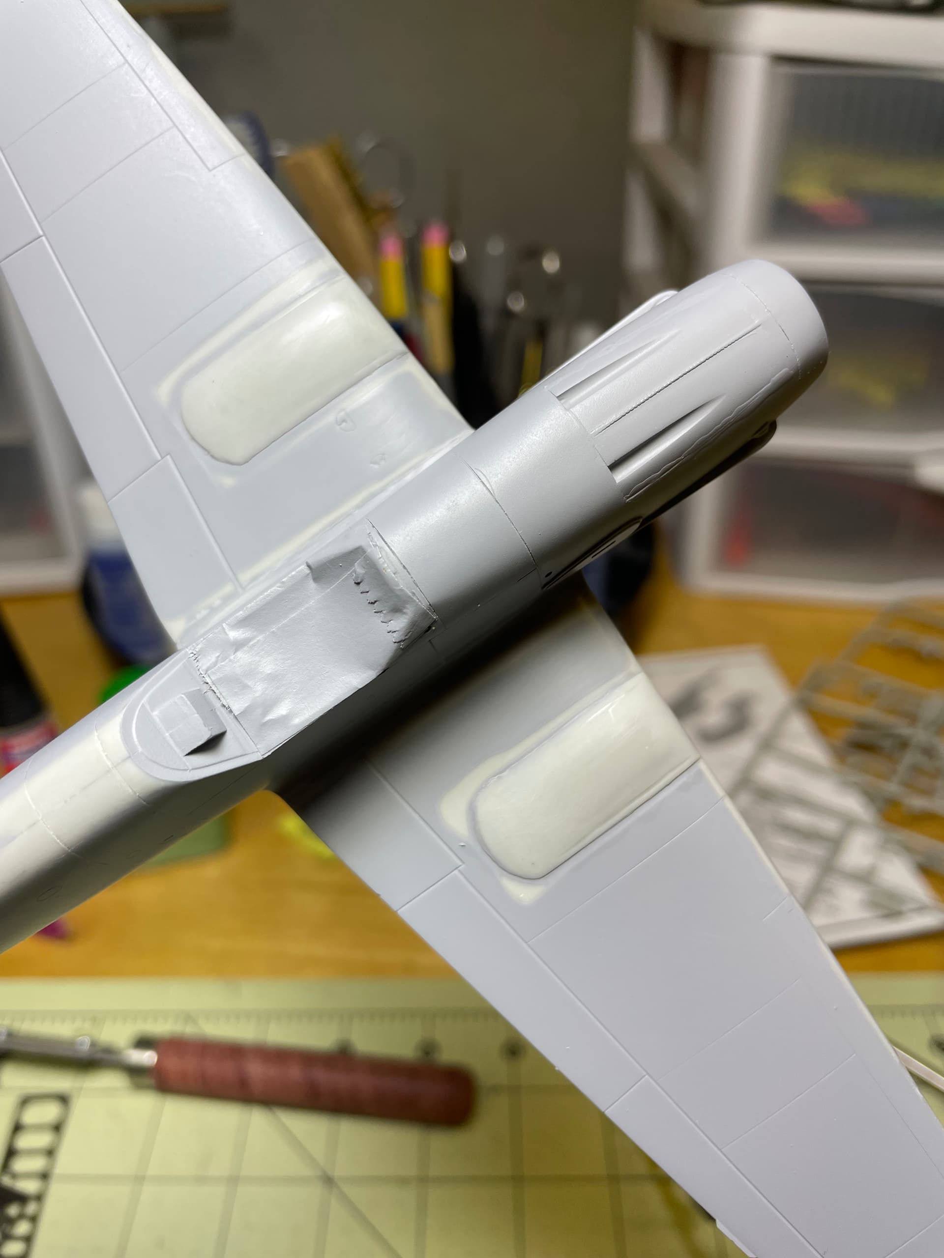

Continuing with the “Mule”, I sanded the fuselage and re-scribed some panel lines, I added the humps onto the wings and sanded the edges to blend them into the wings

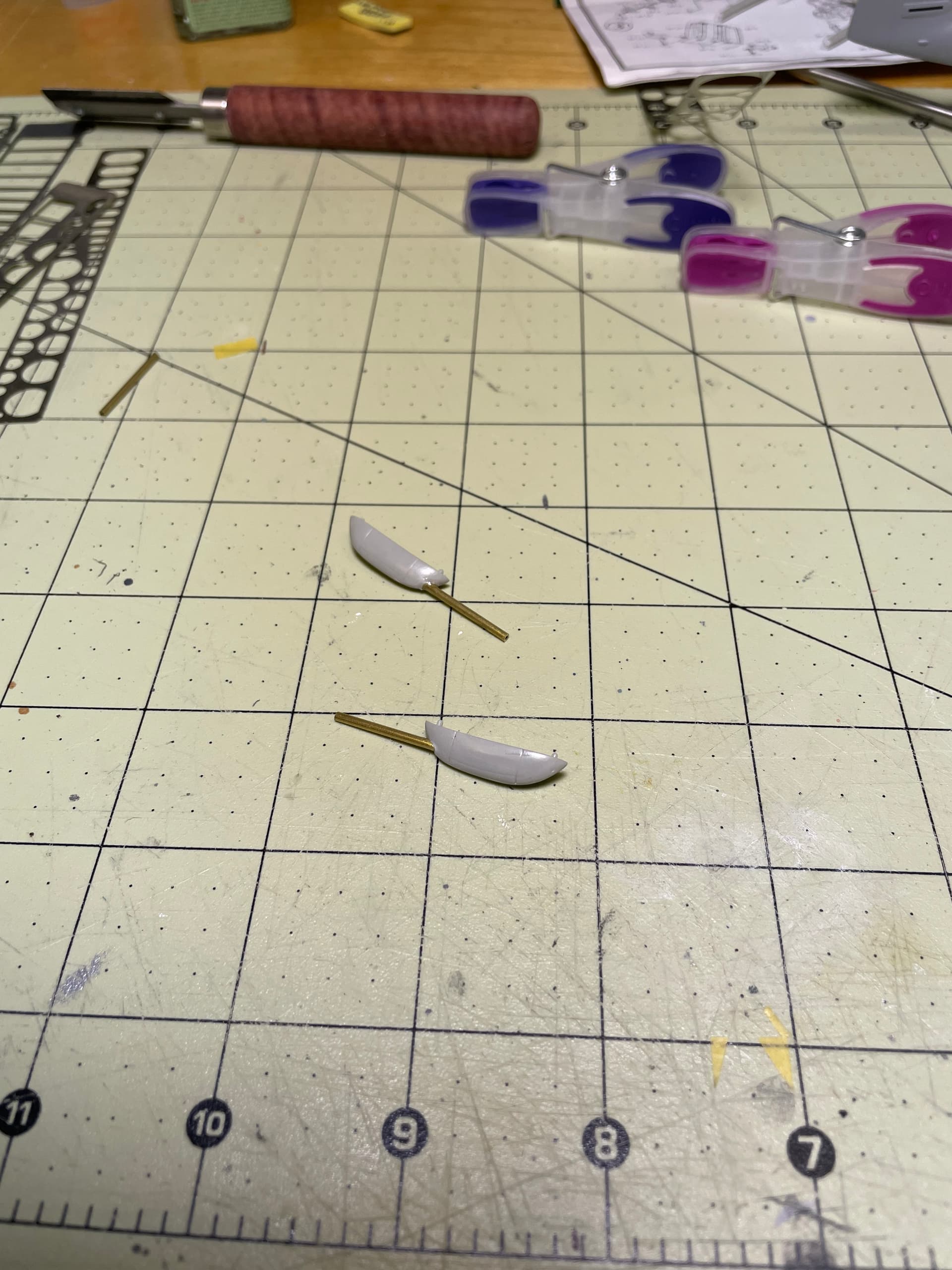

I added some Mr. Surfacer 1000 to some gaps and also to fill some incorrect panel lines on the engine cowlings and then turned my attention to the gun pods that go under the wings. They come with plastic cannon barrels so I cut them off and inserted brass tubing instead.

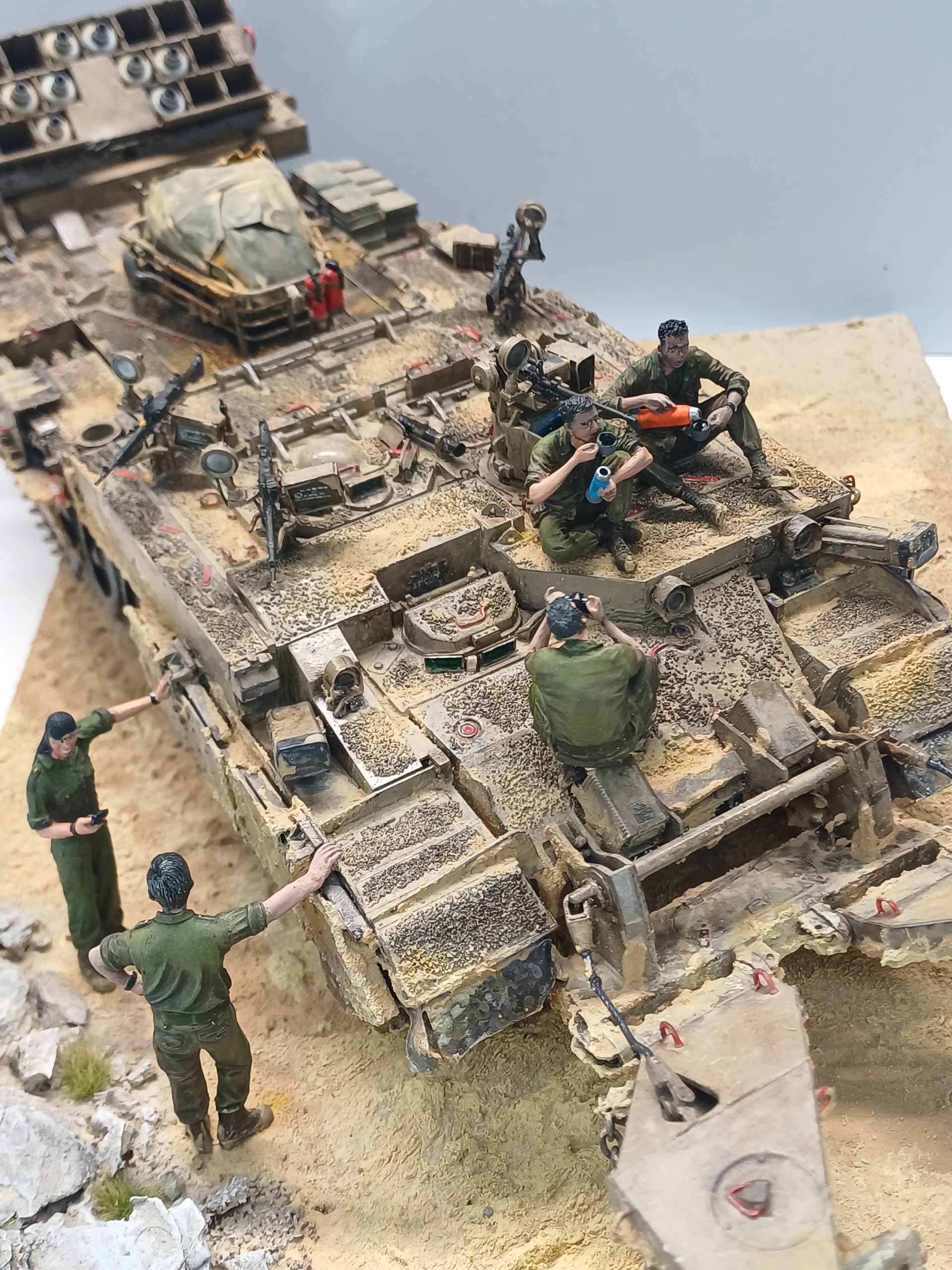

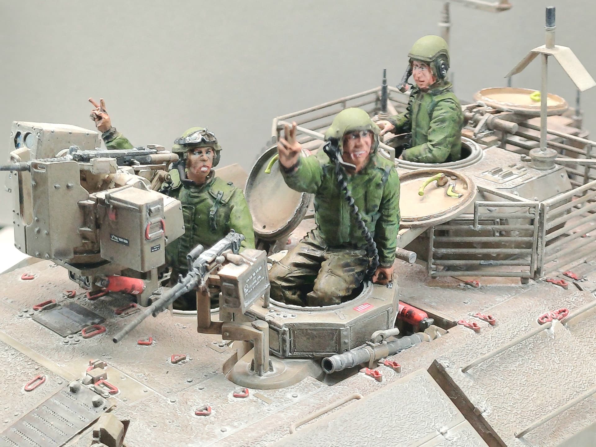

Finally added the figures to my Namer and Puma..
Great builds Bert and adding those figures really gives each vehicle a nice sense of scale, and adds a bit more to the story :+1:
Thanks very much!
Great finish Bert. I fully second Johnny’s comment about the figures.

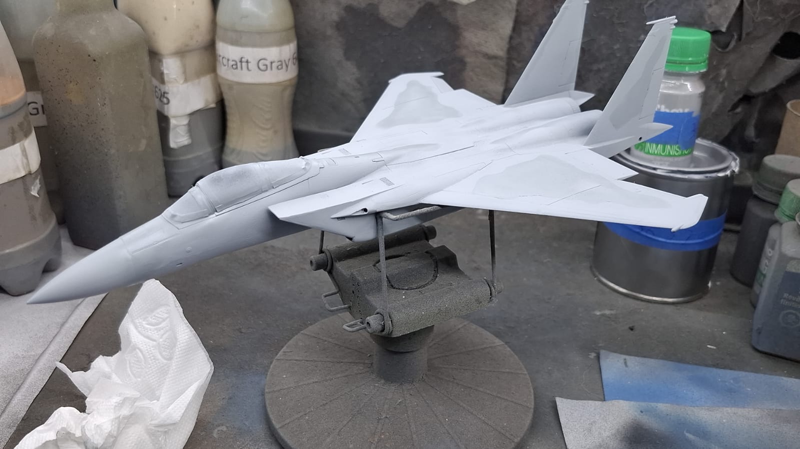

Uh oh. Well, given that I seem to have lost my mojo on the F-15I, maybe this will perk things up!
