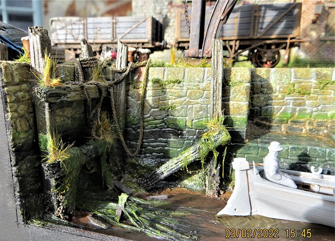

I’ve commented on your other thread regarding the doors of the tilly. But want to again comment on the quality of your A4 builds. For me it is the attention to detail that stands out, here including the water marks, sea weed (including painting of such), etc. The work is inspiring - I just need the time to crack on with some models, and have a go at dioramas again.

A big thank you to Fred, John and Andrew for their kind words, it is very much appreciated chaps, :+1: :slightly_smiling_face:.

Modification of the boat finished, rudder added, so tried dry-fitting it in position to see how the composition works with all the other elements (only figures missing).
The bulk of the figures will fill the empty area of quay to the right-hand side, in front of the Tilly. I’m also thinking that the boat needs to be further out and more to the right, maybe a crew starting to row away having dropped off some troops, :roll_eyes: :thinking:.
Any suggestions/thoughts on composition/location of elements please feel free to contribute.
