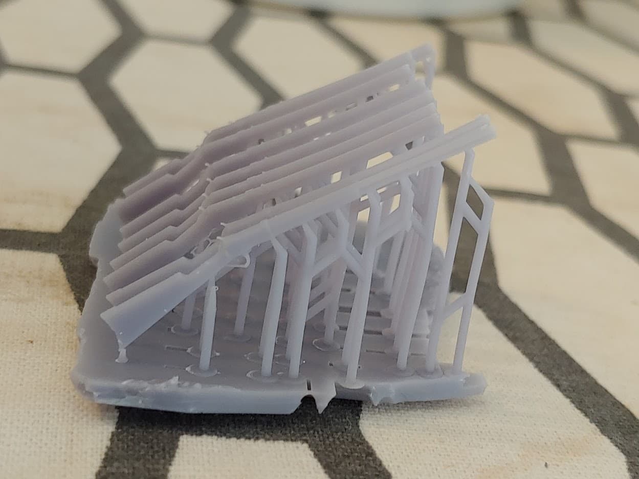

Some photos of the printed Henry rifles and Winchester (1892) rifles:
Wanted to let everyone see the Henry rifle that James printed for me this past week. He printed 7 Henry’s and 2 Winchesters for a very, very agreeable price and shipped them to me.
This is the Master Box Bounty Hunter “Pedro M.” kit that I did a lot of modification to. The kit rifle appeared to be an 1895 Winchester, which is what I wanted to replace with the more recognizable Henry rifle. Now he looks like a “Let’s get down to business Bounty Hunter.”
Jame’s prints are amazing with hardly any cleanup. You can even see the lever opening in the top of the receiver. A top quality job worth every penny.
