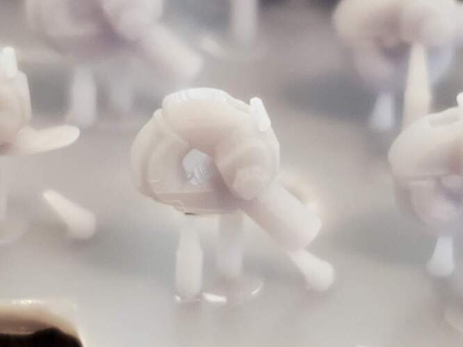

Just 3D printed some 1/35 accs. with Elegoo Mars 3

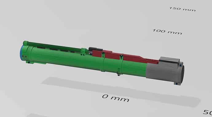

One more CAD for 3D printing done~! RPG-22.
Looks fairly close to the real thing to me. What do you think?
Reference photos:

RPG-18 and RPG-22 prints in 1/35 done!

After the supports removed and some initial clean-up
Before removing the supports:

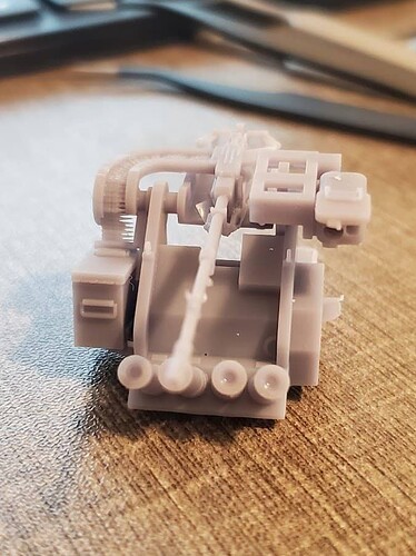

One more thing added to my portfolio. Gaz Tiger remote weapon station:
Need to overscale the spent shell basket next time - too thin to print.
