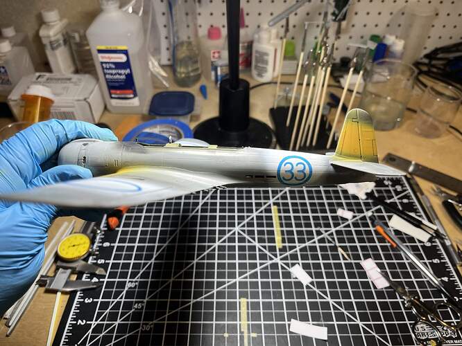

Got the leading edge ID bands on as well as painter the tail yellow for the tail code. Also got the white down for the hinumaru roundel edges, and as a base for the red. Waiting for it to cure before masking it all with cricut cut stencils
Insignia yellow was 1 part flat red to 10 parts flat yellow, pretty happy with the color

Got the markings down for the rounders. Took longer than I wanted as my cricut was acting up and refused to cut a circle. Think the blade was dirty. I loath fuselage side markings, lining them up is a pain.
Planned to get the red down tonight but ran out of time. Tomorrow it is! My squadron vaccuform canopy arrived the other day! I’m intimidated by it but will tackle it soon

You need the cricut design space app to design the masks. It’s really easy to use. For the wing roundels I used two different sized circles, when the cricut cuts you get the outer ring and an inner circle to cover up the red once I spray it. For the fuselage roundels I did the same, but then found a font that matched the decals and added the 33. Once layered on the app you get the ring, and a inner circle with two 33’s cut into it. I then use transfer tape to move it all to the plane which keeps everything aligned. I then removed the inner circle leaving behind the 33 and the ring. Once I spray the red I’ll I’ll in the circle with masking tape. Here is a picture of the stencils on design space
the white lines show where cuts will be made

Roundels red down. Went with a mix of roughly 1 part hull red XF-9 to 9 parts xf-7 flat red.
Pretty happy with the color and coverage. I’m be thing I like to do with reds, yellows, and white is to let them sit for a day to make sure I am happy with the coverage. If I am, I will do the nerve wracking task of removing the 33 stencils from the fuselage roundels to check for bleed through, if we are all I’ll mask the inside of the upper wing roundels and fuselage roundels then plop down the circle masks for the lower wing. Then I need to work on the canopy, mask the cockpit and paint! Getting close!

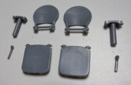

I have cut out and cleaned up the parts for the mount base and the gun trainer and gunner’s seats. I could feel the yearning of the seat levers for the freedom of my bedroom carpet.

Couldn’t help myself. Peeled off the 33 masks last night. Pretty pumped with how it turned out!

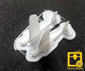

I also have something on the subject of Japan.
“Shimpū Tokkōtai / Divine Wind”
I have recreated the photo that everyone probably knows on a scale of approx. 1:150.
First the photo
Here are the parts I printed out:
am_110
am_210
am_310
And here the vingnette, ready built.
It turned out a bit like a comic:
