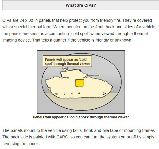

No, it is a CIP (Combat Identifier Panel), it folds up to “turn it off” so it is not seen in thermals.

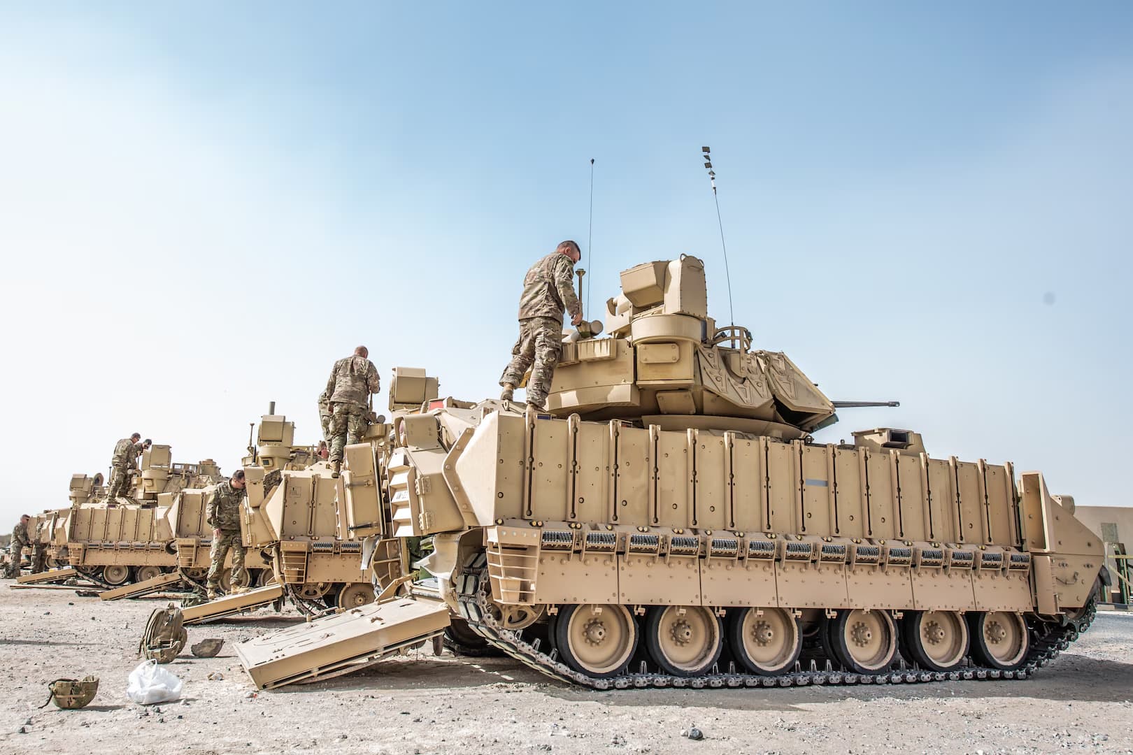

They are on both front slopes of the turret, along with the sides and rear of the hull. Below you can see both turret CIPs open, they appear as darker rhomboids.
From PS Magazine
It’s a Combat Identification Panel.

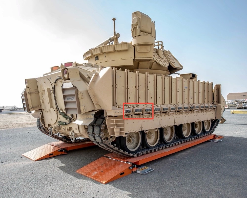

Does anyone have a closeup photo of the ERA bracket mounting marked below? I’d be extremely grateful. Thank you. Luke
Welcome to the forum!

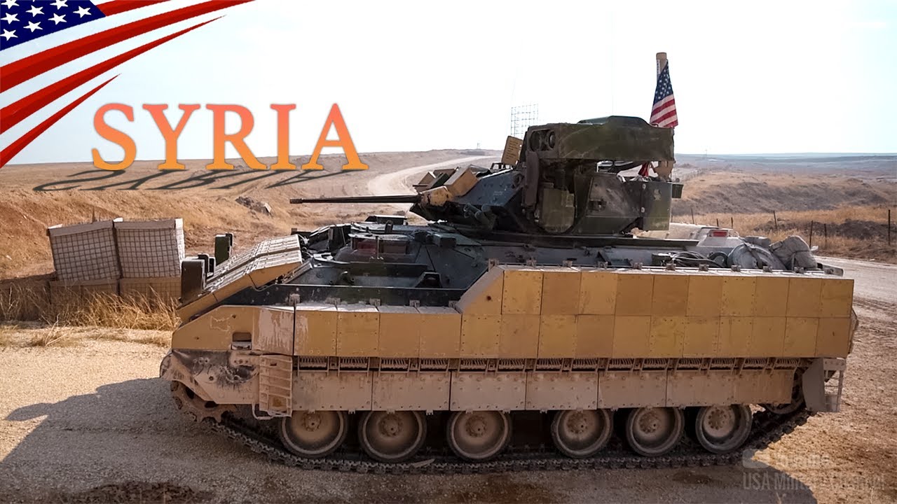

Not a close up. Just a similar photo of about the same fidelity on a Bradley in
Syria. I’ve been working up the entire lower array as seen for the Bradley in this thread.
As you can imagine, it’s taking a while, hence no updates.
Oops, no photo of the Syrian one in this thread. There’s another, but no time now.
Thank you very much!
This is one I happened to have on my computer. No wifi where I am and only one bar on my phone for tethering.
According the the Caption I put on it, it’s Ali Al Salem. Anyone who’s been there knows how much it sucks. But I believe all of these Bradleys were on their way to Syria a few years ago. I’m using a jig for the armor plates. The ERA brackets are available in PE.
The hardest part is the springs. I’m using copper wire twisted together and then wound around a drill bit.
That’s really helpful, thank you. Would be nice to know what shape those boxes with springs were actually :frowning:
Each one appears to me to be a long, square prism with four bolts on top. That’s what I’m going with.

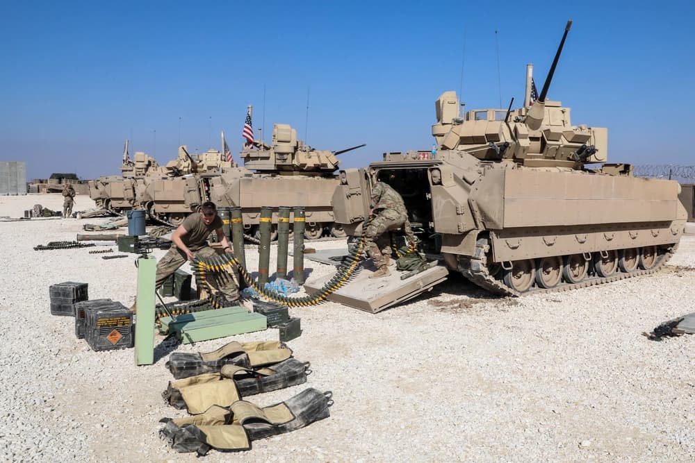

The inspiration for my load out diorama and all of the scratchbuilt items comes from these photos:
There will be an SF straphanger off to the side inspecting his sniper system.
