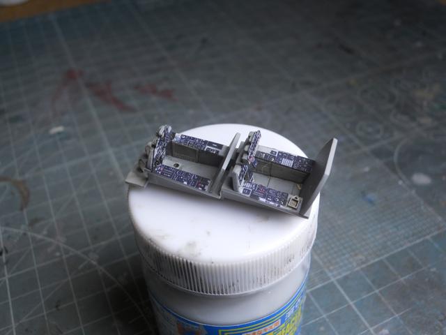

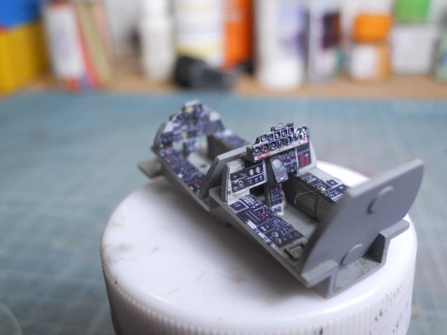

Well, I think I am now caught up with my Phantom build “Do Over” for this campaign. I have finished a second cockpit using a spare hasegawa RF-4E I had in my stash but this time I used Eduard PE to dress up the rather plain cockpit rather than the ill fitting Aries cockpit. Here’s the replacement 'pit before I sandwich it between the replacement fuselage halves:
Now it is time to button things up!
Have fun modeling
Mike
:beer:
I do love these intricate cockpit details. I wish mine had looked like those :+1:
Beautiful cockpit, Mike. Very nice and fine details!

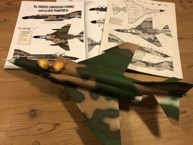

I have made a bit more progress on my F-4E. The camouflage is on. I really love the SEA camouflage scheme. It will look good with a shark mouth on. :slight_smile:
More to follow :slightly_smiling_face:
That is a great looking camo job, SGTJKJ! That scheme really suits the Phantom. I like the way that the F-4E looks, what paint did you use? It has a “just right” look.

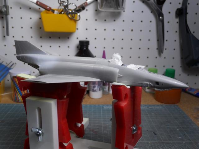

My build is starting to look like a Phantom! Once I was finished with the cockpit, I buttoned it up within the fuselage halves and added the intakes and wings. Here’s how it looks on my bench:
Now i is on to putty/sand/repeat to minimize the different misaligned sections that didn’t quite fit. Yup, it is a typical 1/72 Hasegawa Phantom!

Thanks for the comments, Mike. I used AK Interactives SEA real colors set. They spray beautifully and the colors seem very accurate.
Greg, as already pointed out there is an official camo scheme. It is a beautiful colorful scheme. Luckily there are significant variations in the scheme, so you have significant artistic license.
I studied the edges of the camo quite closely myself. It is a semi soft edge, which is difficult to recreate. I think you rolls of putty could work great. For mine I used freehand first and then masked the edges with putty. Quite satisfied with the result. Notice the putty rolls should have the same thinkness to give the same degree of soft edges.
Looking forward to see more :slightly_smiling_face:

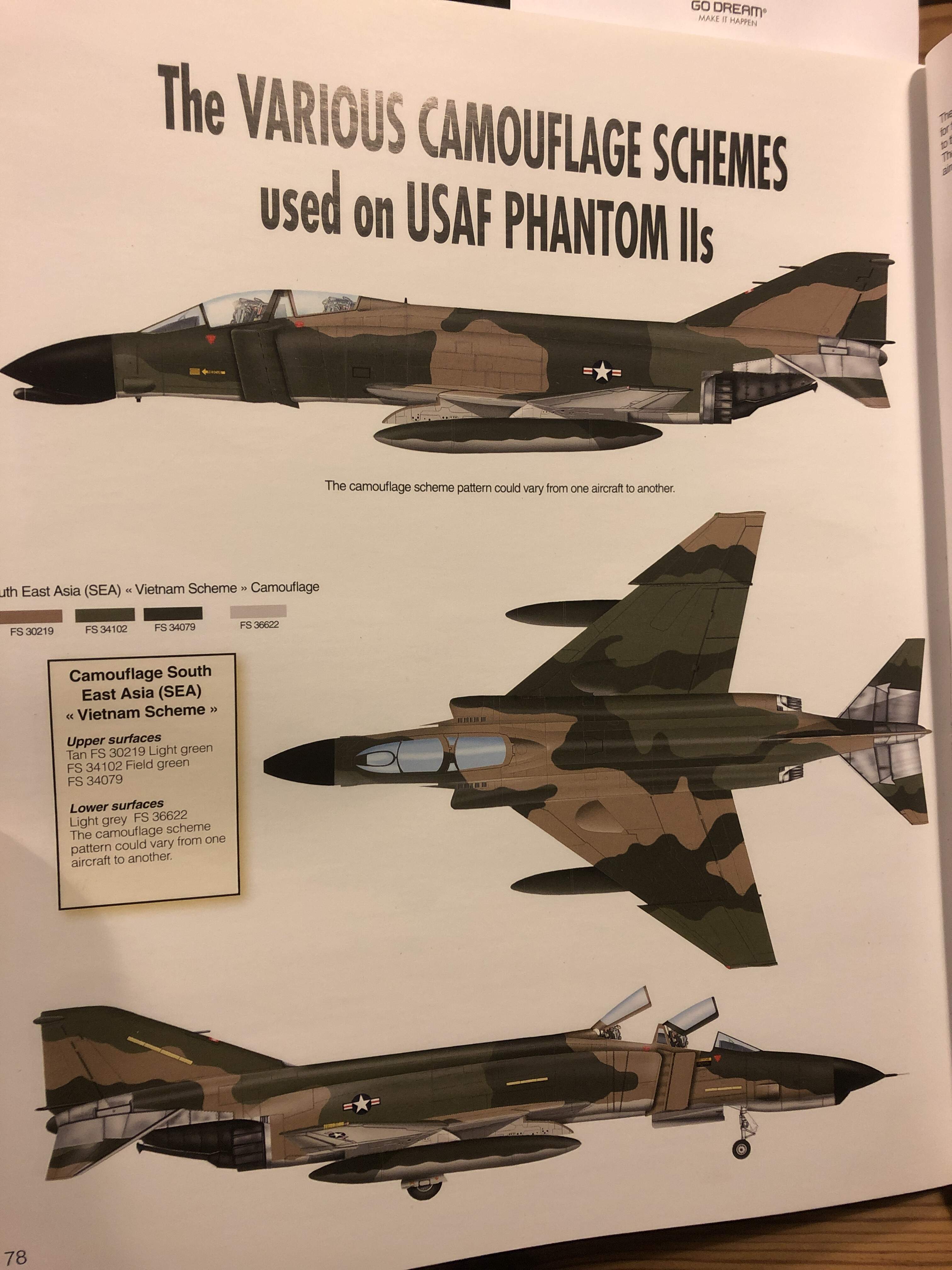

Greg, here are a couple of pictures further to our discussion. You can see the camo scheme pattern I used.
In the picture you can see the subtle differences in camo scheme between aircraft. This is not a Vietnam era photo but it illustrates the differences very well.
I have a Vietnam photo of a four plane flight where the differences are subtle, but shows that every aircraft have subtle differences. I cannot seem to find that photo now. Sorry.
