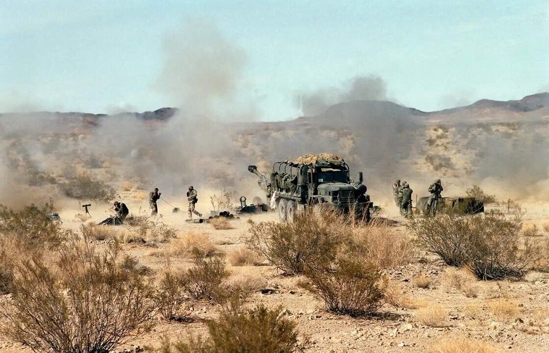

I’m looking for a realistic loadout for this, maybe the PSM water pump, tank set although that was destined for another M54.
Any other ideas for an M813 in ODS? I’ve got the dump, tractor and wrecker so………
Neat idea Gino. I’ve got the gun in my stash.
Thanks for your suggestion.
