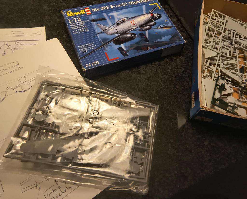

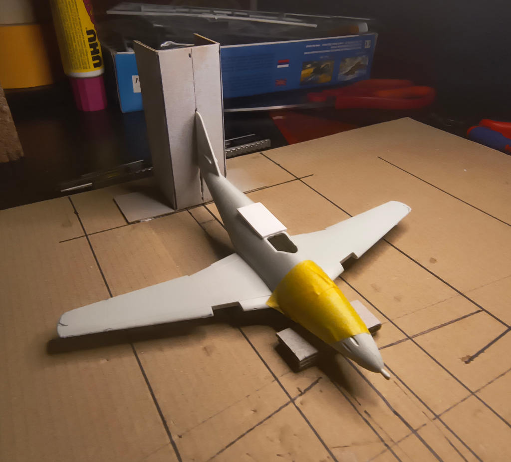

i have started today on a very snowy saturday with my Messerschmitt 626 Triplane , all parts are taken from the standard Revell kit in 1:72 . I made a sketching and a complete concept, draw a rig for the construction and got the fuselage half together , some parts of the wings and the engines ( 4-engine version ).
Everything received little changes from the standard kit, the (coming) “main problem” will be a little tricky :wink::hammer_and_pick:.

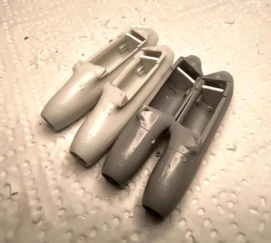

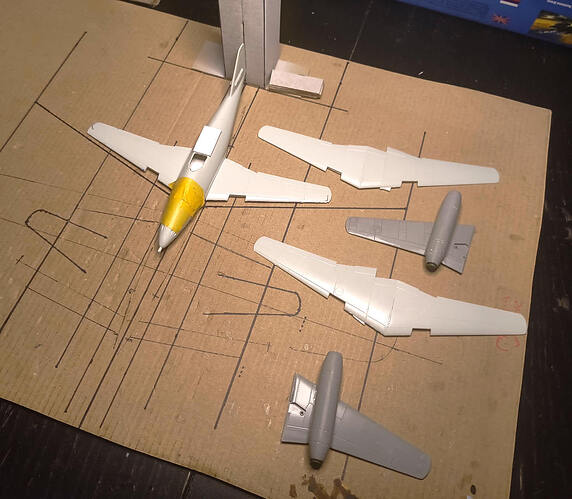

I’ve made a lot of parts for the wings; in total, I used four Me 262 kits for the triplane. The glue joints need to cure completely before I can continue.

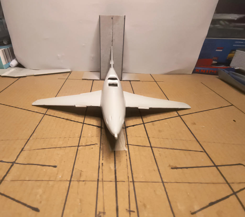

I built a suitable jig out of cardboard to ensure the correct alignment of all the wings and engines.
I made the fuselage narrower, which automatically corrected the dihedral angle of the wings, but that didn’t seem right for a triplane i think.

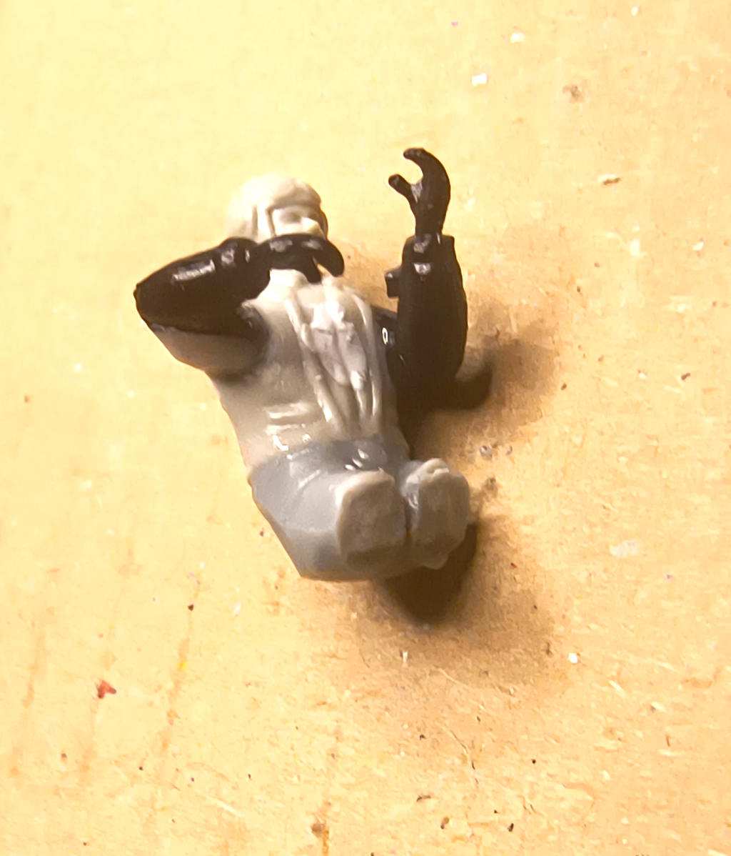

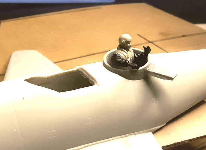

First thing today was the working place for the rear gunner, which went well.

My Cardboard tool is very usefull to fix everything in the correct position, at the end all wings should be in the same distance from the other.

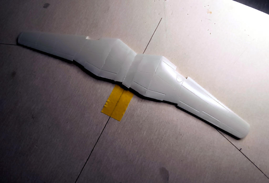

And the biggest wing at the top is together, made from two pairs of original 262 wings.
Great works done so far!
I see a bit of a difference of the wing-halves joint on the last photo. Is that intentional?
And, it is a very interesting project. Do you have a drawing of your idea? Would be exciting to see the goal!
I think you just mean that part in the middle, it just needs to be cutted later. Instead of putty i use parts of sheet to fill some gaps, and the glue was not hard enough for sanding there.

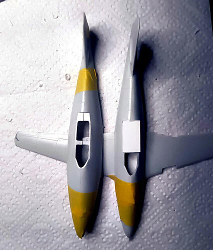

@Killnoizer Do you plan to keep the gunner in one fuselage and the pilot in the other?

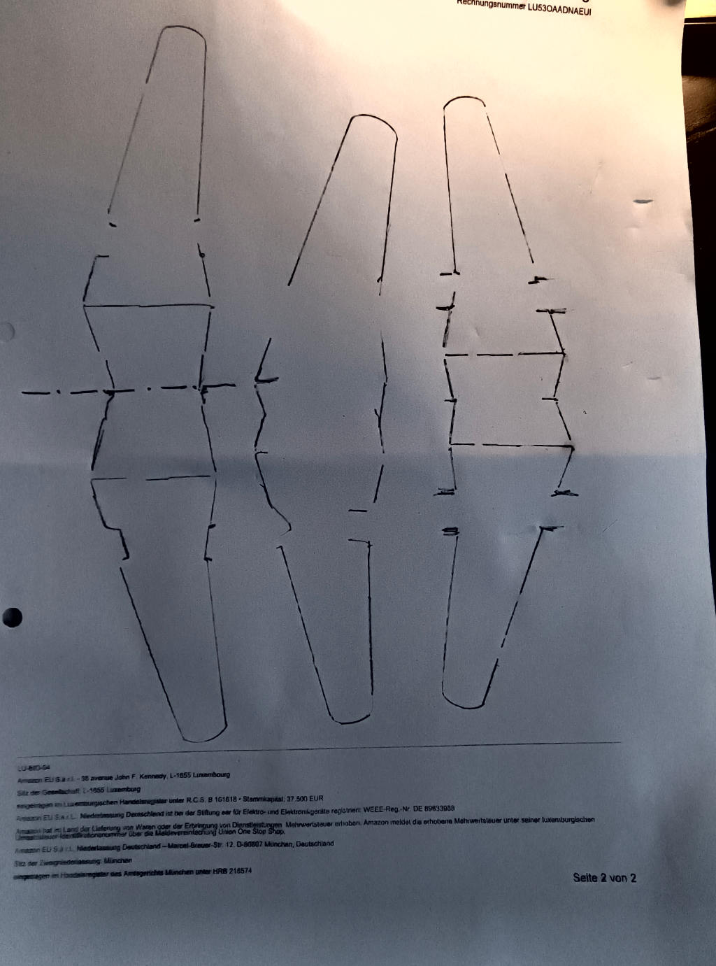

This is the only final sketch that i keep, it shows the final position of the wings and the way to work it.

Today i modified the gunner, it’s a little bit like Frankenstein, but in the end he looks very chilled in his open gun station. ( Fine work and sanding is needed later, i know ) .
