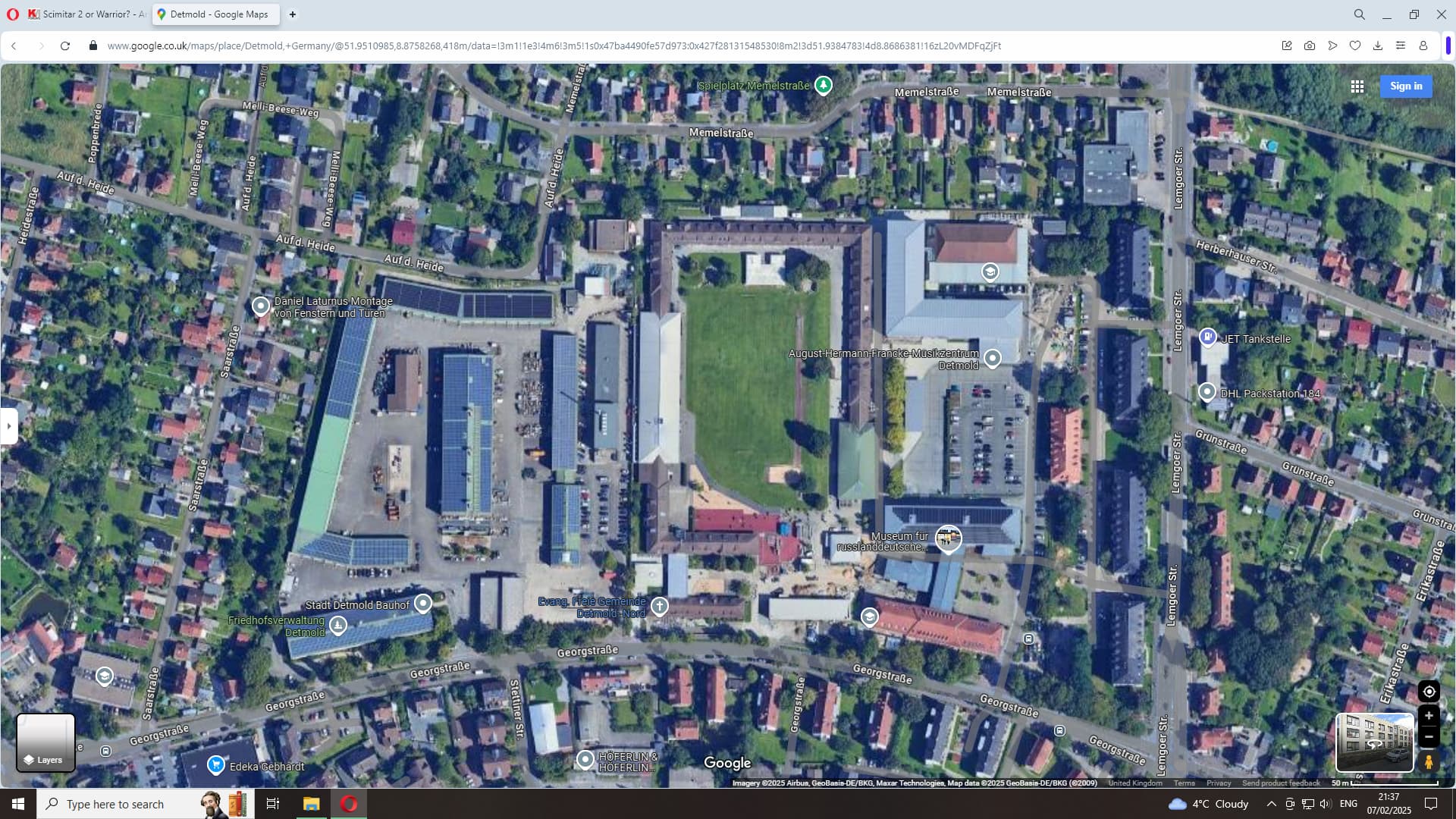

Yeah the government is good at that. Build outstanding facilities and infrastructure and then hand them over to someone else. We did it in Germany, Lothian Barracks in Detmold had been finished a year when it was decided to start closing it down. All of the accommodation was modernised, the hangers were all climate controlled with a new workshop for REME. washdowns, POL point, servicing bays, brand new cookhouse the works. The hangers now house the Stadt vehicles, bin wagons, snowploughs and the like. They even filled in the swimming pool!!! I imagine it won’t be long before CFB Suffield expands across the road into Camp Crowfoot. @Johnnych01 you will recognise it even from the air. Main gate running in between the first and second blocks at the bottom right of the picture.
Yeah, had some great times in Lothian and Detmold. Definitely my favourite out there over Sennelager, but even that was nice down in Paderborn…
I imagine they will just hand back crowfoot and the UK parts of CFB Suffield and it will all just morph into a huge Canadian base.

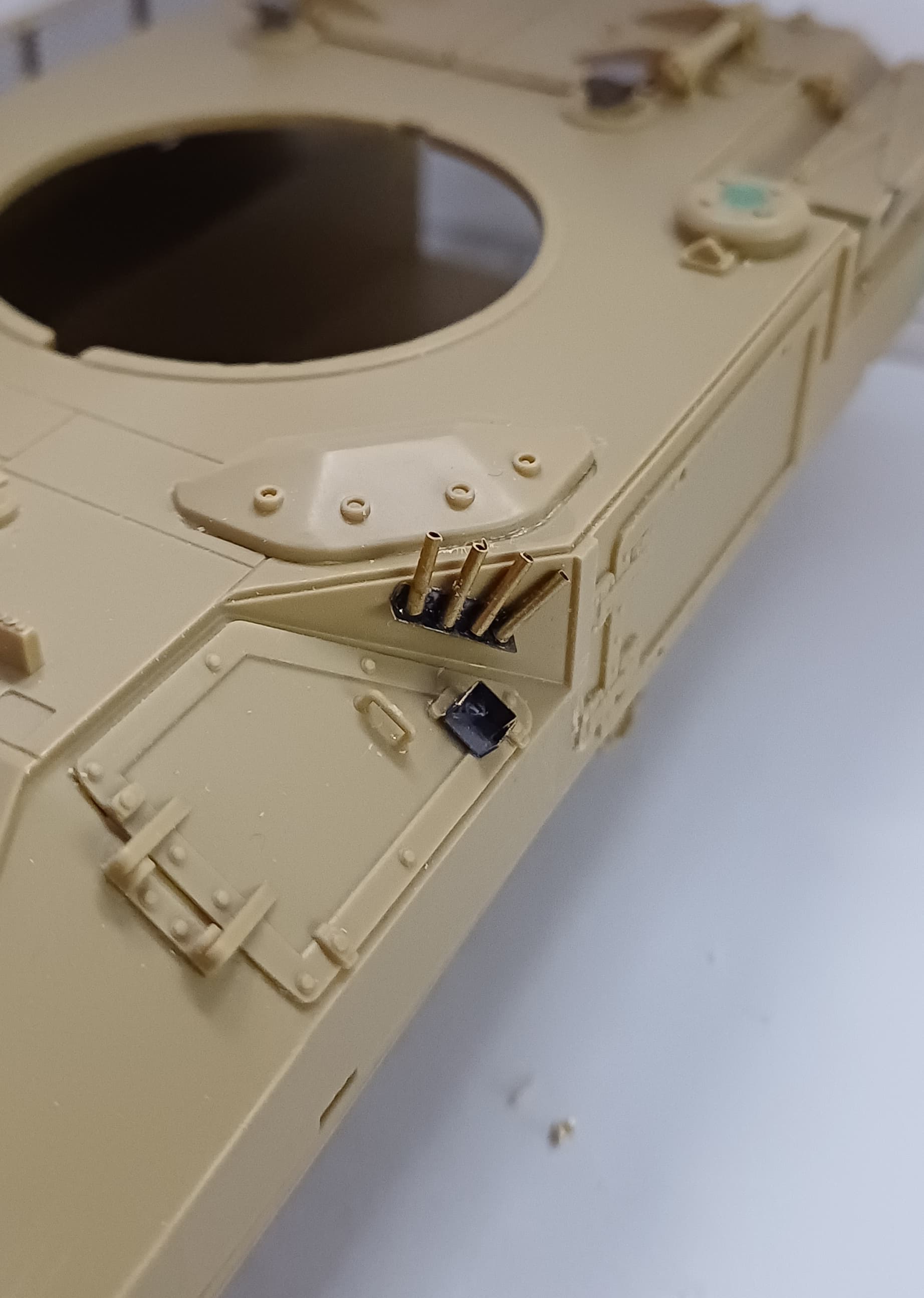

I think etch is taking over from indy links as the bane of my life, It really tests the eyesight. Fitted the tools to the front of the wagon. The kit tools are woeful and only the sledge hammer was saved. The pickaxe handles are just styrene rod shaped and the axe is from an AFV Club Centurion. Used the etch set and brass tube for the cam pole brackets as I think they look better than the solid kit part.

The cam pole holders are terrific. Perfect look :+1:
