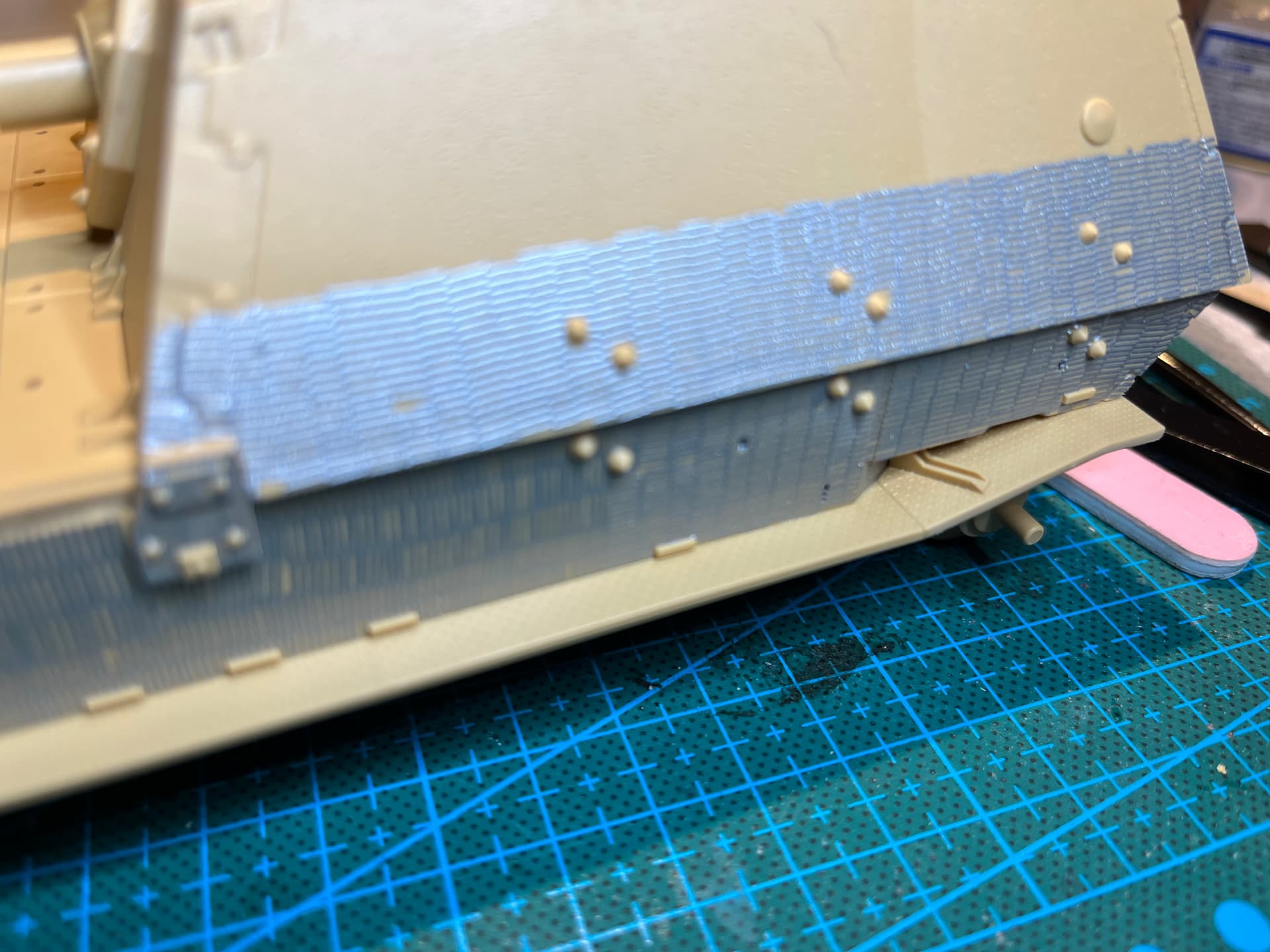

Okay I lied. Update, got half the front and one side done. The long pieces for the sides took quite a bit of a work as they didn’t want to move much after they hit the kit, had to slowly move them into position. Also had to cut 4 bolts off and reattach, haven’t attached two yet, the other two were the far back ones on the lower hull. Super happy with this stuff, need to fix around the one bolt a bit by filling it in with trimmings
It looks okay superficially, but the reality is it doesn’t look to have anywhere near the depth of texture actual Zimmerit had.

I had the same concern but reading an article from the tank museum, the outer layer of zimmerit that receive texture was 4mm thick. Or 0.1mm in 1/35, so I don’t think this stuff is too far off.
In my opinion DIY zimmerit is often over done and overly deep

Finished up the zimmerit except for some small pieces that go in the rear tool bin, and fenders. Pretty happy with how it went down. Hope it shows under paint

I agree the less paint with this stuff the better. I think I’ll “prime” with a very light coat of a home brew red oxide to give the yellow base more depth but won’t do a traditional primer coat

Two small issues. One I gouged the port side fender a bit cleaning up a seam. More problematic, the holes for the fender supports in the zimmerit decals (being for the Zvezda kit) don’t align with the fender supports. This leaves a hole in the top glacias zimmerit
My plan? The zimmerit for the fenders has a portion that wraps around the fender side
I plan to trim this excess and use it to fill the holes
Got all of the zimmerit and a good chunk of the construction done
I’ve decided not to apply the zimmerit to the fenders. I’ve found a few pictures of elefants with no zimmerit there. The zimmerit being designed for the Zvezda kit also didn’t fit perfect. This area was the most egregious
In order to get a good fit against the conduit, I had to trim the zimmerit. This left a glaring gap along the edge. I used the left over fender zimmerit to do some surgery which is also why I won’t be using zimmerit on the fenders. The remainder of the fender zimmerit will be used to patch really small gaps around a couple hinges and the brackets on the front glacias

No problem! It’s good stuff and adheres well. It’s also really durable so it’s easy to position. I am curious how it looks after paint. Word of caution. Lots of dry fitting the zim. There spots it was way too long and would have overlapped previously applied zimmerit and been too thick. There are also spots it was a tad short and I had to plan how to make it fit
